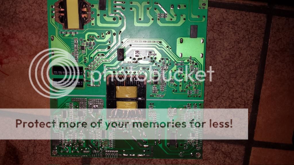

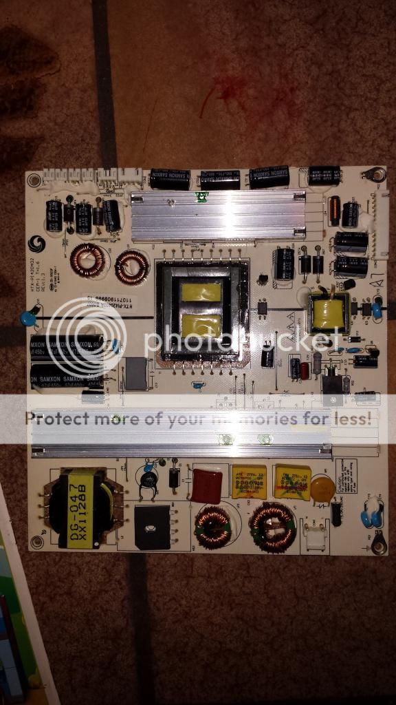

    so I picked up this 42 inch Haier led tv with some shorted MOSFETs that power the 12 and 24 volt supplies. Power supply model htx-pi420402a.
    shopjimmy has a repair kit for it that supposed to repair every known problem with the power supply which there are three different issues that can happen I had the issue where I had no back lights and no 24 volt or 12 volt to power to the main board and the T CON board.
    I replaced known bad components including some LED drivers. I bought the kit and replaced every component and now I have a chirping standby and I found an extra part not included in the kit which is a Schottky barrier diode that shorted and cracked. replaced that all on the secondary side of the power supply I even replaced every component just to be sure.
    I had found a few that were iffy but still have absolutely no power on 12 on the 24 volt even though I have standby although it's chirping.
    In my knowledge in the past I have come across these power supplies having shorted rectifier diodes I have not found any bad part now but yet I still have no 12 volt dunno 24 volt. Anyone have any experience on this particular power supply?

    Could you upload clear pictures please of the boards please ?

          Pictures are not really clear enough for trouble shooting - shooting them in daylight usually gets better result and they should be posted on the forum using manage attachments. I have added these three so the dont disappear
          With just the power supply connected to the mains what voltage do you get on the two BIG caps

              YesI'm getting 384v at the filters. Have standby and 5v to mainboard. i press power button I get green LED but the 12 volt and 24 volt just do not come up. I replace various MOSFETs diodes and regulators that come with this kit. and I apologize for the pictures unfortunately using my cell phone sometimes it doesn't seem to post properly.
              thanks for fixing the pictures for me if you look in picture 3 you'll see the 12 volt and 24 volt regulated output supply that includes the two MOSFET transistors replaced and the two led controllers
