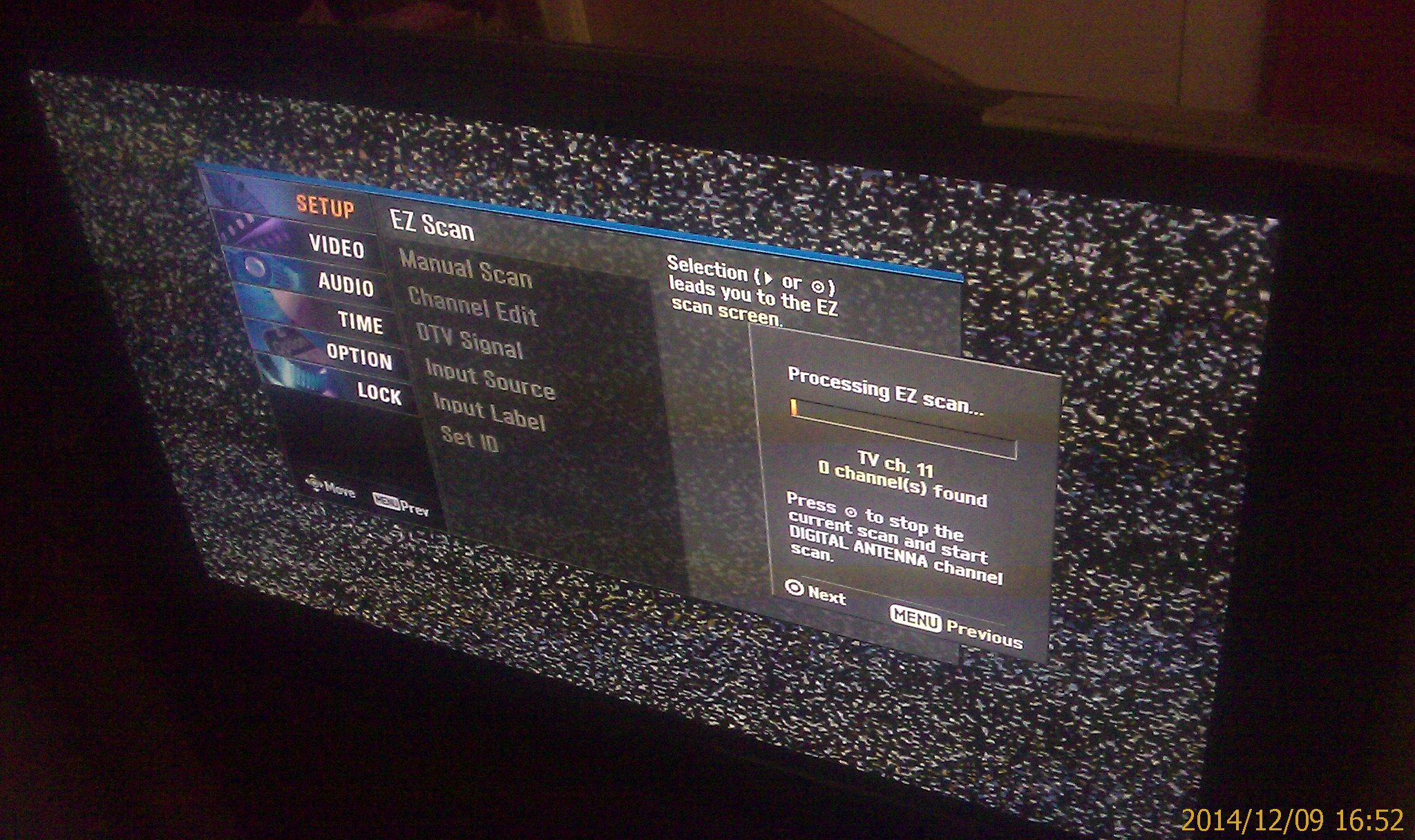

zenith Z50P3 PLASMA TV screen issues pink and purple grainy no image
  • shelby5041
    • Feb 2009
    • 1505
    • united states of america usa
    #121
    Re: zenith Z50P3 PLASMA TV screen issues pink and purple grainy no image
    also there are some really thin horizontal black lines going across top half screen......so if anyone can help me i would appreciate it.........the laerge black stripe is confusing me suince the lower buffers test not shorted......the thin lines could be reseating ribbon cable
    • freakaftr8
      • Oct 2012
      • 3743
      #122
      Try reseating the y ribbon cables. Make sure they are clicked in all the way. Congrats!
        thanks freak.......this has been 4yrs of hell all because of bad new parts.....im going to call shop jimmy and cuss them out....they cost me 350.00 in parts and hundreds of hrs of time....
        what about the large black horiz area?....
        • freakaftr8
          • Oct 2012
          • 3743
          #124
          Either a bad connection on the ribbons to the buffers or something wrong with the buffer most likely

              #126
              no i havent tried...in bed now...3rd shifter 88hrs week
              the bottom y is not shorted.......but the large black doesnt seem like a seating issue......im not that clumsy.....its connected pretty good....so i guess a buffer can be bad and not test shorted?
              i am happy....i believe i now can save both of these zeniths even though i was told to trash them lol
              • shelby5041
                • Feb 2009
                • 1505
                #127
                meet mr clumsy lol.............
                it took me about 10-15 reseats each connector and finally got all the thin black lines out and the large black strip...........FIXED!!!!!!!!!!!!!!!!!!!!!!!!!!!!!!!!!!!!!!!!!!
                hell yeah!!!!!!!!!!!!!!!!1
                thank you!!!!!!!!!!!!!!!!!!!!!! everybody!!!!!!!!!!!!!!!!!!!!
                and screw you shop jimmy for putting me through all of this because you cant sell good parts..will never buy a part from shop jimmy again.....!!!!!!!!!!!!!!!!!!!!!!!!!!!!

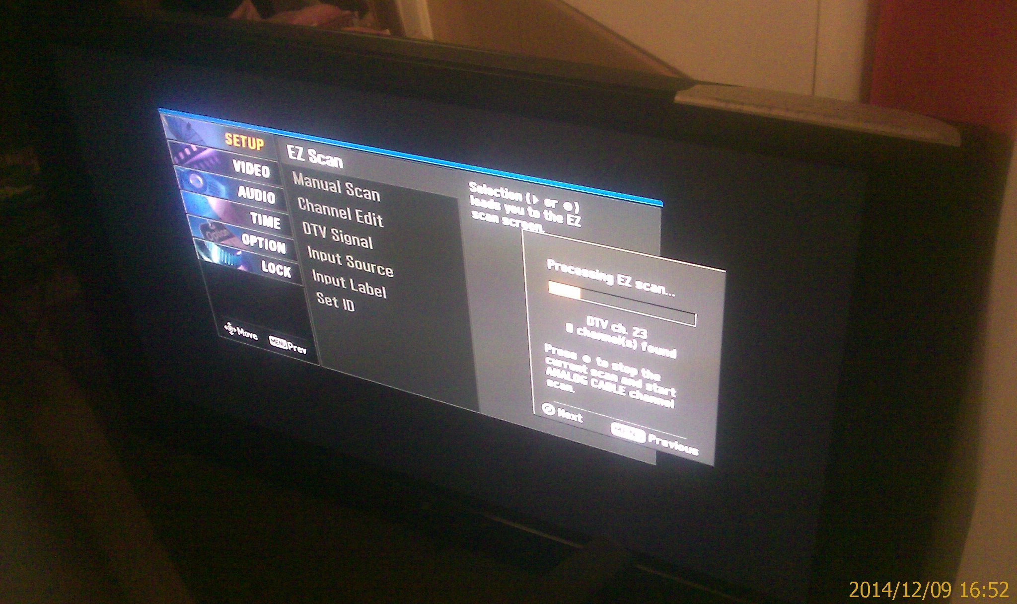

                                #135
                                hi ....me again....1st tv working great and put it all back together ....probably shouldnt have before i got 2nd tv fixed.... BECAUSE 2ND TV have not been able to get to work....i actually ordered a substitute part per encompass parts data the y upper in my tv orig is part # ebr38447602 but i bought ebr37397801 which encompass says was a direct substiturte even though shop jimmy says no........my tv model is
                                zenith z50p3
                                model code 50pc3db-ue
                                panel code pdp50x40a36
                                for whatever reason the board i just got when i install it ..like the other tv the pink is now gone but the top 40% of the screen is good now but the bottom 60% is black.......its not 50/50 its 40/60
                                i have reseated the cables 10 times from experience with 1st tv and the display absolutely does not change....the top and bottom board do not test short...i even have an extra good bottom buffer and installed it and no change at all to display.....
                                seems like part of top buffer isnt working and also seems no power going to bottom buffer.............could this be a part compatibility issue???
                                unfort i already put the other tv nack together which is a pain with all the screws...maybe ill take it apart and install the known good upper buffer that is orig part#.............but cant do it for a while........
                                was just wondering if somone could give me some advice on this new situation...
                                i really thought the 2nd tv would be exact same repair which it seems to be loooking that way..by how it acted when i installed good y upper buffer...but wondering if encompass parts has incorrect data on their site.....someone recommended that they are the most accurate parts data site....shop jimmy shows no substitute part for ebr38447602 but encompass does.....
                                any help would be appreciated

                                  #136
                                  i wish i could test for 5v going to bottom buffer but seems to be hard to test....does anyone know how i can test 5v from upper to lower buffer? on my tv?...i tried berfore on 1st tv going from y to upper buffer and could never get a reading....even though the 1st tv does work ..the issue is what to use for ground .....so i can get a v reading
                                  just seems bottom buffer isnt even firing up.....since bottom half of screen is black...and also another 10% of top half is black
                                        uh oh.....update....left 2nd tv on for 2 min and now the screen is pink and white again.......
                                        back the to drawing board.......
                                        • shelby5041
                                          • Feb 2009
                                          • 1505
                                          #140
                                          lower buffer is not connected to the y sustain..it is connected to the y upper but i got other issues now....have to start over....for some reason display is pink and white again......going to have to do some more testing....
                                          i now am going to leave the 1st tv on for a couple hours to make sure its ok
