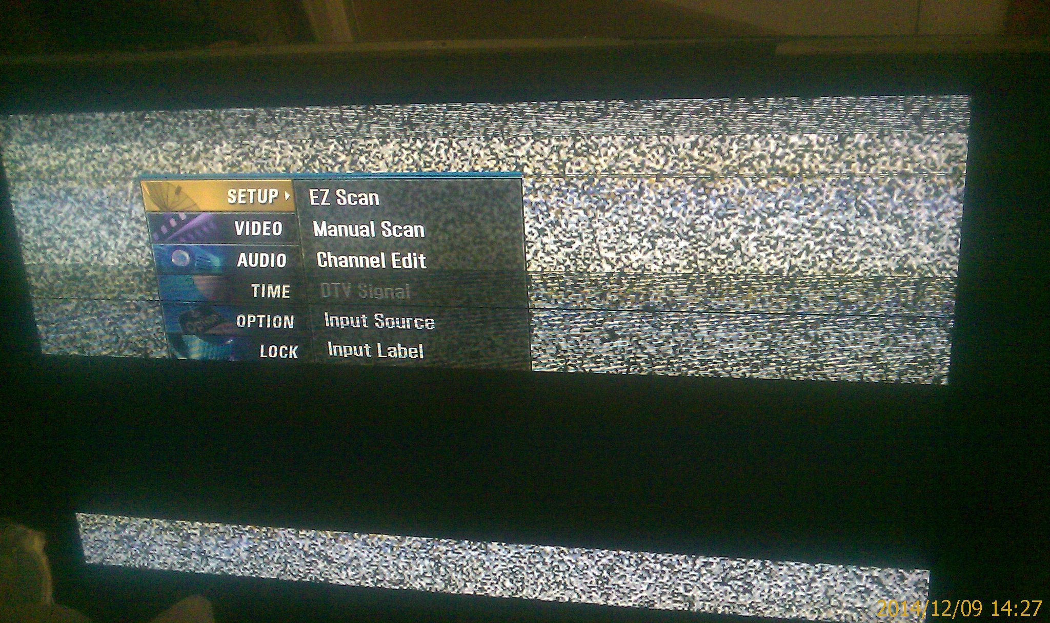

Hi friends,
I got this monitor, which works perfectly fine, except there is pink discoloration over right side of the screen ( picture1 ). When I disconnect LVDS cable, there is no sign of pink color, so its not backlight issue ( picture2 ). I took a closer picture of the upper right corner, you can see even some kind of pixel defects. Its only on that pink area ( picture3 ).
I believe, there is some problem inside the panel, the question is, if it is fixable. I have never met this kind of issue, so I really appreciate little help from you guys. What I tried so far - interrupt...
