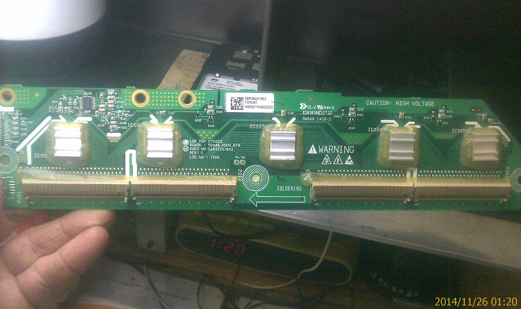

                      #90
                      Re: zenith Z50P3 PLASMA TV screen issues pink and purple grainy no image
                      does anyone know how i can test my y buffers for short?
                      thanks
                      see photo
                      • mmartell
                        • Oct 2013
                        • 3189
                        #91
                        Do a search for user "tom66" and "buffer testing" or similar and you will find a video of exactly what you're looking for.
                        • tw2005
                          • Oct 2011
                          • 6458
                          #92
                          Can we give him the link? This one's been a battle, I'm having trouble finding that video. Is it in the sticky?

                            #93
                            this tv is driving me nuts....im ready to toss it out in the lake lol

                                  #96
                                  thank you for the info i did both tests on each buffer and all the uppers tesst shorted....the 2 original ones and 1 repalcement i bought in 2010
                                  im going to buy another replacement y upper buffer and will do some more swapping of boards...so far nothing has worked
                                  i dont have much free time so i tinker with the tv when i can.few min here few min there ...i want to hook up a video source to see what the display would look like with a video image on it...the pink and white display photos in my posting are just turning tv on with no video source.....
                                  thanks
