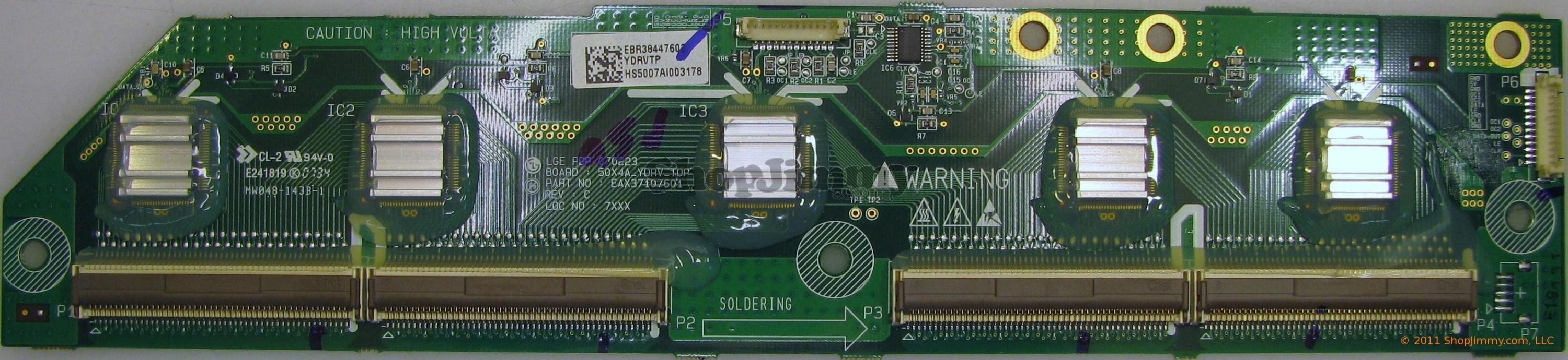

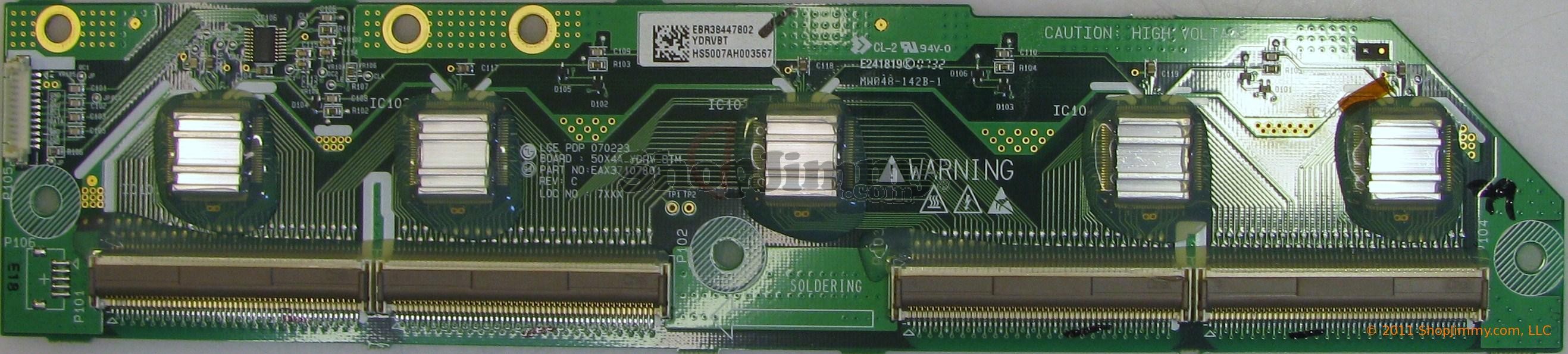

when i get time i will review my y buffers...i ruled them out when i boguht new ones but there is a possibility like u said that maybe they could be part of issue....Comment
Re: zenith Z50P3 PLASMA TV screen issues pink and purple grainy no image
wow the buffers are really cheap on ebay like 10-20.00 each
i may just go ahead and buy another set of ys to continue my troubleshooting...afger i find more about the 5v testComment
odd..my buffers are ebr38447802 and 602
shop jimmy does not show these part #s for z50p3
they have diff part#Comment

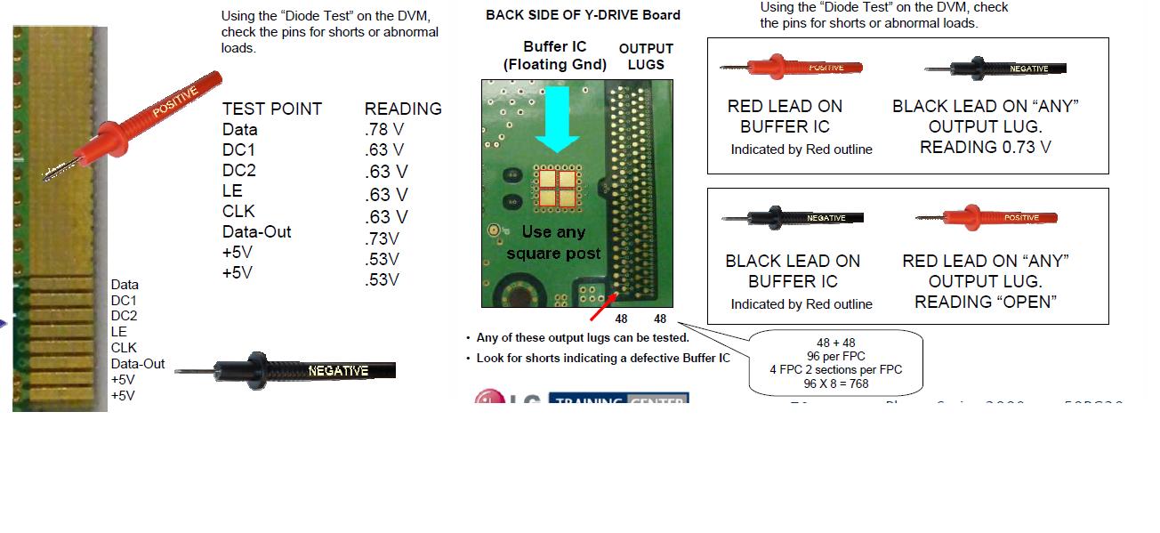

5VF is floating, test wrt to the screws on the Y-sus or the VFG output.
Every signal to the buffers is floating, it's not relative to chassis.Please do not PM me with questions! Questions via PM will not be answered. Post on the forums instead!

thanks....so i test 5v to y buffer by grounding to a screw on y board?....if so i did that 0v.....
or do i test using pin marked gnd like tv2005 said?Comment

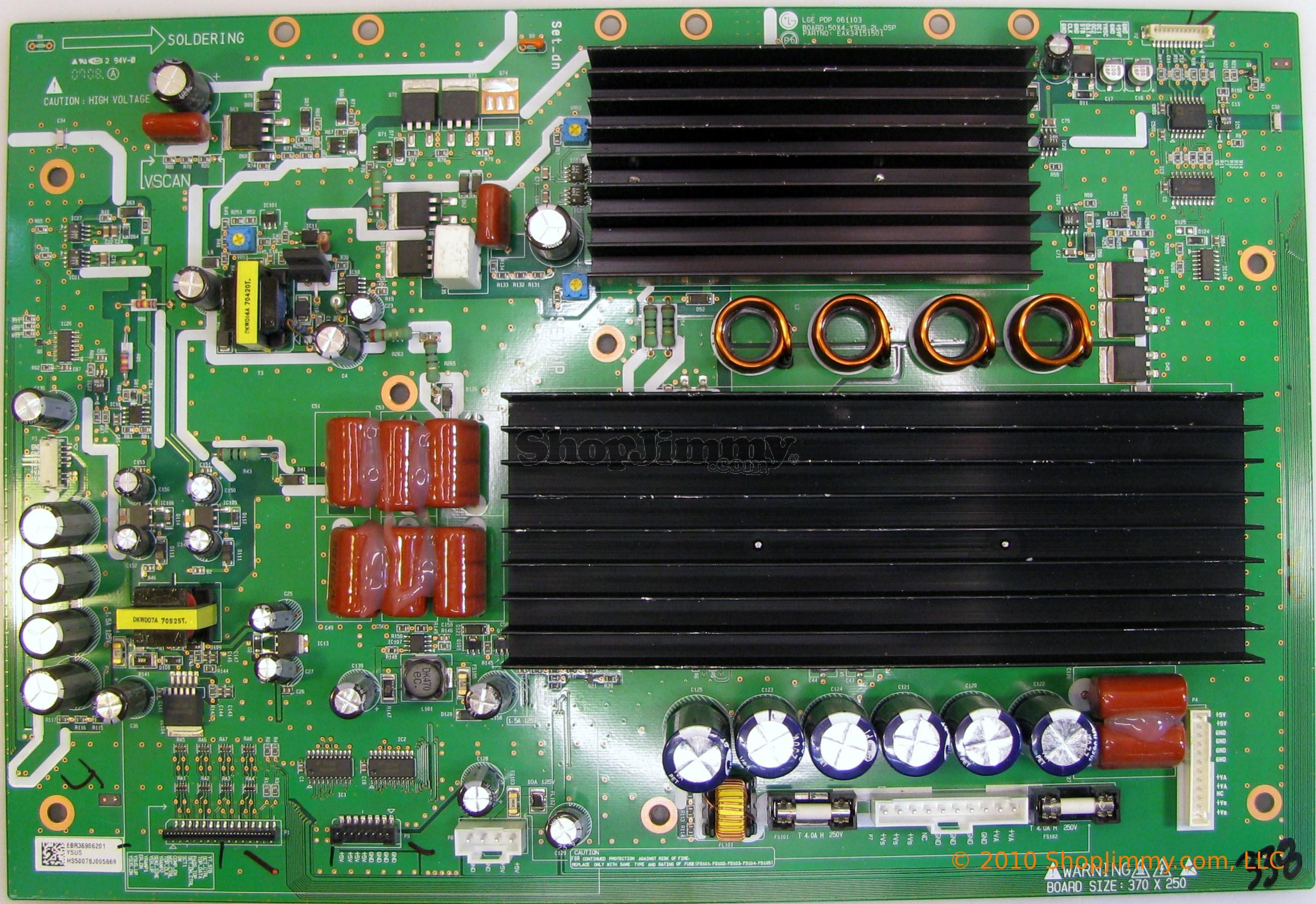

The output of the Y-sustain, the un-grounded screws connecting the board OR the connectors which have lots of pins connected together.
You've not posted any clear photos of the Y-sus, so I'm suggesting possible configurations... I don't know how your set is laid out.Please do not PM me with questions! Questions via PM will not be answered. Post on the forums instead!
For service manual, schematic, boardview (board view), datasheet, cad - use our search.Comment
Yuck, IPM based. The two outer pairs of screws are the VFG. The inner pair will be the VFG+VSC (about 120~150V above VFG). The 5VF is 5V above VFG, approx.Please do not PM me with questions! Questions via PM will not be answered. Post on the forums instead!

I would just test the output nodes using a continuity meter, test to VFG and VFG+VSCN. Inputs on the IC itself are unlikely to fail.Please do not PM me with questions! Questions via PM will not be answered. Post on the forums instead!

That's certainly the quick and easy way, well what I'd do. So the gnd and 5v at p2 to the buffer, that won't display 5v? I've never probed a live buffer, only ever resistance.Comment
VFG to 5VF should give about 5V, but GND to 5VF (with GND being chassis) will just give a nonsense number because you're essentially just measuring the Y-sus output plus 5V... and the Y-sus output is not a DC level but a complex multi-step waveform and it changes based on the current image.Last edited by tom66; 11-24-2014, 07:02 AM.Please do not PM me with questions! Questions via PM will not be answered. Post on the forums instead!

update with tv powered on i checked pin 2 5v to pin 1 ground on power cable from y to y buffer...reading 0v
also did same 5v and neg to the metal connector thay atyaches both boards...reading 0v
also did resistence test pin 2..pin 1...reading 0...or no readingComment
