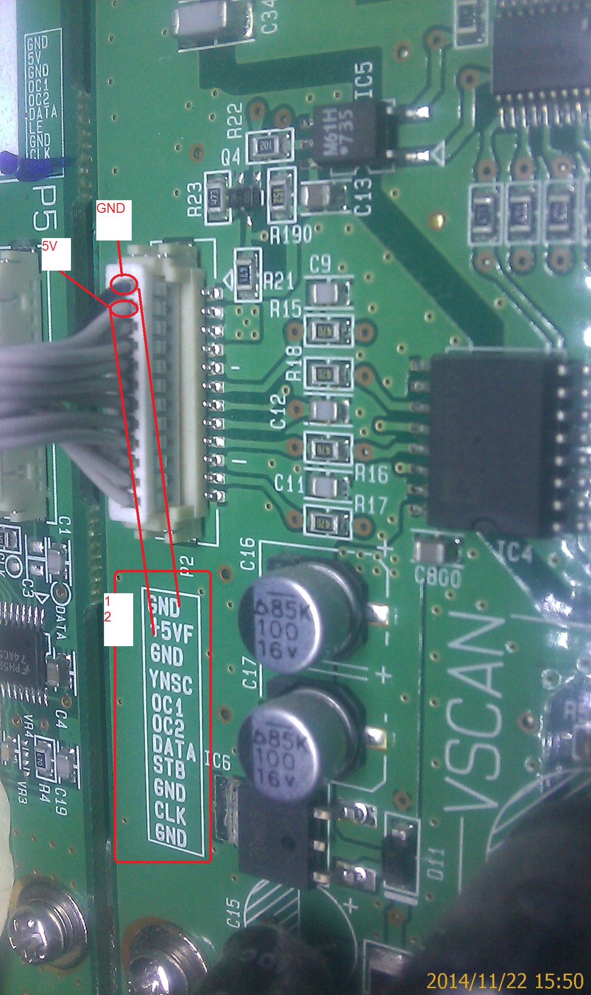

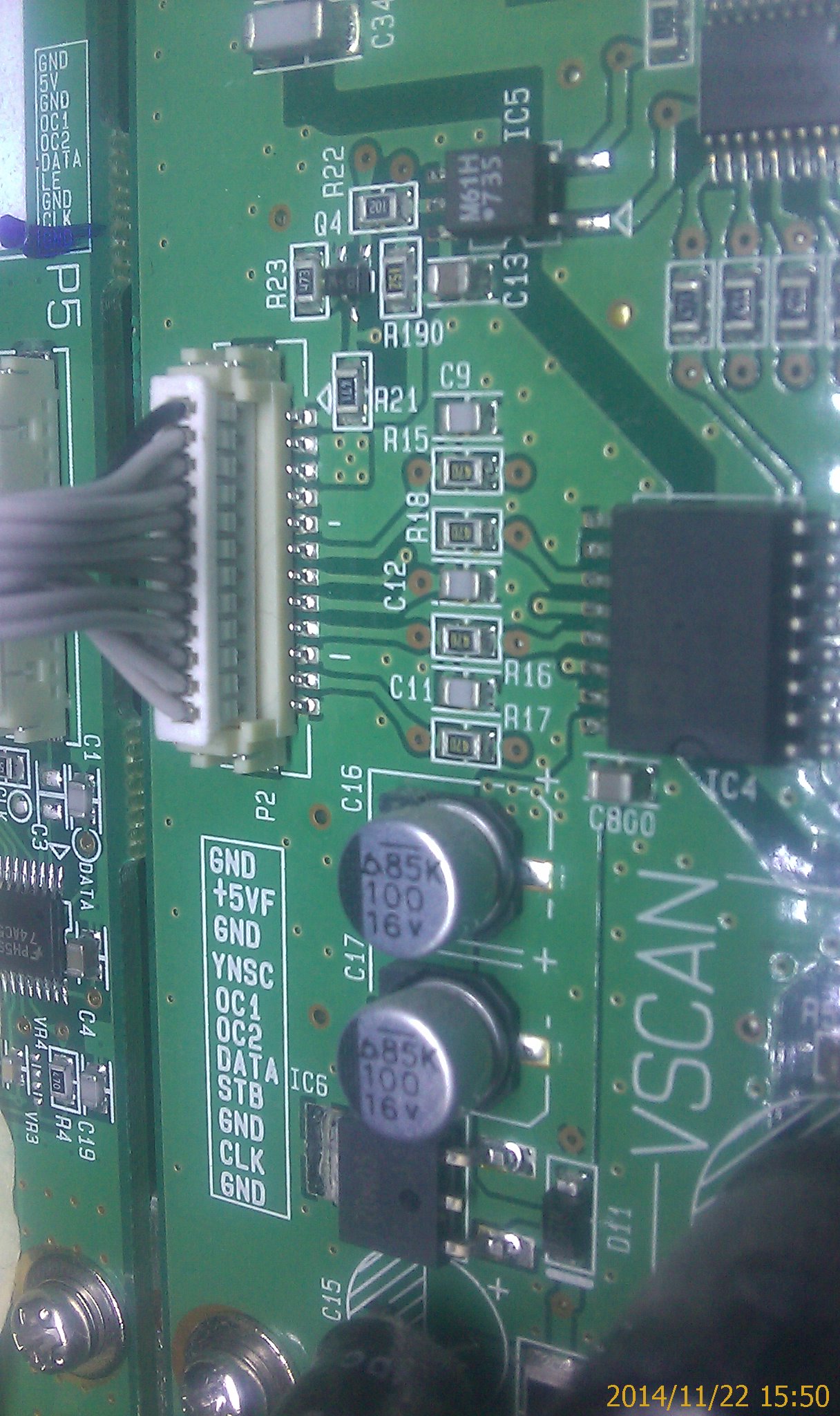

                      #50
                      Re: zenith Z50P3 PLASMA TV screen issues pink and purple grainy no image
                      hi i have a question maybe im testing the 5v wrong going to y buffers....how can replaced y boards all produce no 5v??
                      here is a photo of the cable going to buffer........there are 12 noted locations but only 11 pins ....how would i test for 5v and what would i use for ground
                      i tested the top 5 pins and used a screw for ground and got 0v
                      so im thinking im not doing something right
                      i have replaced 3 y boards....1 z board....2 buffers....and 1 logic board and the display looks the same all pink and white
                      • shelby5041
                        • Feb 2009
                        • 1505
                        • united states of america usa
                        #51
                        correction there are 11 noted locations and 12 pins on the cable...can anyone tell me which pin would be the 5v pin and what to use as ground?

                            #53
                            I've marked the photo, after you test for 5V there, turn it off and then check the resistance between the same to see if there is a short

                                  #56
                                  looking at the tracks, I'm thinking.
                                  1.GND
                                  2. 5V
                                  3. 5V
                                  4. GND
                                  5. YNSC(GND)
                                  6. OC1
                                  7. OC2
                                  8. DATA
                                  9. STB
                                  10. GND
                                  11. CLK
                                  12. GND
