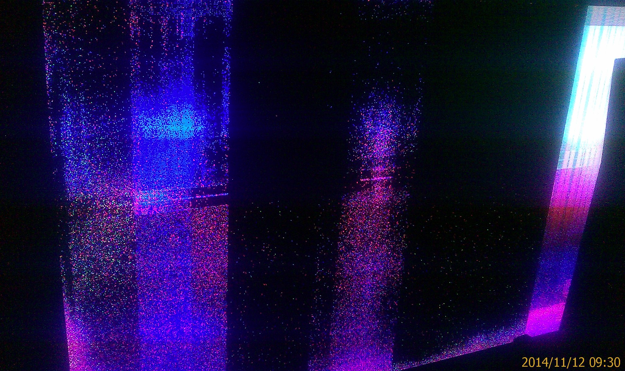

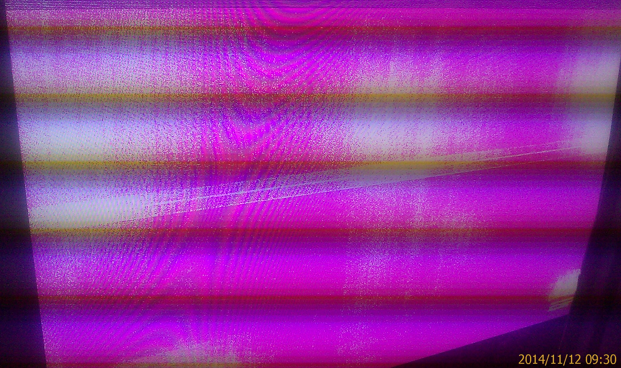

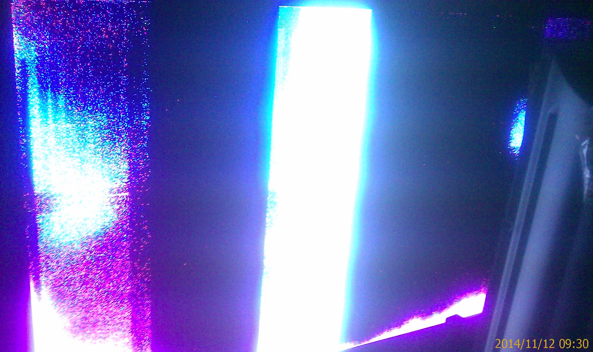

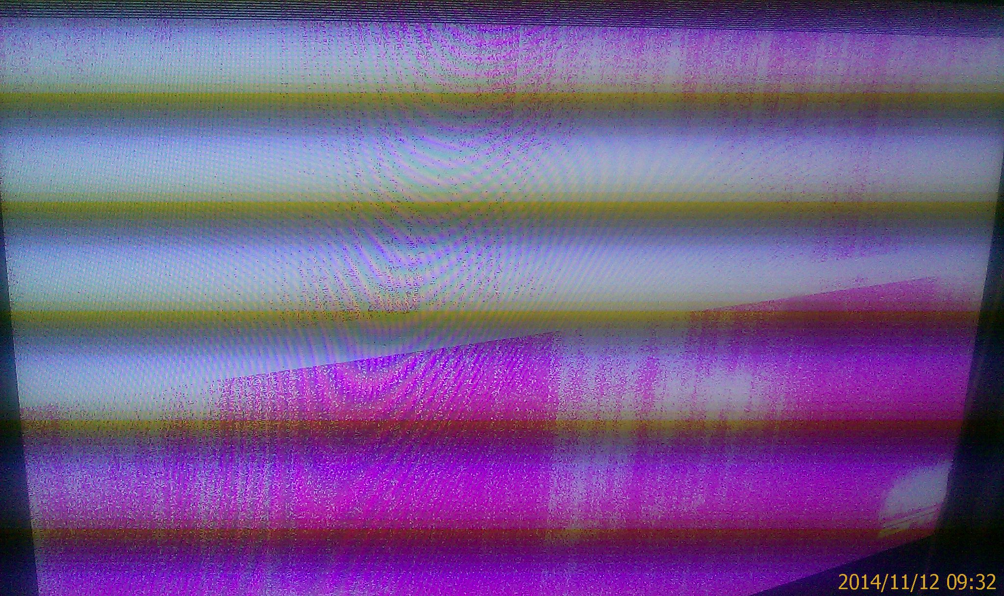

    hi
    i have 2 of these exact same tvs zenith z50p3 and both are doing the same thing..i got them from 2 diff sellers and both power on but the display is messed up..........the screen is not cracked....sound works...and powers on fine but see photos........the display is pink and purple and black grainy and messed up bad and it the configuration of weird patterns and colors continues to change when tv is on....both tvs are in great cosmetic condition and would love to repair them if repairable........
    i have had these for a few yrs and couple yrs ago whil troubleshooting i bought new y-board..new z- board and replaced the buffer boards and did not fix the issue..so not im getting back to them to see if i can bring them back to life or throw them in trash
    note: the photos with black horizontal stripes spaced apart evenly is just a camera issue they are not actually on the display its just how the camera took the pics
    any help would be appreciated

      Shorted mosfets on y board. Check all of them. Also check all voltages from the power supply. Do they match the panel label?

          From my plasma experience fixed lines (similar to the ones in your photos) have almost always meant a bad panel for me!! Lots of people disregard the need to replace the buffer boards with the sustain boards in question. If a bad buffer was the reason the sustain board failed then marrying the bad buffer to a good replacement sustain will only cause the good board to fail pretty much right away.
          Buffers can only be checked with an oscilloscope to measure variable voltage.

            Re: zenith Z50P3 PLASMA TV screen issues pink and purple grainy no image
            hi there are no fixed lines............the horizontal lines in photo are from camera
            not on screen

              the screen is random and changes colors and patterns continuously see photos.........the blackish horizintal lines are from camera not actually on display of tv
                                    two things which catches my attention.
                                    1. on TV 1 (pics 1 & 2) how bright and white that centre band is, I'm thinking it's pretty bright for a dead Zsus
                                    2. TV 2 there are in fact horizontal lines on that one both at the top and centre
                                    You have 2 sets of buffers, if it's only one board dragging the ysus down then you may get lucky and get half a good display isolating and swapping the buffer boards.
                                    Another thing I'm thuiking iss if the zsus is dead , then if that board was isolated then theorectically you should end up with the same display no change.
                                    I guess you've tried swapping the zsus across from the other TV? any change?

                                      the photos i posted were from the same unit....i do have 2 of these tvs exact same model doing same thing...
                                      ..i just got home from work and disconnected the z board ....
                                      when i power the tv it powers on fine but the screen is now totally black......and almsot no static noise....very very very slight..almost cant hear it.
                                      with the z board in ...the screen is like you see it in my photos and the screen flickers real bad and makes loud static noise and changes patterns and colors pink white red blueish purple continuously but there is no horizontal permanent defects areas on screen...im not a tv tech but i really dont think its bad buffers ..the ones i bought i got from shop jimmy....the other boards on ebay
                                        and like i said those pics i posted are from the same tv......i was hitting menu and input buttons and the screen i think went from darker colors to bright pink white...
