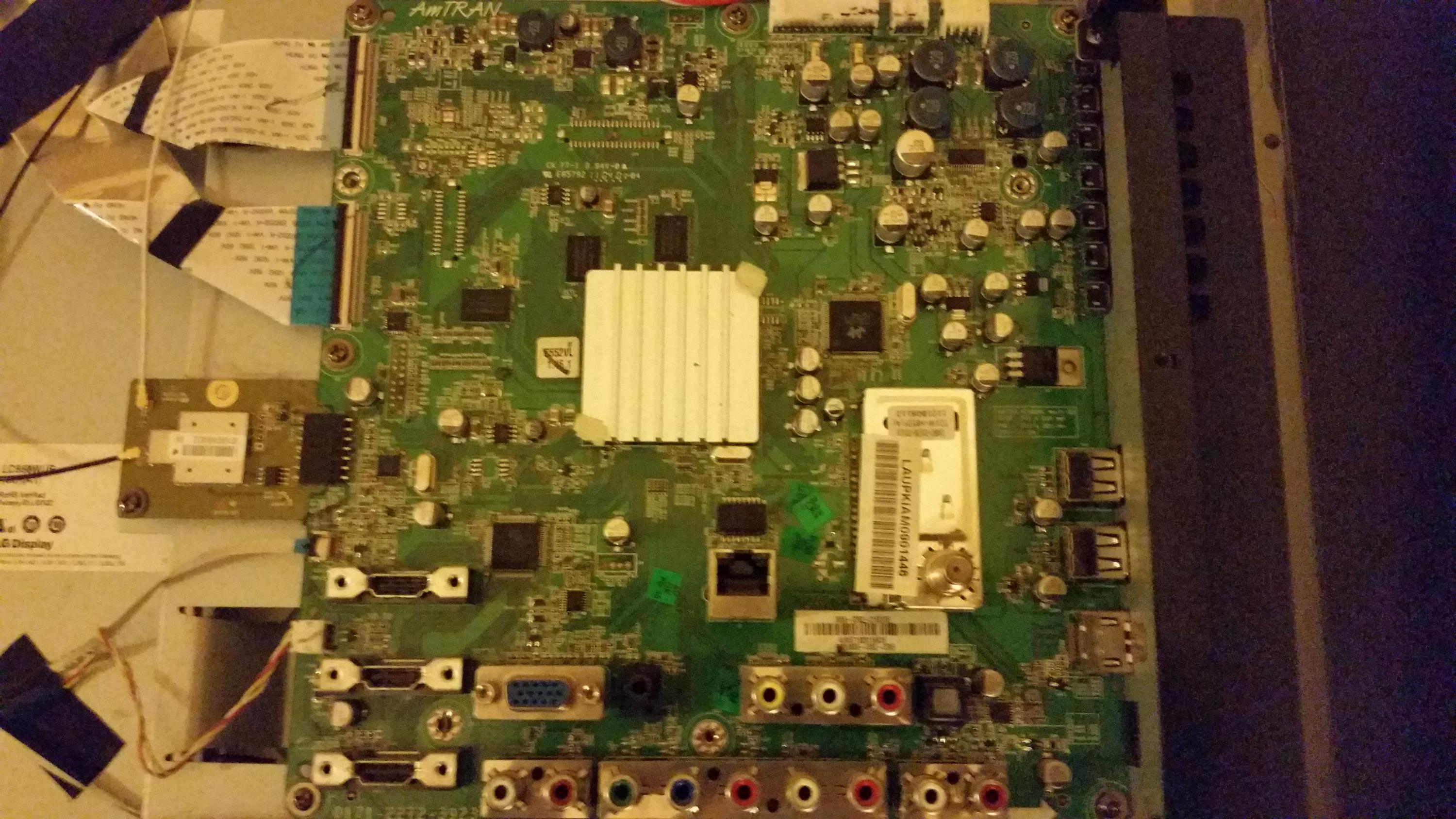

          Please let me know if thesese pictures help. It is a E552VL model.

                Pictures are way out of focus (please look at your pictures, if you cannot read any labels on the board then we cannot read them either), I cannot read the model number on the board or the labels next to the whites connectors on the top right.
                Also need the pictures of the backside of the TV so we can see how all the boards are connected together.

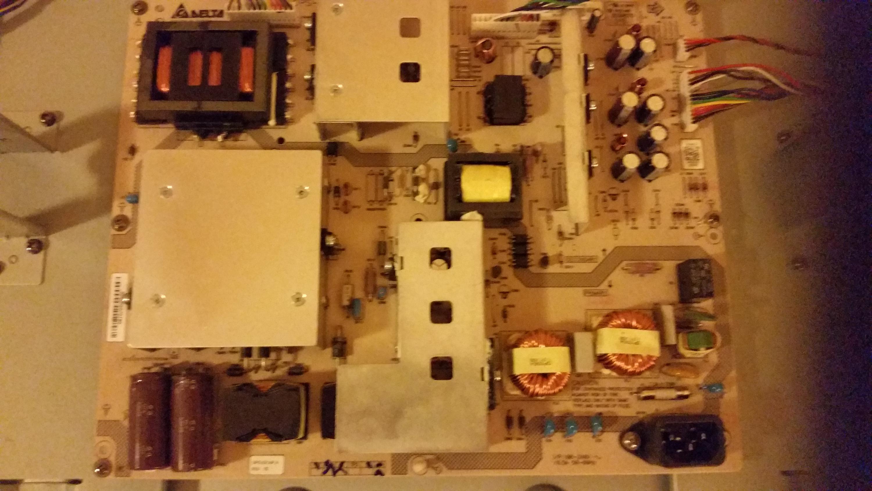

                    I hope these help. My wife is getting irritated with our dismantled TV and this is my only hope haha. I can take more pictures if needed.
                      Re: Vizio E552VLE Not Turning On
                      OK, I found the good pictures of your DELTA POWER SUPPLY 0500-0507-0790 (DPS-321AP).
                      When the TV is not working, you need to verify that you do have >2VDC on the PS_ON pin of CN201 when the power switch is activated. If you do have PS_ON, then check and see if you do have 12VDC on CN201, 18VDC on CN204, 24DVC on CN202.
                      Also report the DC Voltage of A, B, C on CN202 when TV is OFF and when TV is turned on.
                      You should also verify that the backlights are on or not when it is not working, you may have to look at the back side of the panel in the dark to see if they are on. We need to know if you do not see the pictures on the screen is due to no backlights or the T-CON board is dead.
                      http://www.shopjimmy.com/vizio-0500-...upply-unit.htm
                        I apologize but I am very new to this stuff. I have a volt meter but I'm not sure how to use it to test the areas you are asking. The backlights have to be working because when I power on it goes to the V screen and the back of the TV is all lit. Would you mind walking me through how to test those places you asked about?
                          Do you have user manual for the meter?
                          So you are saying that the backlights are on but no pictures on the screen?
                                Originally posted by tonelope10
                                I do, its an E Tek10709. The TV turns on and gets stuck on the opening screen which is a big white V on the screen. If you turn it on and off enough it eventually goes to the HDMI input and works perfect.
                                this sound like an EEPROM problem if your TV is freezing on the "V" logo, does it become unresponsive? and you must unplug the TV to power it off?
                                  Ecking that is exactly what happens! What do I do?
                                  • ecking767
                                    • Oct 2009
                                    • 492
                                    Replace the main board
                                        It sounds like an EEPROM issue, but I don't see any for sale. So maybe it's not an EEPROM issue.
                                        I would measure the regulators on the mainboard.
                                        I have a E371VL and I have replaced the EEPROM, but did not repair the issue and one of the EBay seller, is selling a kit for this TV and I have found out, that in that kit, there is no EEPROM. There are three regulators and two smd fuses.
                                        The regulators have three pins on one side and a wider one on the opposite side.
