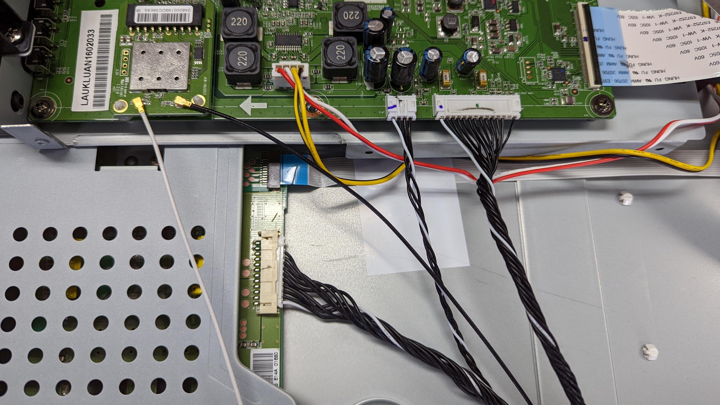

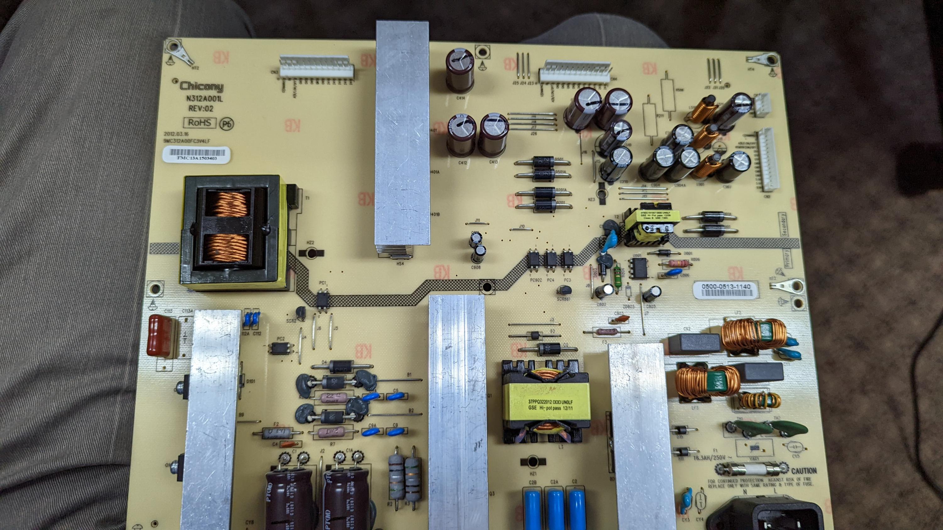

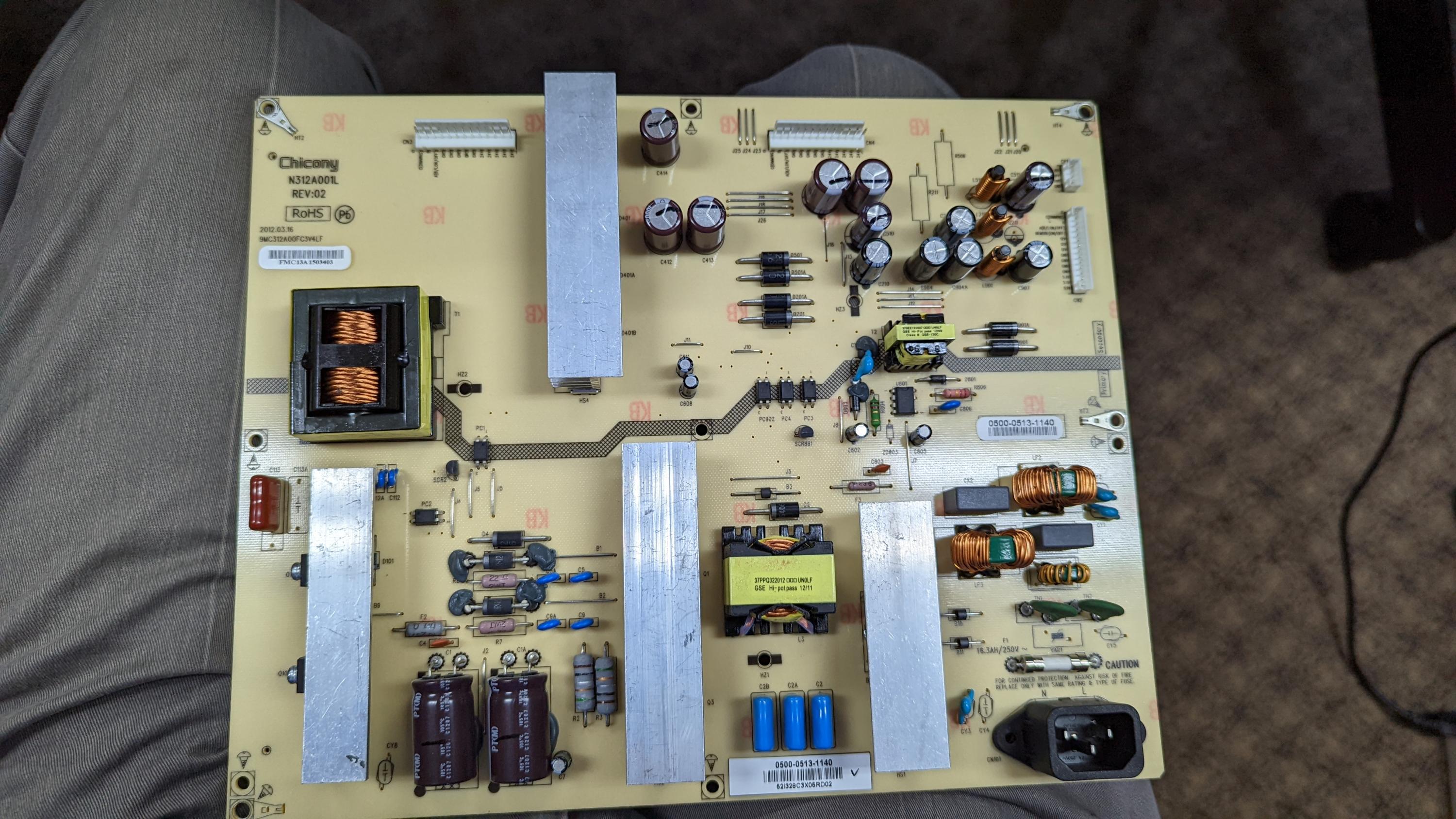

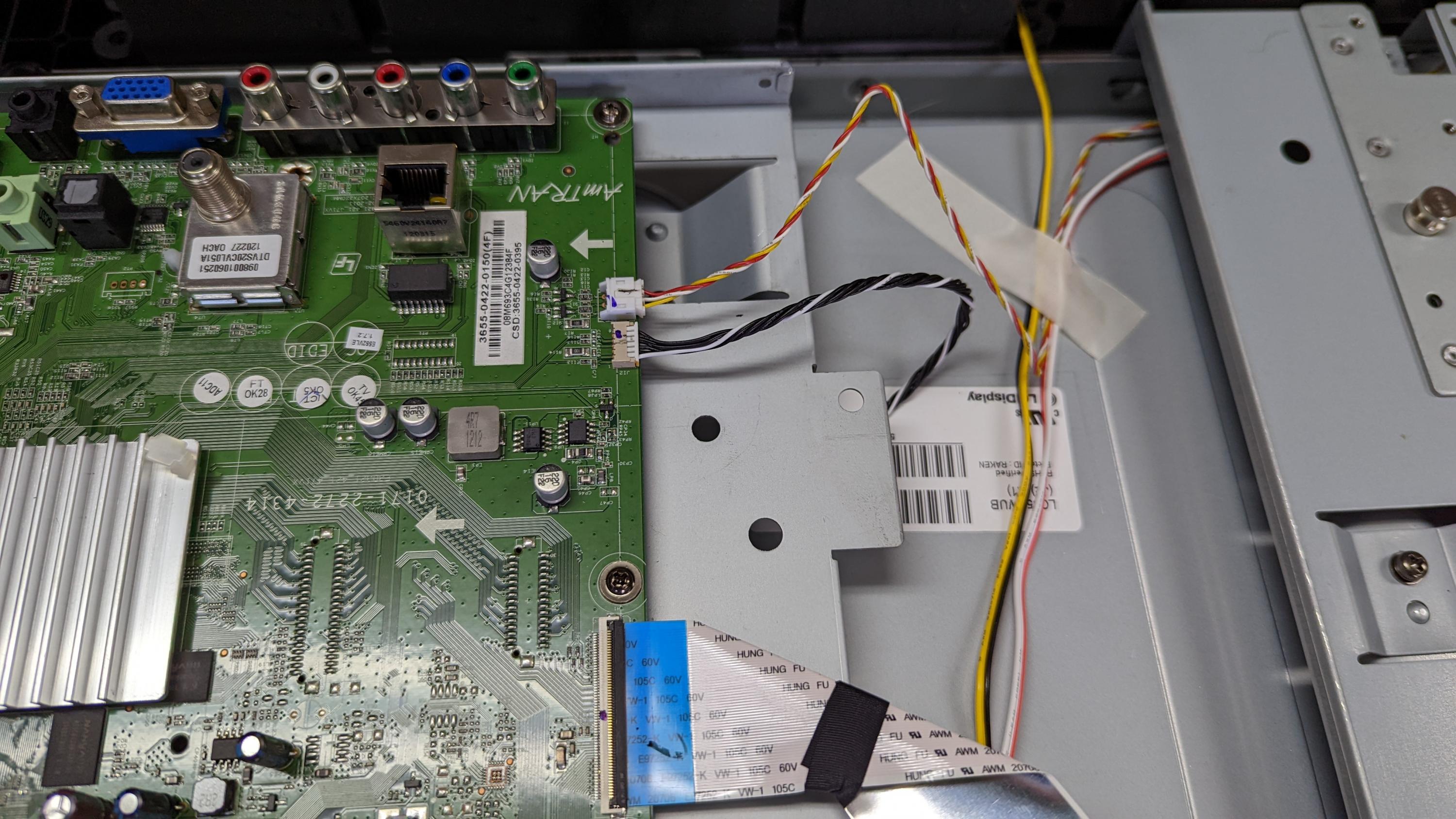

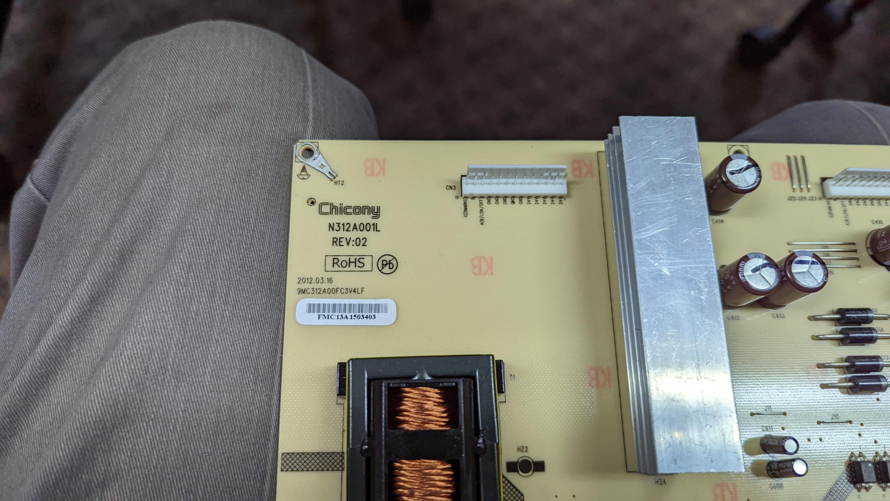

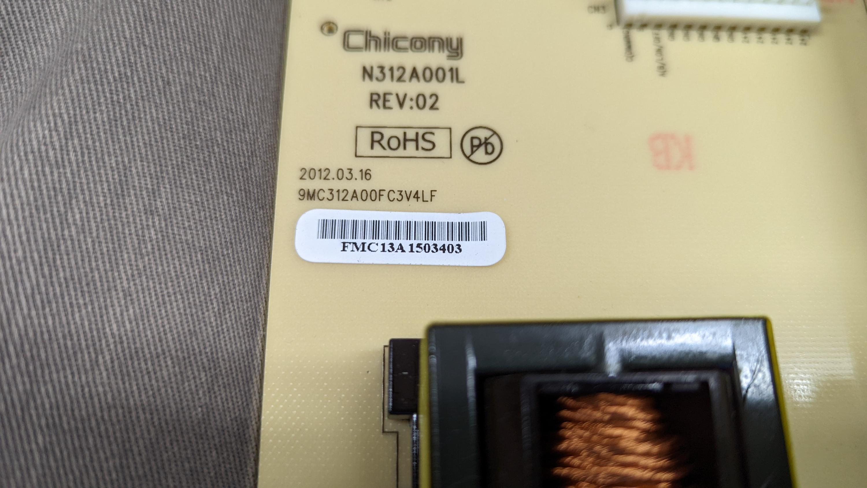

    attaching 6 pis here as the forum said it failed to make the links to the image on GDocs...
    basics: E552VLE no power on, no light, no power at ALL from power board, so nothing to control board.

      I've since removed the PS and controller boards, keeping the interconnections, and brought to bench.
      I could trace everything a lot easier with a schematic, but I guess I have to start drawing the circuits by hand... joy...

        Re: Vizio E552VLE Schematics needed! [no power on]
        Need to see picture of connector legend to mainboard. Probably have a bad mainboard.

            Do you have 5.1 volts on CN2 of the power supply board?
            I have no voltages on any of the connectors where voltage levels are indicated. I have voltage on one side of the isolation transformer, and nothing on the other side-on both boards.
            What isolation transformer are you talking about? You do know that the primary side uses hot ground which is different from the secondary side ground.
              Yay! @R_J I have 5.1V on CN2! I have the board completely removed on bench, no connectors to the main/control board.
              Without the controller board, the 5.1VDC is present continuously on pins 1, 2, 3 of CN2. However, as soon as it powers up with CN2 and CN5 connected, the 5VDC is only present for 4-5 seconds on powerup.
              Unplugging CN5 (+18V) from the power board allows the 5.1VDC to continue on power up. After a few tries w/out CN5. 5.1VDC goes away after only 1 second now... Ain't it great when symptoms change?! :-(
              Progress!
              P.S. I have been over the boards with a microscope, and have tried a different power board, and no change in symptoms. Am I taking the $130+ plunge on a controller board, or does anyone have a schematic so I can t-shoot at component level?
                @R_J,
                "What isolation transformer are you talking about? You do know that the primary side uses hot ground which is different from the secondary side ground."
                There are 2 transformers on the power board, crossing the primary-secondary line. I cannot find them by part number in the Interwebs...

                          I cannot locate this IC, and the numbering doesn't look like the rest. Here are 4 shots, with the 4 and 14 conductor cables being the power ones from the power board...
                          I think this is a link to the folder: link
