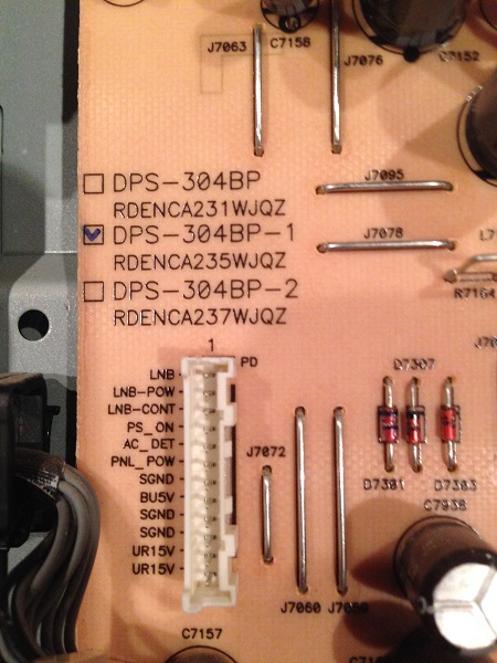

    Upon plugging the set in, it sounds like one of the relays on the power supply board is powering up, clicking and then nothing happens after that. The power and OPC lights both flash once then the power light flashes once more on its own. My research so far has revealed that this indicates a faulty power supply board.
    Not sure if this helps, but if I unplug the main board from the power supply and plug the TV in, the relay on the power board makes no noise at all. No blown caps, all solder joints look good and every connection has been checked. I pulled out my meter and got 5V from BU5V and nothing from PS_ON on the power supply side of the connector leading to the main board.

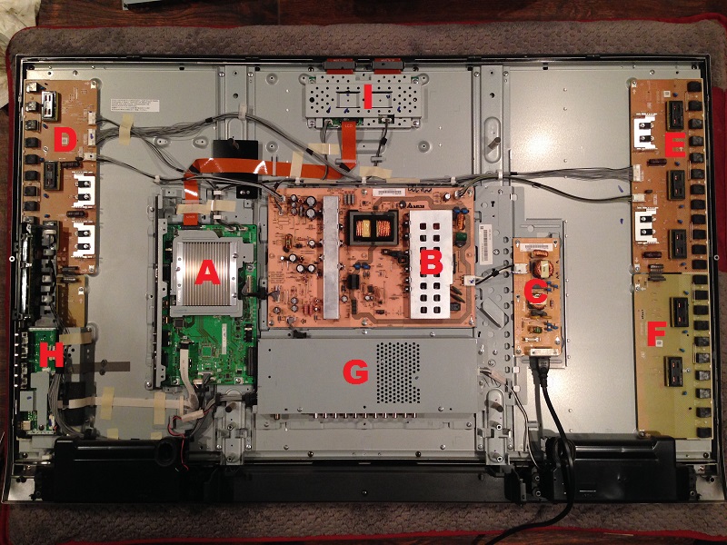

    I snapped some pics of the the whole back and labeled the components for easier identification.

    PS_ON is given by the main board and if you don't get anything there, than it looks like a main board problem.
    I would try forcing on the power supply, to see if the voltages come up and the backlight turns on.

            Report the voltage readings of that connector when TV is OFF and when power switch is activated.

              I have repaired a 65" and it was the master inverter(right one from the back), though I don't know which board it was, because there are three on each side and I have just swapped all three boards on mine.($40 for all six boards)
              Mine it was, a typical two seconds to black.

                        Alright, voltages on mine are
                        PS ON- 2.1v
                        AC DET- 2.29v
                        BU5 - 5.0v
                        PNL POW- 0 at power on then has a burst that goes between 2.9-3.2 before it clicks and shuts off.
                        The 15v is there on the last 2.

                                Just got back in town tonight and checked the voltages immediately...
                                OFF
                                PS_ON - 0V
                                AC_DET - 0V
                                PNL-POW - 0V
                                SGND - 0V
                                BU5V - 4.96V
                                SGND - 0V
                                SGND - 0V
                                UR15V - 0V
                                UR15V - 0V
                                When power button is pressed...
                                PS_ON - 5V
                                AC_DET - 0V
                                PNL-POW - 0V
                                SGND - 0V
                                BU5V - 4.96V
                                SGND - 0V
                                SGND - 0V
                                UR15V - 0V
                                UR15V - 0V
                                That diagram doesnt seem to be much help. Does one cycle constitute when the power and opc flash and then power flashes once more? My continues this pattern forever, there is no break like the digital wave is showing.
                                After comparing Clutch's voltages Im beginning to think my entire power board is fried

                                  It seems like the main board sends the signal to the power supply to turn on, but nothing happens.
                                  5V PS_ON? Seems high, no? Usually is 3.3V or lower.
                                    Re: Sharp Aquos LC-46D64U Help
                                    It's hard to tell with my meter because it happens so fast. It's a digital meter but has an animated analog needle which jumps to 5V so I was just assuming that's what it was.
                                    Went back and cycled it a multiple times and Im getting 2.35-3V when my meter flashes the value.
                                      On the PNL_POW, after hitting the power button, mine stayed at 0v for about 3-4 seconds then it jumps up to 2.9-3.2 right before it clicks and shuts off. Yours doesn't do something similar?
                                        Nothing. Mine attempts to power up for about half a second before the relay on the power board clicks and it's done.
