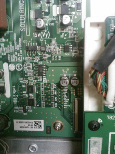

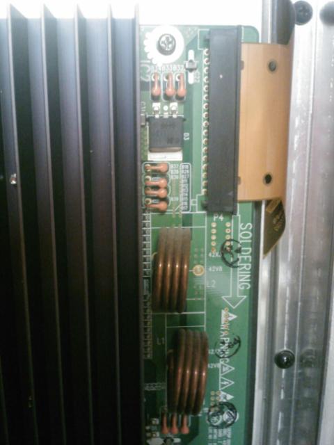

                          Re: Insignia ns-42pdp (lg pdp42x30000)

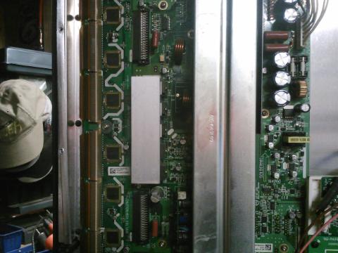

                          That's good then, time to focus on the Y-sustain & Z-sustain then, could you supply a picture of those boards?
                          • DaveL
                            • Sep 2014
                            • 90
                            sure..give a few minutes.
                            • DaveL
                              • Sep 2014
                              • 90
                              Y and Z
                                Any way you can get some bigger photos - I need to be able to see the small test points...

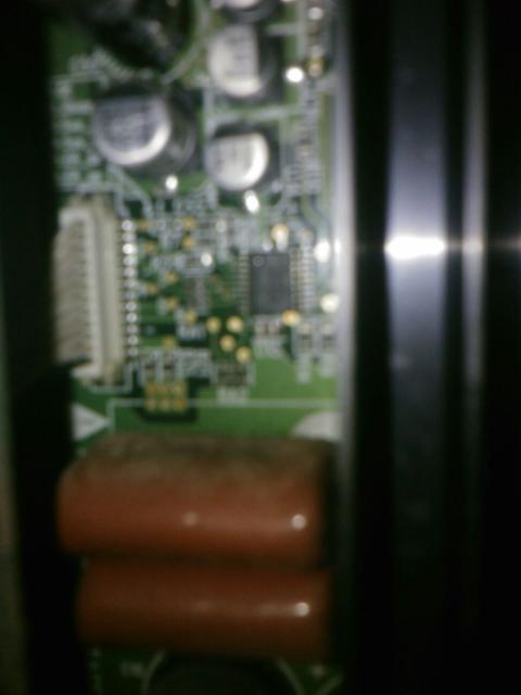

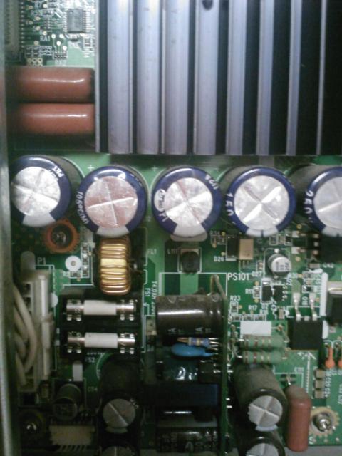

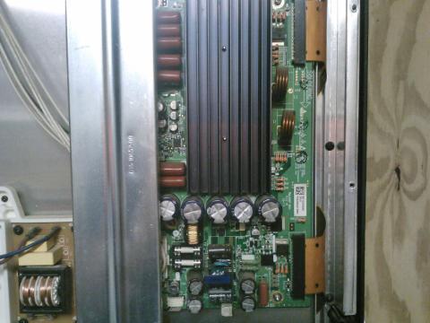

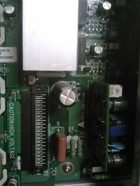

                                  Z board
                                    Unfortunately we really need good pictures to see what might be worth testing... is there any chance you can borrow a better camera...?
                                    • DaveL
                                      • Sep 2014
                                      • 90

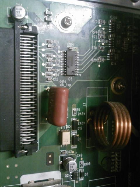

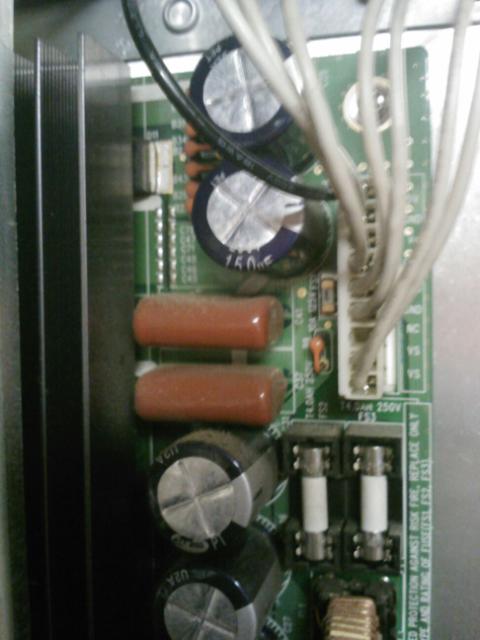

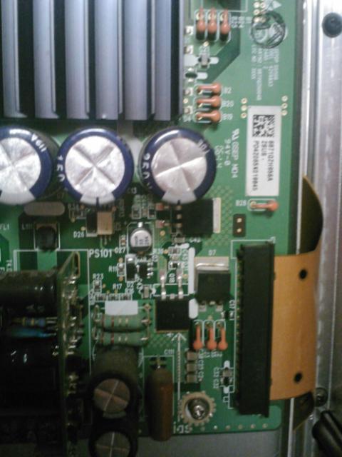

                                      Y board
                                      Are these any better?
