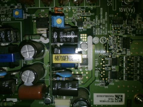

    #81
    Re: Insignia ns-42pdp (lg pdp42x30000)
    Is this what you are talking about?
      #82
      There is a -Vy and Vsc module. The -Vy module should be marked. Yes it's one of those stand-up board things which has lots of other parts on it.
      • DaveL
        • Sep 2014
        • 90

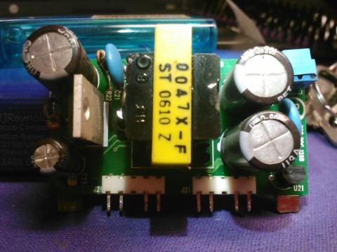

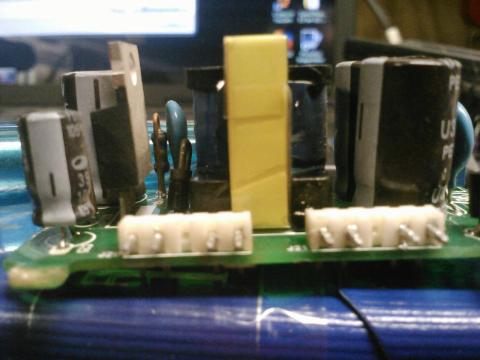

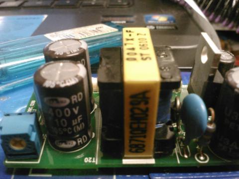

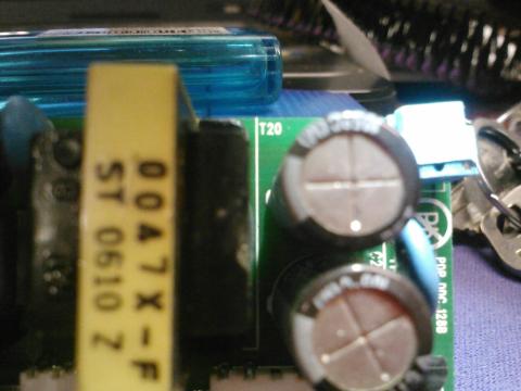

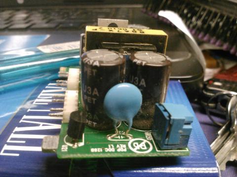

        #83
        Ok...let me remove the board and I'll get it off and get some pics of it...
        • DaveL
          • Sep 2014
          • 90
          #84
          Took me forever to get that board loose!
          • DaveL
            • Sep 2014
            • 90

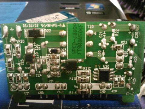

            #85
            B
              #86

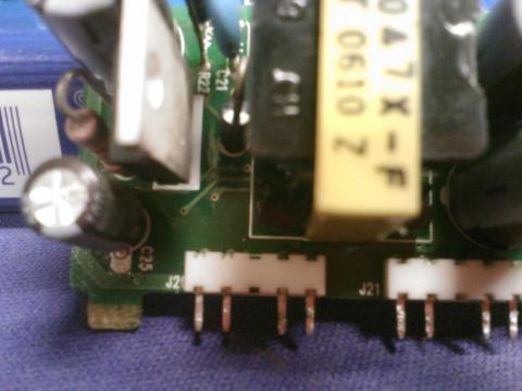

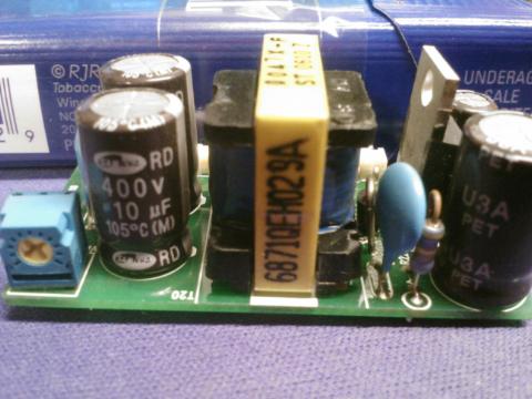

              Ok, worth checking a few things:
              - D22/D23 for shorts
              - C20 solder joints look dodgy
              - Q20 for shorts
              - VR20, between outer two terminals, what do you measure on 200kohm range?
              • DaveL
                • Sep 2014
                • 90
                #87
                D22...490
                D23...496
                C20 are good tight joints
                VR20 outer terminals at 200kohms...1.8
                Q20...
                G:open D:+ S:- no reading
                G:+ D:open S:- reading hits .957 and quickly drops to 0
                G:- D:open S:+ reading 737
                G:open D:- S:+ reading 570

                      #90
                      Sorry for missing your post.
                      Nothing obvious there, I'm afraid. Nothing shorted.
                      Perhaps try replacing the IC "U20"...

                        #91
                        That little black thing? This should be fun...
                        Is there any way of testing it?
                          #92
                          Yeah, the 8 pin part.
                          No easy way to test it, I'm afraid.

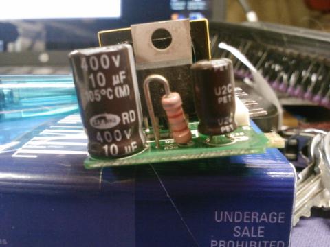

                                    #97
                                    Yes sir, that appears to be the part...
                                    I will get that on order...
                                    The mosfets are on there way and should be here by Friday...
                                    When you say "pin 1 marker", what am I looking for?
                                    To clarify, the caps we are talking about are the three, 400v/10uf /U3A/105*C that are on the module,is that correct?
                                      #98
                                      Those capacitors are them, yeah. What is the diameter and height of them, approximately?
                                      There's usually an indent or a small dot sunk into the packaging of the device. The closest pin to this is pin 1. If there is no indent, then pin 1 faces the bottom left of the device when the half-moon shape is on the left hand side of the device and it's facing up. Also you can usually read the part number this way around.
                                        #99
                                        Also maybe worth replacing the 35V cap too... it won't be expensive.
                                        • DaveL
                                          • Sep 2014
                                          • 90
                                          #100
                                          Looks like the caps are 10mm x 17.5mm
                                          the 35v is 6.3 x 11...
                                          There is a small bar like indention on the face where the numbers are on the chip
