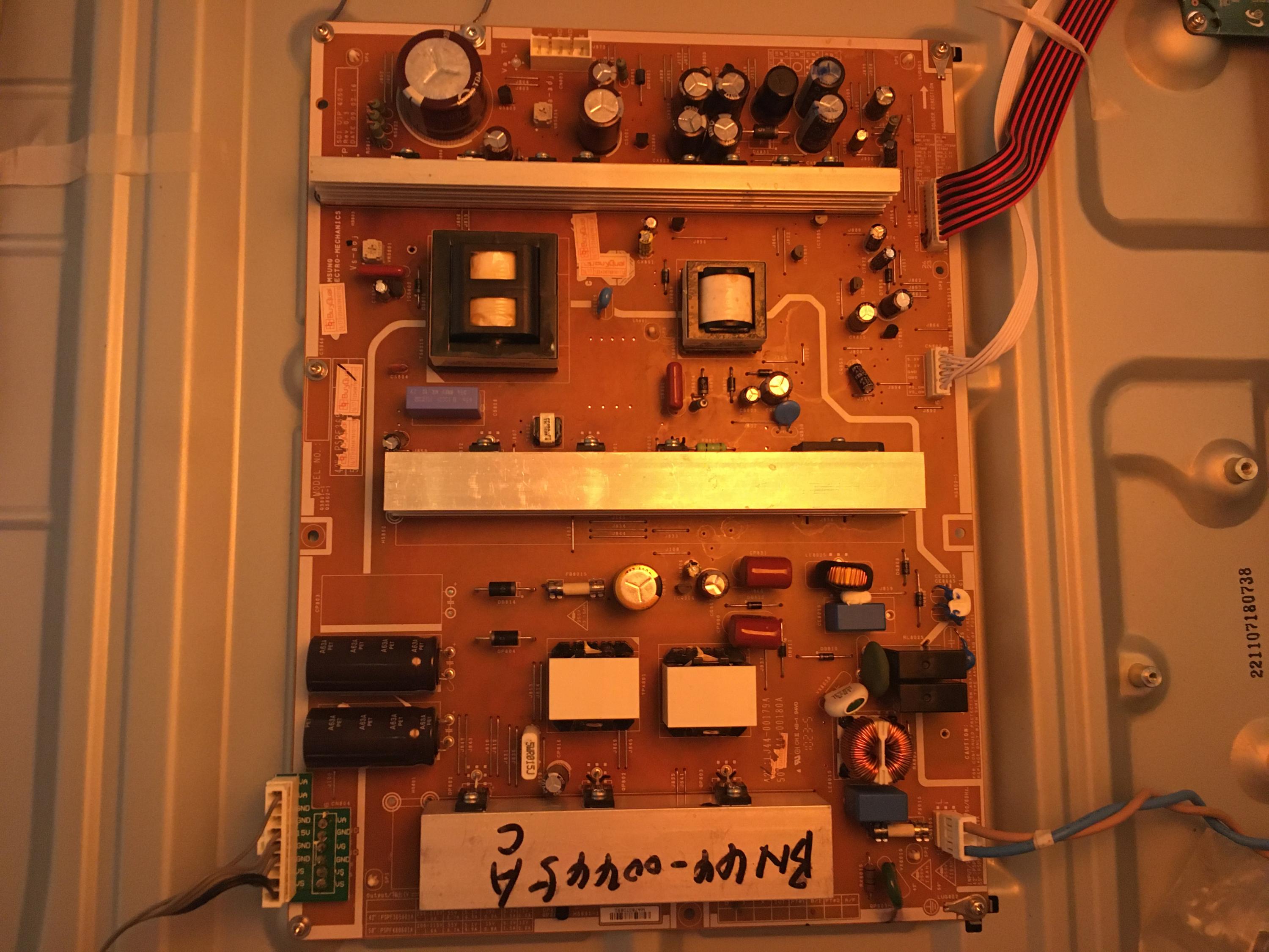

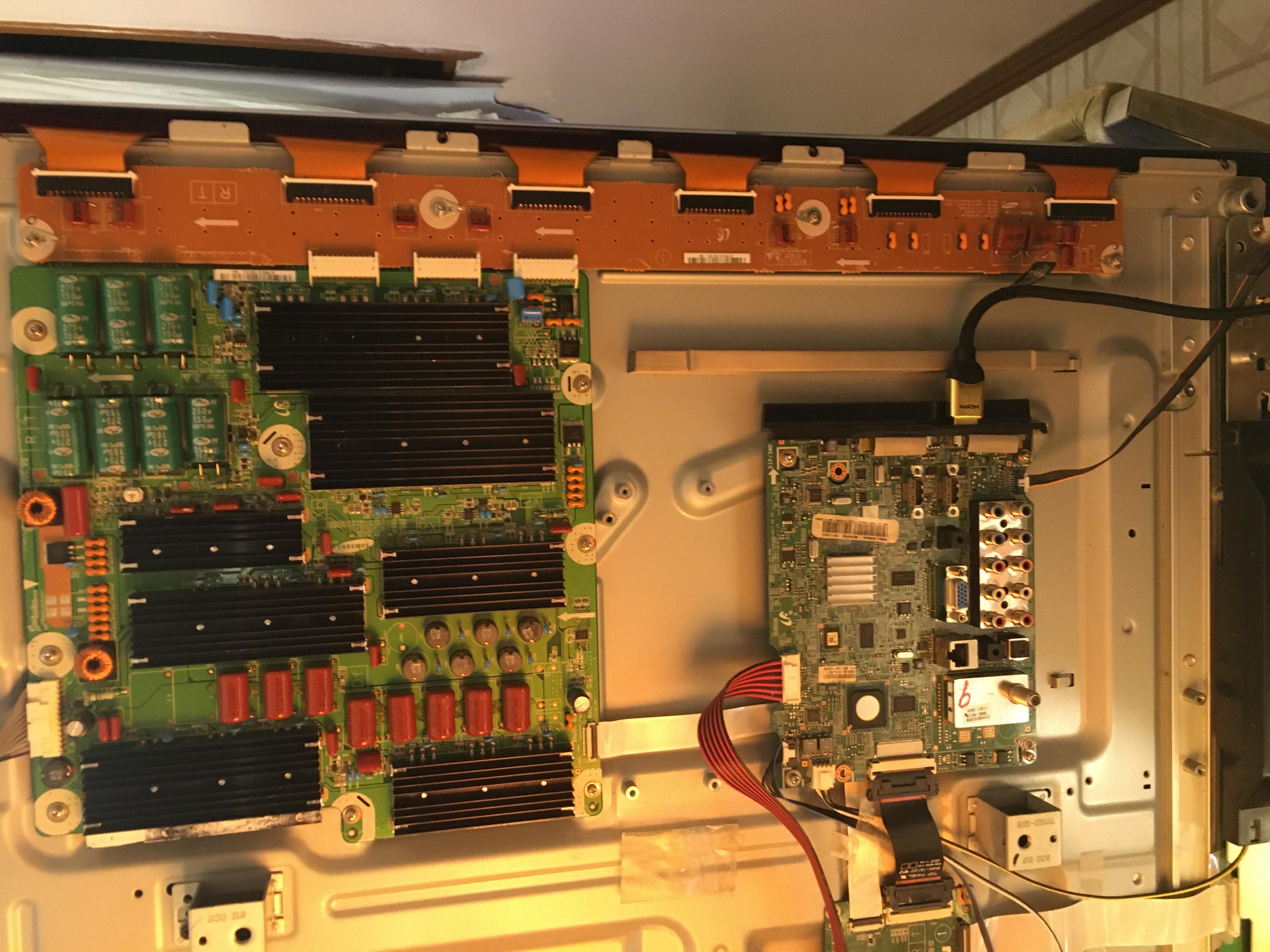

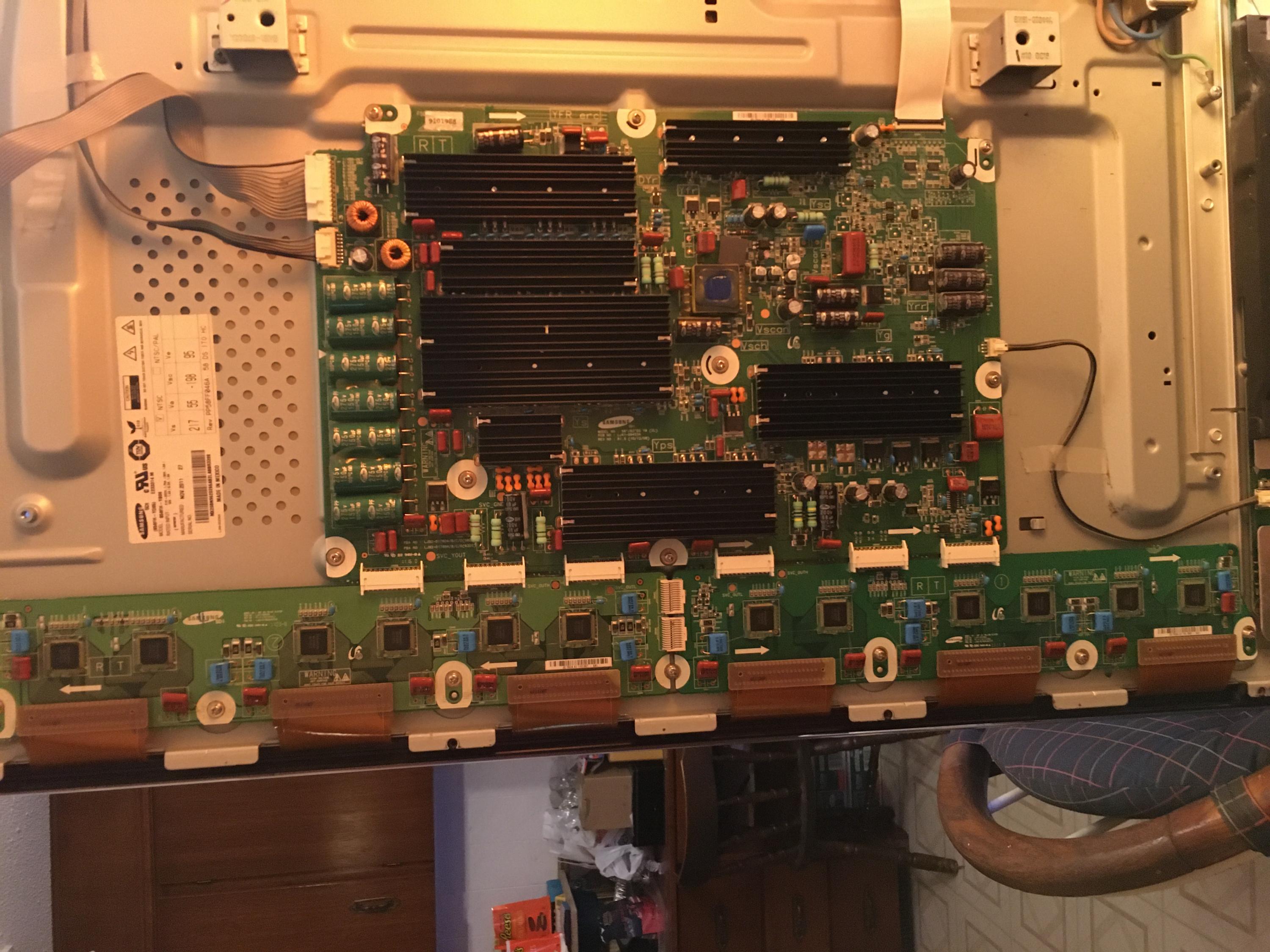

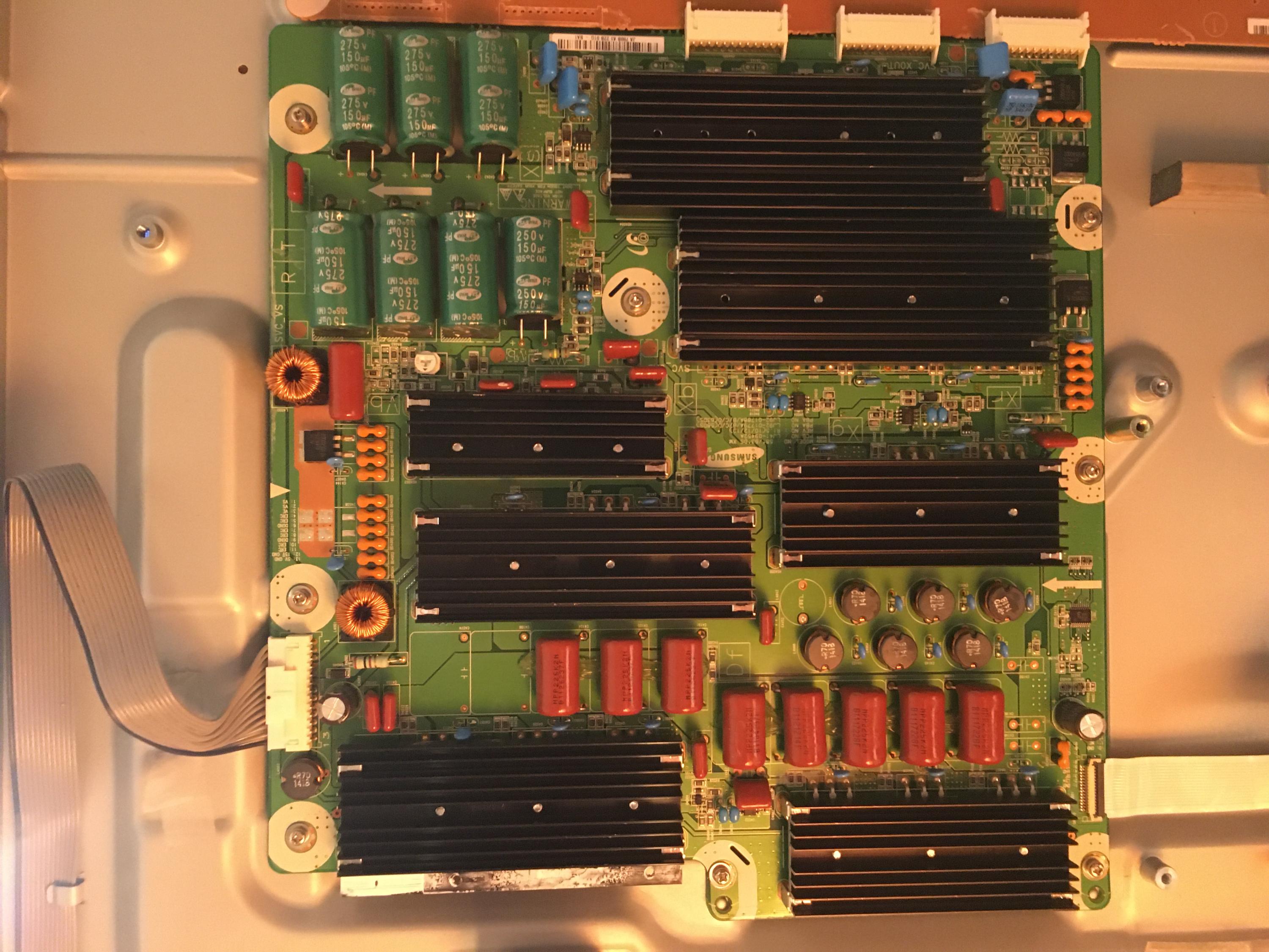

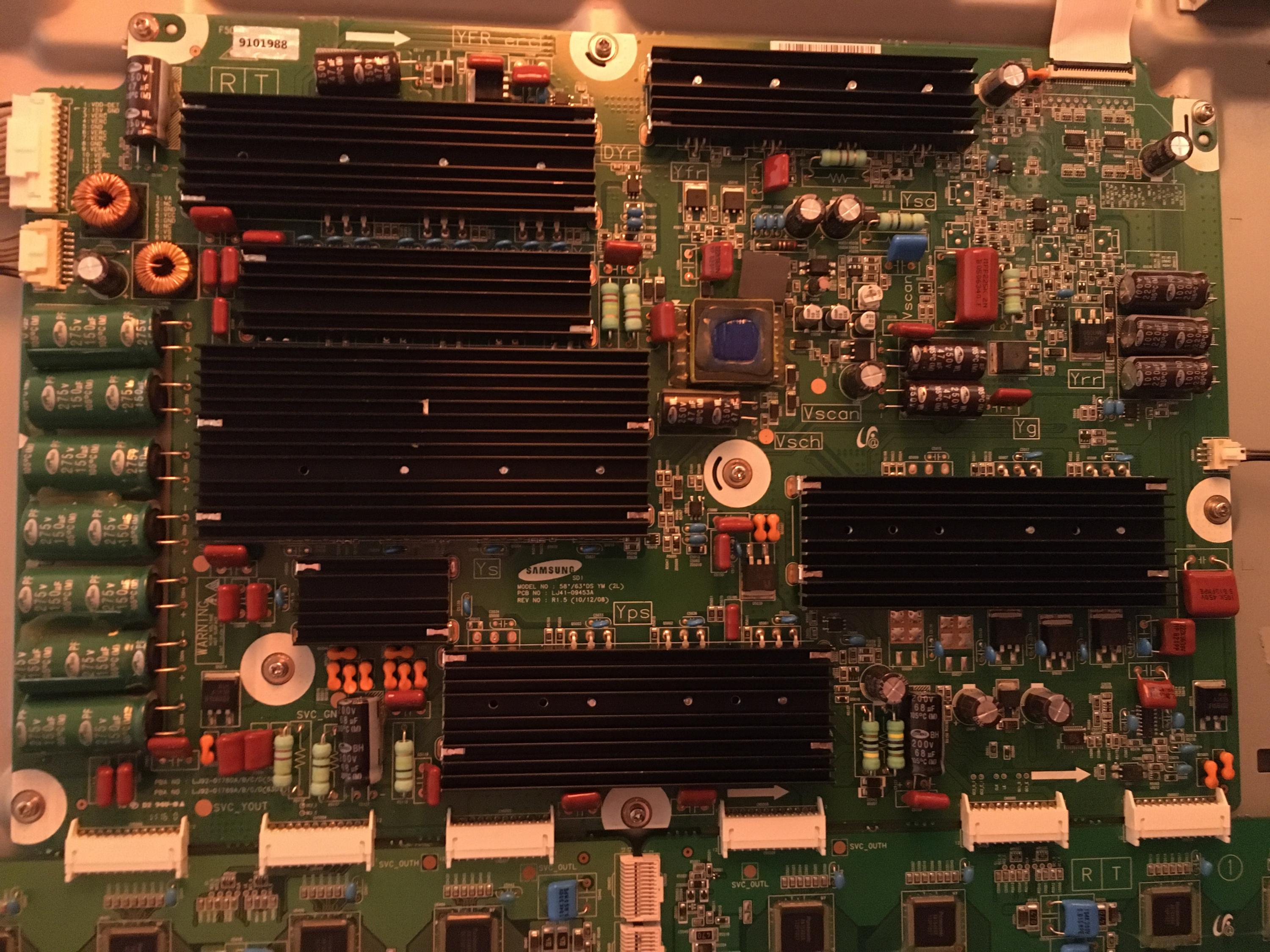

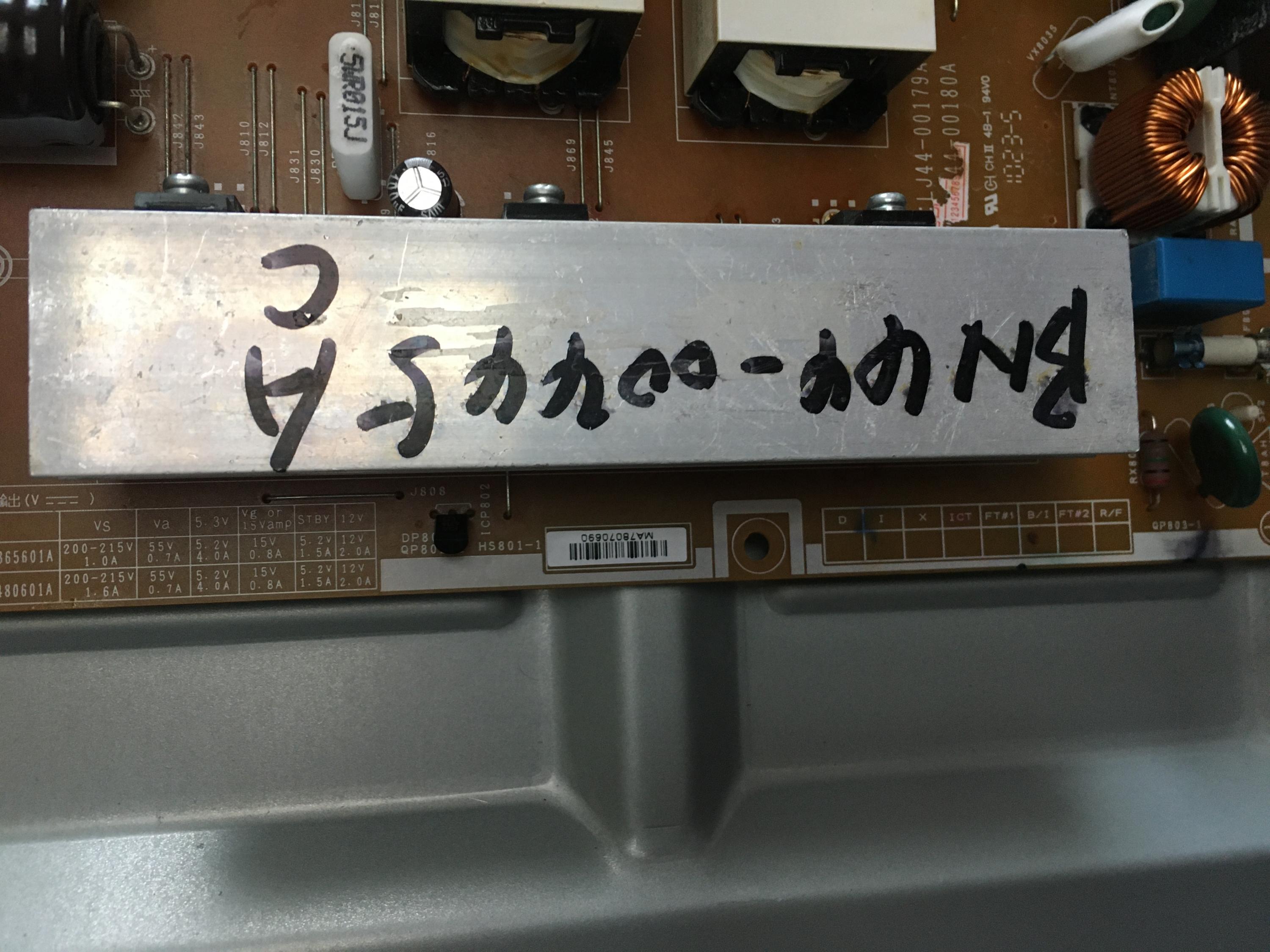

                sorry for the delay, could not figure out how to upload pictures, thank you nomoresonys for the assist.
                here are some pics of the boards, Y-main with and without buffers, main power, X-main with and without buffers.
                Sorry a few are sideways, they orientated correctly when uploaded.
                Thanks in advance, Duane.

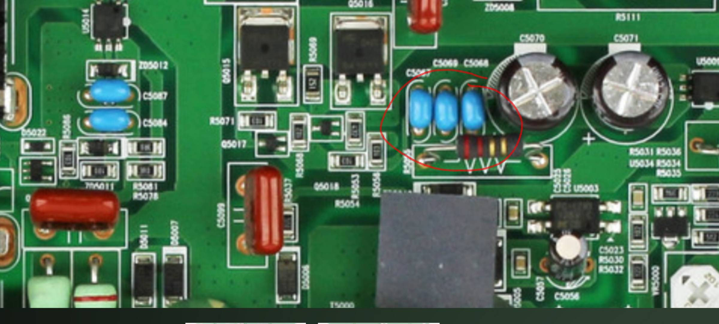

                  Re: Samsung Plazma Blues Model PN59D550C1F
                  Start by replacing these 10uf 50v caps. They are on the y-main board.
                      I replaced the 3 caps, and nothing has changed, the TV works great for a while, then randomly just shuts down suddenly. it will not restart until you unplug the set and plug it back in. It has gone for a week with no issues, to shutting down after a few hours. It is not consistent. I do not know if a short video can be uploaded, I will try to video the TV working and after it shuts down.
