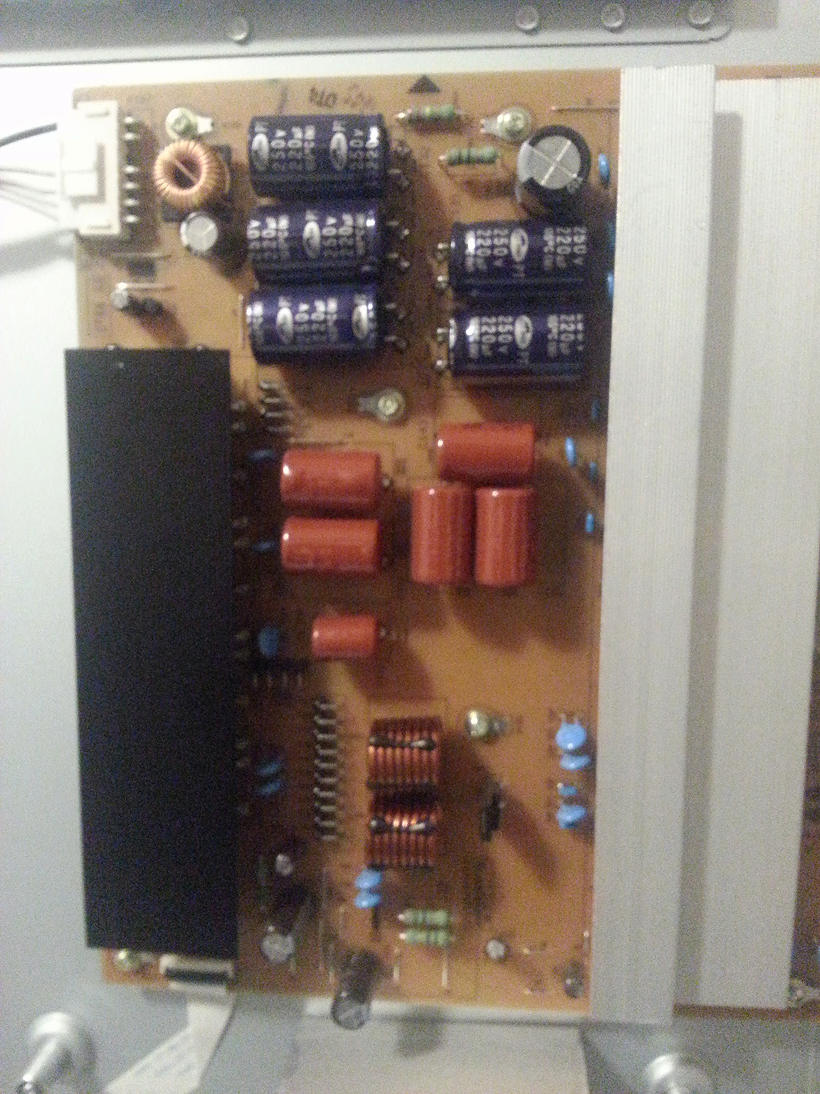

    I have a 60" Plasma that has no image.
    I can hear the volume Up and Down, but has no image at all..

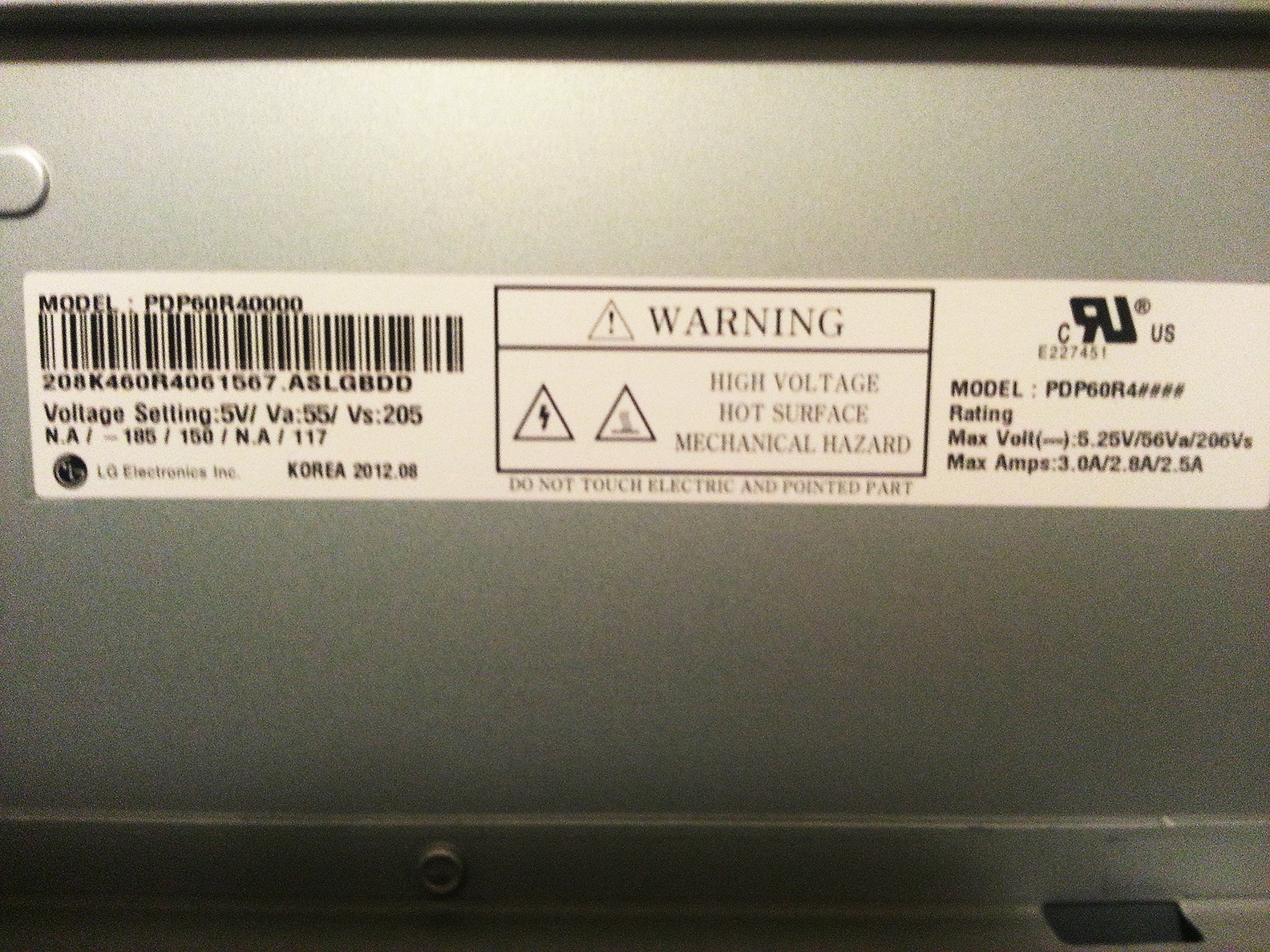

    The model In the white label is PDP60R4XXXX
    I got it that way, so I have no idea if there was some symptoms leading to this problem.
    Thank you in advance for your help, or suggestions.
    Re: 60" LG Plasma 60PA5500 (Sound but no Image)

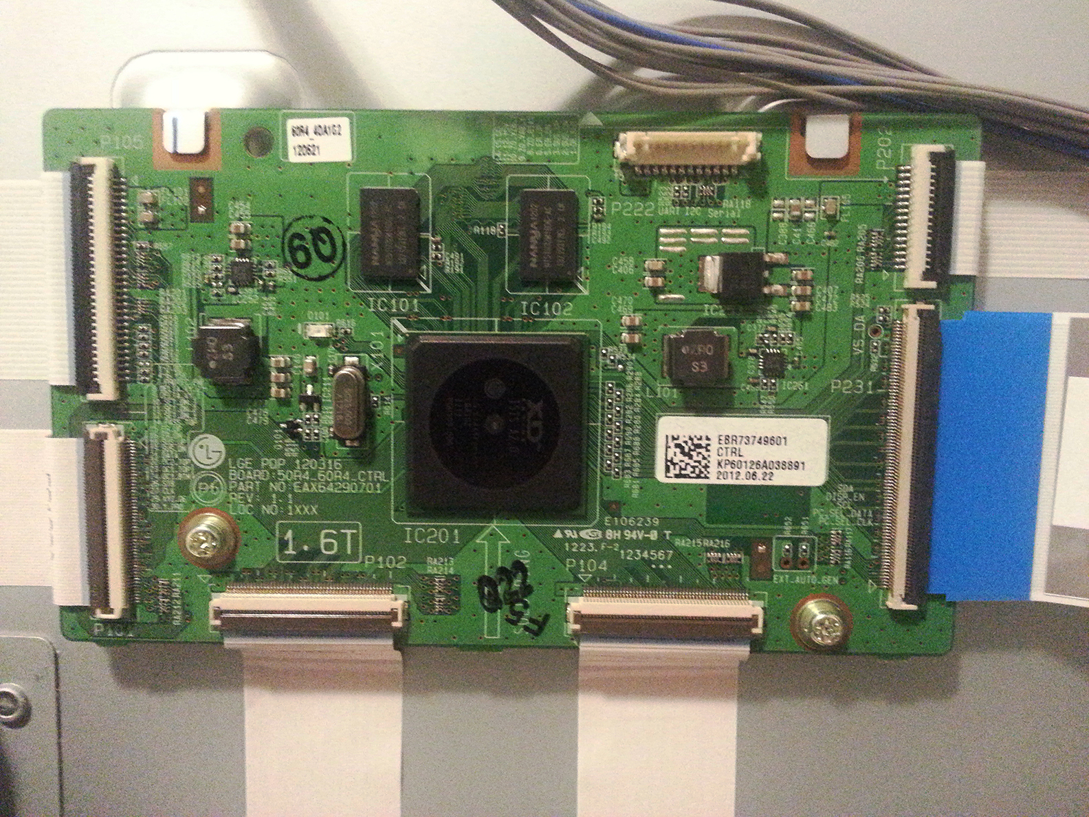

    Disconnect the TOP LEFT green board in this photo (from the white connectors, leave orange ribbons attached.) You will have to unscrew it.
    https://www.badcaps.net/forum/attach...7&d=1412736470
    Does half the picture come back?

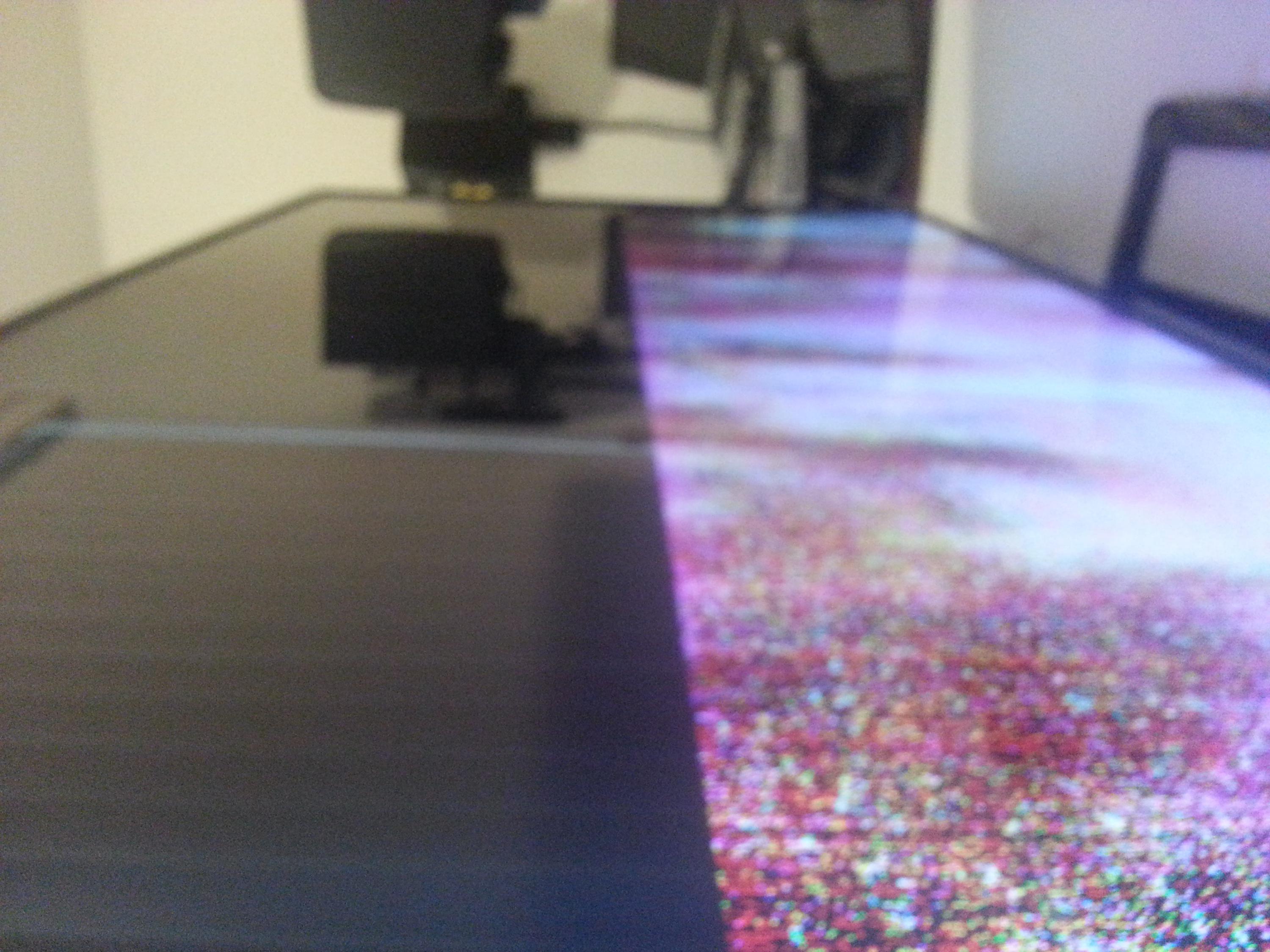

      Thanks for your help Tom.
      Yes half the screen came on.
      I guess that means the buffer needs to be changed?
      Im attaching a picture of the screen.
      • titodj
        • May 2012
        • 39

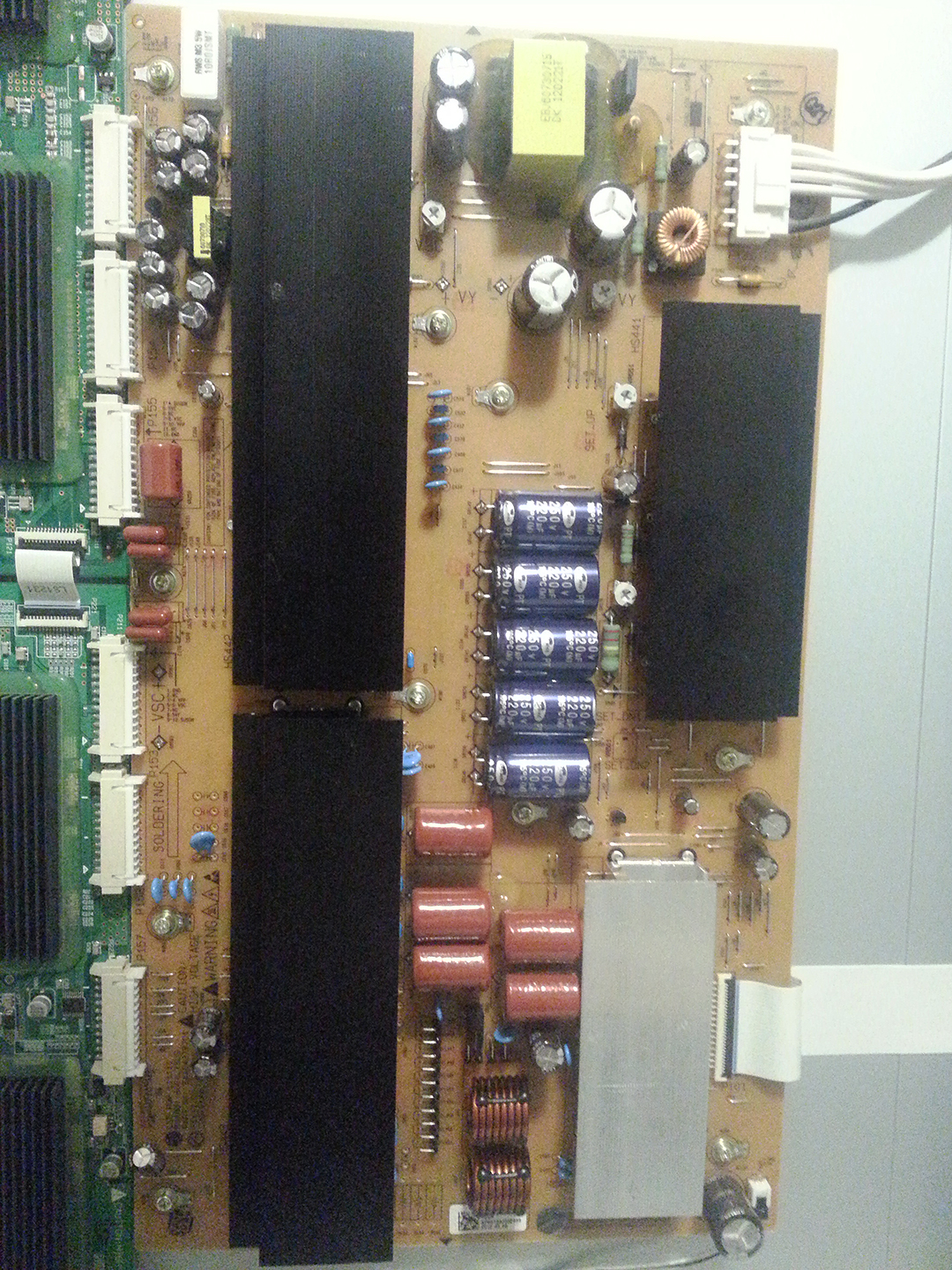

        Thank you VERY MUCH, Tom, I finally got the upper Y buffer, and the TV works perfect, I do have a couple of questions, why did you suspect of the buffer board?
        and in case the upper board had been working, the next step would have been reconnect the upper board, and disconnect the lower board to test?
        Finally, I think it would be a good idea to add those steps in your troubleshooting guide.
        https://www.badcaps.net/forum/showthread.php?t=18542&
        Thanks again....
          Hmm...
          You should be aware of a problem with these sets. The plastic "nubs" on the side of the frame near the orange flatflex connectors to the panel can cut into the ribbons.
          If this happens, it WILL KILL the plasma panel and the Y-buffer board! So you should REMOVE these as soon as possible to prevent this failure occuring.
          I'm quite surprised that it was actually just your top buffer. Usually, the failure mode is a dead panel which then kills your top buffer. So I was going to say be very careful when installing it, as you could blow up the new board.
