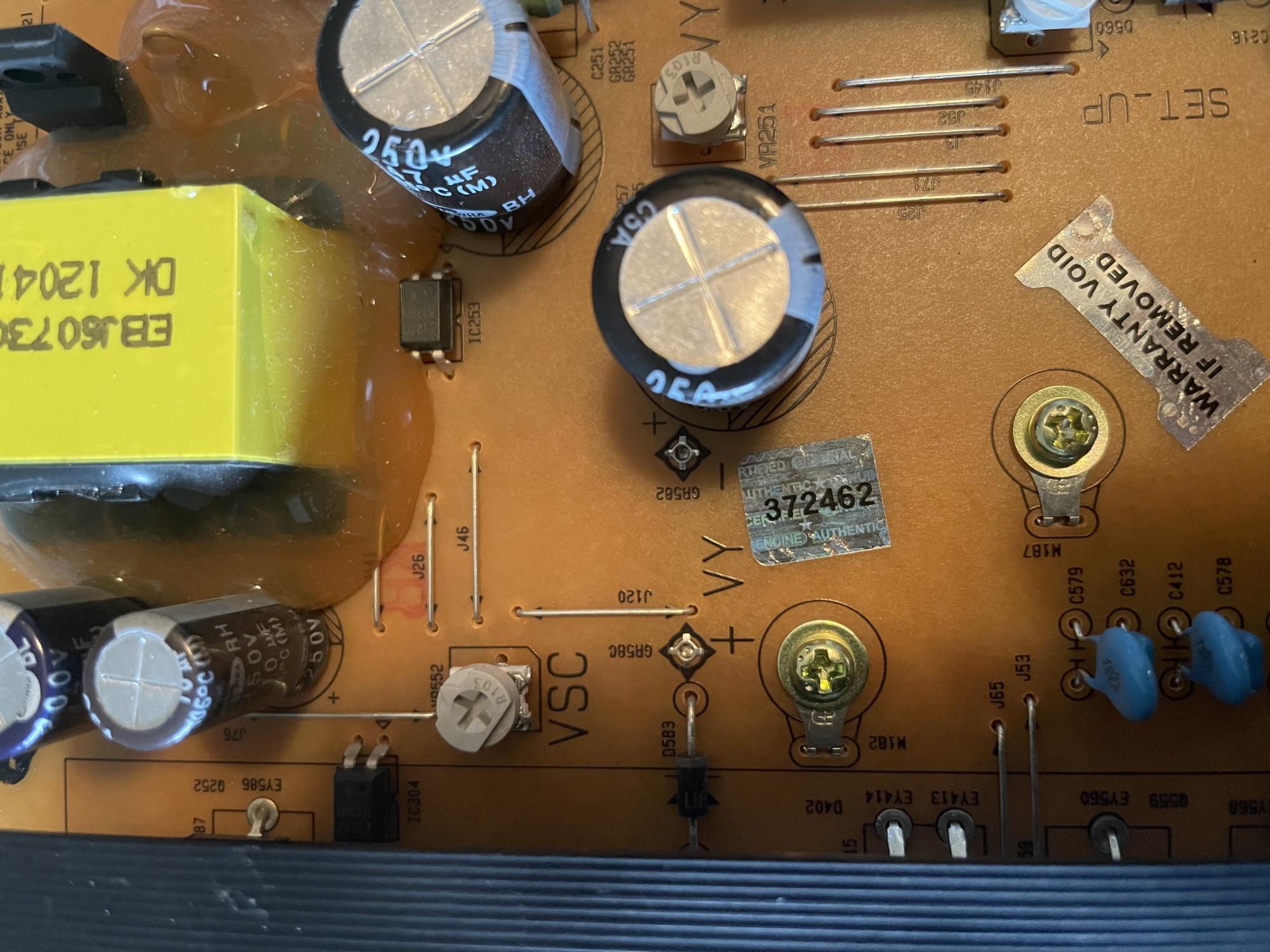

              So I checked the points; readings are below:
              VA....55 vdc
              VS.....205 vdc
              ZBias....2 vdc ( suppose to be 120vdc)
              -VY....-10 vdc ( suppose to be -190 vdc)
              VSCN..... could not find test point
              I have attached a picture of the-VY testpoint I used and wanted to ask if it is the correct place to test.
              So looks like too low of voltage; I'm assuming a bad y board?

                #47
                Re: 60" LG Plasma 60PA5500 (Sound but no Image)
                Are you testing between the + and - pins? Do not measure VSCN and -VY in relation to the ground, if these voltages are not up, control board is taking them down, what about during startup? If they are correct for a moment then it's something else.

                  #48
                  I put one of the probes on the -VY and the other lead on the ground of the tv. Is that right?
                  • Biruslapio
                    • Nov 2013
                    • 552
                    • Brasil
                    #49
                    no, that's exactly what is not to be done, there's a + and - on that picture you sent last, same for VSCN, two "grXXX" to put the leads on.

                      #50
                      Ok thanks for the direction to follow.
                      So, I checked the -VY and getting a reading of mostly 18 vdc; the voltage consistently changes anywhere from no voltage to 29vdc. At power up the most the voyage read was 30vdc.
                      The VSC terminals read from 1.5 vdc to no voltage. At startup it started up with a reading of 50vdc, then 120vdc then back down to 1.5 vdc.
                      I didn't see a VSCN terminal; would you know where it is?
                      So knowing the voltage results, is it leaning to the logic board or is there something more I could check or do? Thanks

                        #51
                        VSC = VSCAN = VSCN, it's just that some brands use VSCN, sometimes VSCAN on different models.
                        At this point I would probe all the IGBTs, MOSFETs and diodes, P105 optocouplers and gate resistors for transistors on both Z-SUS and Y-SUS.
