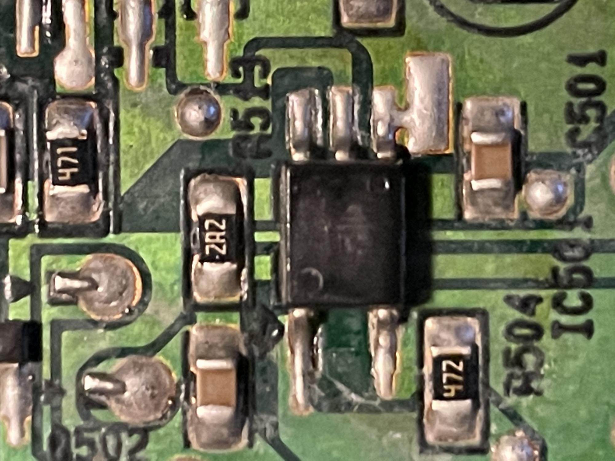

              Hi, I have the same TV and my Y-SUS has a fried SMD resistor, could you provide me a picture or tell me what value it is?
              https://www.badcaps.net/forum/showthread.php?t=94627
              If I get mine working I can guide you better to what's happening with your set.

                Re: 60" LG Plasma 60PA5500 (Sound but no Image)
                I attached a close up picture but cannot see any numbers on it.
                If I unplug the power cable and logic board ribbon cable the tv turns on and has sound only, so which leads me to believe it's shorted.
                  Thank you! It's a 2R2 then.

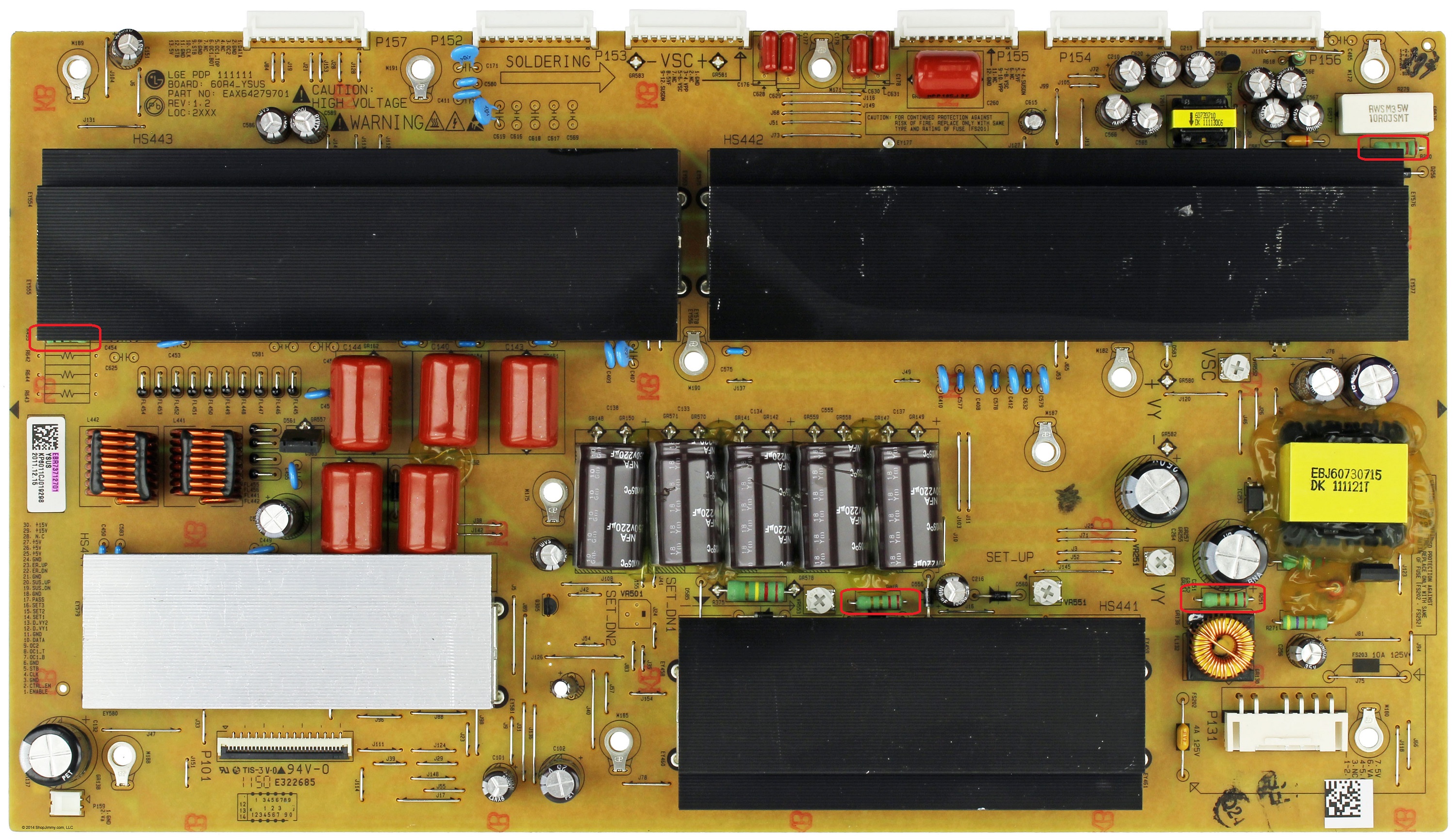

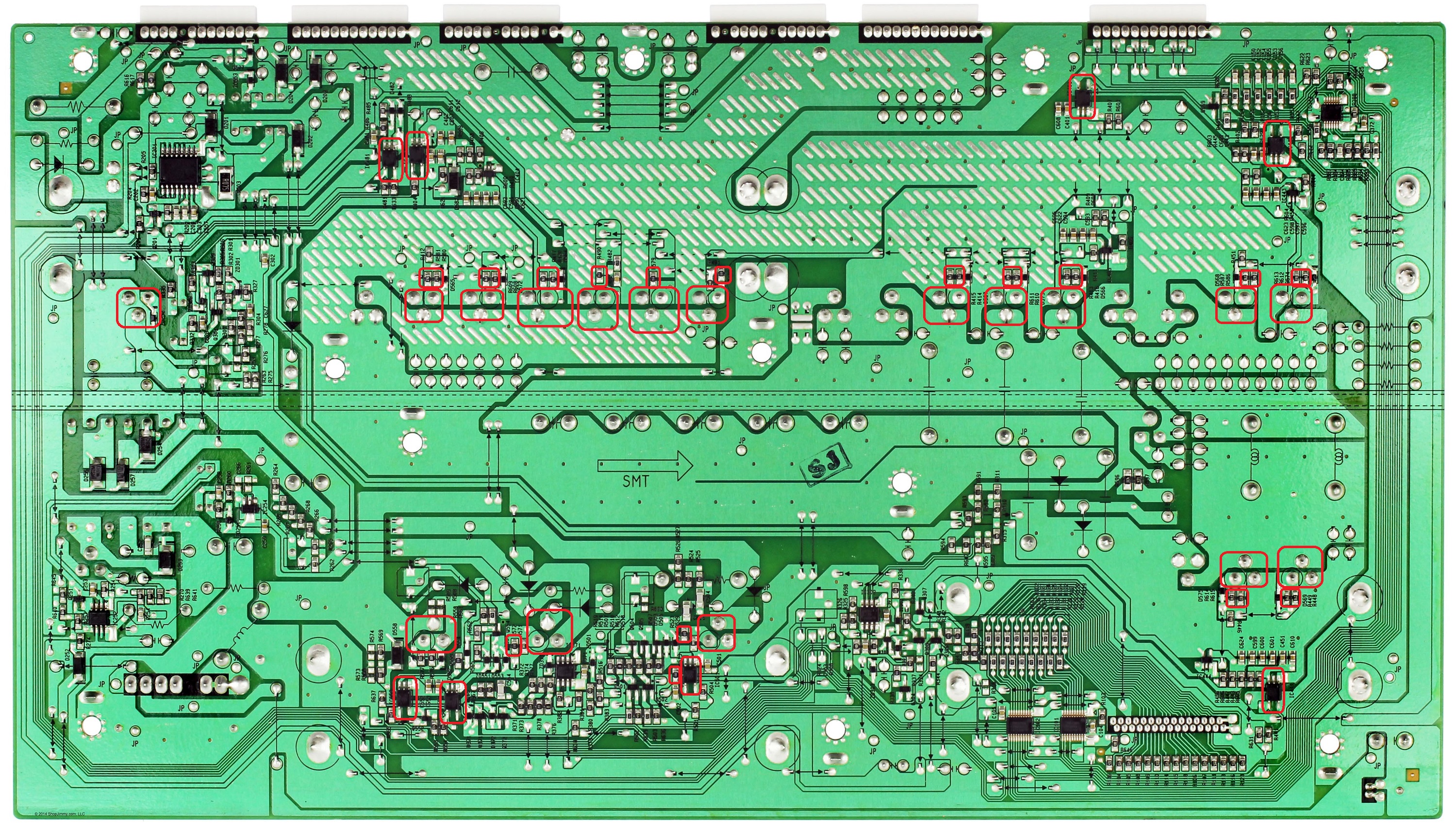

                        I think the buffers and Y-SUS are the primary problem, the logic board should blink when the TV is on, remove both buffer boards from the TV and test Y-SUS + logic board + Z-SUS plugged in.
                        Powering on the Y-SUS with defective buffers will damage it.
                        I've uploaded pictures of both sides of the board with poorly circled points of interest.
                        First I've circled all the transistors that are on the heatsinks, they should not read short between any of the pins, most likely to fail are the 30F126 and RJP63K2.
                        All MOSFETs and IGBTs have gate resistors, if the transistor shorts, often these resistors have a current surge and go open-circuit, they're usually 10, 15 or 27 OHMs in parallel.
                        Those P105 SMD optocouplers that have 5 pins, they drive the transistors gate pulses and can short between pins too.
                        There's these 2W 2R2 PTH resistors on the component side, they act as fuses, when IGBTs go bad, they open too.
                        These are the most common failures on LG PA series Y-SUS.

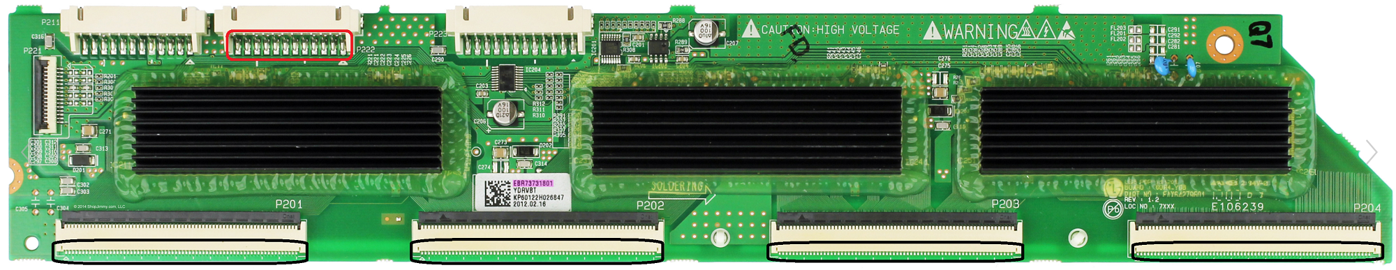

                                Do not measure to ground, measure between the pins of the mosfets themselves, no shorts, it's fine.
                                Buffer test: Multimeter in diode mode, positive lead on buffer floating ground, negative lead on the output pins that connect to the panel, any shorts is a bad buffer chip. There's a handful of videos on youtube showing how to do that, search for "test plasma buffers".

                                        #39
                                        This, where it's circled red use the positive lead, black = negative, will give you ~0.7V forward voltage, any less than that or if it's measuring less than MegaOHMs it's defective. Sometimes it's just one or two pins that short, so it's hard to pick up with a slow multimeter.

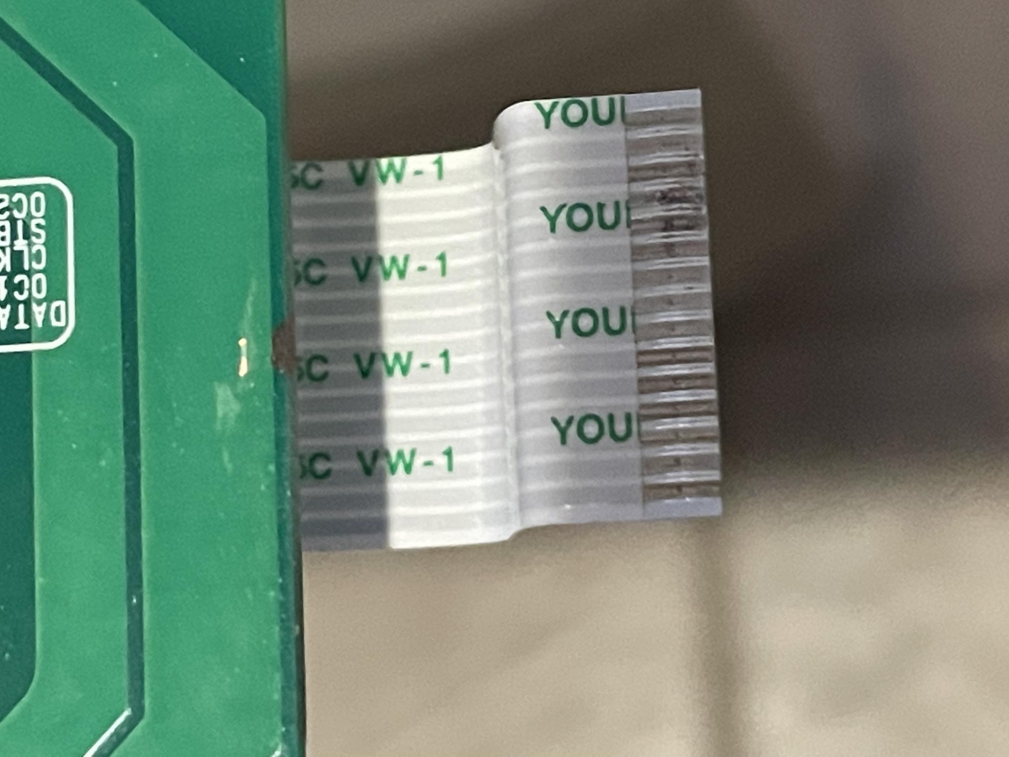

                                          #40
                                          Surprisingly I checked both boards in the same way and did not find any shorts; unless I did something wrong.
                                          I have attached a picture of the ribbon where it shorted to ground; looks to be the 4th one in on the upper y buffer when upside down. Not sure if that helps any.
