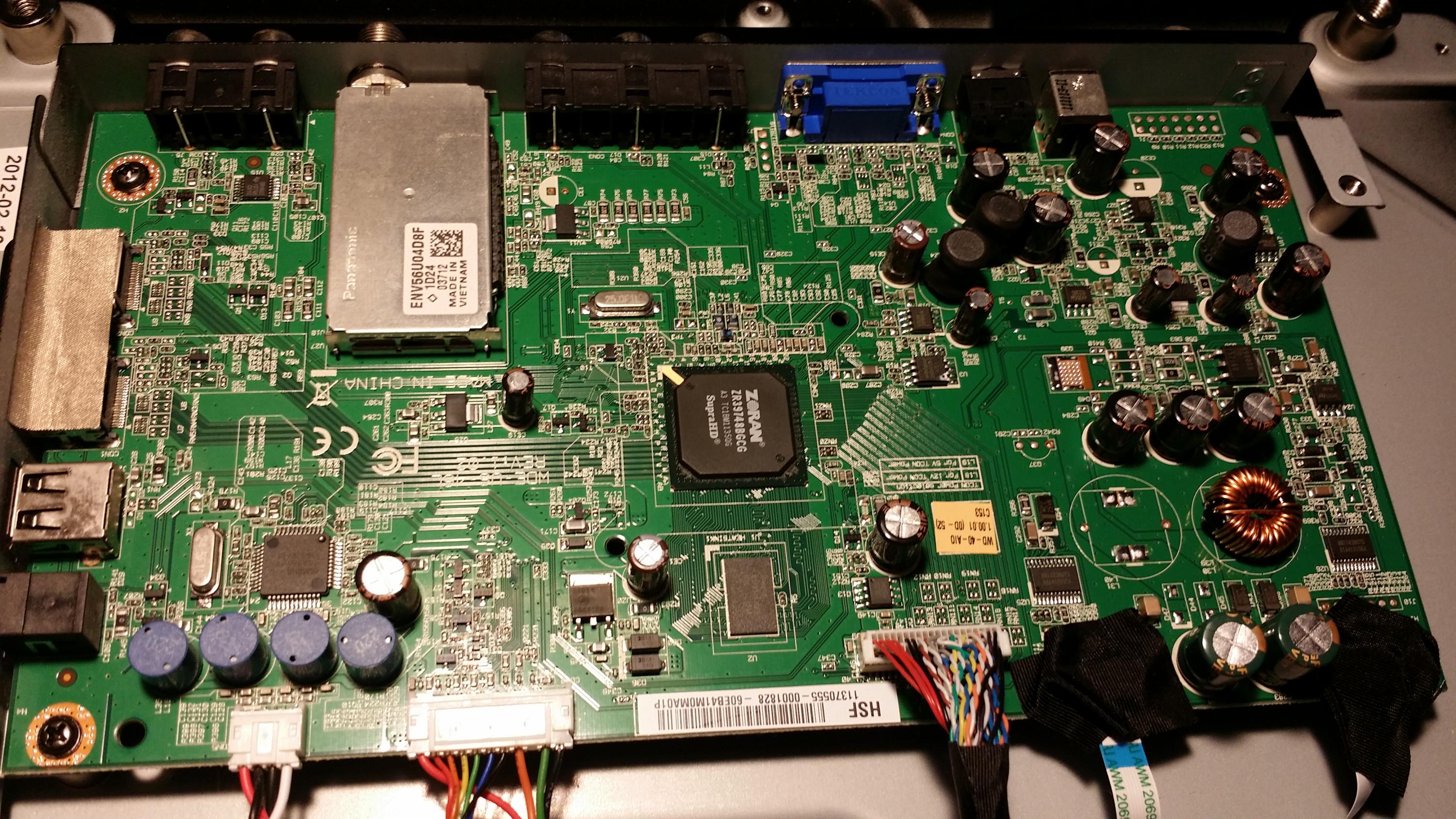

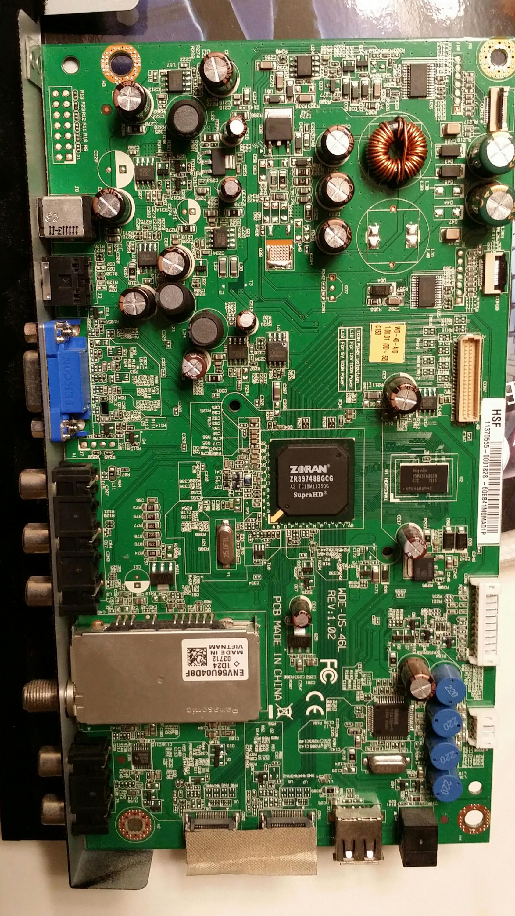

    WestingHouse UW40TC1W wont turn on

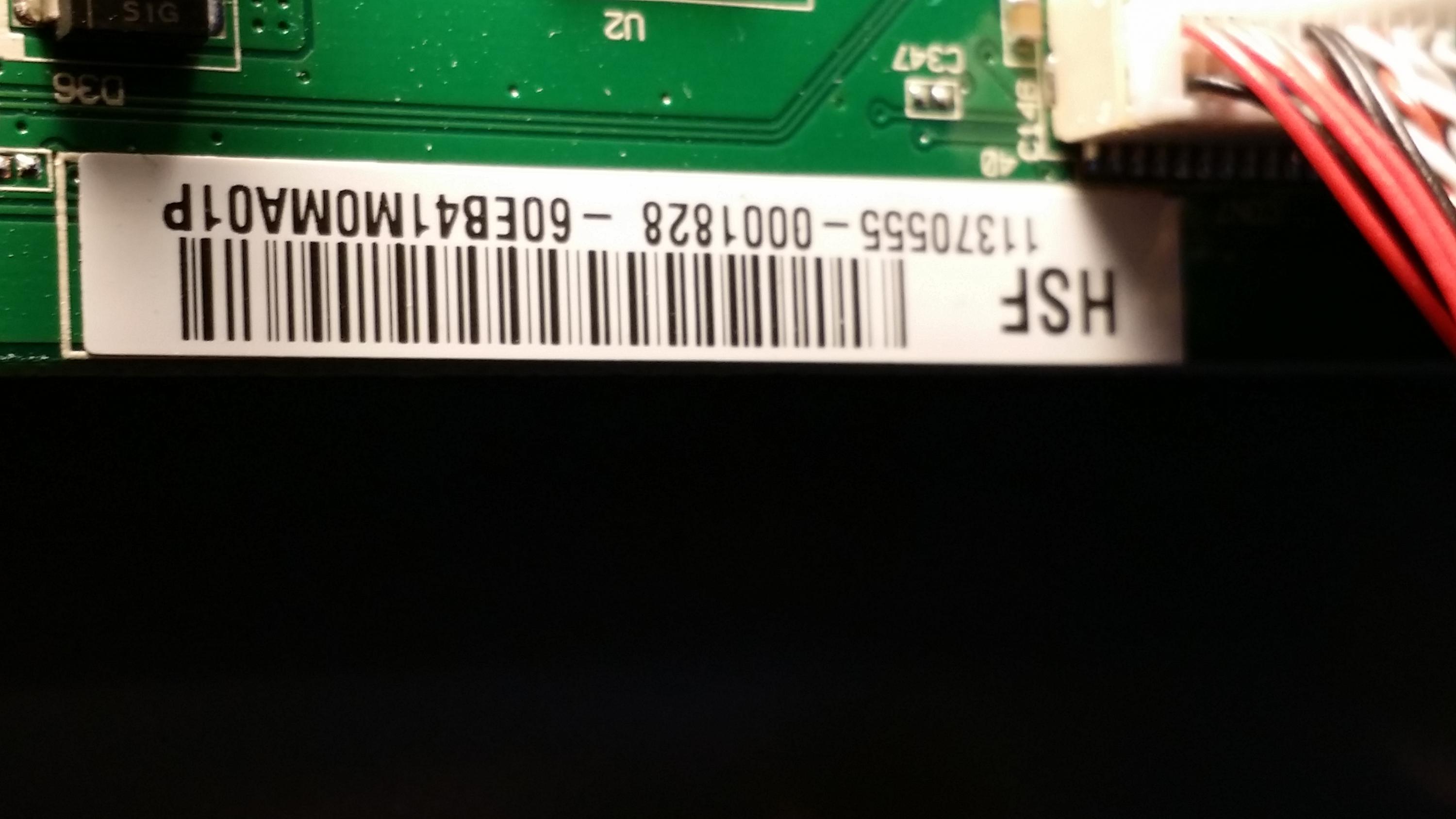

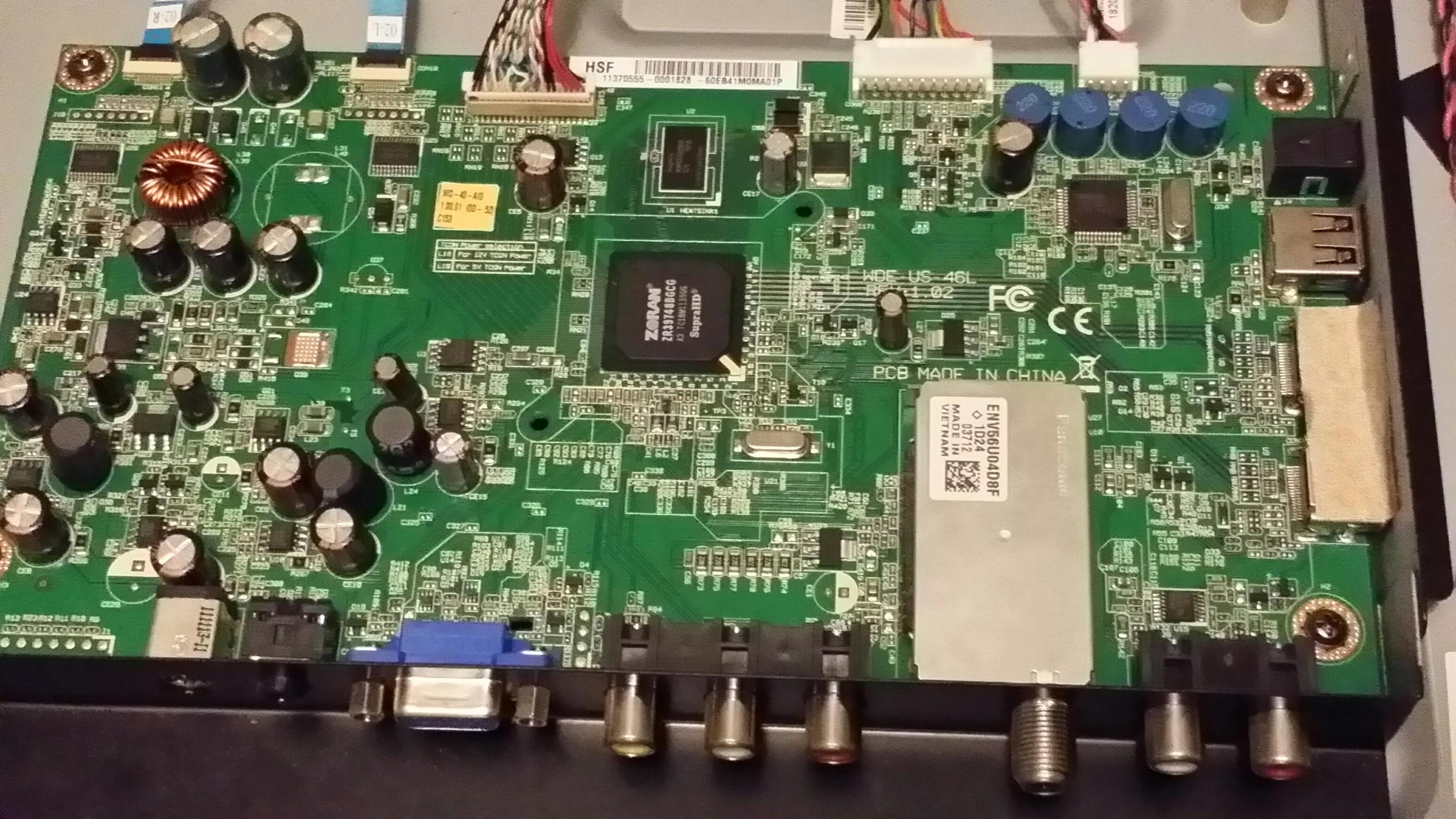

    I was just given this 40 LCD super thin LED tv. I brought it home and first thing I did was test the external brick power supply. it has the proper voltage and when I plug it into the tv. I get a red light on the digital audio out. but it does flicker a little. I get a red led just under the middle center bottom of the tv. that stays lit for about 2 seconds and then goes out. about another 30 seconds and the red led lights up and stays lit. when I search on the web it talks about a EEPROM. could that be all that is bad. does anyone have a service manual on this unit so I can test some of the voltage regulators. the front touch panel that turns on and off the tv and changes inputs and channels does not make any changes. thanks for your help.

    Re: WestingHouse UW40TC1W wont turn on
    Sorry, no manual, but here are a couple things to start with:

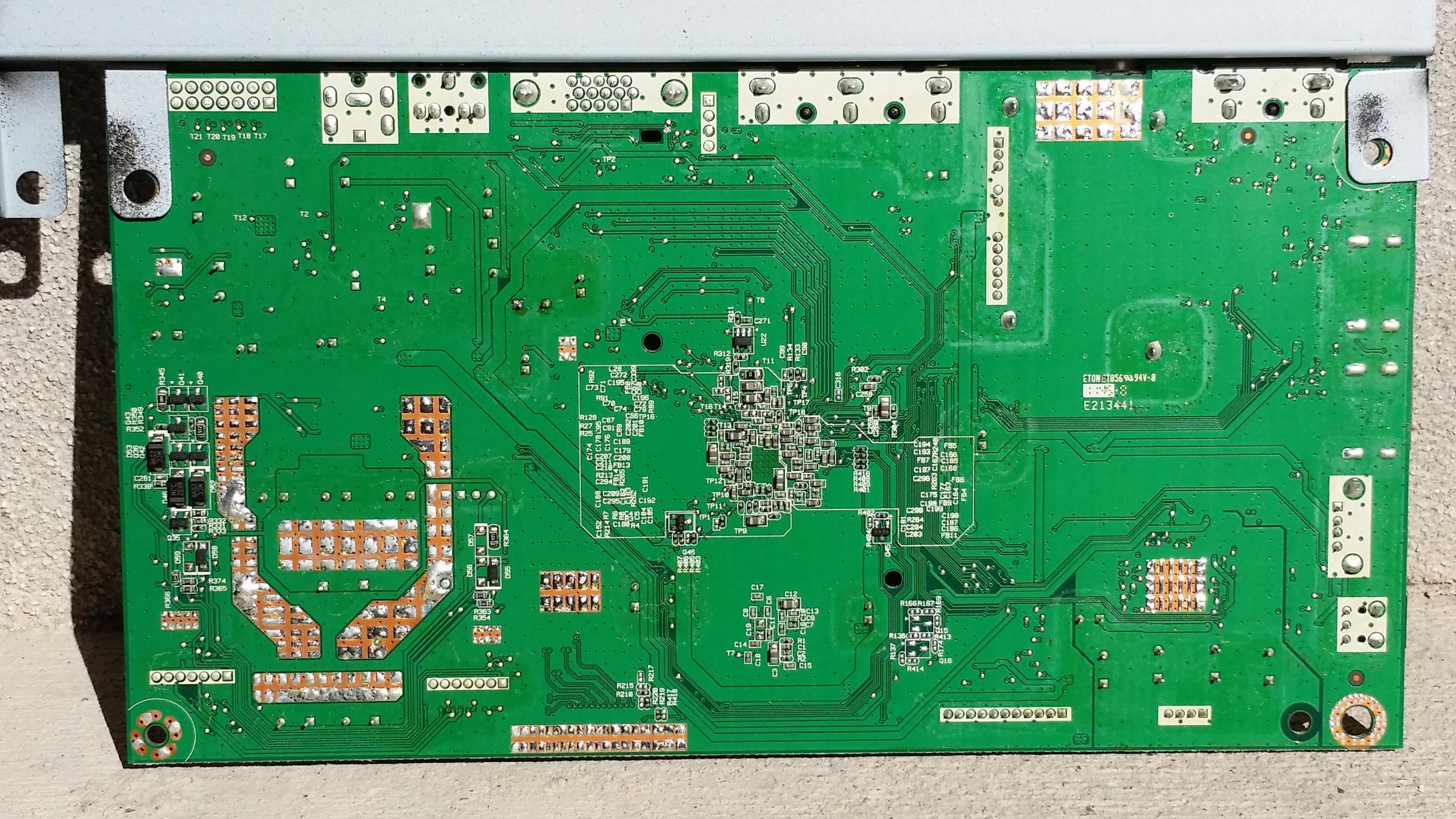

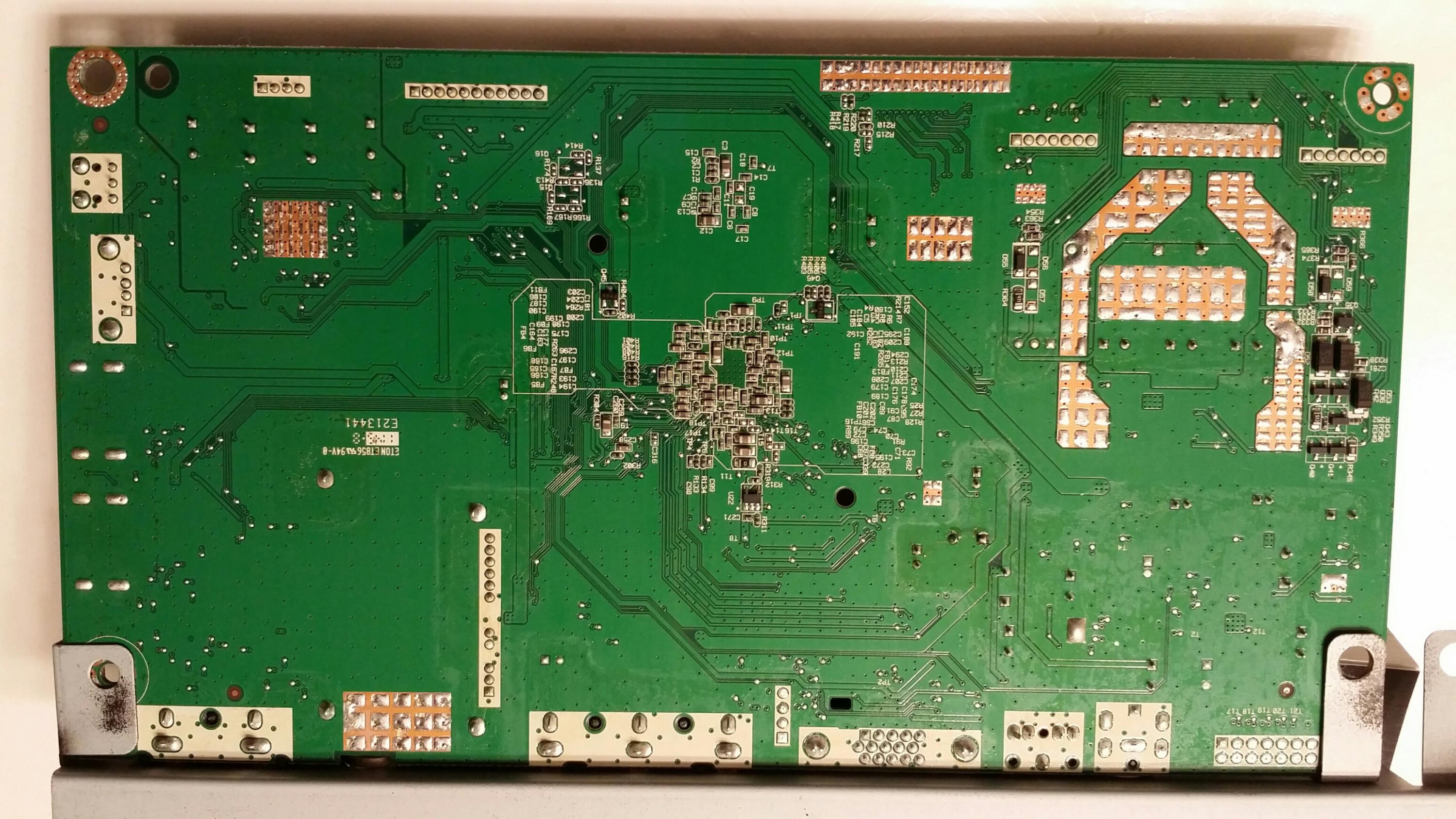

    I can't tell for sure with the first picture, but one of the caps in the top right cluster looks like it might be rounded (bulged) on top. Look closely at the top of all the caps throughout the set and see if there are any that are rounded instead of flat on top, or, misshapen in a any way.
    Then, do a thorough visual inspection of both sides of all the boards.
    Finally, look for connectors that list the various voltages and see if those voltages are present during that two-second window when you try to power it up. Keep in mind that many sets will only allow a few failures before they go into a state that doesn't even do the two-second test. You may need to totally disconnect the set to reset that count.
    This should give you a couple places to look, for now. Maybe someone else will chime in soon to help.
      See the connectors on the lower right of your first picture? Unplug them one at a time and see if it will turn on. These sets are known to short those cables where they wrap around the LED strip.

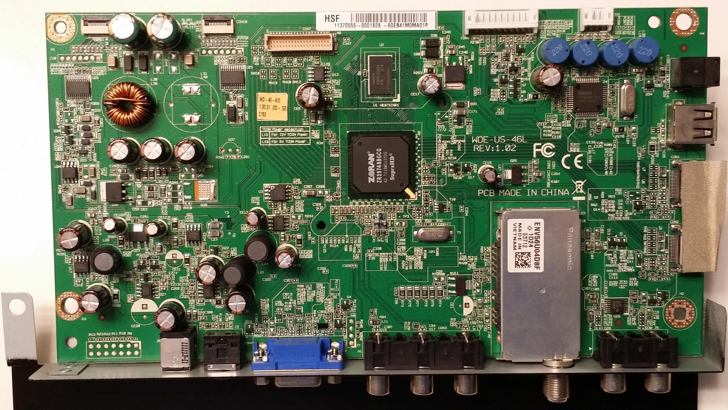

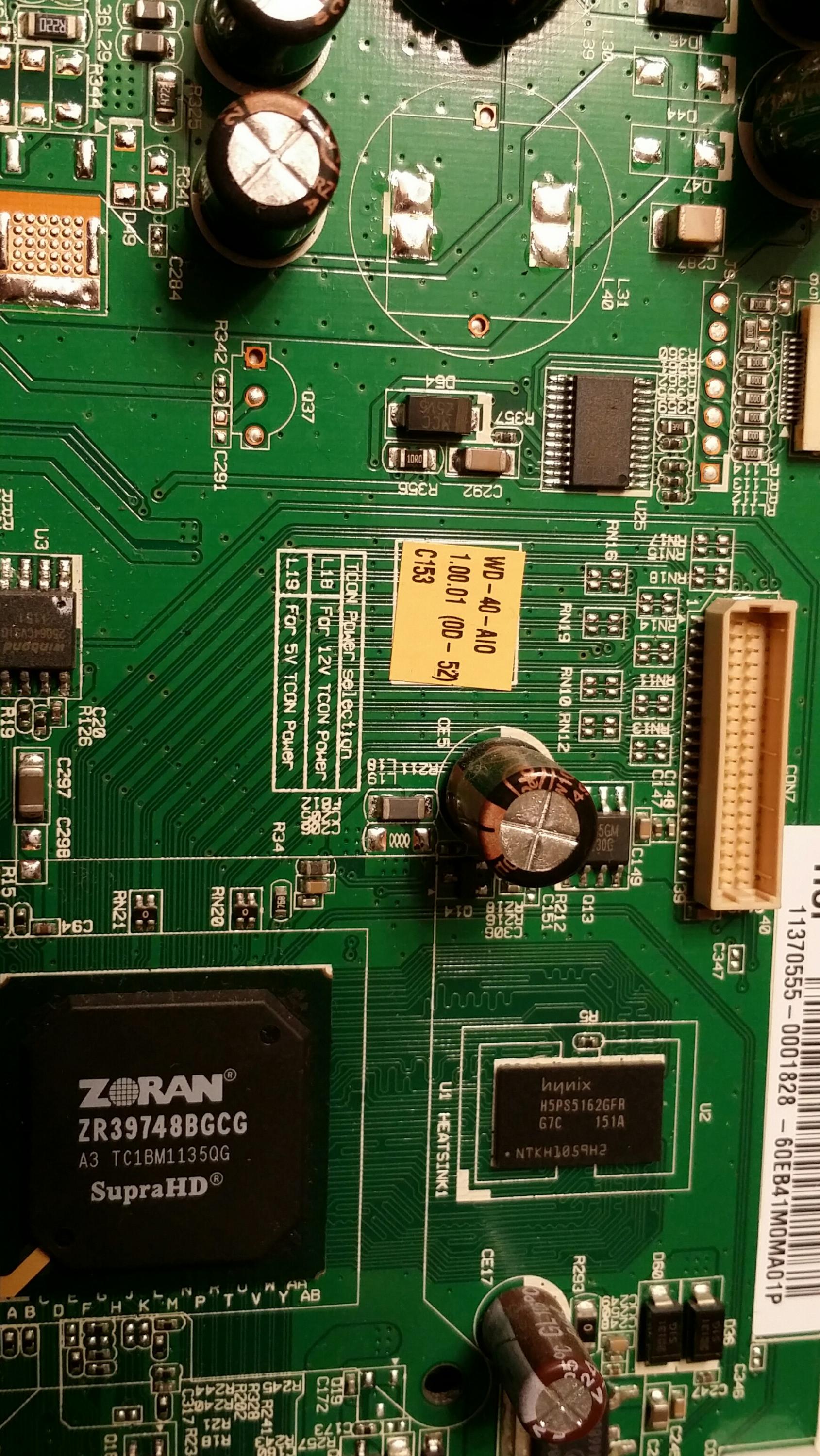

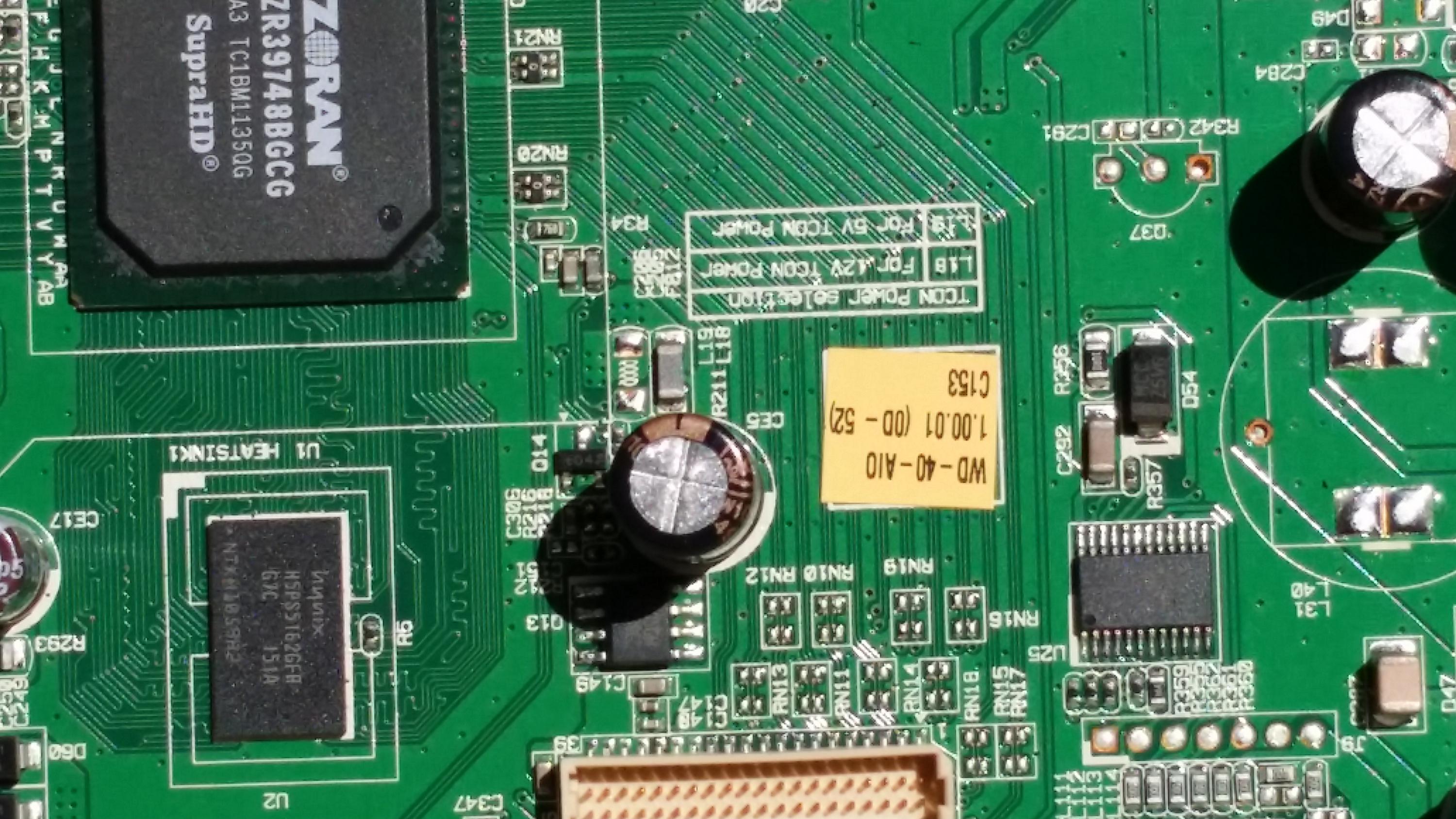

        There is two connections on this board that talk about voltage one is 5 volt and one is 12 volt both of them say they are to the T-Con. I tested both of them and they are both correct. I removed each one of the ribbon cables that goes to the LED Back light and I still get the same result. I did have the tv Red led turn off once when I touch the turn off on the front of the TV. but would not turn the red light back on. I get nothing else no backlight, no sound and the only other light is coming from the SPIF digital sound. Looks like all of the controls are touch no buttons. I have added some better pictures. thanks so much for your help.

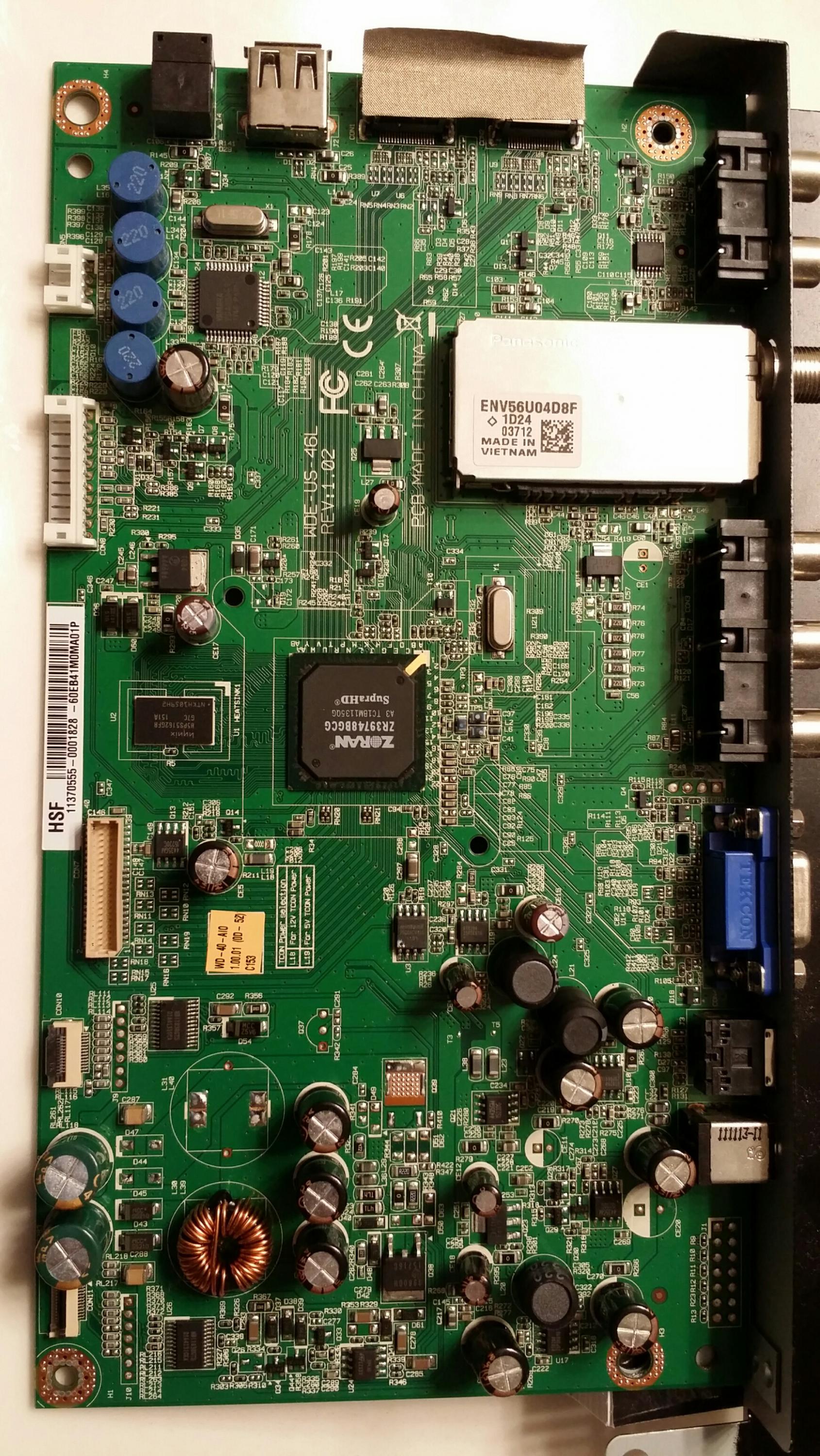

            purchased a main board. now I get nothing. no lights at all. put the old main board back in and I get a solid red light for power and on the digital audio I get a red flickering light.

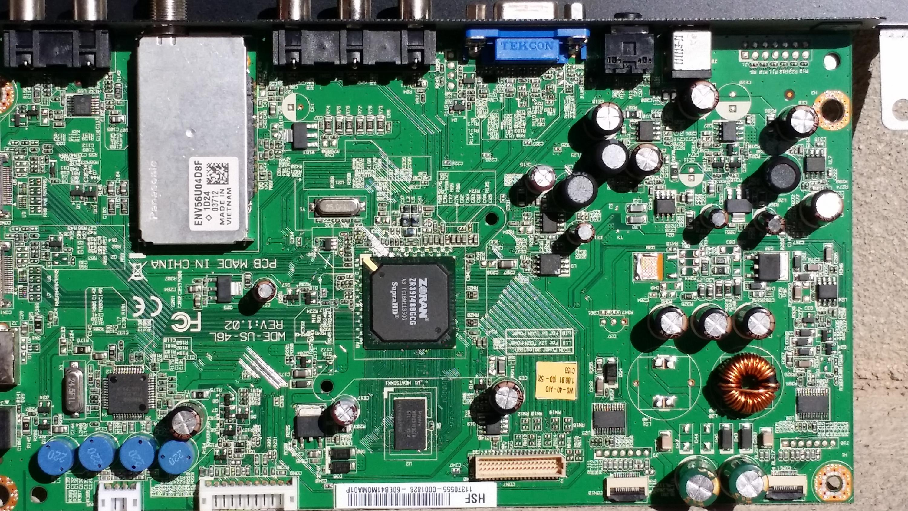

              I am wondering what kind of voltages I should be getting on the voltage regulators. I have tested the fuse on the T-con and am only getting .5 volts. the main board doesn't have a lot of labels for voltages.

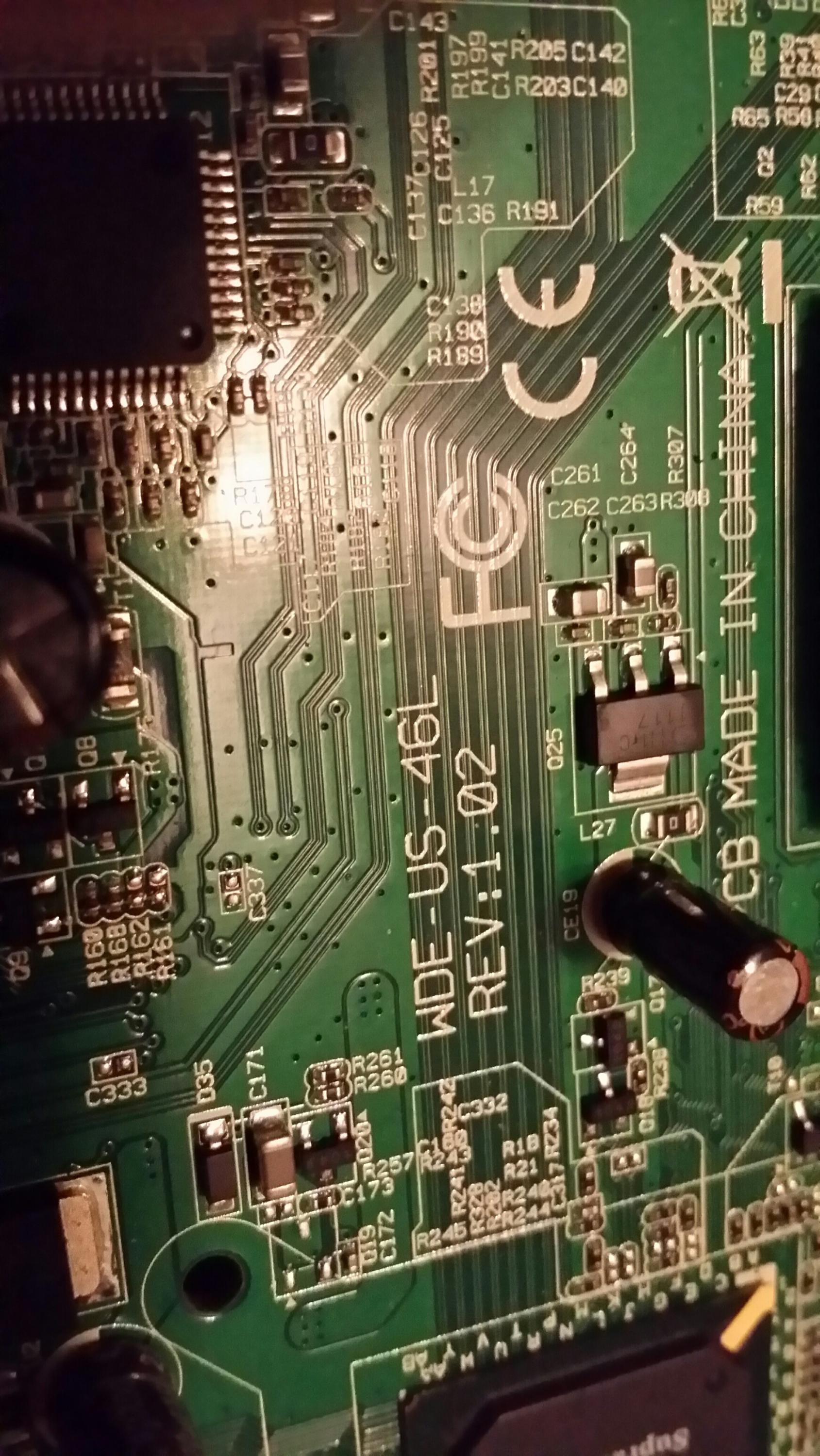

                      ok I have tested some voltages on the small regulators
                      U11= 3.7, 4.9, 10.2
                      U20= .5, 1.8, 4.1
                      Q25= 2, 3.2, 4.9
                      Q23= 2, 3.2, 4.9
                      Q30= 0, 19, 1.6

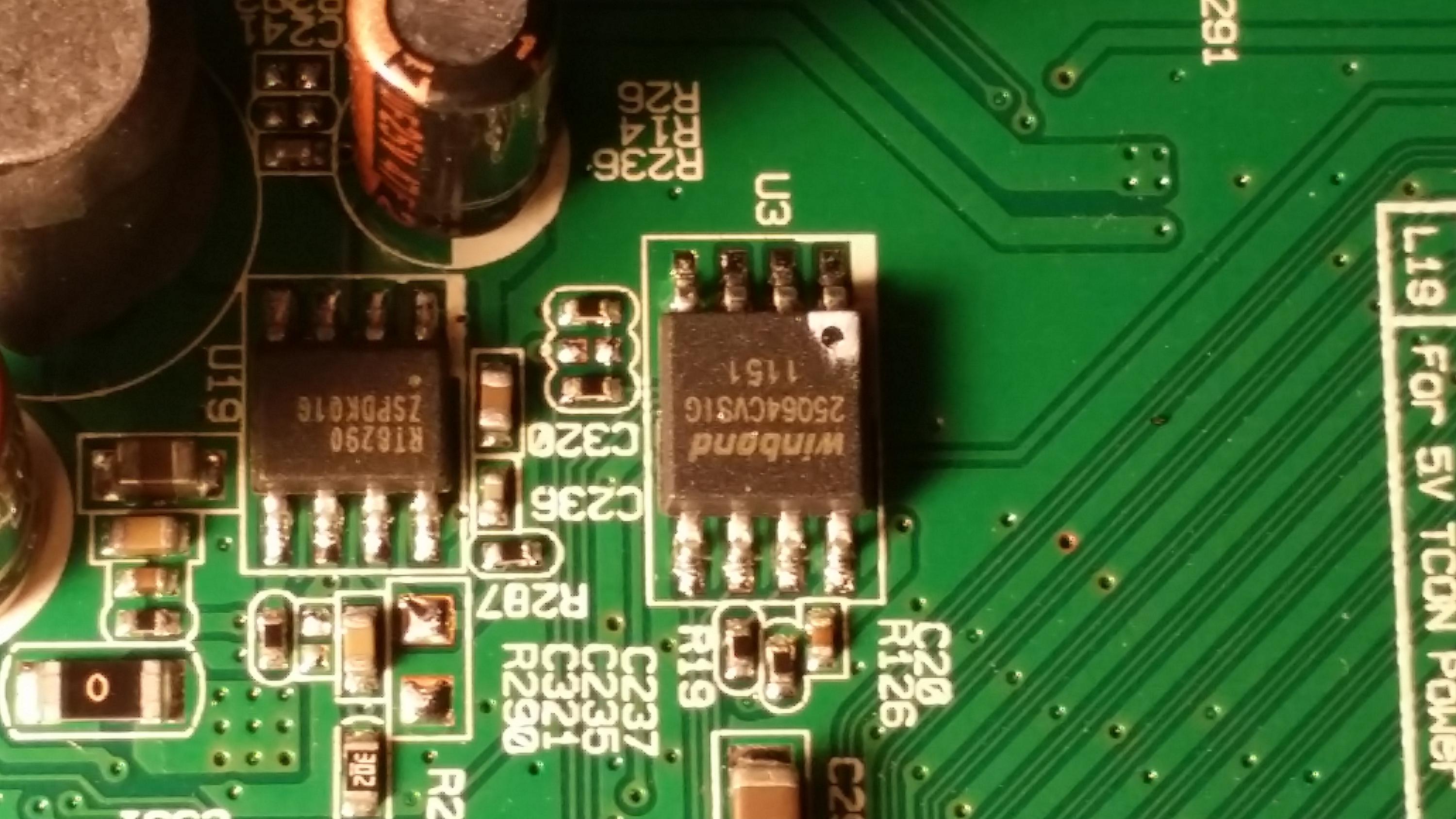

                            I wonder if this could be a eeprom. maybe I should purchase one of those and try replacing that first.
                              Ok I purchased a eeprom and installed it. still no change.

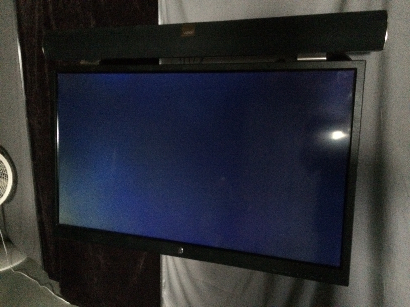

                                Any luck with your WestingHouse UW40TC1W?
                                I have the same problem....Red LED comes on usng the front panel touch-on/off control...LED backlight comes on (faint dark blue) but no picture.
                                Pic#1 - TV set off
                                Pic#2 - TV ON (faint blue light), LED red power light remains on
