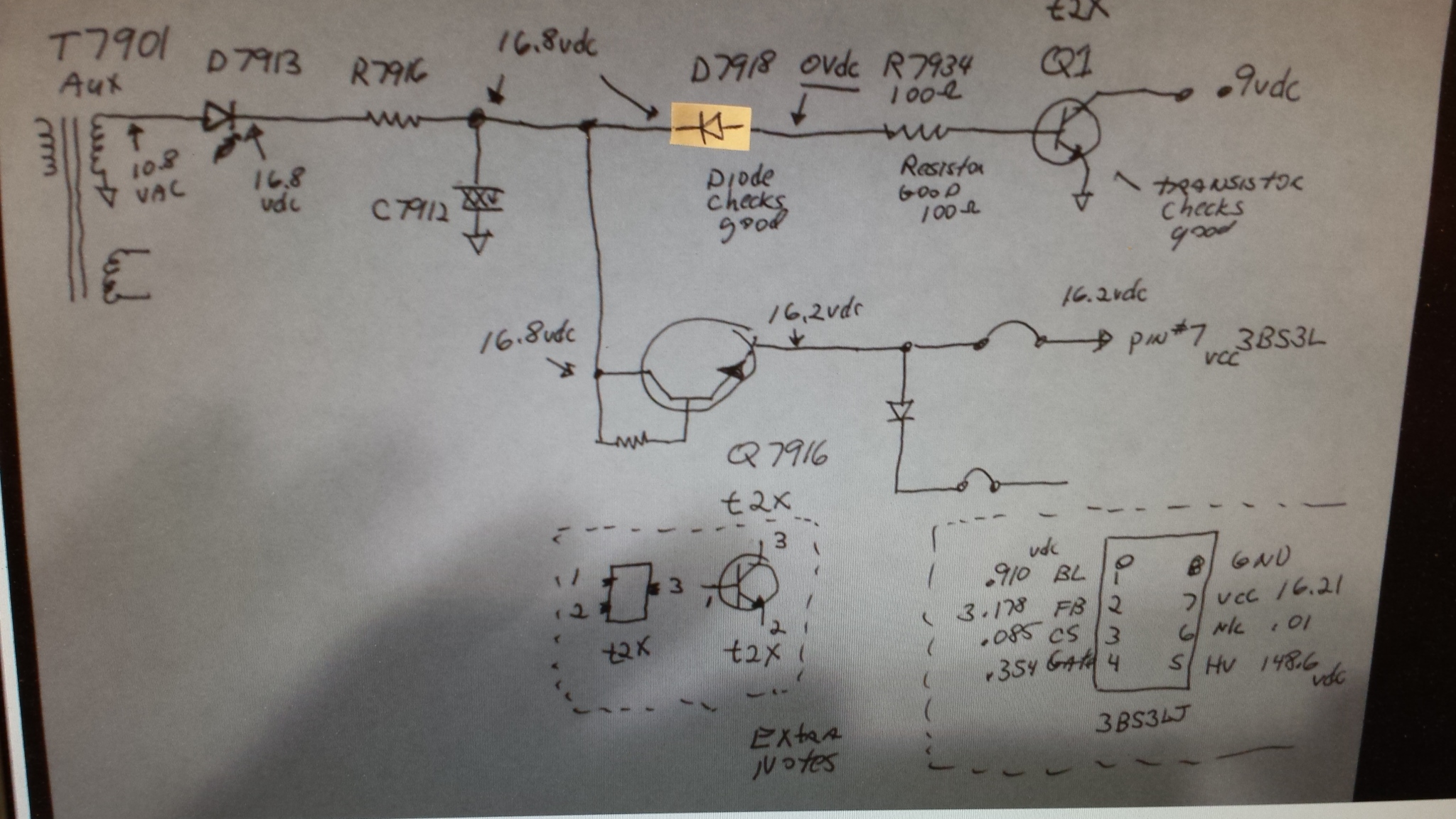

    Corrected Drawing
      #42
      Re: Question about jumpering P.S.-on command
      https://www.badcaps.net/forum/showth...381#post485381
      OK, I see that too now in the picture, the white bar (CATHODE) is on the right and connected to the + of C7912.
      That Q1 has nothing to do with the VCC to the PFC IC though, so we still need to find out where that voltage supply is.
        Pin #7 of 3BS3LJ is 16.21 dvc as come from the Emitter Q7916 comon base circuit. this is the VCC to that IC
        IC 7801 1608B and IC 7601 DDA002C in the primary circuits have no VCC I will start in those circuits.
