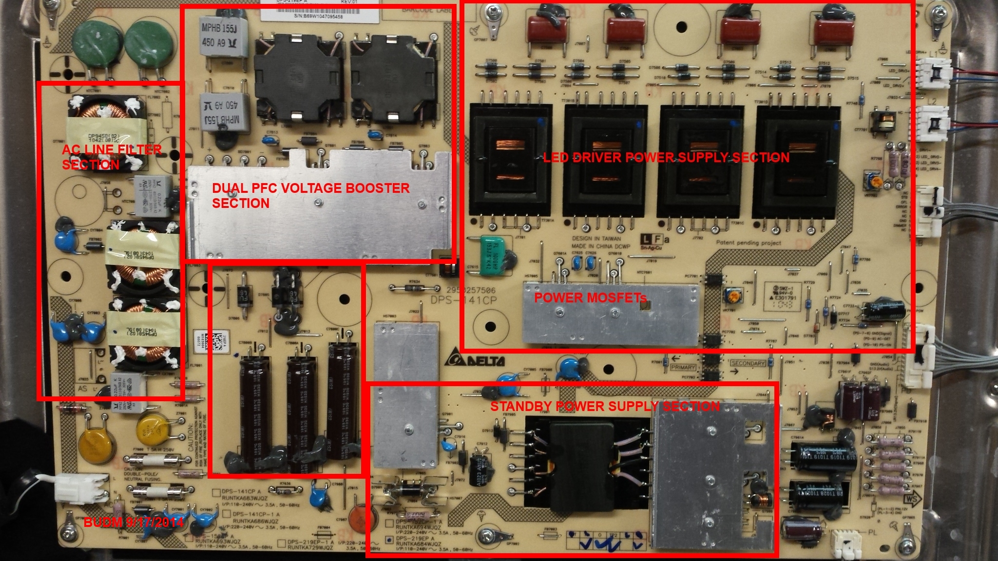

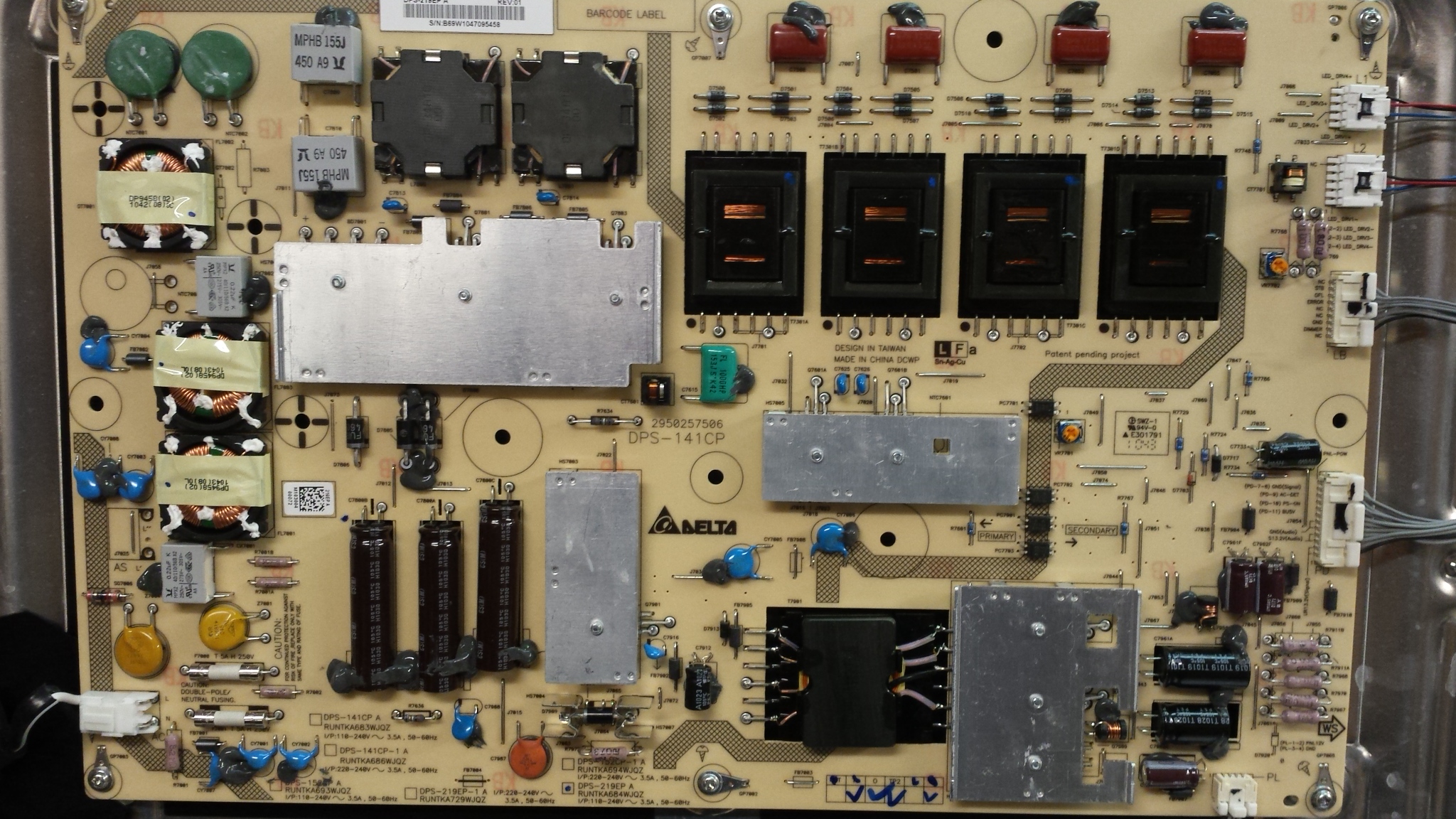

        Pic of P.S.
          Re: Question about jumpering P.S.-on command
          So what brand is this so I can look at SJ to see if he has good clear pictures of the board?
          OK, it is a SHARP DPS-141CP

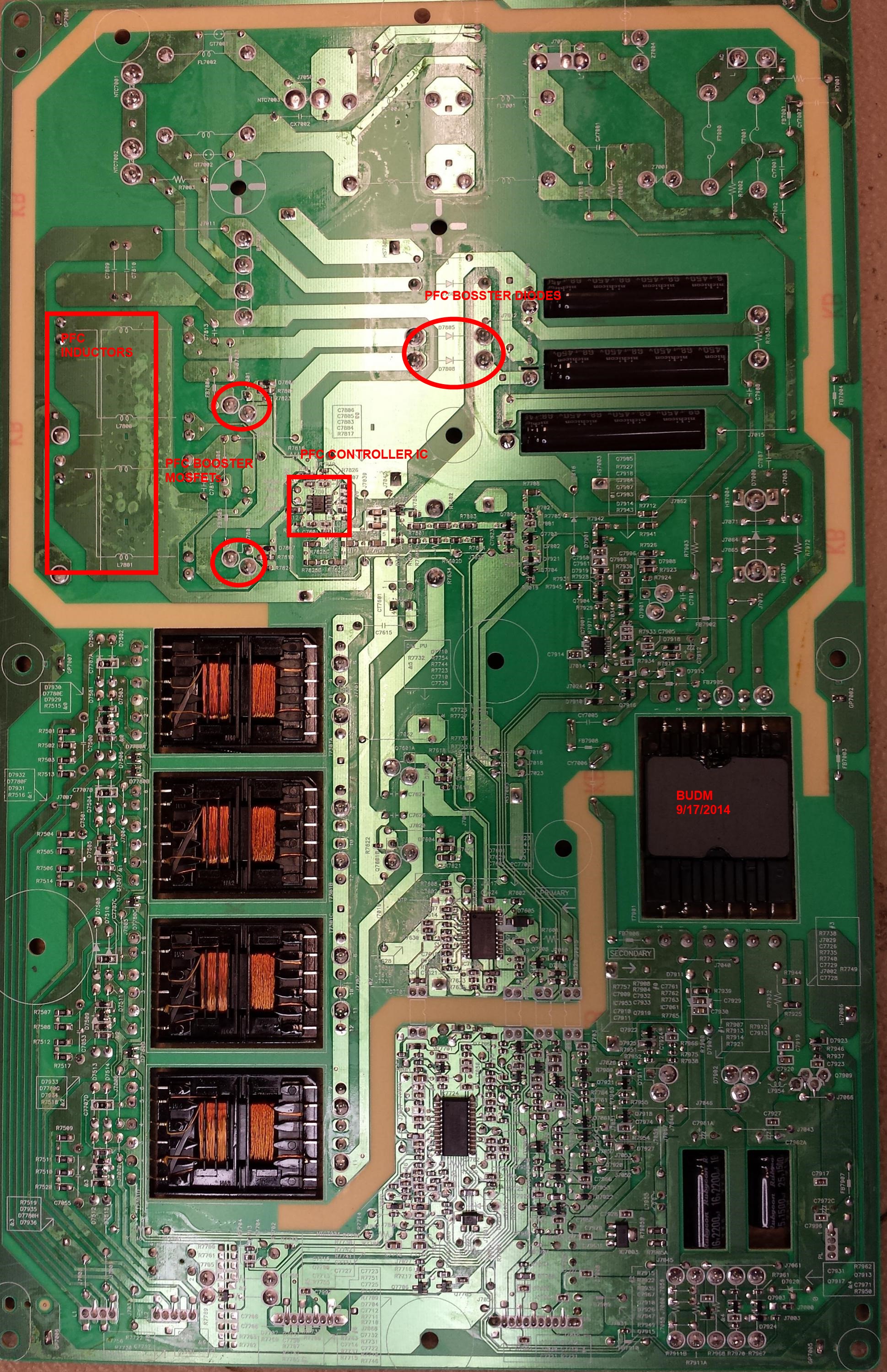

                  Shopjimmy does not have good pictures of the board. Can you please take good pictures of the whole bottom side of the board for me?
                  BTW, the LED driver power supply runs on boosted Voltage and it looks like it has 4 LED strings.

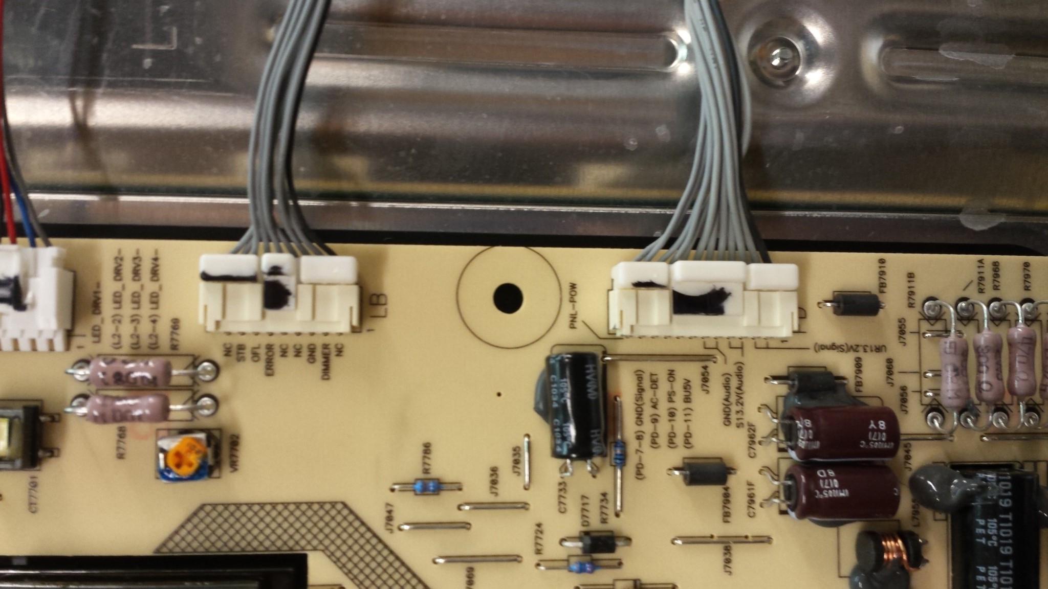

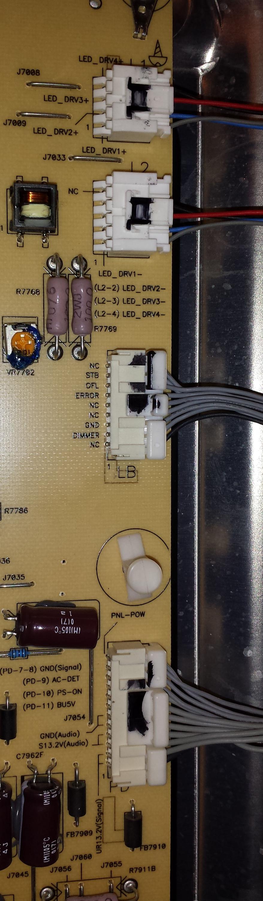

                    I jumpered (PD-11 BU5V) to( PD-10 PS-On) and to (PD9-9 AC-Det) with 470 ohm 1/8 watt resistors. I did get 13.2 volts on the (PD audio power pins 1-4).
                    But across the main filter caps is still 168vdc. I went ahead did some other checks any way. I am unaware of anything else to to to make the P.S. come out of standby and turn on. Odd that I got the 13.3vdc though.
                    There was no voltage on any pin of LB connector when connected to the main board ot not connected to the main board. There was no voltage out to L1 &L2 to the LEDs.
                    I did a diode and resistance check on L1&L2 that feeds voltage to the LEDs and all readings any combination were all open. That is higher than my Fluke 87 would read. If they are open the the P.S., does it sense this and does not turn on power to the LEDs? Does anyone know what I should read if the LED strips are good? Or what resistances can safely be used to trick the P.S. to turn on? This would tell me that the two P.S. I have are good.

                        I need to see the bottom side of the board.

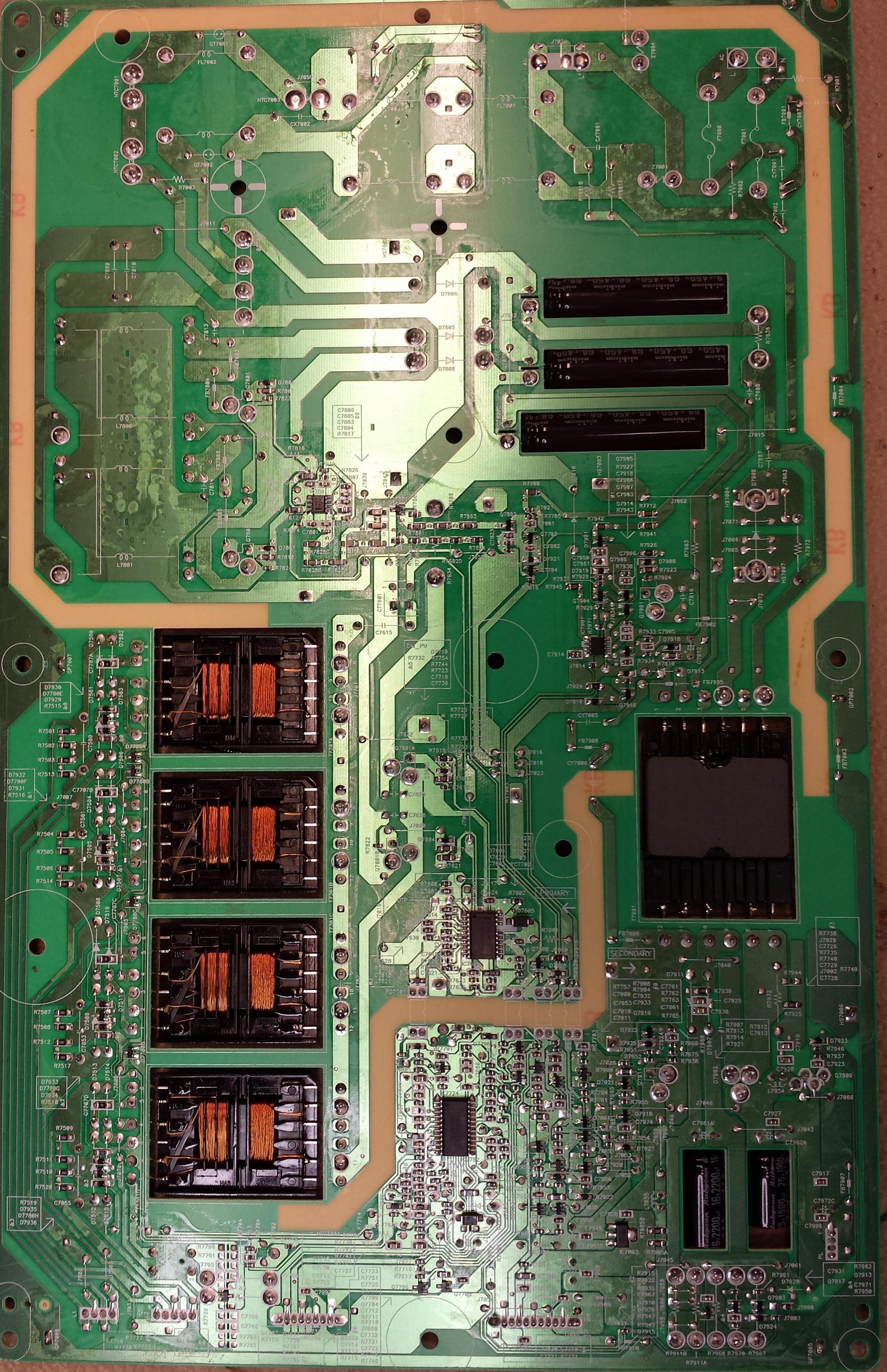

                          Bottom of board
                            OK, you need to get the P/N of that PFC Controller IC so we can find out if we are getting the B+ at the VCC pin.

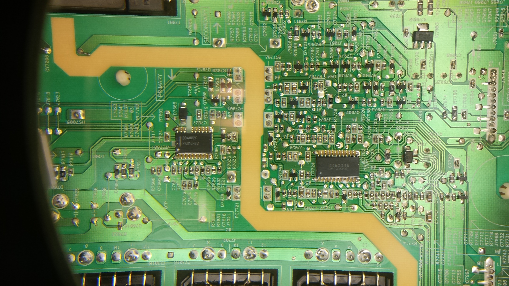

                              There are two PW Controller IC DDA003A and a DDA002C
                                Right now we are interested in the PFC Controller IC that needs to be checked out as I redlined in the picture in post 14.

                                  The DDA002C Gnd Pin#14 is connected to Gnd of the Main filter cap on the Primary P.S. 450v 68uf cap. Pin #16 VCC of the IC has zero volts. I will try to trace ot the problem. Poer Supply is a Sharp RUNTKA684WJQZ

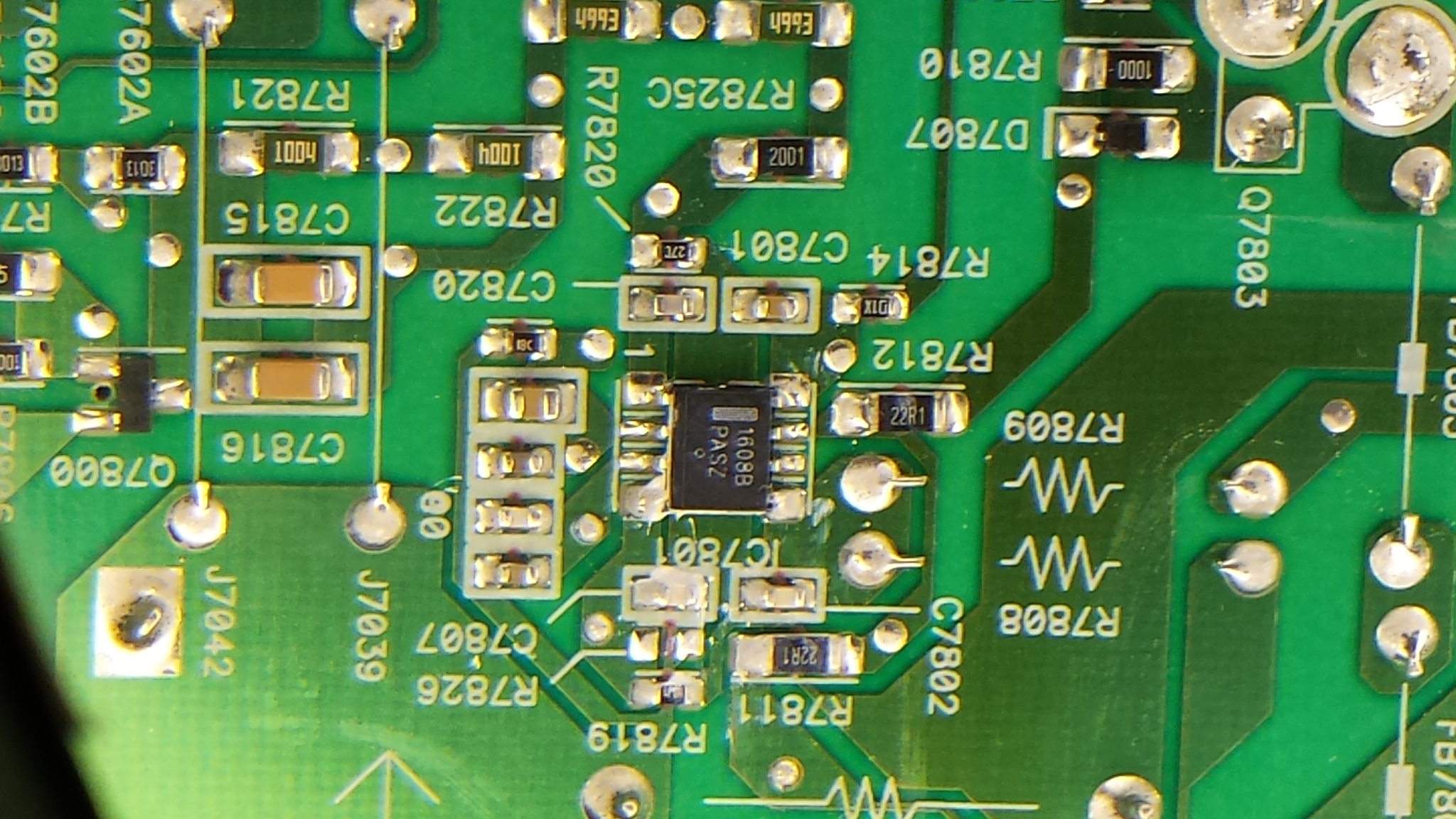

                                    The PFC Controller IC only has 8 pins, please see my post #14 AGAIN.
                                    • Ltank
                                      • Jun 2013
                                      • 776

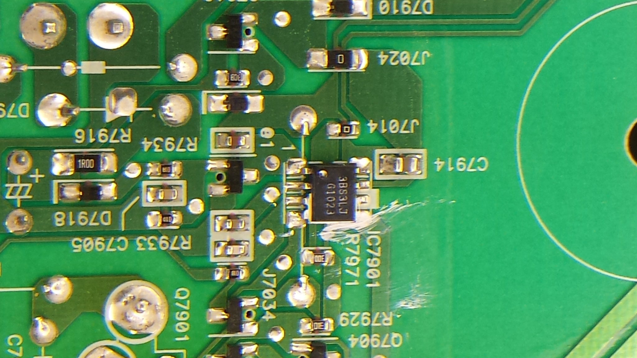

                                      Ok. I took a pic of two 8 pin IC. 16088P is the PFC controller. VCC is zero.
                                      38S3LJ is another PW Controller. VCC is 16.2vdc
                                        Check VCC to GND on PFC controller for shorts (ohm range, power off)
