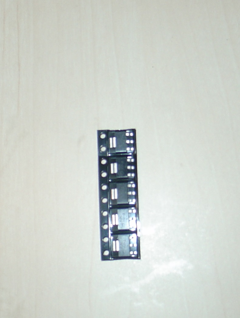

      the 1117 finally came today. i went w/the adjustable for all five
      not that great at soldering, any tips?

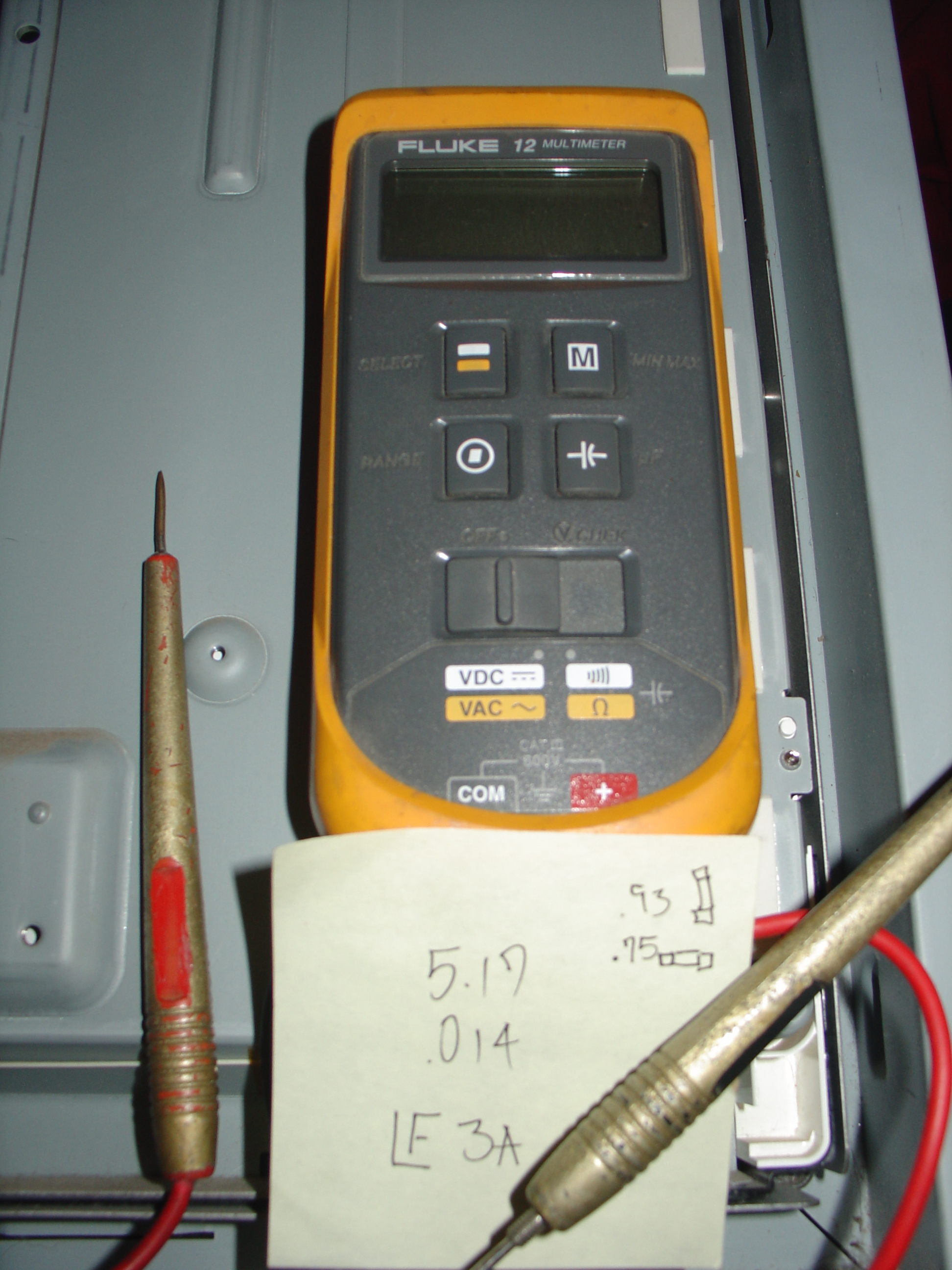

                    yeah i looked again and saw them, does it matter which side i measure them?
                    can they blow if i measure wrong side w/multi meter before i try it?

                      to test fuses, black probe to chassis ground, red probe on either side of the fuse. while power is on. careful, dont slip!

                        maybe its just the fuse!?
                        readings:
                        5.17 - one thats horizontal
                        .014 - one thats vertical
                        w/TV on

                          Re: bought new Power Board, can't test Main Board - need help using MultiMeters
                          Test resistance with power unplugged. A good fuse should measure the same resistance as when the probes are touching each other. On my meter its .03 ohms. U should have seen 12v on that other fuse. If the fuse is not blown then u have some problem with the 12v on ur motherboard...or the PSU is not sending the 12v
                                i get no readings on both?
                                  Please explain with more details than less. Were not mind readers! What do u mean by no readings? What is the resistance in ohms across each fuse? Set your multimeter to its lowest ohm setting and unplug the tv. Put the red probe on one side of the fuse and the black on the other. What ohms do u get? Also what ohms do u get when u just touch the probes together? That should be your meters version of zero.
                                    this is the new multimeter i'm using so when its in V Check position i get:
                                    .93
                                    .75
                                    when its V- i get no zeros

                                      Are you checking the fuse resistance of the fuse by setting the meter to Ohm mode? TV not plugged in of course.
                                      "when its V- i get no zeros" I have no idea what that means.

                                        sry about that, i meant i didn't get any reading or numbers displayed on multi meter even a zero
                                        in Ohm setting at:
                                        Ohm multimeter set to: 2m
                                        Vertical Fuse
                                        top is -.012
                                        bottom is -.012
                                        Horizontal Fuse
                                        left is -.013
                                        right is -.013
                                        Ohm multimeter set to: 200k
                                        Vertical Fuse
                                        top is 1.1
                                        bottom is 1.1
                                        Horizontal Fuse
                                        left is 3.0
                                        right is 3.0
