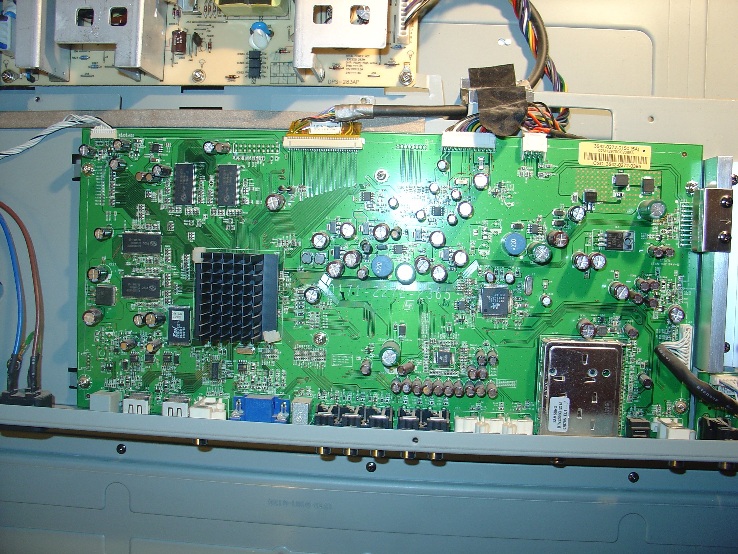

    bought new Power Board, can't test Main Board - need help using MultiMeters

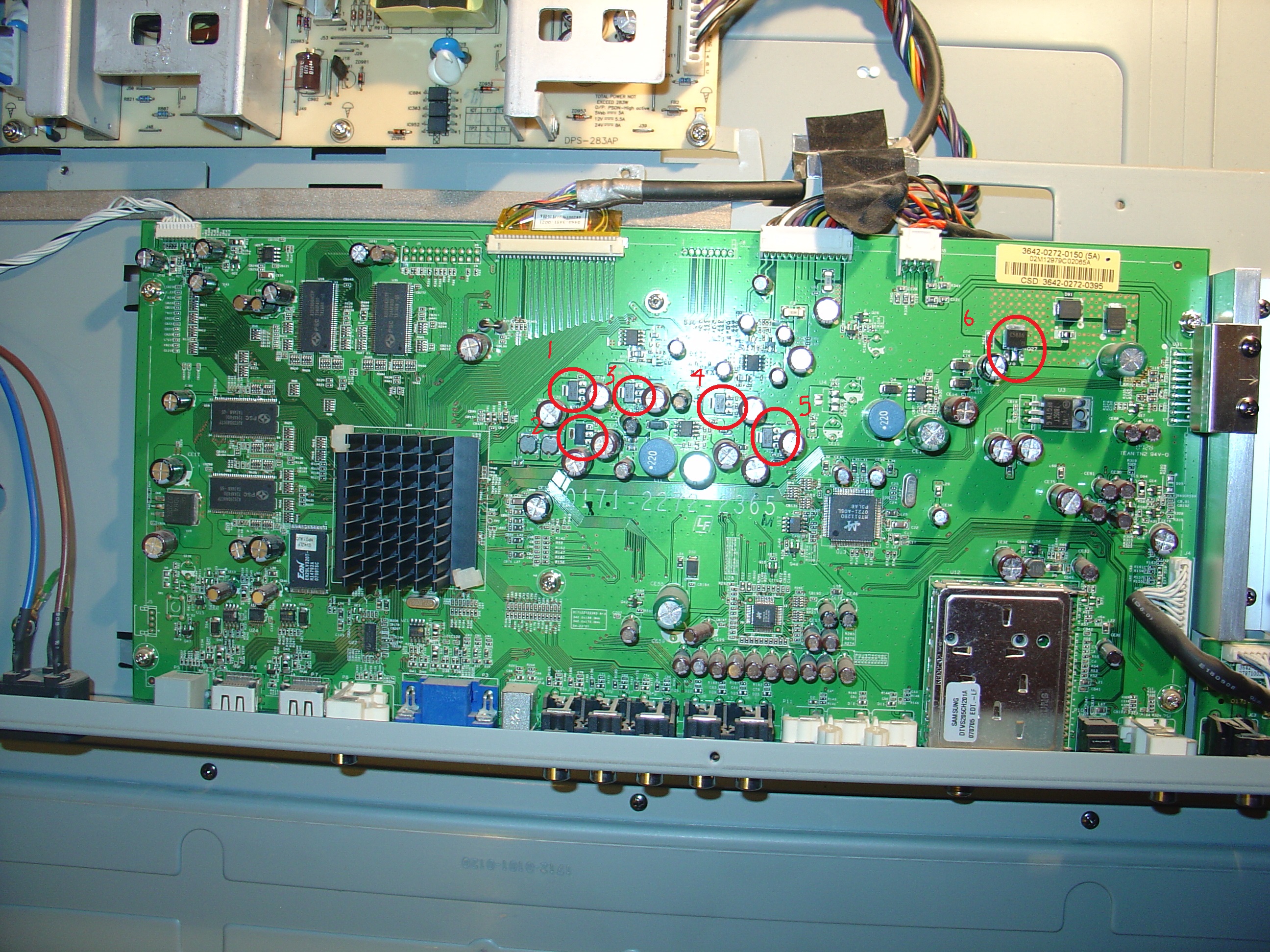

    TV Model is Vizio GV42L and replaced the Power Board w/one working on eBay, VIZIO logo turns orange like before

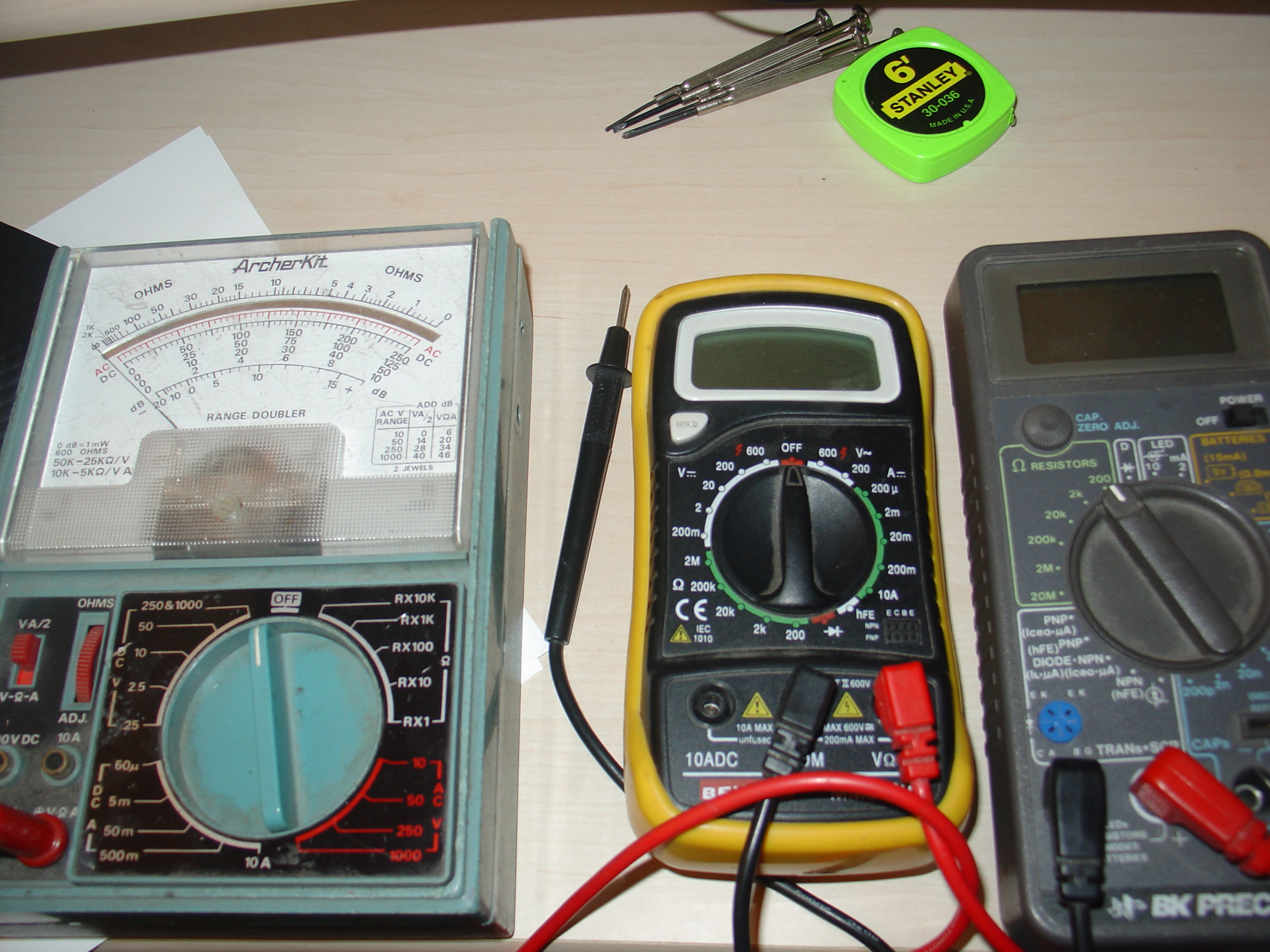

    my Dad was in electronics for 30+ years and brought me 3 Multi Meters and i want to test the voltage regulators but searched extensively and still can't figure them out
    can someone please tell me how to use any one of these to measure this Main board

    Re: bought new Power Board, can't test Main Board - need help using MultiMeters
    I'd use the middle one...
    Keep probes like they are.
    Set meter to 20V DC (the symbol with one solid line, one dashed line.)
    Place the black probe on the TV chassis, this is your ground reference for now.
    Place the red probe on each pin going to the main board in succession. Note the readings (post them here) and compare to the label.
      tried that and that was the one i was using...will try again today and thanks
              k got the numbers but the mutli meter was -0.04?
              1.
              pin 1 = 1.56
              pin 2 = 0.00
              pin 3 = 1.05
              2
              pin 1 = 1.25
              pin 2 = 0.00
              pin 3 = 1.38
              3
              pin 1 = 1.44
              pin 2 = 0.00
              pin 3 = 1.05
              4
              pin 1 = 1.45
              pin 2 = 0.00
              pin 3 = 1.04
              5
              pin 1 = 2.25
              pin 2 = 0.00
              pin 3 = 0.74
              6 question, this one has 3 pins but the middle one is not solder?
                not 100% sure if i did the readings correct 1st time so put ground on chassis and measured:
                1.
                pin = 2.58
                pin = 0.98
                pin = 0.00
                2.
                pin = 2.58
                pin = 1.16
                pin = 0.00
                3.
                pin = 4.07
                pin = 2.58
                pin = 0.00
                4.
                pin = 4.08
                pin = 2.58
                pin = 1.58
                5.
                pin = 4.07
                pin = 1.77
                pin = 1.07
                6.
                pin = 0.00
                pin = 0.00
                pin = 0.00
                so 6 is blown for sure?
                  Please write down the P/N of each one of those regulators so we will know what they are, for example 1117-1.8, or 1117.
                  There also two SMD fuses on the board that you should check also, one is for 5V, another one is for the switched 12V.
                  Those 4.07/8 reading are not normal, I expect 5V reading. Is the meter good?
                    All 4 say:
                    AMC1117
                    F0719J
                    except 2:
                    K1117S15
                    726
                        Originally posted by GR3Y5H3ART
                        All 4 say:
                        AMC1117
                        F0719J
                        except 2:
                        K1117S15
                        726
                        OK, the one with 1117s15 is the 1.5V fixed output voltage regulator, the other are Adjustable output regulators.
                        But which two are the 1117s15?
                          1.
                          pin = 2.58
                          pin = 0.98
                          pin = 0.00
                          2.
                          pin = 2.58
                          pin = 1.16
                          pin = 0.00
                          3.
                          pin = 4.07
                          pin = 2.58
                          pin = 0.00
                          4.
                          pin = 4.08
                          pin = 2.58
                          pin = 1.58
                          5.
                          pin = 4.07
                          pin = 1.77
                          pin = 1.07
                          6.
                          pin = 0.00
                          pin = 0.00
                          pin = 0.00
                          So which two are 1117s15.
                          Did you do as I requested on checking the voltages on the fuses?
                          The 4V input voltage is not right, it is too low.
                          Check the voltage of the both SMD fuses at both ends against the chassis ground, if one of them shows 4V then you will have to fix the 5VSTBY power supply first.
                            i meant #2...1,3,4,5 all AMC
                              1.
                              pin = 2.58
                              pin = 0.98
                              pin = 0.00
                              2.
                              pin = 2.58
                              pin = 1.16
                              pin = 0.00
                              3.
                              pin = 4.07
                              pin = 2.58
                              pin = 0.00
                              4.
                              pin = 4.08
                              pin = 2.58
                              pin = 1.58
                              5.
                              pin = 4.07
                              pin = 1.77
                              pin = 1.07
                              6.
                              pin = 0.00
                              pin = 0.00
                              pin = 0.00
                              sry for being a noob but can you point out in the pic where the fuses are? i've seen norcals vid a number of times but wanna make sure n thanks for being so helpful
                                They are just below the connector circled in red. They are labelled F1, F2, etc. I can only see 2, but the flash on the camera might be obscuring another one? A good fuse should measure less than 1.0 ohms.
                                  whats the part number for the 1117s? should i just replace them all or just the ones w/lower readings?
                                    Well, did you check the voltages at the fuses? the reading of 4V feeding voltage to the regulator is too low for the 5V Standby Voltage.
                                      not yet, i'd rather just buy all the parts and have them in hand just in case
                                      can someone please help me w/correct part numbers from digikey
