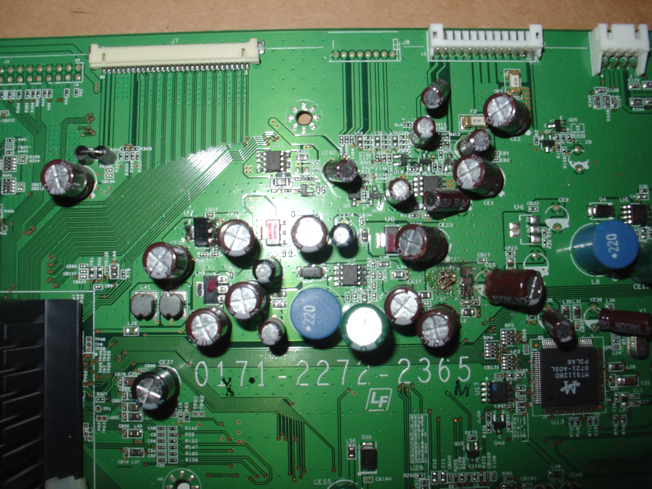

    Re: bought new Power Board, can't test Main Board - need help using MultiMeters
    do the readings you got on the fuses match the readings you get when u just touch the probes together? if so, then your fuses are fine.
    Don't fear the repair...
    • GR3Y5H3ART
      • Jan 2011
      • 146
      #42
      pretty close
      Ohm multimeter set to: 2m
      -.015
      Ohm multimeter set to: 200k
      -01.5

            measured with the Fluke:
            1
            Left Pin
            1.27
            Right Pin
            3.28
            1.28
            .028
            2
            L
            1.50
            R
            3.28
            1.50
            0
            3
            L
            3.28
            R
            5.13
            3.28
            2.03
            4
            L
            3.27
            R
            5.15
            3.27
            2.02
            5
            L
            2.26
            R
            5.16
            2.26
            1.39
            so 1 & 2 seem the same and 3 % 4 seem the same
            is 5 bad?
              sorry im totally lost as to what you are measuring. it helps to label things ohms or volts.. and um... explain yourself better? or maybe its late and this will all make sense in the morning
              • GR3Y5H3ART
                • Jan 2011
                • 146
                #47
                volts
                the readings for voltage regulator #1 and #2 are about the same numbers, same thing for #3 and #4.
                #5 having different numbers than #1 - #4
                • keeney123
                  Lauren
                  • Sep 2014
                  • 2536
                  #48
                  You should not get a neg reading on the ohms setting. So to measure the fuse you need to set your meter to ohms on the lowest setting. That would be the setting closest to 0 ohms. Most likely 200 ohm setting. Or if your meter has auto-adjust it will do it for you. Then you make sure TV is unplugged. You take one probe and place it on one side of the fuse and the other probe place of the other side of fuse. The fuse should typically measure under 1 ohm.
                  • GR3Y5H3ART
                    • Jan 2011
                    • 146
                    #49
                    remeasured and fluke beeped and went to 0 indicating both fuses are good
                    • GR3Y5H3ART
                      • Jan 2011
                      • 146
                      #50
                      should i replace voltage regulator #5?

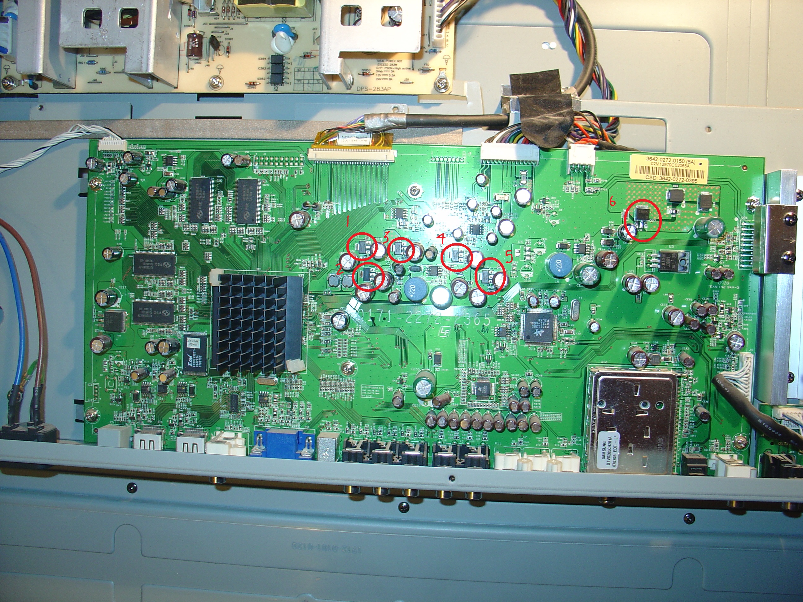

                        #51
                        #1 : OK, 1.25vRef +.028 =1.278
                        3.28
                        1.28
                        .028
                        #2: 1.5V FIXED Regulator?, need to verify P/N
                        3.28
                        1.50
                        0
                        #3: OK, 1.25Vref + 2.03 = 3.28
                        5.13
                        3.28
                        2.03
                        #4: OK, 1.25V ref + 2.02 = 3.27
                        5.15
                        3.27
                        2.02
                        #5: BAD, 1.25Vref + 1.39 = 2.64, you are getting 2.26.
                        5.16
                        2.26
                        1.39
                              I did not read all the lost, it is over 50 now. So it is 1.5V fixed regulator and it is OK.
                                  5.16
                                  2.26
                                  1.39
                                  good news in a sense?
                                  will report back when the replacement is installed
                                  should i grab readings for any of the caps around #5 voltage regulator
                                    the #5 regulator looks like its getting its 5v just fine, its just broken so its not outputting the correct voltage. i dont think bad capacitors around there would cause this. you cant test much on caps beyond voltage and shorts with a simple meter. you cant test capacitors ESR without taking them out of circuit and having a meter that does that. id say just replace that regulator and see if it doesnt fix things

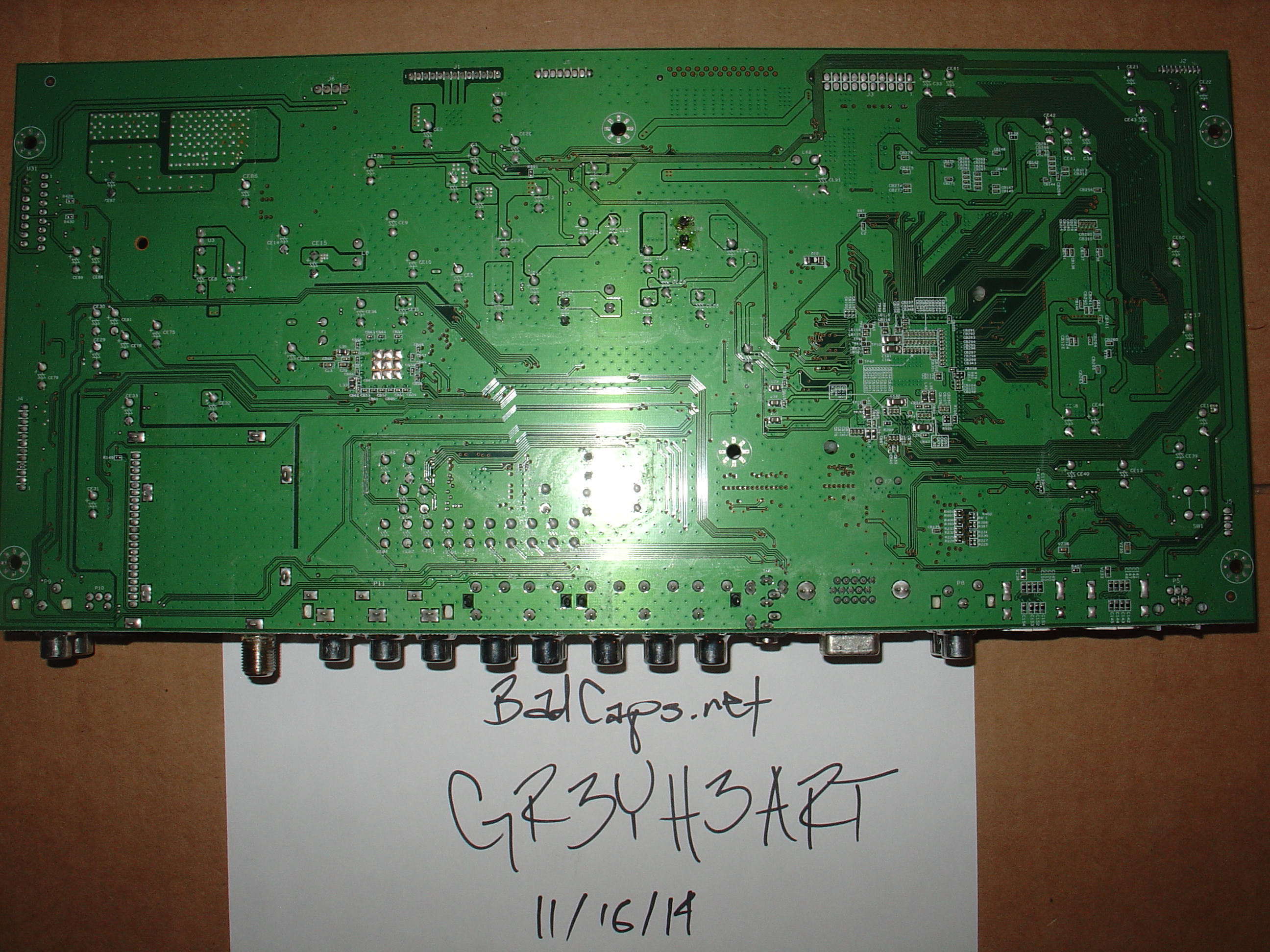

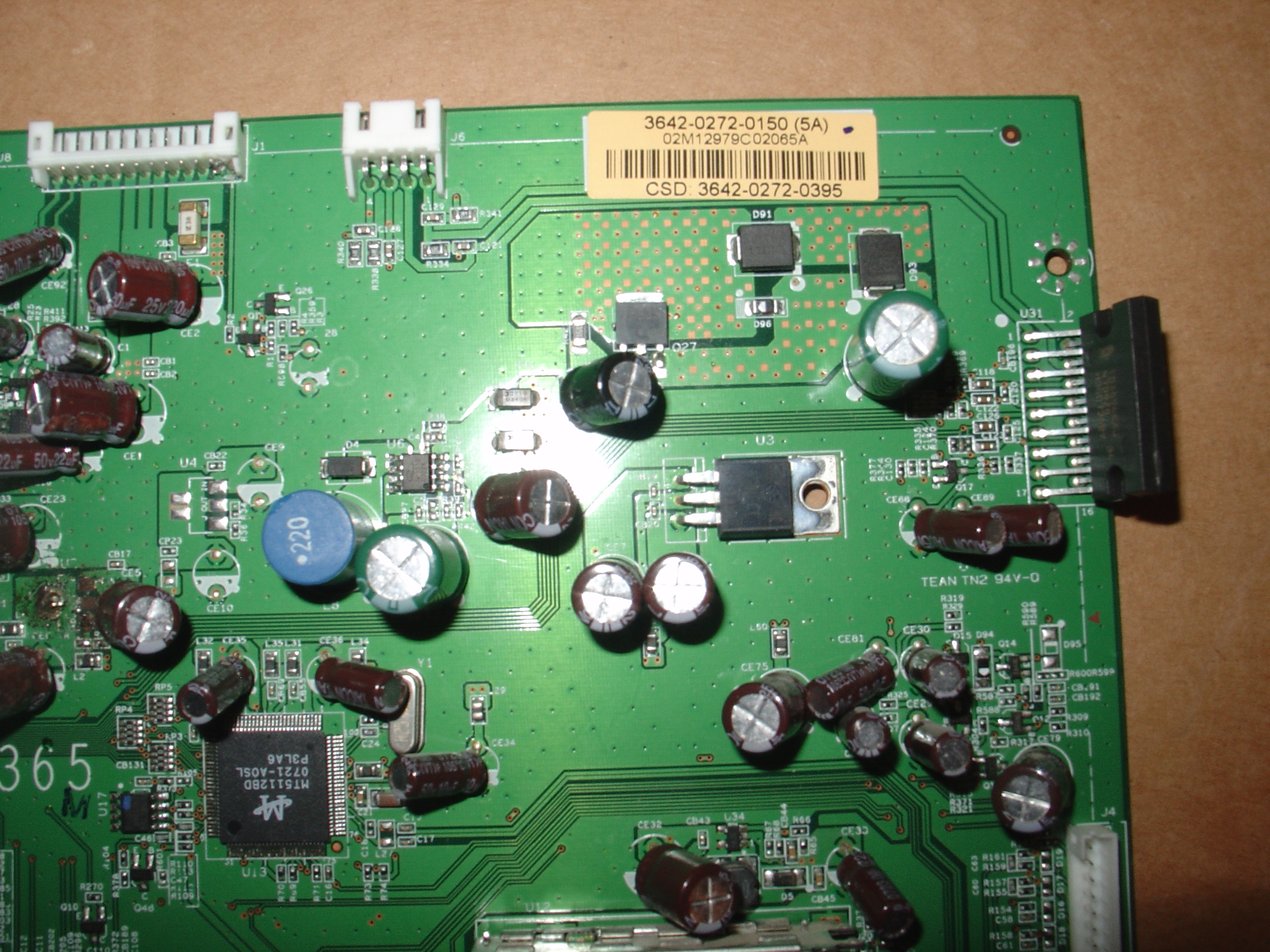

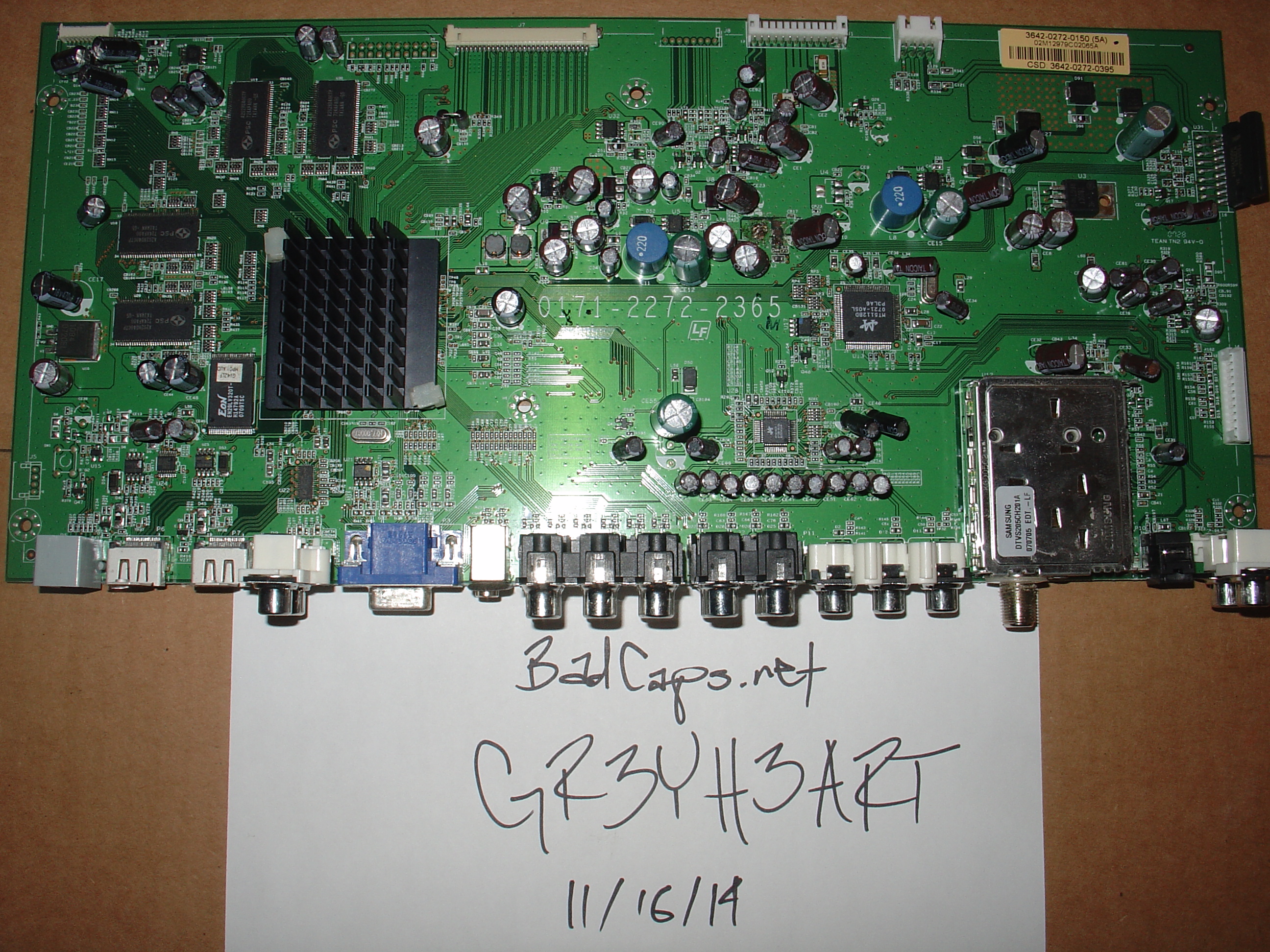

                                        i tried my best at soldering the Voltage Regulators but they were way harder for me
                                        bit the bullet and found a good deal for a working one for $40ish shipped
                                        it WORKS!
                                        now i have a Main Board (Voltage Regulators will most likely all need replacing and most likely is a non working board for parts) and a Power Supply for parts only since i tested soldering on it
                                        i will gladly ship either of these to someone who can use them if you cover the shipping
                                        thanks for everyone's help and only condition, Main Board is:
                                        3642-0272-0150 (5A) if your Main Board is different in those numbers, they are not interchangeable
                                        i.e. if your Main Board is 3642-0552-0150 (3E) or other varying numbers, it will not fit if your looking to directly replace but again, Board is probably only good for parts

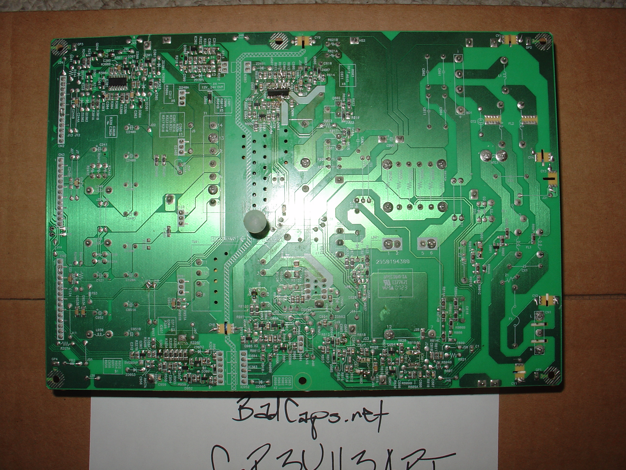

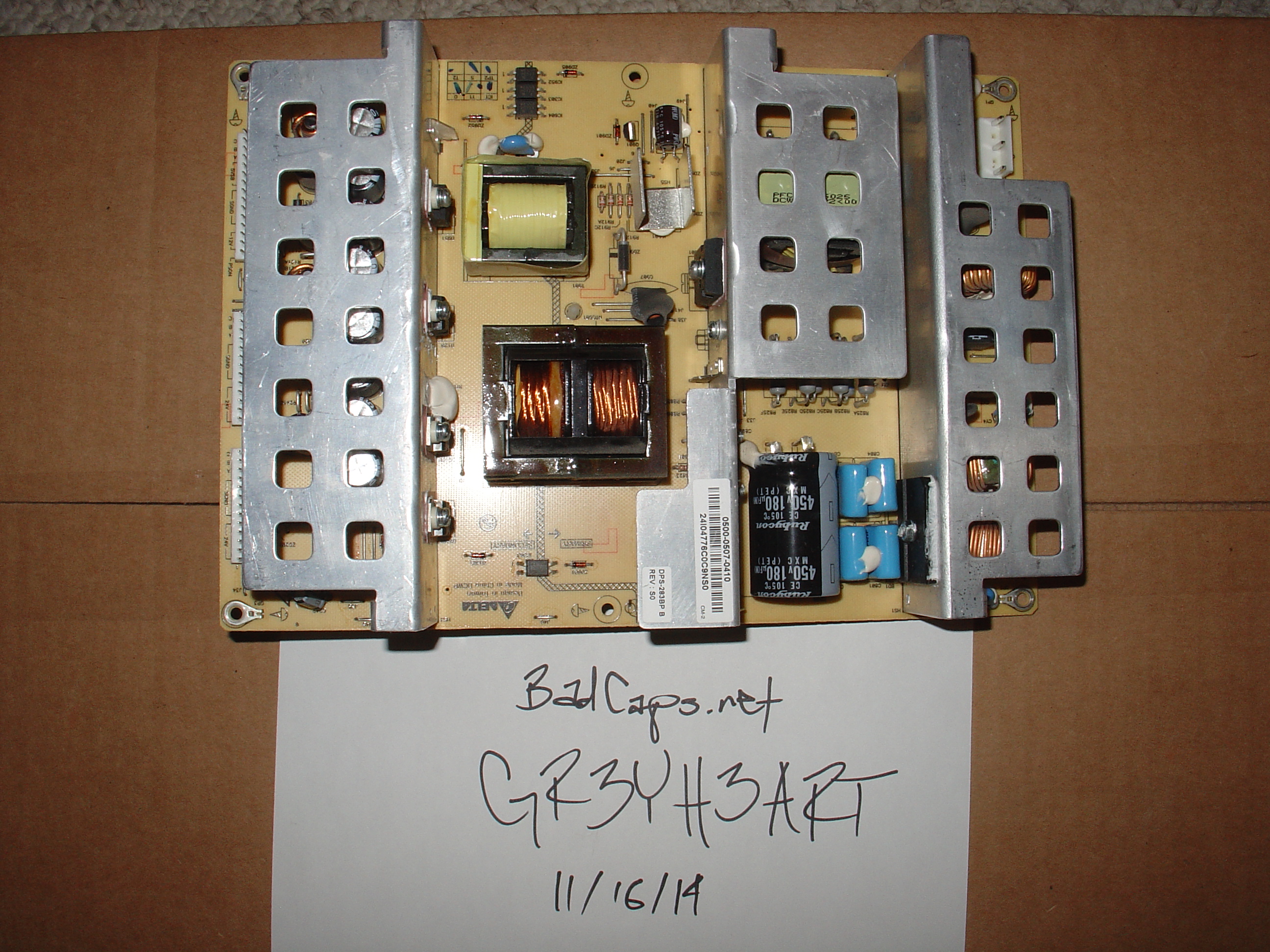

                                          #60
                                          Main Board
                                          Power Supply
                                          will put both on Craigslist and eBay next week, again pay for shipping and its yours
