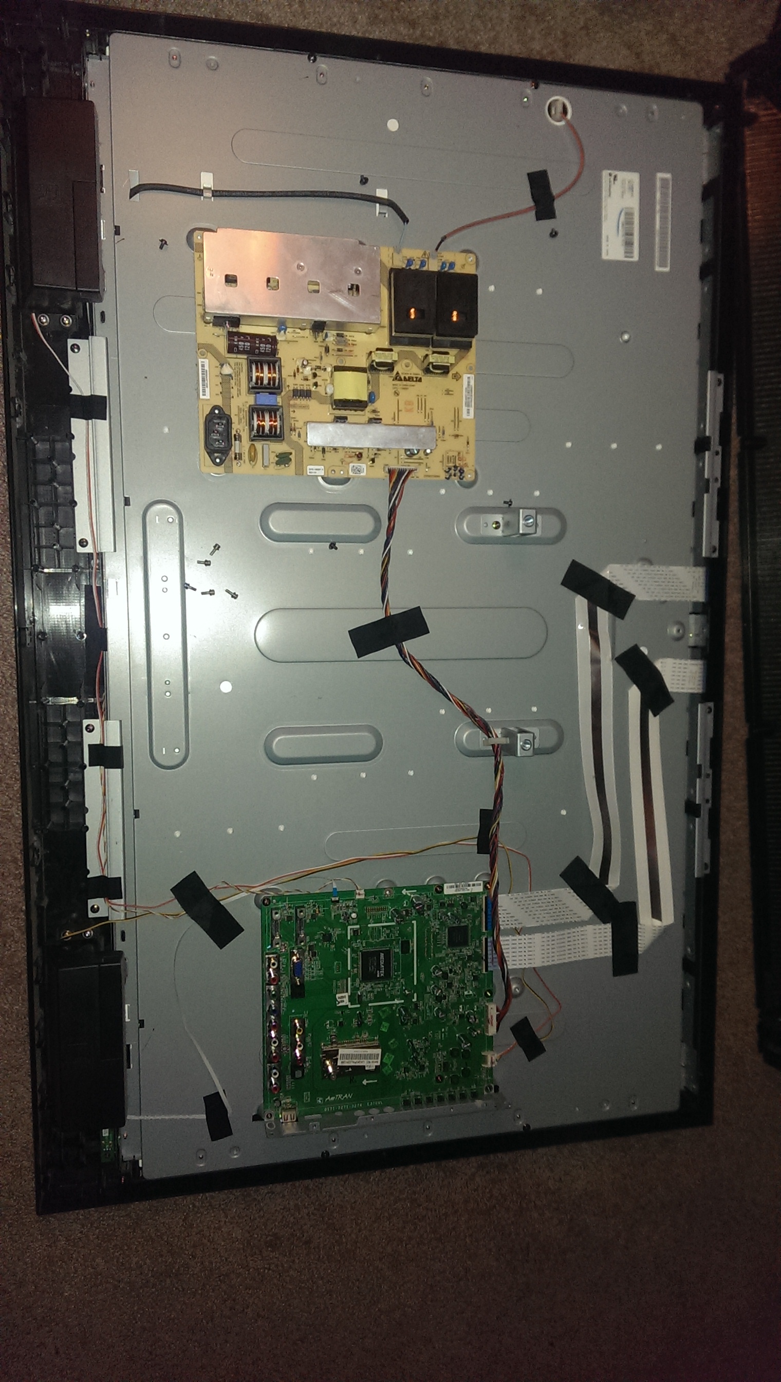

    I have a vizio tv model e420VO and the problem I am having with it is that the tv turns on and displays the vizio logo on the screen and then the tv shuts off. I have power cycled the tv plugged it into other outlets and tried different power cords. Everything seems to work fine but it shuts off after displaying the logo on the screen so I took off the back and I couldnt see any blown capacitors or burn marks. I can't afford to pay for the fix but If you can help me find the problem I am crafty at finding replacement parts cheap and I am very handy at fixing things. Also if it helps there is a vizio brand logo on the front of my tv that is orange when off and turns white when I turn it on then goes back to orange after it shuts itself off after displaying the logo. Any help is greatly appreciated.

      I will try to load pictures as soon as possible I am in the process of soldering what I belive to be heat shields off of the only two boards since they cover a lot of components

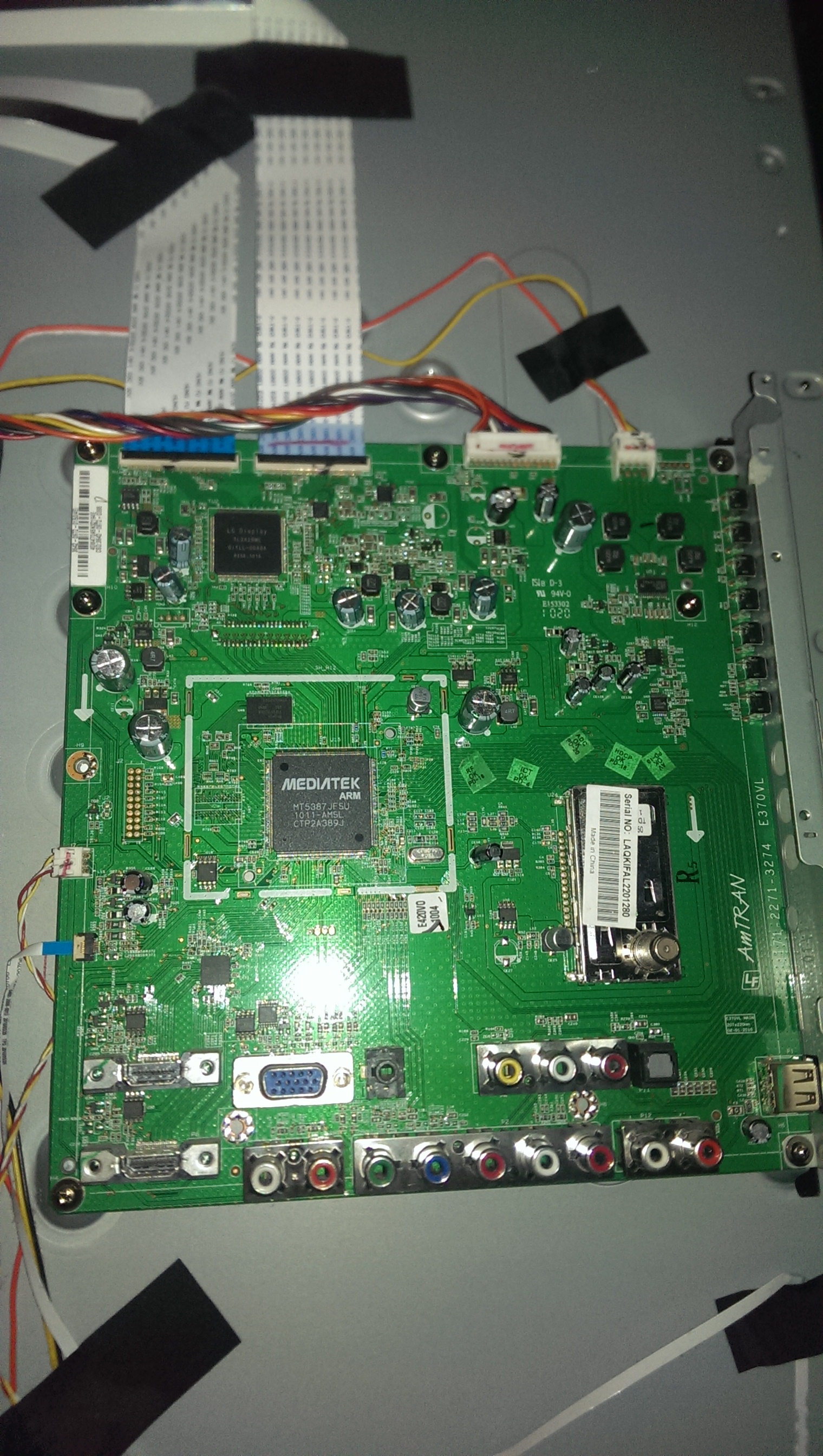

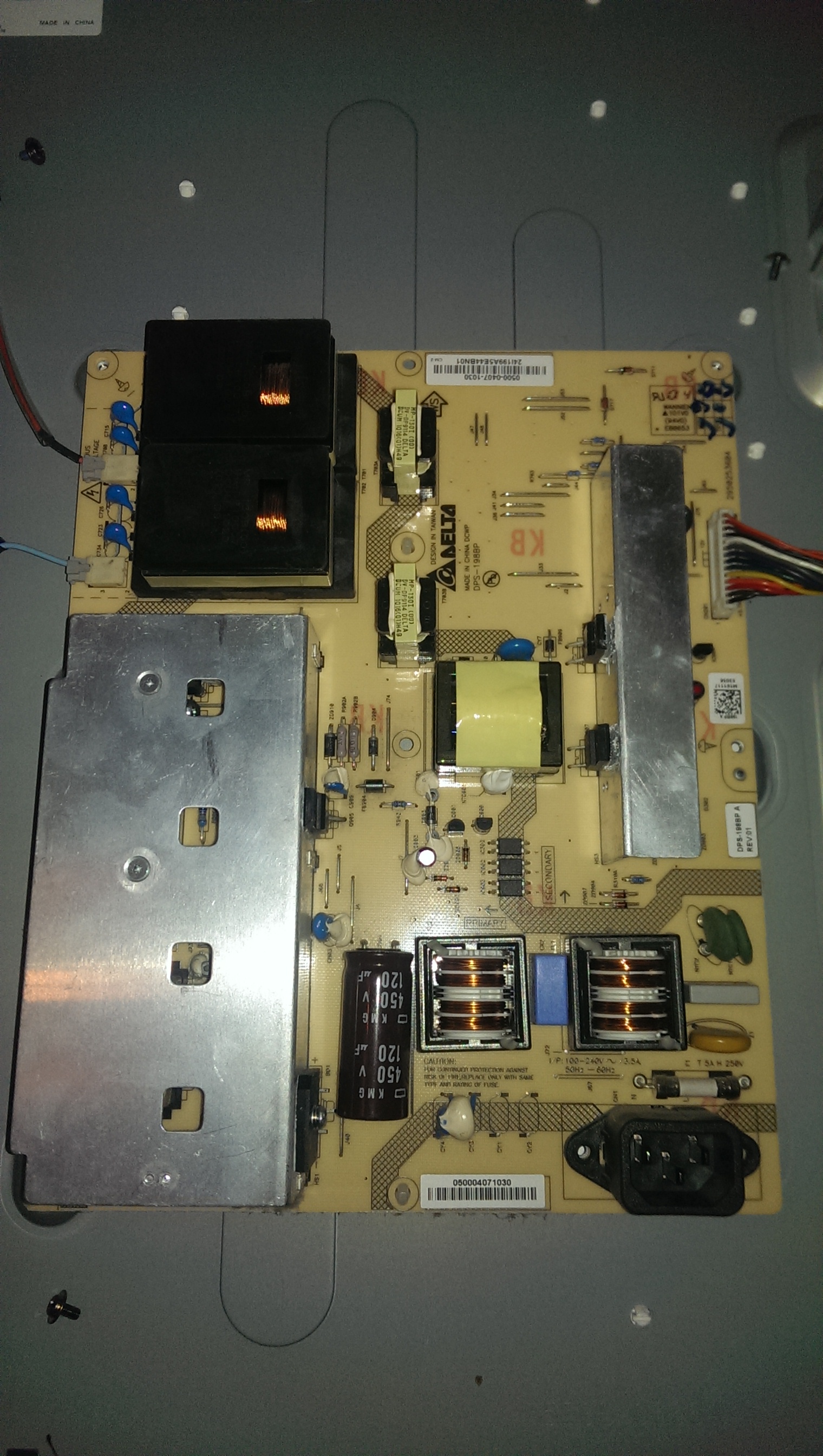

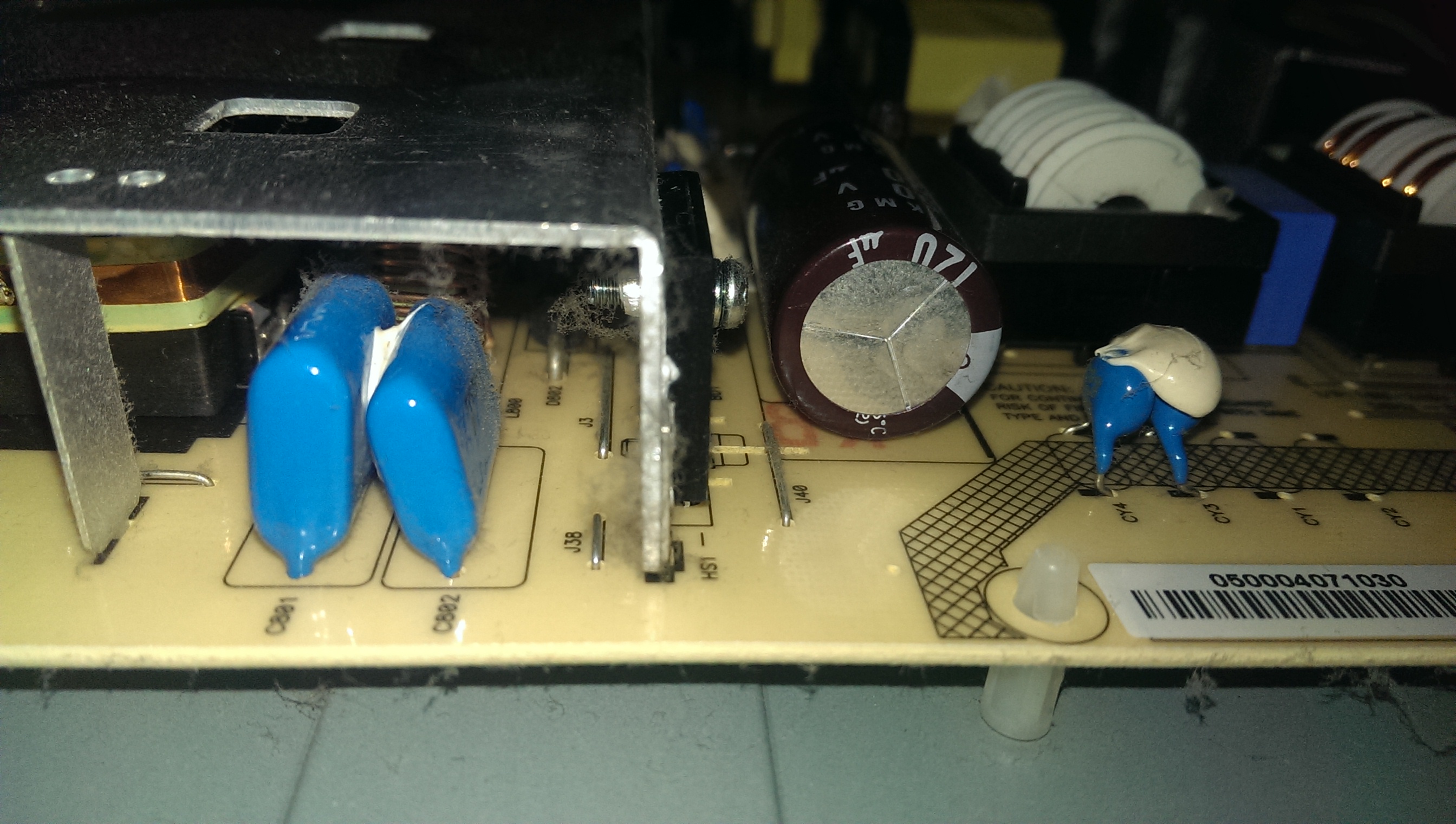

        here are some pictures do you need me to solder off the metal shields on the board to the left if so I can and then I can post more pics also let me know if I could get any closer and where you would like closer pics. also if I uploaded the pictures wrong just say something I am new to posting in forums and would appreciate help so I don't piss off the guy who could potentially help me

          A lot of Vizio sets had a bad PROM--that would cause this. Come up to the logo--or the V symbol on--then down. Sometimes the PROM can be flashed--and that will fix the set.

            Sounds like bad U18 EEPROM issue. They are for sale on Ebay.

              Thanks for the help so just buy a new u18 eeprom and replace it on the board and it will most likely fix the issue?
