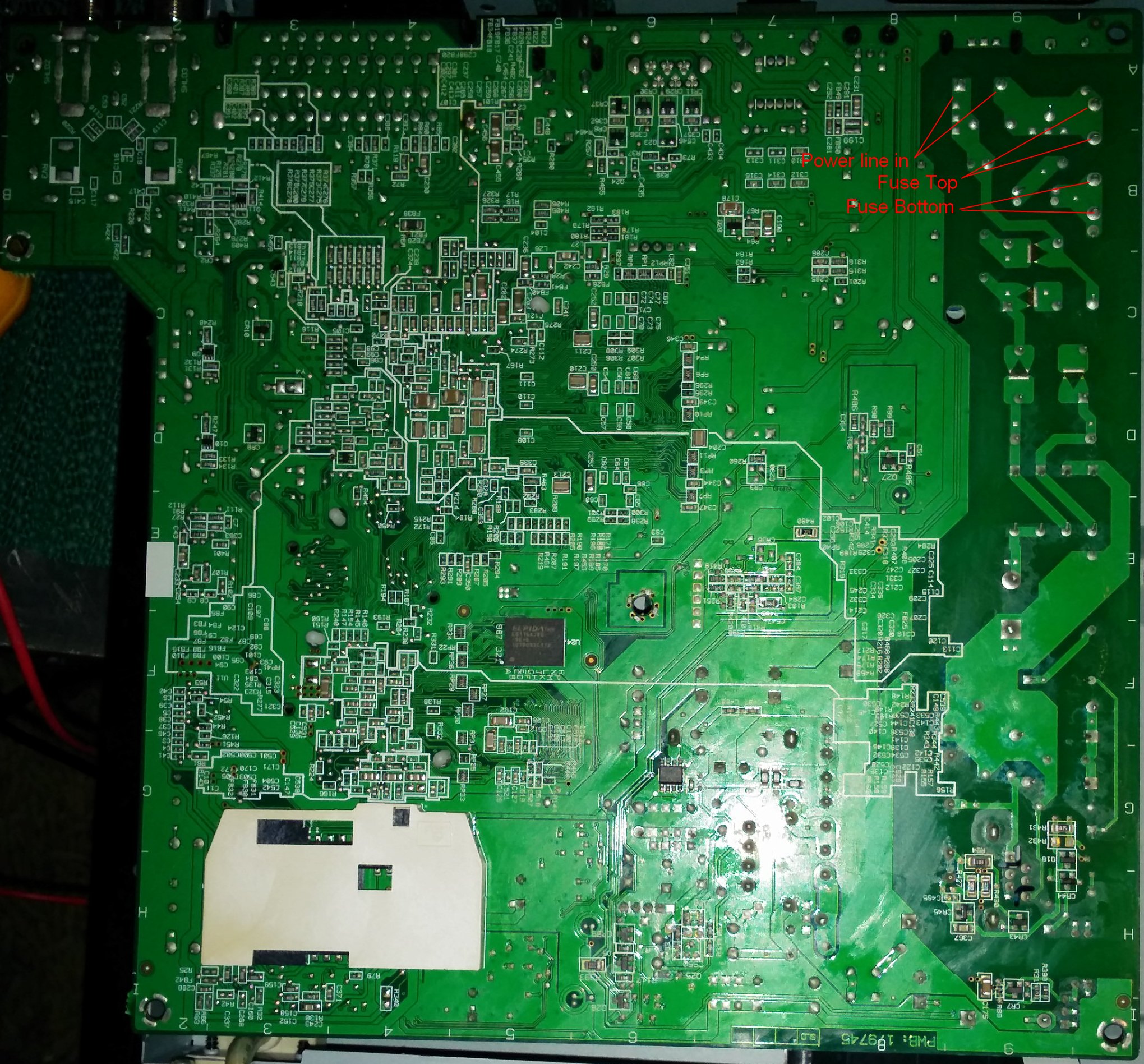

        Yep will get some. however more of an update first.
        I couldnt believe I was only getting 17v on the fuse so I re-evaluted my testing.
        On the Hot side, if I place my multimeter on the ground to the Neutral pin on J1 (power input) and test various points, I see I am getting 240v through the fuse, and power seems to be going through to aother test points on the main board.
        If I ground the multimeter to the chassis instead, then I can only read 17v through the fuse.

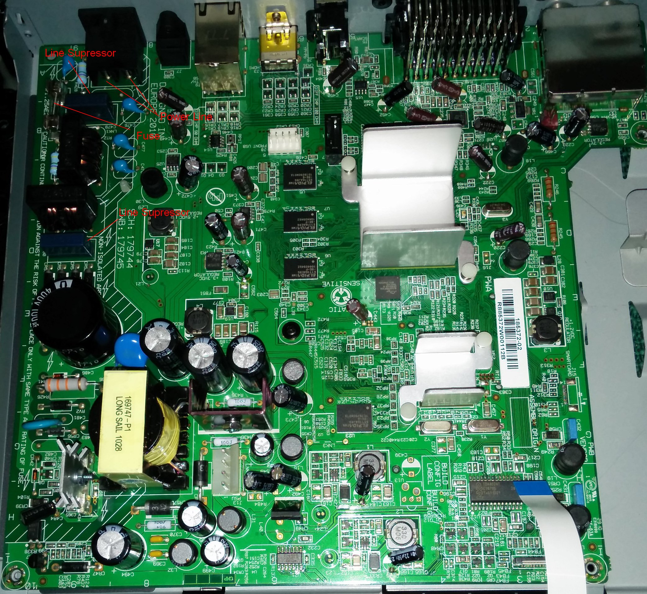

                  pics attached as requested
                  Since learnt that the Okaya is a line noise suppressor

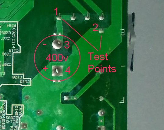

                                  So are you saying that if I test points 3+4 I will get different reading than what I would testing points 1 and 2 on the attached screen shot? Only difference being I am testing the top side points of 1 and 2.
                                  I would have thought they would return the same results being on the same part of the track?

                                    Re: echostar hds-600
                                    I'm going to go out on a limb with my rudimentary electronics knowledge and say you're ok to measure there. When is the last time you changed the battery in your DIMM ?

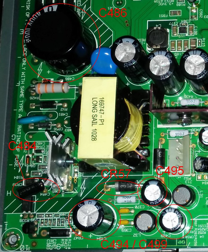

                                      Hi Again.
                                      OK so I tested again on the reverse side on the cap points, and found the following;
                                      Multimeter set to DC, C486 returned results 322-323v
                                      Also checked the reading from the topside two point I mentioned previously, and it returned the same results. Difference was I was testing in AC not DC.
                                      Also on hot side, cap C484 fluctuates from 11.5V down to 8.8V and then cycles.
                                      on cold side, some more test point results
                                      CR57 is returning a fluctuating value - resting as 12v but ramping to ~150v and dropping down to ~50-75v, then resting at 12v again. what does this imply?
                                      C494 and C499 are at 11.94V
                                      C495 Could get no reading from
                                        Aha! You're on to something there. Unplug the device, pull the board out and replace C484 with one of same uF and volts and see if it powers up.
                                        If it does not, and still fluctuates, you've got a short on the secondary side. But i'm fairly sure that cap alone will fix the problem.
