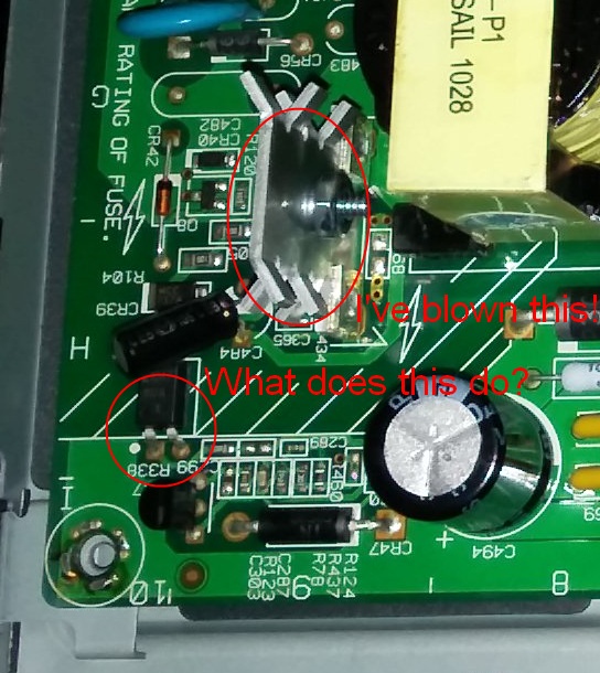

          Figured I better check some of the items between the good large cap and the fluctuating small cap, and one of the items was a Power IC, model Q0456R.
          Looking at the bottom right of this IC there is a small mark, so I suspected that may have blown. Decided to test on top side and during my testing, I think I managed to short pins 1 + 3 and got a big bang.....
          Pins are now scorched, so ordered a new one to replace it as if it wasnt broken before, I am sure it will be now!
          Suprisingly it doesnt look like its blown anything else either so here's hoping that everything else is still good.
          Still, its going to take a little while to get the part (Ebay, China) so will advise what happens when I get and replace that part.
          Here is another thought I have had (seen this method used on a dell monitor previously) - Could I disconnect the PSU component and use an external PSU wired to the right points going to the main controller board to power it instead? How do I determine what output is required and to which pins?
          I see 6 pins (3 sets) coming from the yellow coil - I guess this is ground, and two independant power rails - but what voltage would they be.
          Also, there is a little connector at R338 (?) that takes two pins from hot to cold side (see H01 area on pic 2 from previous posts. What does this do?
            Anyway see attached.

              That's an optoisolator. It provides feedback from the power supply output back to the controller IC so it can regulate the voltage. Most likely in conjunction with the TO-92 package device next to it, which is probably a 431 voltage reference.
              And of course provides isolation between the hot and cold sides of the PSU.

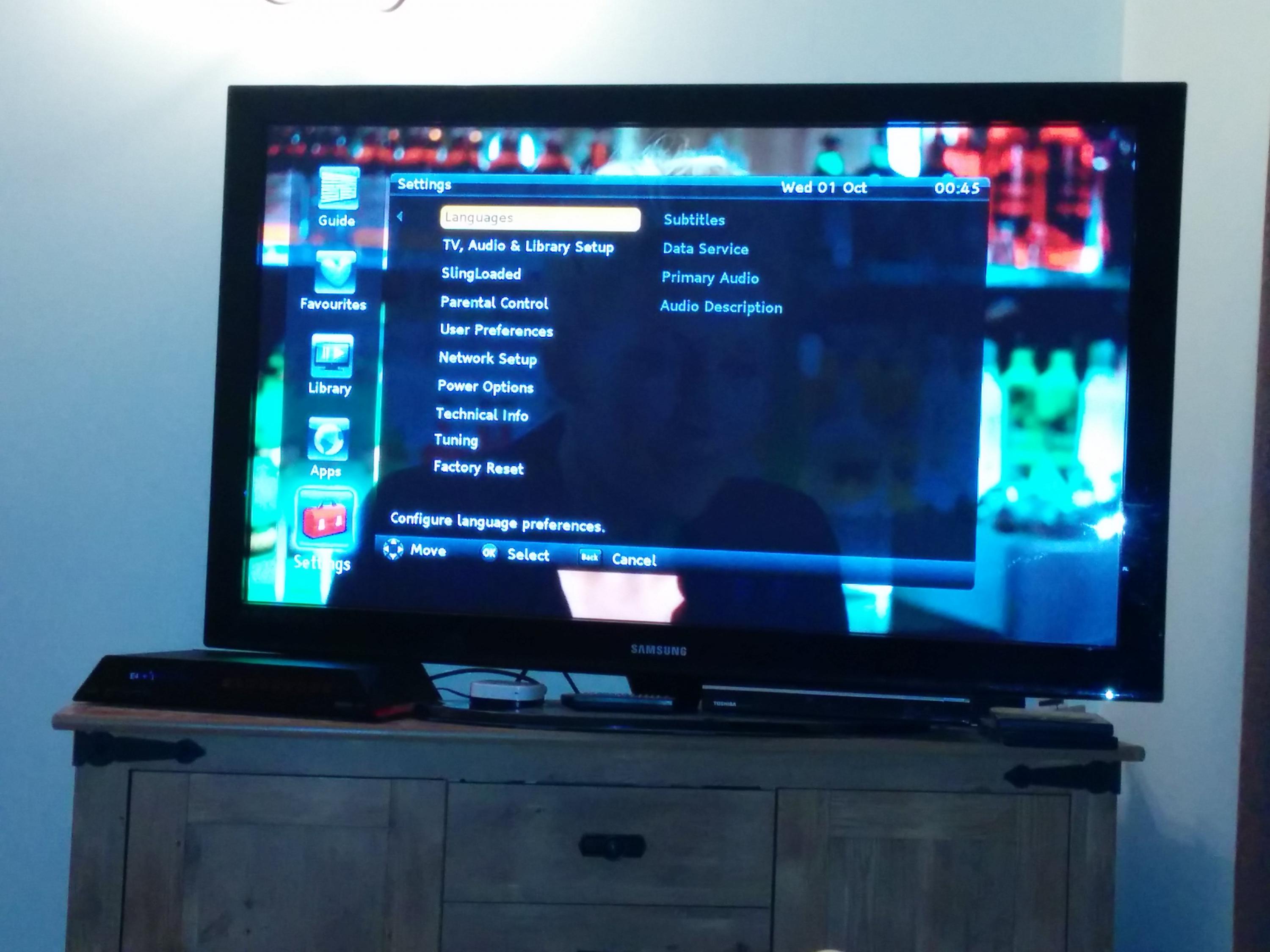

                                        Case closed.
                                        Having discovered that a laptop hard drive works, and after trying to desolder two caps and struggling - i have decided to leave a laptop hard drive in.
                                        I have placed a 1TB drive in, so should last a while
                                        Lucikly a laptop hard drive fits just nicely on an angle with two screws holding it in underneath.
                                        Couple of pics attached.
                                        Thanks for all the help guys - I can recommend this gizmo for freesat - its great!
