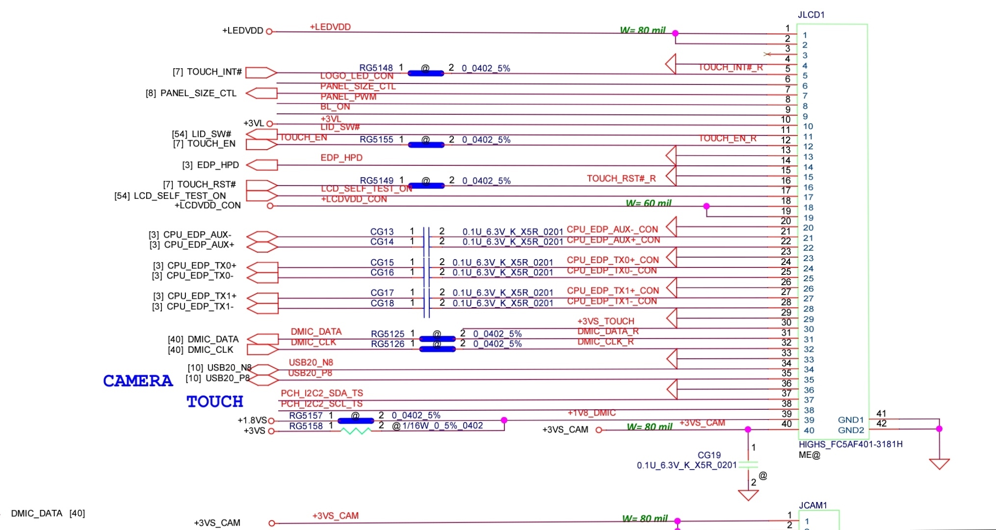

    Hi
    Schematics here on post #9:
    https://www.badcaps.net/forum/troubl...98#post1718498
    Measure for resistance to GND on both sides of the fuse, with and without the LCD cable plugged in, you should have a high value of several Kohm
    Check your soldering on the LCD connector
    From the schematics on page 40, only pins 1 and 2 are the backlight voltage +LEDVDD after the fuse FG1, pin 3 is not connected on the LCD connector on the board (should measure OL on resistance to GND without the cable plugged in)
    Please post close up pictures of the LCD connector area

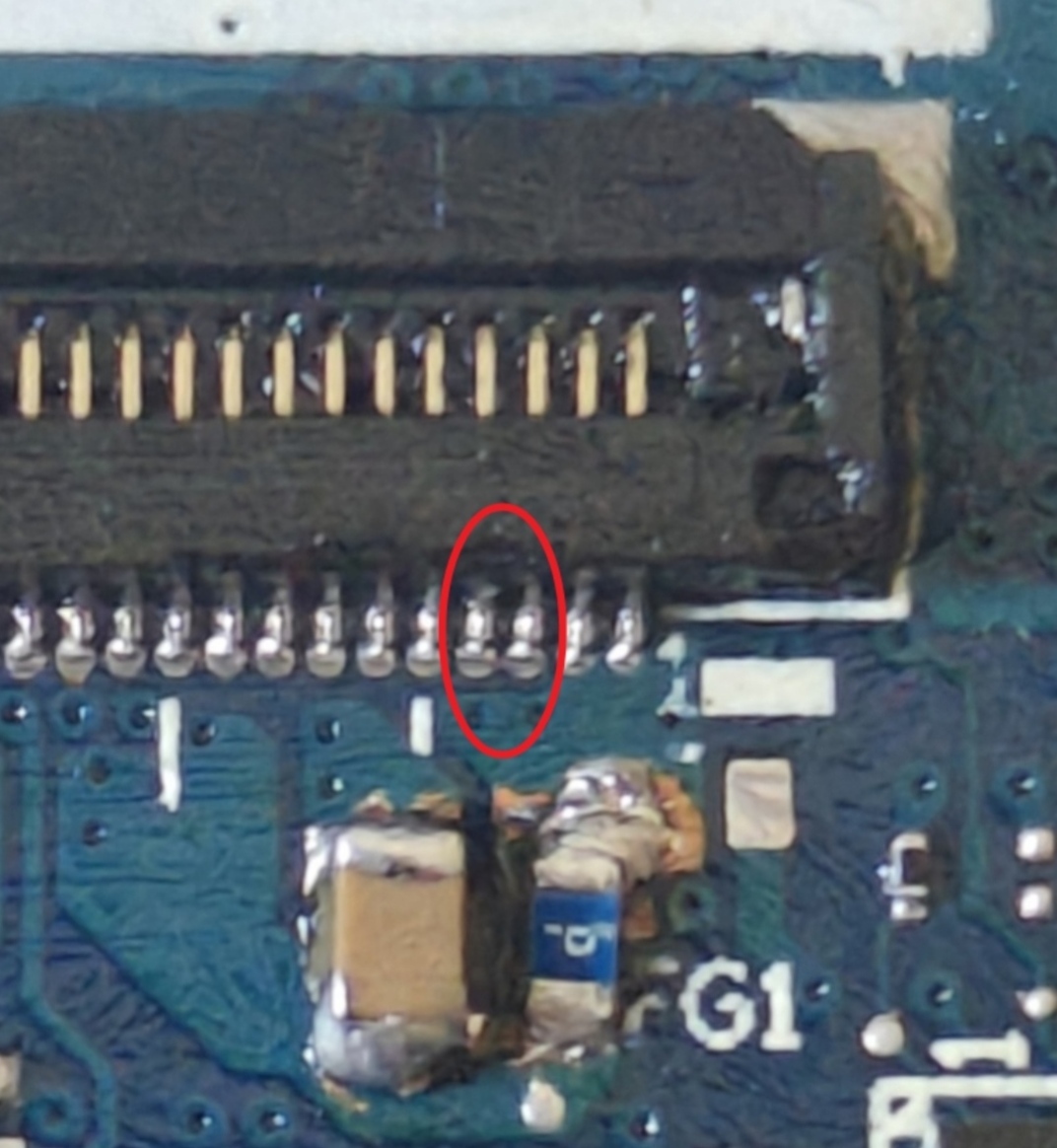

              Could it be a very tiny solder bridge here?
              Add flux and touch the soldering iron to those pins, inspect carefully for solder bridges
              While the solder joints on the cap and fuse look questionable, right now they "work", you really need to use more flux when soldering
              From the schematics, pin 3 is not connected, pin 4 is GND, on the first picture, start counting the pins from right to left
              The only possibility i can think, is that pins 1.2.3 are connected on the LCD cable side, yet on the board side only pins 1,2 are connected and pin 3 is NC
              And you have shorted pins 3,4 on the board
              With a sharp probe on your multimeter, test continuity from pin 3 (counting from right to left) to GND, it should read OL
              Measure continuity of pin 1 to pin 3 on the cable to be sure
              So, while plugging in the cable, pin 3 (shorted to pin4 on the MB, gets connected to pins 1,2 (by the cable)

                  Okay so without the cable 4 pin is short to ground ,but 3 pin is NOT shorted to groud.
                  When i plug in either another screen or the old cable again it shows 3 + 4 pin short to ground.
                  So maybe there is another error somewhere else?

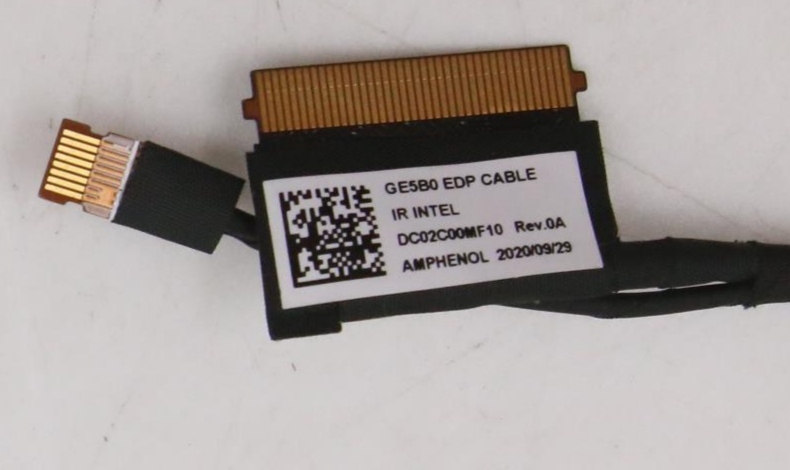

                    Maybe you got the wrong cable for your laptop? Unless you can check with another laptop of the same model/type/same board number
                    I checked the schematics of another board NM-C421 (E14/E15 gen1), while the FPC connector is the same 40 pins, the pinout is completely different, starting with the first 4 pins are connected to the backlight voltage, that could explain it
                    You mentioned the old cable was burnt at the end, I wouldn't use it
                    I suggest visually checking the ends of both original and replacement cables under a microscope

                      Yes, it's direct original replacement.
                      Yes, i already did that, until you wrote the message because i didn't know what to do .
                      It's Gen 2.This laptop.
                      Yes, the old one had a burn mark in the pin 1-2-3-4.
                      Yes,i tried the original also from the other laptop but again does the same, thing when the secondary laptop doesn't short.
                      My question to you ...
                      I have removed the screen and also checked the cable to the other laptop , and again turns on just fine.
                      Only to this laptop is the problem .
                      So i have pin pointed down the problem to the bridge...what i mean ? If i connect the cable then it becomes short to ground. If not, then it doesn't .. i mean if i dont' install the cable, even without the fuse it remains the same.
                      What could speak with 1-2-3-4 ,which controller that does that? Maybe the controller of the pins 1,2,3,4 is burned and problematic. So when you plug the cable, then it makes the chip to go short...

                        There's 2 versions of the E15 gen2
                        According to Lenovo parts search
                        https://pcsupport.lenovo.com/us/en/p...isplay/buy-now
                        The models with Intel CPU (the one you have) (Type 20TD/20TE) uses display cable FRU: 5C10Z23917
                        The models with AMD CPU (type 20T8, 20T9) use a different display cable FRU: 5C10Z23842
                        They're not interchangeable, and that could explain it
                        I checked the schematics for NM-C771 (E15 gen2 AMD) and the pin out of the LCD connector is different, with pins 1-4 connected together
                        That's why I mentioned the "machine type" also needs to match, it's printed on the back cover
                        So I'm guessing you have an E15 gen2 AMD (the working laptop), and this one you are repairing E15 gen2 Intel and you're trying the screen/cable from the AMD laptop on the Intel one...
                        It's the first time I saw that a manufacturer uses different display cables but using the same chassis for the Intel/AMD versions, so you can't easily swap an Intel board with an AMD board or vice versa

                            I checked again the Lenovo parts website, and got this
                            Search for "edp" and I get 3 different cables for type 20TD (Intel)
                            CABLE FRU CABLE EDP CABLE RGB
                            Part No: 5C10Z23918
                            FRU CABLE EDP CABLE RGB TOUCH
                            Part No: 5C10Z23919
                            Mars1.0INTELFRUCABLEMars1.0IntelEDPCABLEIR
                            Part No: 5C10Z23917
                            The one with "touch" looks like it's for a laptop equipped with a touch screen, but the other 2 the difference is in "IR" or "RGB", whatever that means (and this one says Intel EDP cable)
                            But for the type 20T8 (AMD) i get this
                            FRU CABLE EDP RGB Cable
                            Part No: 5C10Z23842
                            CABLE FRU CABLE EDP IR Cable
                            Part No: 5C10Z23841
                            No touch screen option for the AMD version, again, different part numbers than the cables for the Intel version
                            Lenovo sure makes things confusing

                              I am not sure. hahahah!
                              Both laptops are Intel ones. Both laptops are non-touch versions.
                              My cable the new that i have in front of me: Lenovo Thinkpad E15 Gen 2 LCD Video Cable DC02C00LD00
                              But i keep believing that something is wrong with the "pins all together" i mean the 4 pins that are getting their signals most probably from another controller chip ?

                                  Google search brings me this Ebay listing
                                  Screen Display Cable IR For Lenovo ThinkPad E15 Gen 2 5C10Z23841 DC02C00LD00
                                  According to part number, that cable is for the AMD version...
                                  You got the wrong cable, you need to get one suitable for type 20TD that would be:
                                  5C10Z23917
                                  Click image for larger version  Name:	IMG_20250512_092701.jpg Views:	0 Size:	87.4 KB ID:	3635535
                                  (Image taken from Lenovo parts site, cropped the relevant portion)
                                  It says "GE5B0 EDP CABLE IR INTEL DC02C00MF10"
                                  Perhaps the IR means for an IR camera? (As in, for face id/windows hello)
                                  The other cable 5C10Z23918 I guess is for a regular webcam
                                  The pins are connected together on the cable itself, so plugging in the cable without the screen attached to it would cause the short
                                  Could it be, that your customer (or someone else) replaced the LCD cable with the wrong type, causing the burn on the cable and a possible short on main rail, then brought the laptop to you for repair and the liquid damage on the usb-c port was a secondary fault?
                                    5C10Z23917
                                    Yes, you are right most probably it was changed, before it came to my hands and that's why it was burned those lines.
                                    I have just placed an order from eBay (China} so it will take 2-3 weeks to arrive , the correct part number as shown from lenovo (yours) .
                                    So i believe this time it will just be fixed.
                                    If not, i will just jump out of the window...
