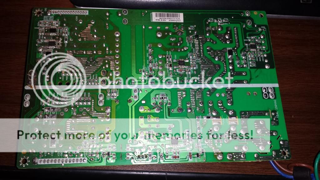

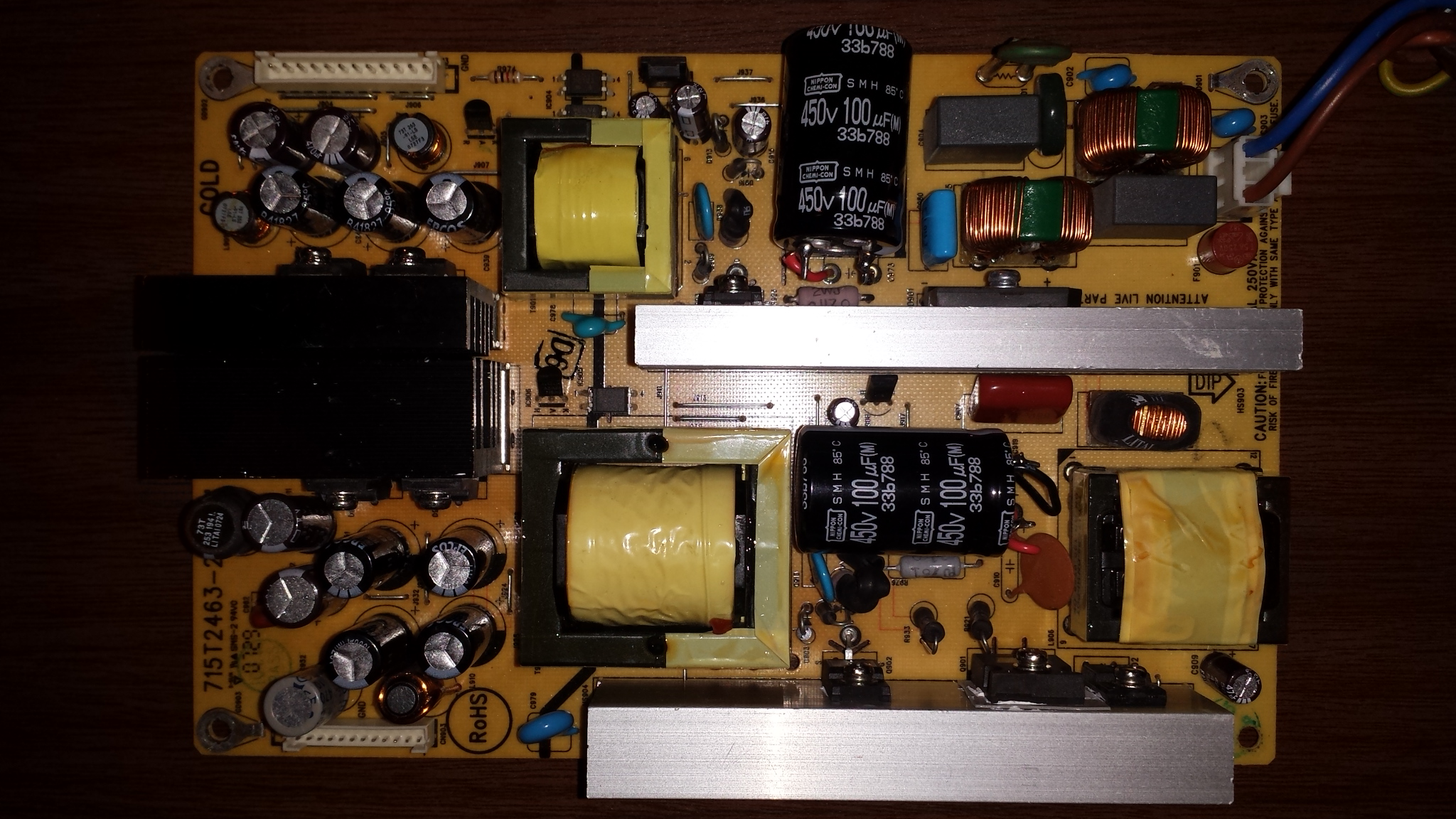

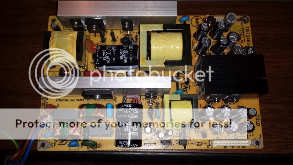

    Oh and heres the pictures!
    Please let me know if I need to take closer shots of certain areas!

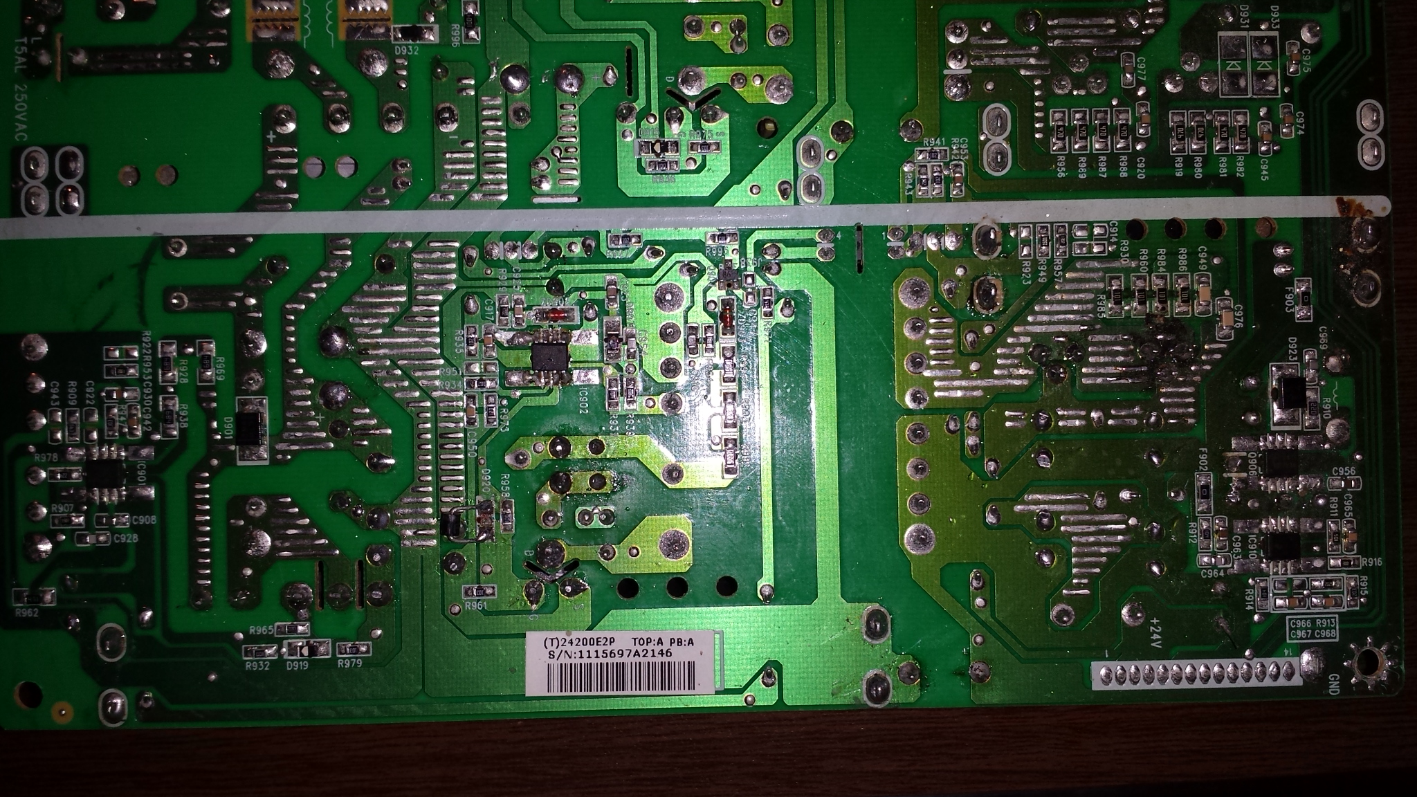

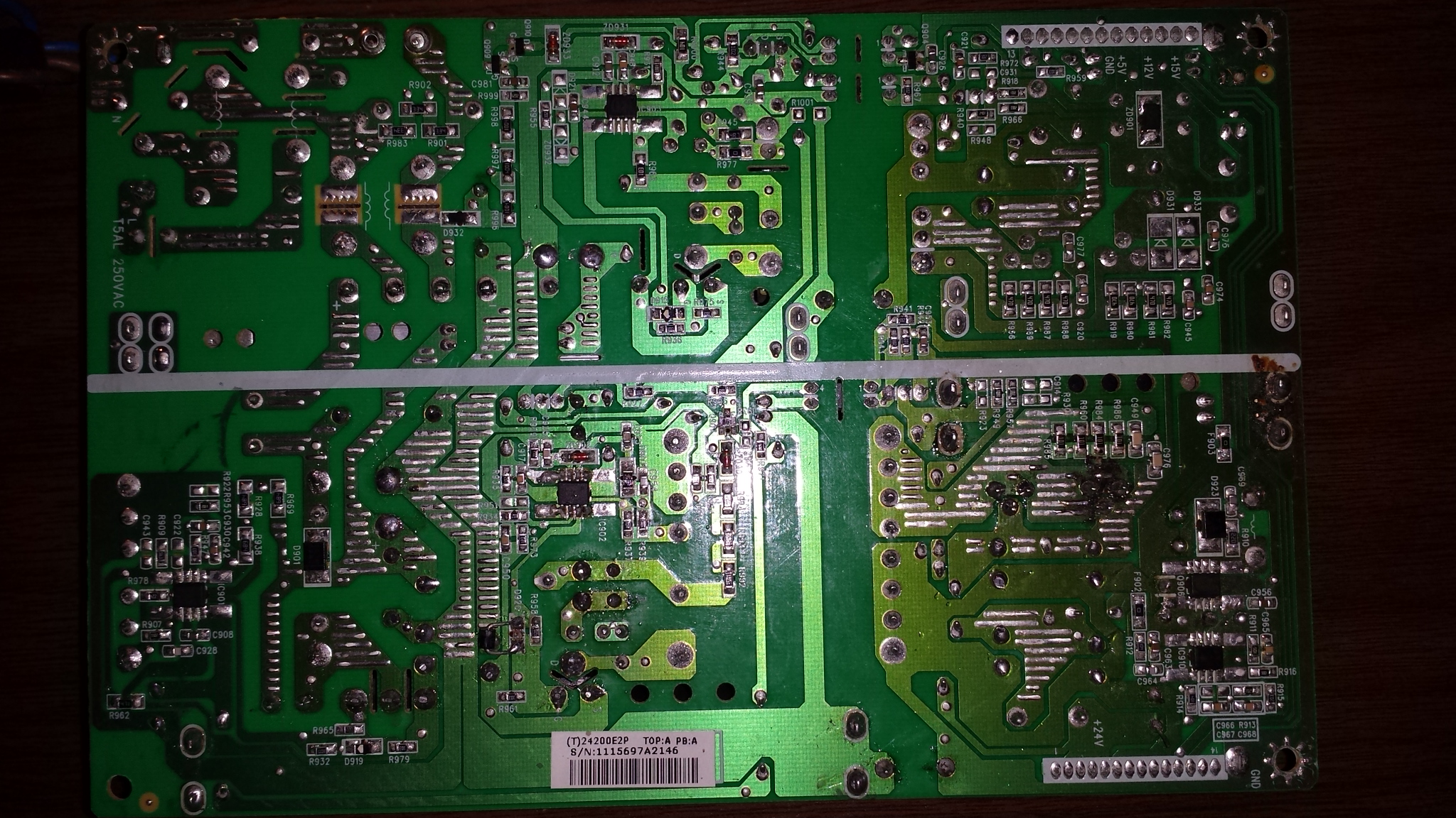

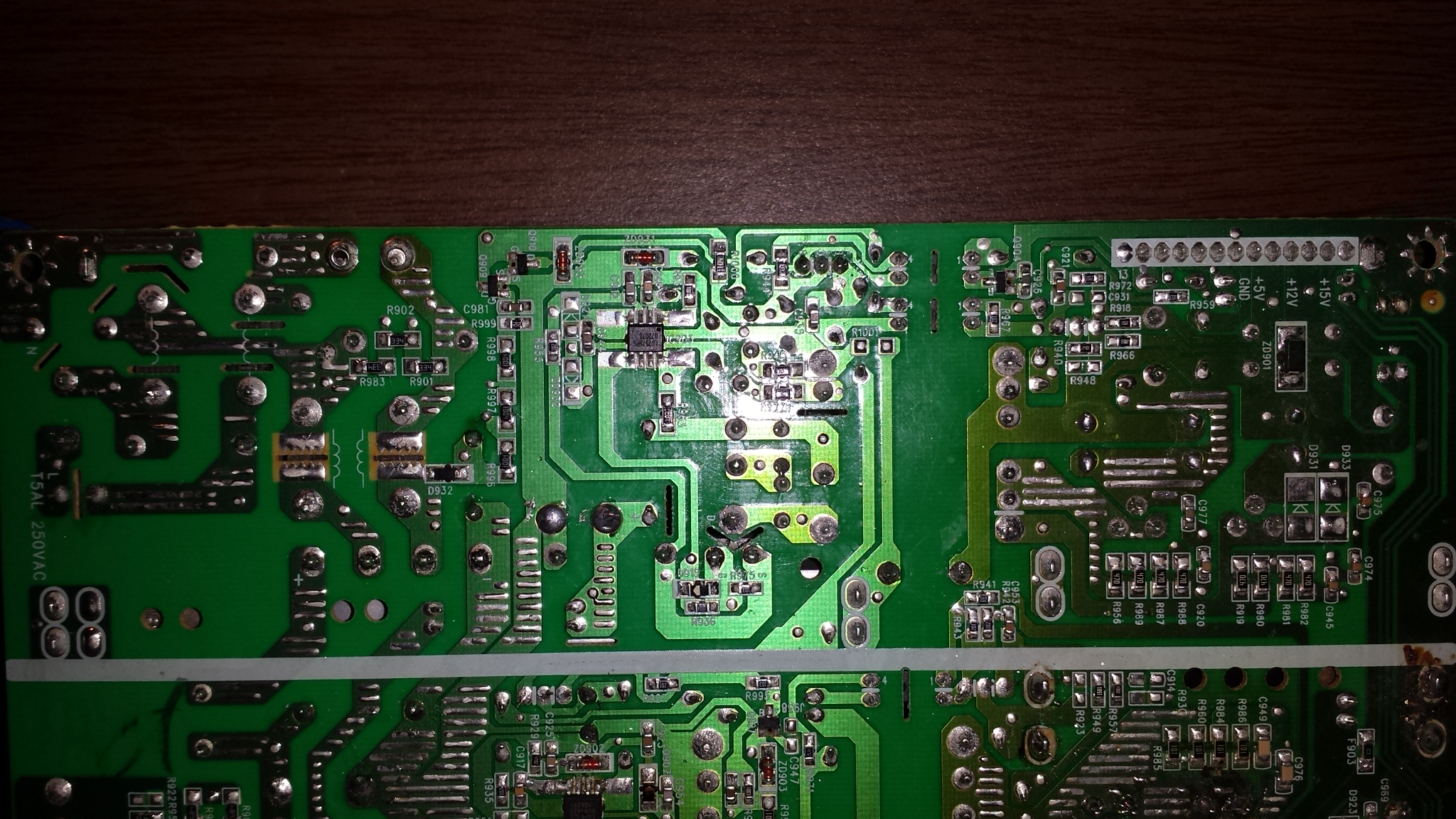

            Re: Dynex dx-lcd32 power supply half dead
            Can we get the straight shot pictures of the board, both sides? Also bottom side in small sections so I can clearly see the traces.
            • selldoor
              Slow Learner
              • Dec 2010
              • 7870
              Pictures should be JPG (max resolution 2000x2000 and 3MB) using the manage attachments button, which is found by clicking "go advanced" under quick reply.
                Thank you for the responses everyone! I am sorry about the picture issue, I'm used to other forums that operate differently. Was just a habit to upload from the cell to photobucket
                Ok here are the updated pictures budm asked for. Please let me know if the pictures are useless so I can fix them.
                Also if it makes any difference, this thread has the same powerboard with the other users pictures.
                https://www.badcaps.net/forum/showth...light=dx-lcd32
                One other thing to note is I have replaced d920 in the photos as I took the original off to find out it was fine, (replaced it with a legged diode) and as well c932 was substituted to see if anything changed.
                Thanks again!
