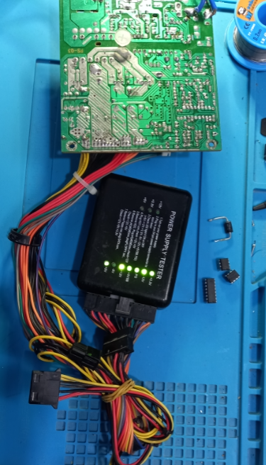

The power supply was completely dead. Voltage reached the main capacitors, but nothing after that.

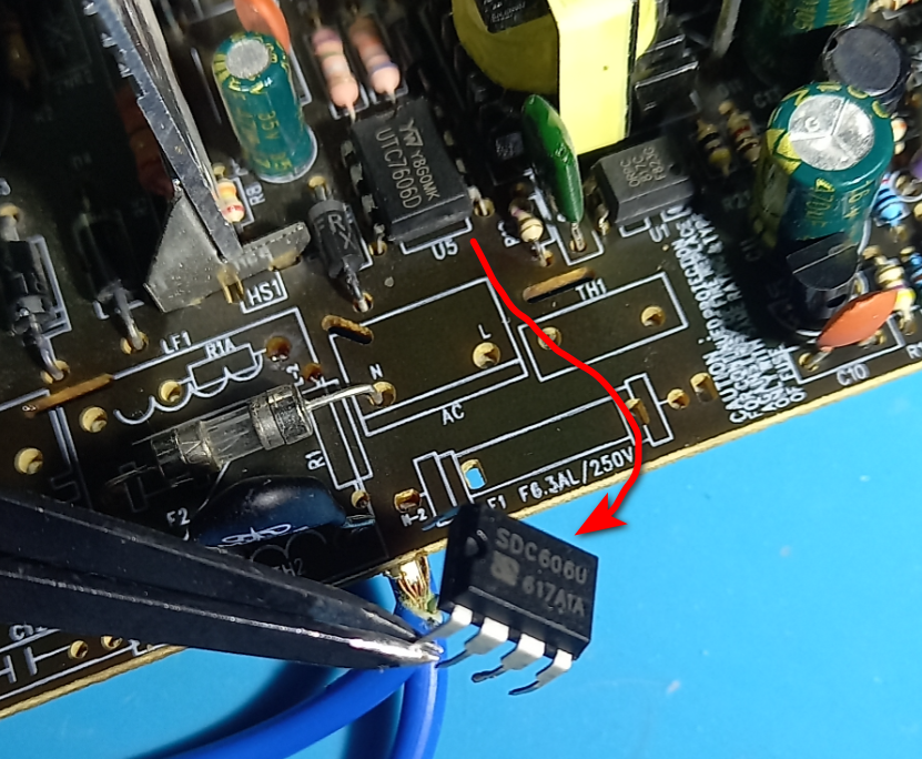

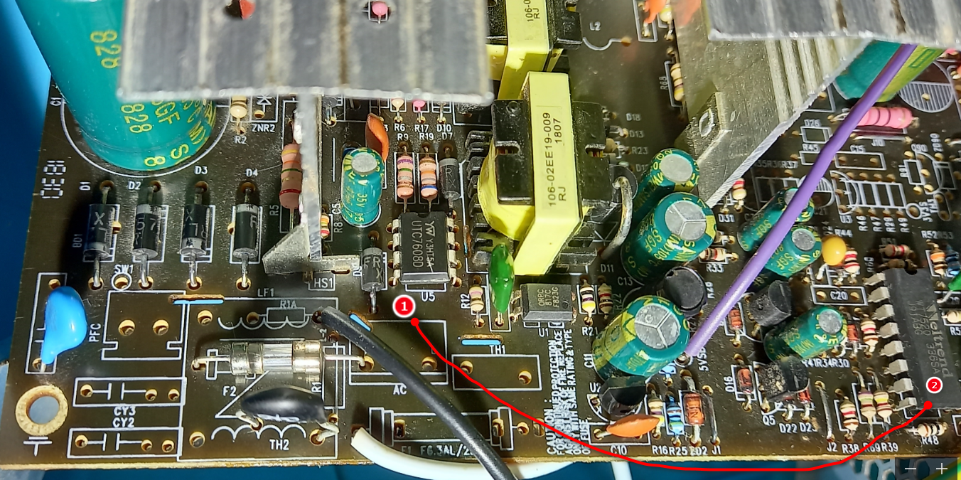

After checking, I replaced the UTC7606D IC to restore the 5VSB.
I using SDC606U as a replacement, but it didn’t work — possibly the IC itself was faulty.
Replaced it again with another UTC7606D.

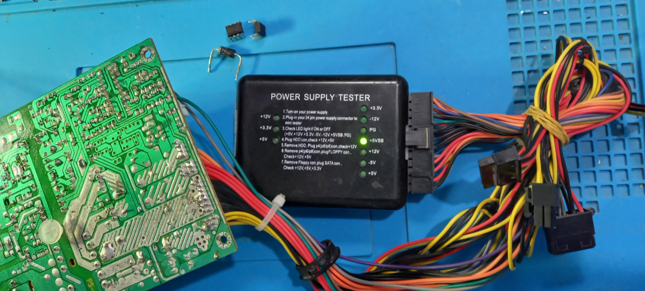

Result: 5VSB came back, but still nothing — no 12V, 5V, or 3.3V.

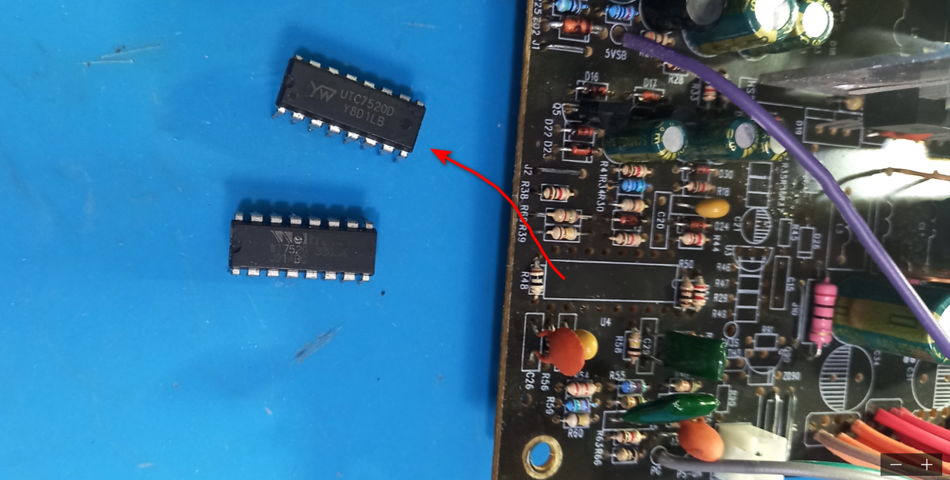

After checking again, I think the issue was with the UTC7520D IC.
Replaced it with a WT7520.

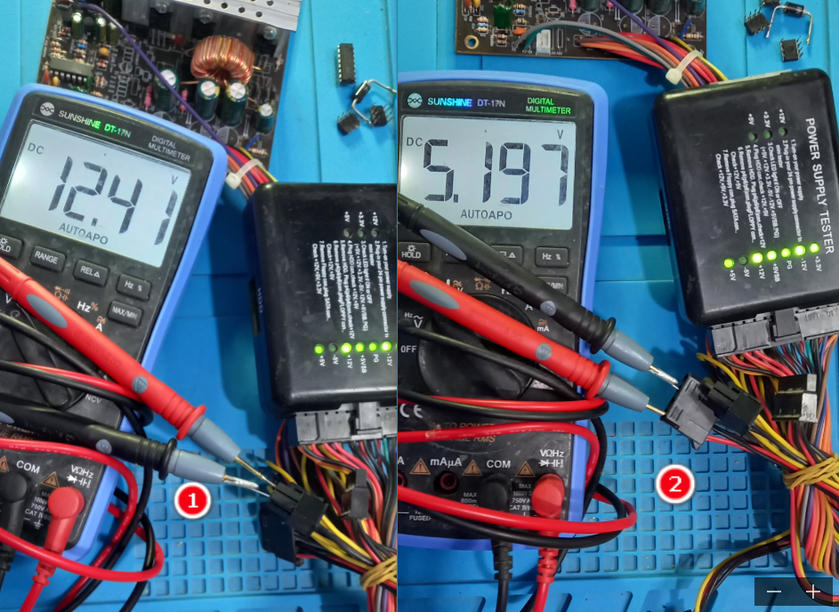

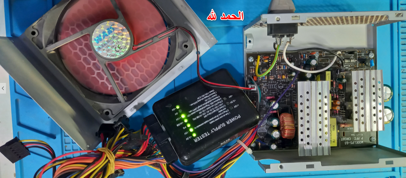

Result: PSU fully working again
My bad.
