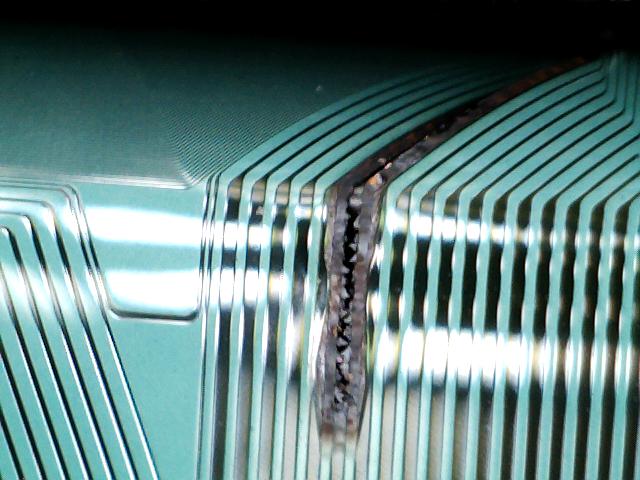

          I pick up a 50 Hisense 50K360G with a blank screen, the owner claim the screen just when blank while watching it. I remove the back cover, and doing a visual inspection of all board found nothing.
          Power up the TV and confirm the problem, back light turn on and the screen was blank. I was able to get sound using the HDMI port.
          Checking the T-CON board, the fuse wasn't blown and +12 volts was present. This T-con board have electronics components on both, very rare to me. Checking voltages on the T-CON regulators all was good.

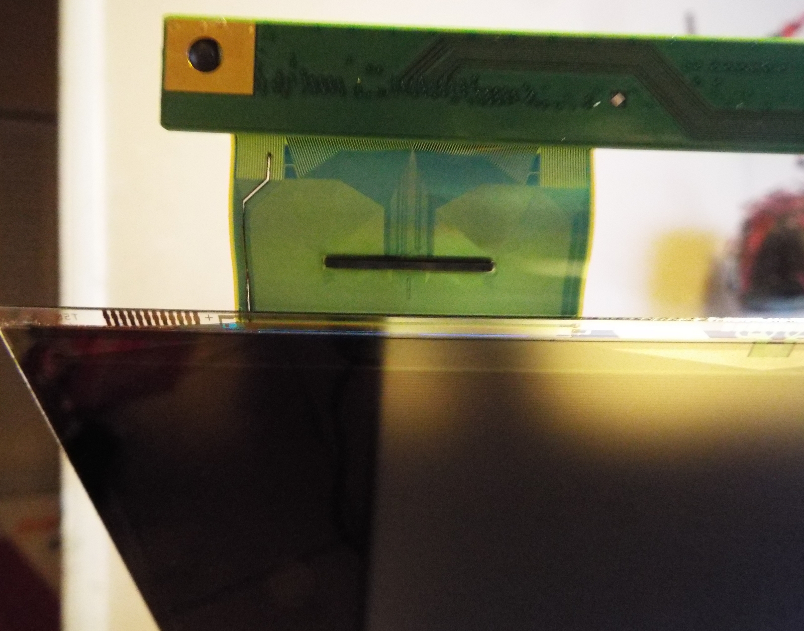

          So I remove the framing around the LCD screen, this is what I found. see picture. This is one of the flat ribbon cable going to the LCD screen. I'm going to attempt to fix this using very thin wire wish me luck !!

            after further review, this can't be repaired, so I'm gotta scrap this unit and sale the parts online.

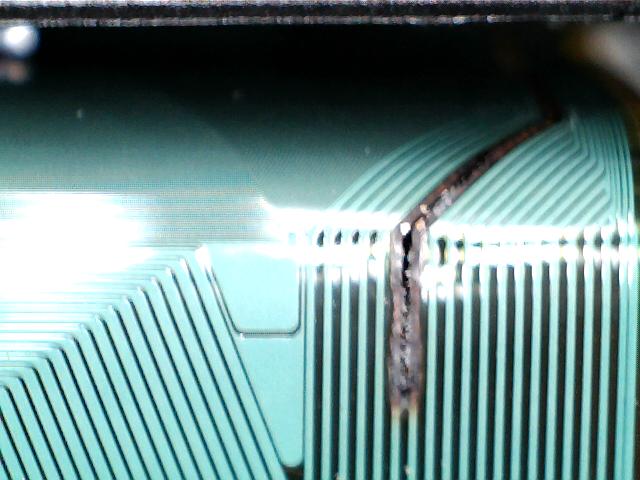

              Here is a better picture of the damage ribbon

                Hense this is the reason why I like plasmas better lol. I just picked up one of these for free last night same exact problem same symptom same burn in the ribbon cable. Absolute garbage but I'm surprised if panel was made by AUO! it appears that there's some kind of rubbing action going on where the ribbon cable meets the metal frame and it rubs through a section of the cable.
