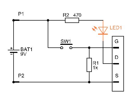

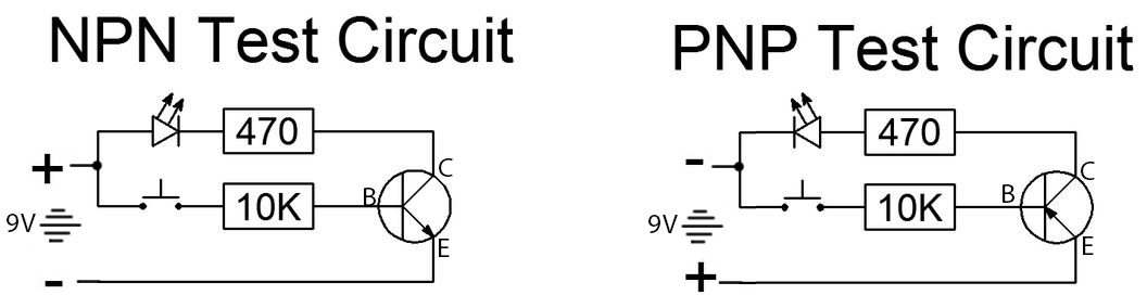

                        I took out an tested, just to be certain, Q1601 and Q1602 according to the following site and the test circuit schematic I attached in post #25. http://www.sentex.ca/~mec1995/gadgets/mostest.htm
                        The both check good according to that site and light up the LED.

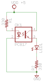

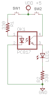

                            I pulled and tested all the optocouplers with the attached test circuit and they all light up the LED. I took that to mean the are good, correct?
                              While a working opto would light the LED in your circuit, so would one with a shorted\leaky transistor. To do a better test on optos you would also need to remove the power to the LED side of the opto and be sure your LED you have connected to the transistor side turns off.
                                  Would adding momentary contact switches seen in the amended attached circuit fulfill that requirement? I drew in two switches but am assuming that I only need SW1 and 5V can still flow/should flow to the transistor to allow for the more thorough shorted/leaky test, correct?
                                  Thank You
                                      Yes.
