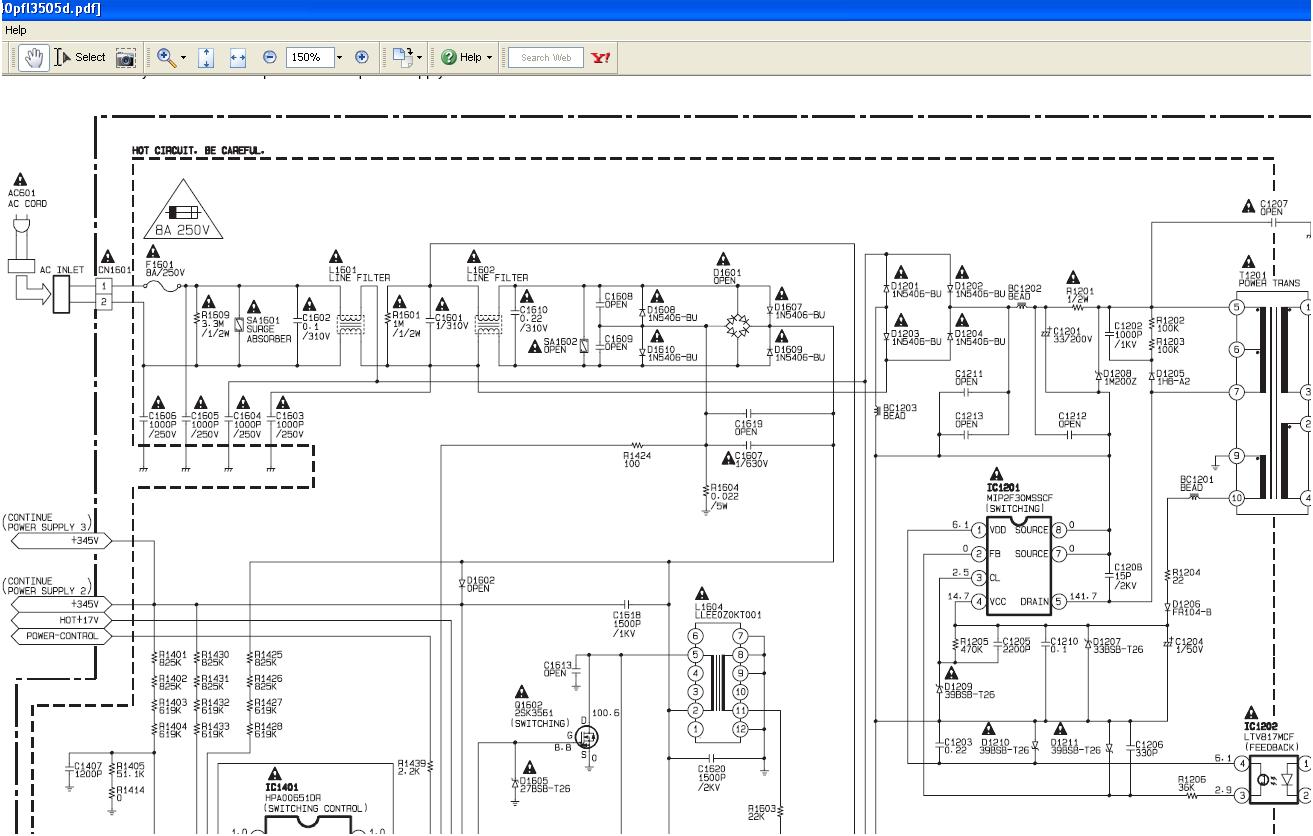

    Board Info here: Pages 10-3,4,5 and 10-17

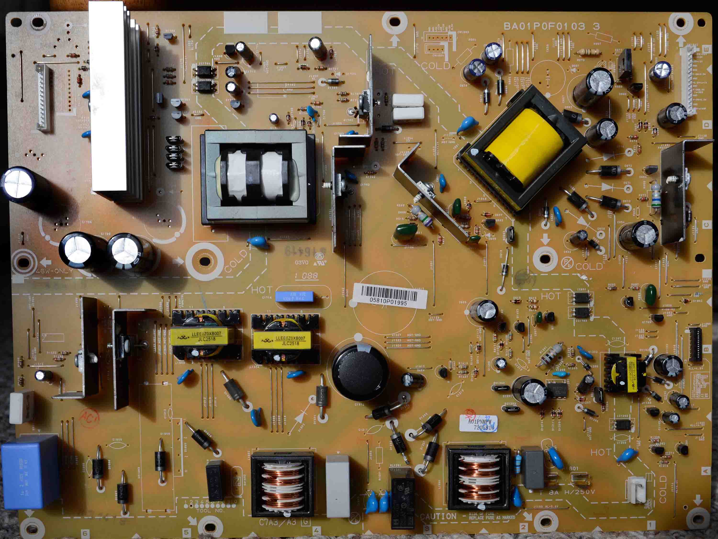

        We might spot something if you post good clear pictures of your boards

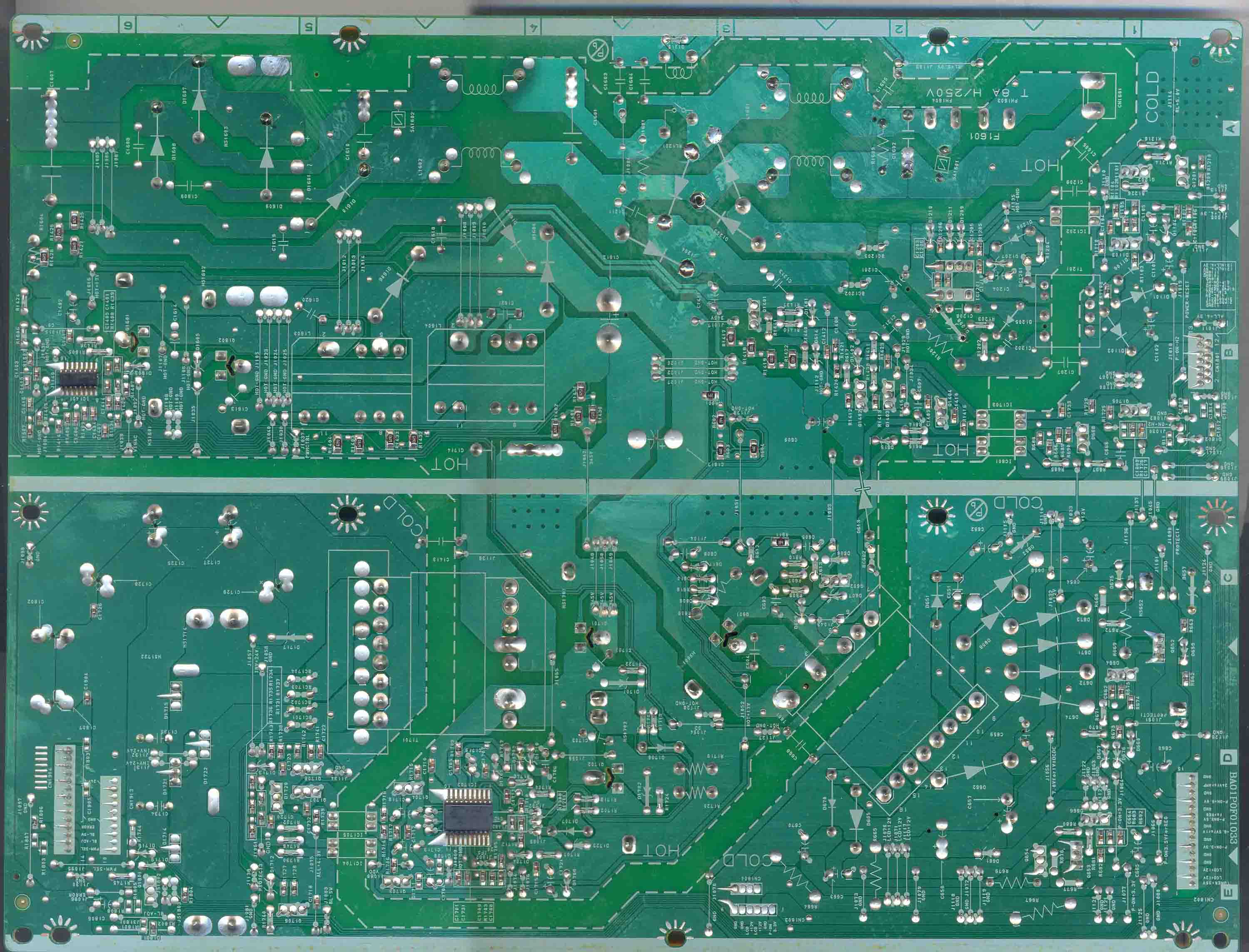

          Re: Philips 40PFL3505D/F7 Blows fuse when plugged in
          Here are pictures of the front and back of the power supply board. Please excuse the diodes at D1201-D1204 I pulled up to check and the missing zener diode at D1208.

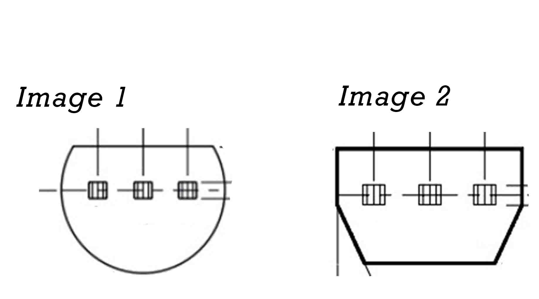

                      First is it supposed to be the view looking down at the transistor with the legs pointing toward you or looking at the top of the transistor?
                      Second to identify their ECB, Some transistors physically look like image 1 and some like image 2 as seen in the attached image.
                      My question is, for both the ones with a rounded side or a chamfered side, is the flat side always the flat side, therefore disregarding whether it is rounded or chamfered, i.e. no matter if the datasheet image physically looks like the acutal transistor would making the flat sides match while looking at it in the correct orientation give me the correct ECB location?
                      I ask this because I had gotten confused because while starting to test the transistors With Q1404, TRANSISTOR KTC3199-GR-AT/P, it is a rounded one and has printed on it 5343 Y043 so that in itself did not make sense to me. Looking at the datasheet: for it it does not show it having a rounded side, thus my above questions.
                      Next. Trying to see what else I should be looking at I came across this.
                      According to Flow Chart 1 page 8-1 of the service manual, disregarding the fact that my fuse still blows, it is possible that IC 1201 and T1201 are bad and is there a way to test them?
                      I think it is possible that both the zener D1208 or the IC1201 is bad because they are parts that the shopjimmy.com rebuild kit references as potential items to replace due to the fuse blowing.
                      Printed on the board is BA01P0F0103 3 and the sticker says A01PNMPW. Crossreferencing with tv models and board numbers seem to indicate that the rebuild kit would be for my board if I choose to go that route.

                        1 orientation of transistor
                        I dont think I would want to rely on a one rule fits all though that might be correct, and if datasheet is not available it is more difficult.
                        I have never even thought about it and always just assumed the diagram
                        was looking onto the bottom with legs towards me. If testing for shorts only
                        I dont think it matters
                        Also it often has the c,e,b marked on the board?
                        This might help https://www.youtube.com/watch?v=b0jCUsenNsY
                        fast foward 1min.
