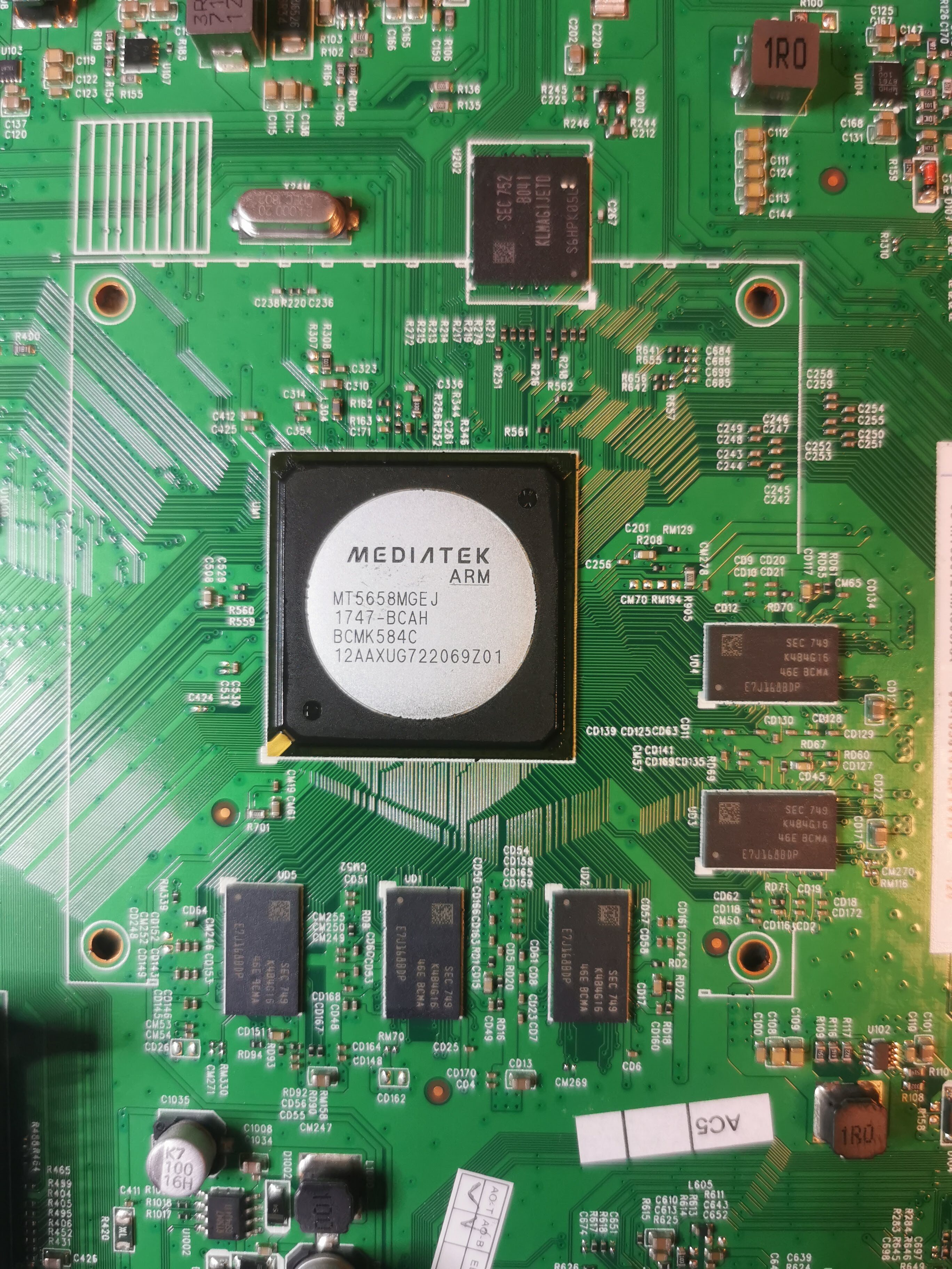

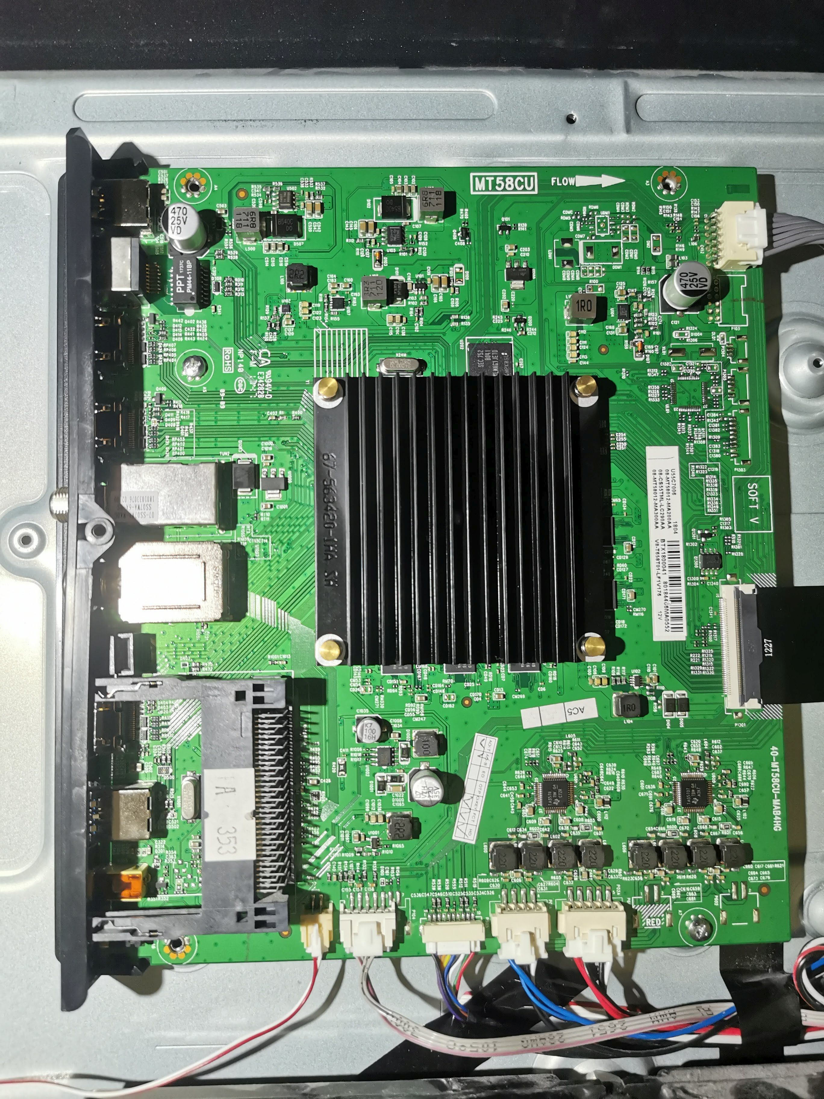

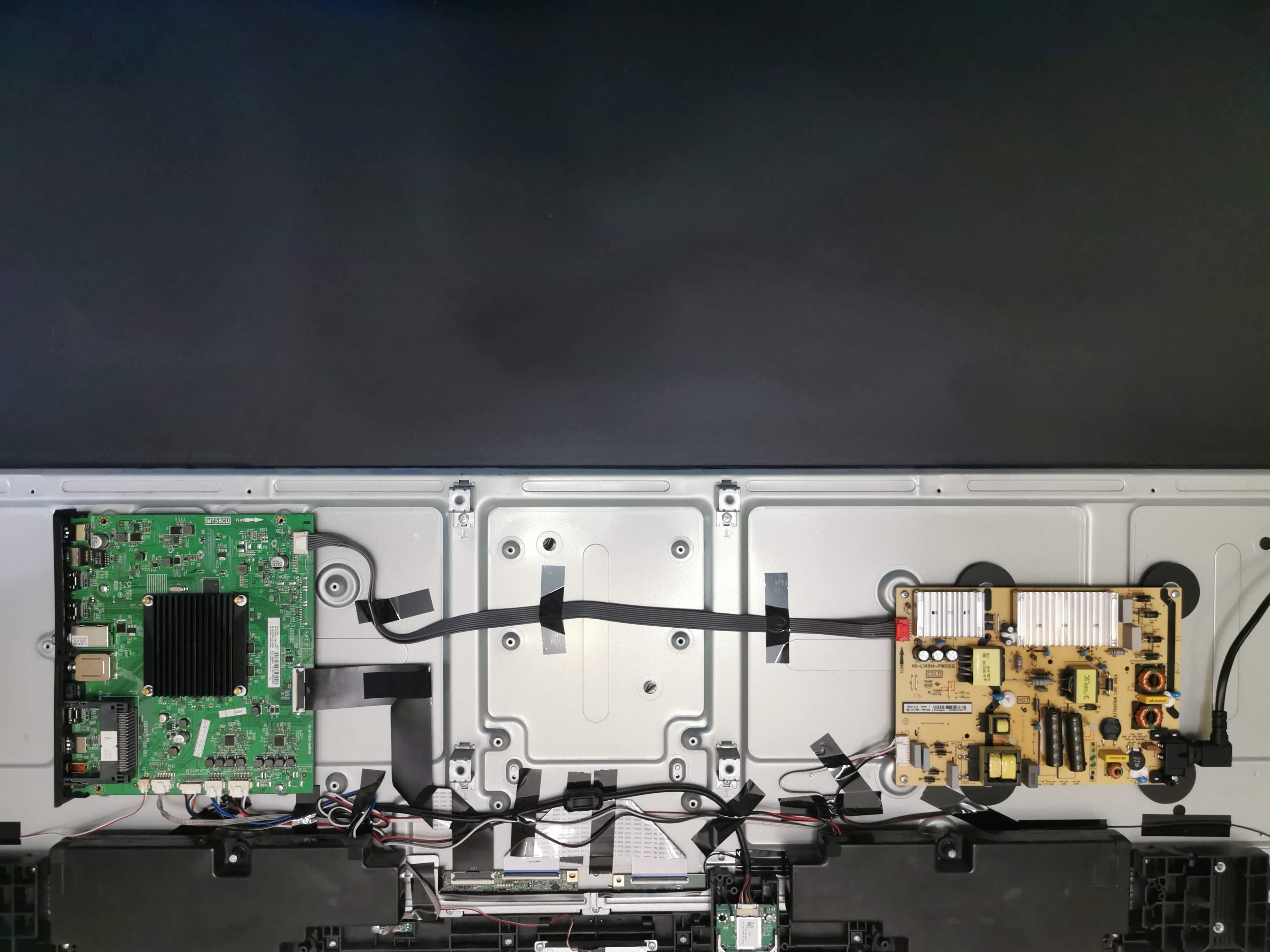

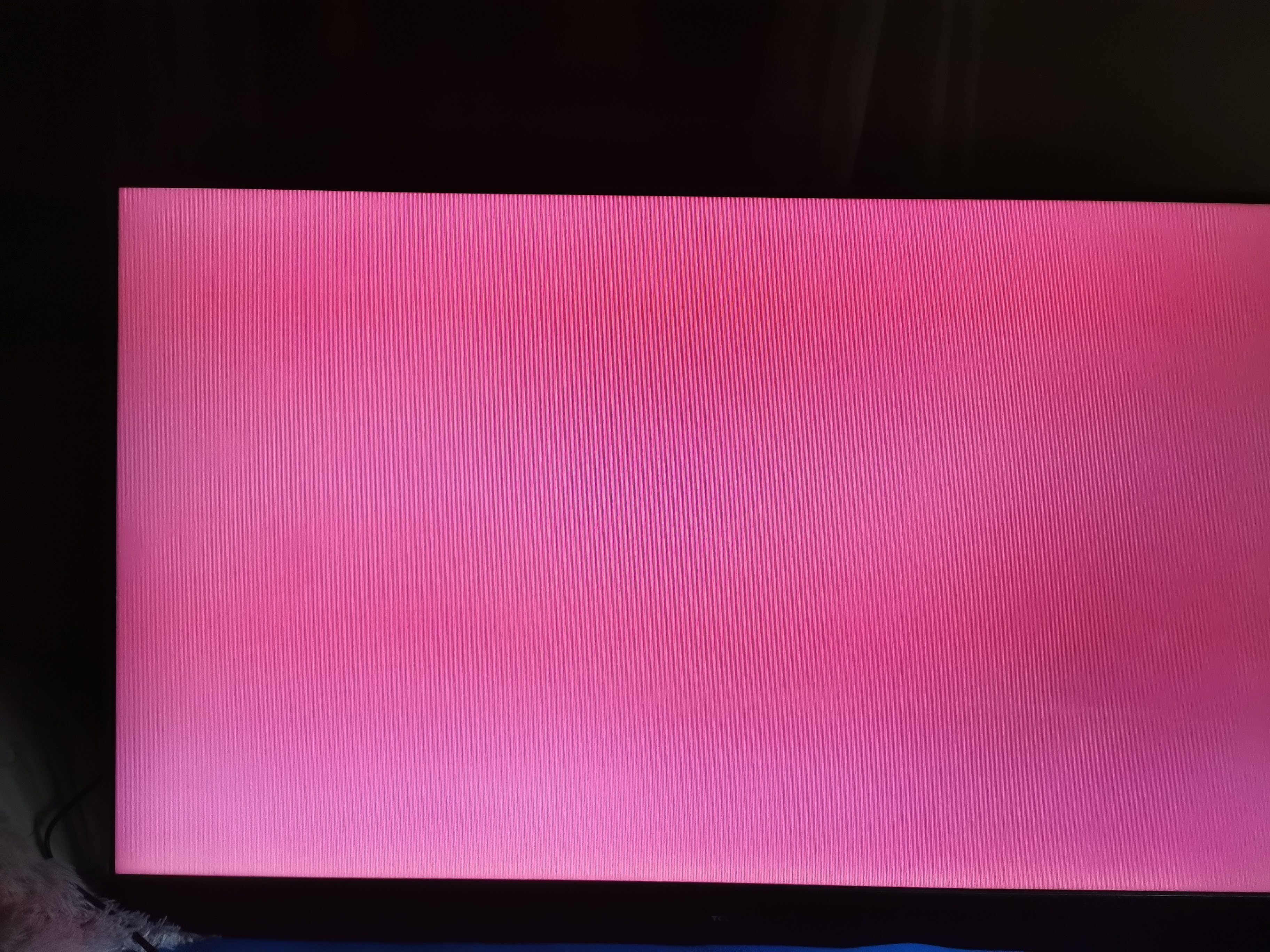

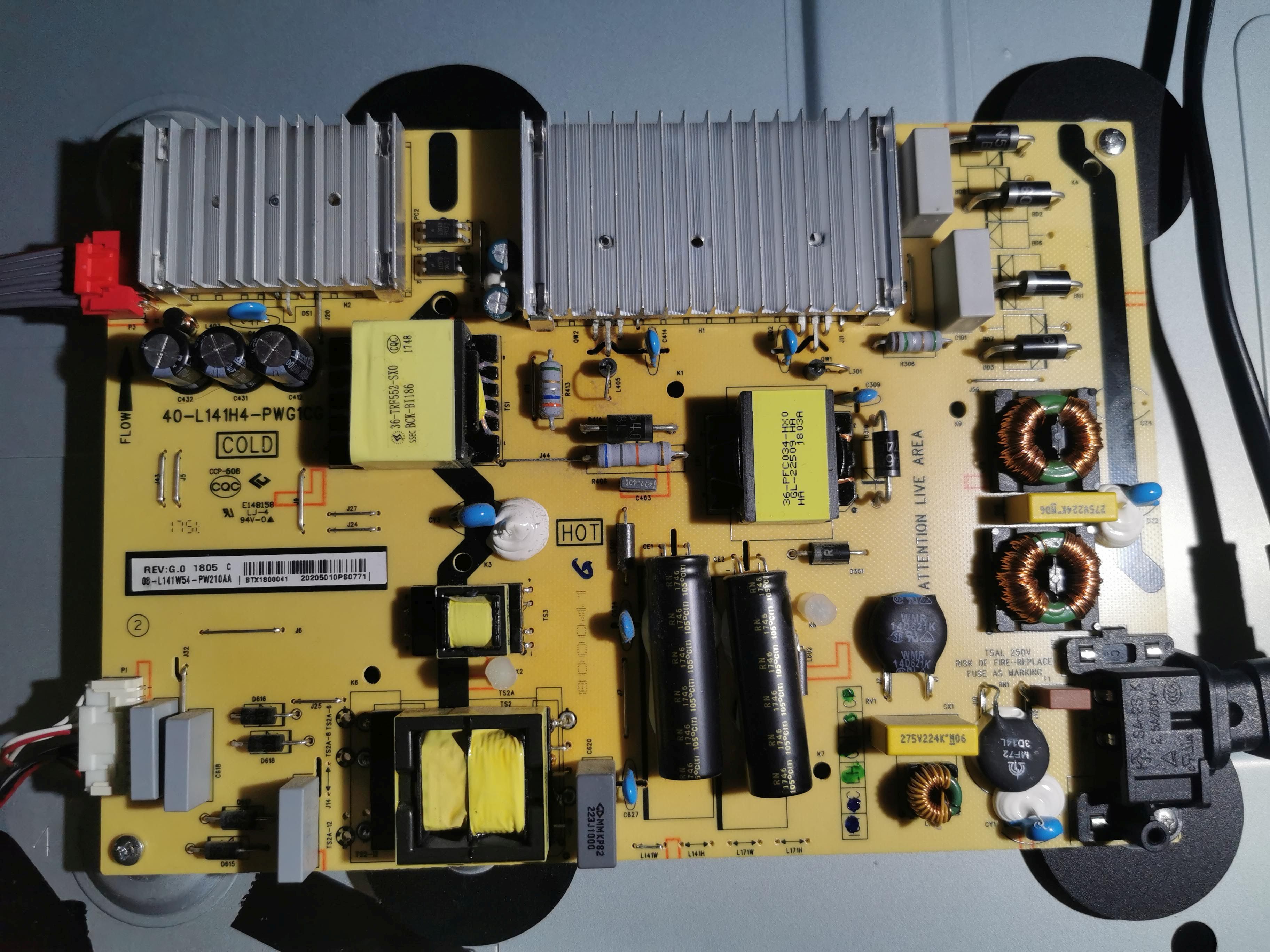

    Can you post some clear straight on pictures of each board and one of the whole back as to see how everything is connected. And one of the pinkish garbage.
    • janos6662000
      • Mar 2015
      • 21
      • Romania
      Here are some pictures.
      Pink stuff is not always the same, i even saw a few times the TCL log, on normal picture.
      Since then i never left it to warm for hours, so i never got sunday's result again.
