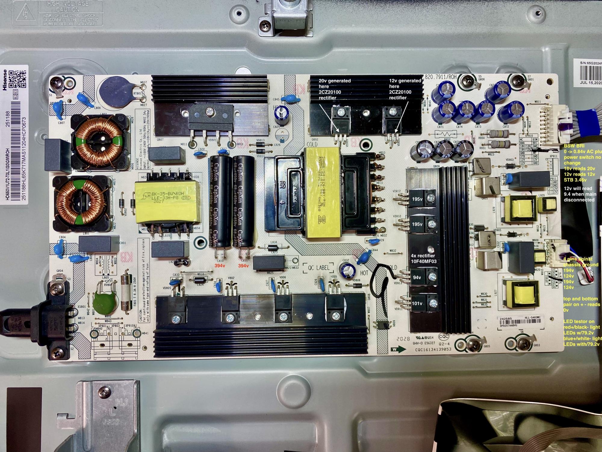

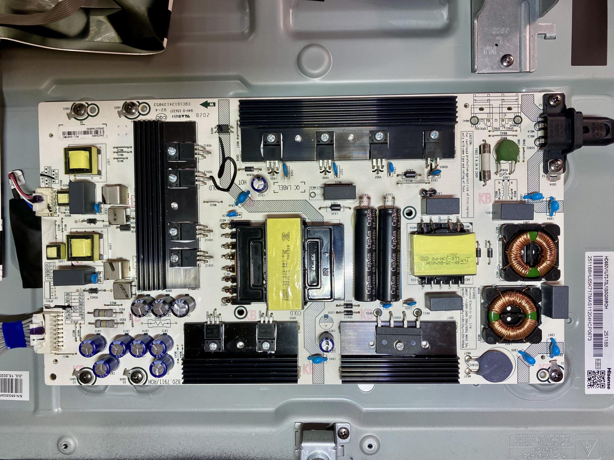

    All PSU voltages to main looks good (12v, 20v (label says 18v but is 20), standby voltage) Probing main board shows what appears to be a DCDC converter (MSH6103A can't find datasheet) providing 5v, 3.3v and 1v. 5v present to the standby light power switch board.

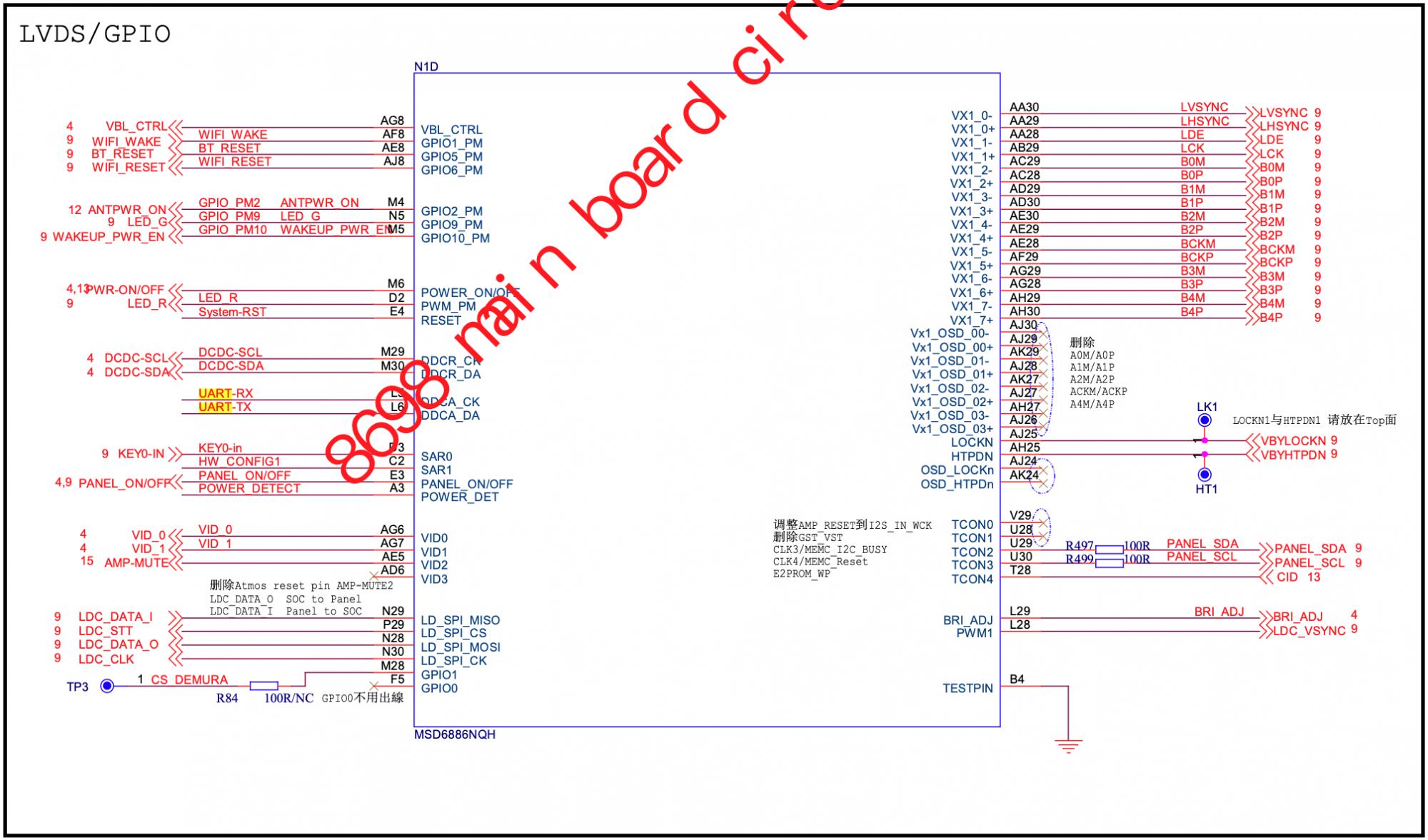

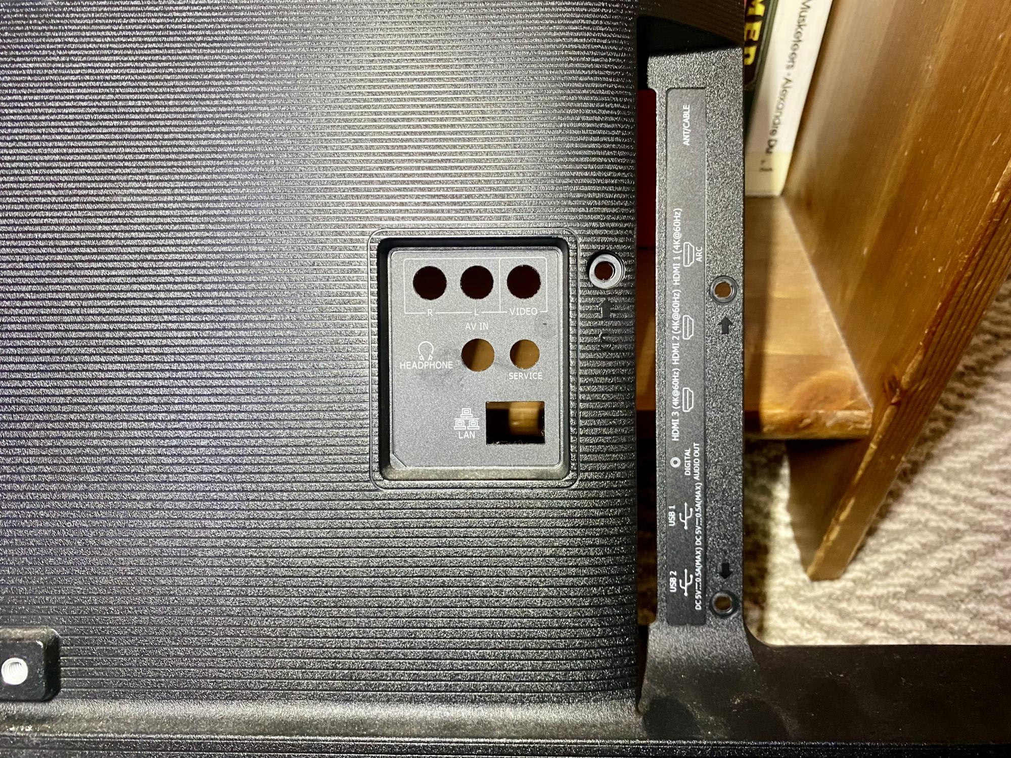

    Found this 2018 service guide for MSD5886 showing UART access to the TV to flash various boot/firmware bits
    https://www.manualslib.com/manual/16...roduct-MSD6886

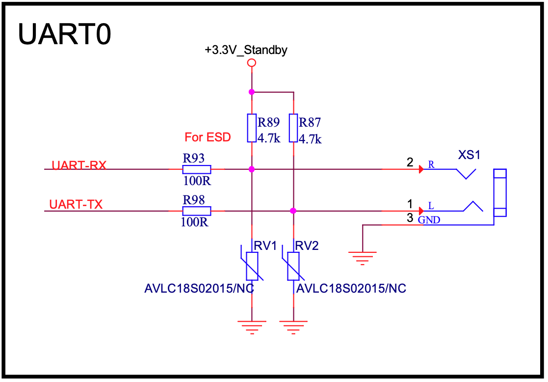

    p28 shows a serial port connection to the earphone port. My TV has both an earphone and service port (also earphone plug shape) right next to it. Service port plug solder points appears to show its just a TRS 3.5mm plug port
    https://www.headphonesty.com/2019/04...uctor_plug_TRS
    Looks pretty easy to make the DB9 to TRS 3.5mm cable (pin 2/3/5) and can buy these off the shelf programming cables

      Don't know if BSW is turning backlight on but < 1v after plugging in AC and no change pressing power switch on TV. Anyway, none of the main connector voltages change pressing power button on the TV (not remote)
      Shopjimmy shows 10 strips of 6 LEDs so LED tester shows 10v below 90v assuming 3v LEDs.

          4 pins on PSU LED connector. Presumably 2 serial circuits.
          blue
          white
          red
          black
          volt meter ground probe on chassis
          blue = 195v
          white = 124v
          red = 195v
          black = 124v
          meter + on blue, meter - on white = 0v
          meter + on red, meter - on black = 0v
          These voltage reading starts when plugging in AC cord and never change with pressing TV power button.
          LED tester + on blue and - on white light up LED and reads 79.2v
          LED tester + on red and - on black light up LED and reads 79.2v
          I only use shopjimmy reference to see # of LEDs. Of course it may not be exact to whats in the TV. To see whats in the TV require a lot more disassembly.

            disconnect the MB from socket XP810 and tested the voltage you have on it and on the LED BL socket with references to TV chassis
              XP810 disconnected from main
              BSW BRI 0v
              18/12v = 20v
              all 12v = 9.4v
              BL Connector (volt meter - on chassis)
              Connected to backlight
              blue and red = 190v when plug in AC and continuously dropping
              white and black = 120v when plug in AC and continuously dropping
              Disconnected from backlight
              white and black = < 10v and continuously dropping

                if you are sure MB disconnected and this is the value u have,,, then you have one Optokoppler between primary and secondary PWB defect
                    I only see 1 optocoupler on bottom of PSU (right of center). The diode side measures good (1325 in forward bias, 0 in reverse ) Don't know how to check emitter collector side in circuit.
                    Maybe try the powerboard as stand alone and see if you get steady voltages and backlights on.
                    PSU doesn't light up backlight with main disconnected. Anyway, there is clear evidence main is dead. Here is latest summary

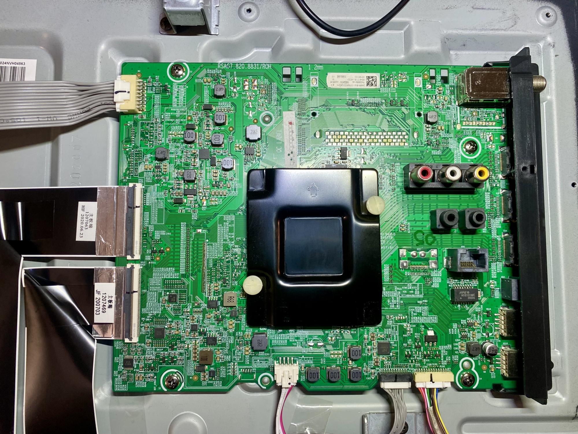

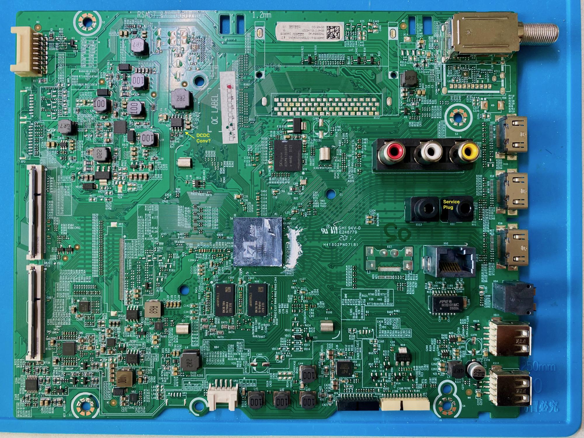

                    I believe the boot sequence is as follows
                    - PSU generate 12v to main and 20v (not sure what this is for, maybe tcon or audio amp? I have seen LG tcon's PMIC generate 20v+ VGH from 12v)
                    - If main boots properly, it will turn on standby light and power on IR. If TV is requested to power on, main will tell PSU to turn on backlight along with supplying analog or PWM dimming signals. PSU on this board shows ANA signal at a minimum (I've seen ANA and PWM dimming on a 55 Samsung but not sure HiSense have both)
                    - BSW (Backlight Switch?) between PSU and main is likely the signal main uses to tell PSU to turn on backlight. Goes to about 0.8v when AC is plugged in. I jumped this line with 3.3v standby (generated by main's DCDC power tree) and saw backlight flash on briefly. I'm guessing probably need to supply proper ANA signal (maybe jump 3.3v also) to keep it staying on.
                    - Main's DCDC power rails use PSU's 12v to converts to all the necessary voltages to drive its components starting with the computing system (CPU=1v, DDR3=1.5v, eMMC=3.3v and 1.8v) just to be able to boot the computer. Other voltages like 5v exist for USB, IR, wifi, etc
                    -All of the main's computing system voltages are present checking around SOC/DDR3/eMMC. One of the 2 USB port has no 5V. Circuit trace (service manual has the circuit diagram) shows its enabled by the CPU so CPU didn't get that far.
                    - FLIR image of main shows one region of SOC and one side of eMMC warms up on plugging in AC. This likely shows everything is configured to start reading boot/system code from eMMC. The correct boot sequence on AC plug in would be to enable IR and turn on standby light at a minimum. But lacking standby light, 2nd USB port power, no SPDIF light etc... means SOC didn't get very far.
                    So main is dead and I suspect it is likely firmware. Main boards for this TV (3 years old) is out of stock everywhere @ $100. Many complaints of slow smarttv software and bricking from updating the TV. Anyhow, Hisense doesn't even provide USB recovery firmware without request. Not sure can get PC flashed tools and firmware.
                    So to summarize, main has the 12v source from PSU and DCDC generates all voltages for the SOC, DDR3, eMMC but no evidence its booting very far. Don't think I want to invest $100+ on a replacement main so will see if can gather enough SOC tools to see if can at least get a terminal prompt over the service port (3.5mm jack for serial UART signal)

                      Can you scope something on the ARM chip to at least see if it's alive (clock etc)?

                        Unfortunately no scope or logic analyzer. That would be helpful of course. But I suppose seeing heat signature in one spot in the SOC and one side of eMMC indicate there is clock (or a short of course but my probe found none)

                          The PSU does make a faint noise differently with main connected and disconnected. Furthermore, one periodic noise correlates with voltage drops.
                          Main Connected
                          - Every ~30s will hear a faint 1/2s squeal sound near the big transformer (haven't isolate it exactly where from) when this sound occurs, all DC voltages will drop momentarily. 195v will drop about 10v on digital volt meter. Even main side's 1v CPU supply voltage will drop a tiny amount (few 100th of a volt on the meter)
                          Main disconnected
                          - No periodic squeal but a faint clicking sound that speeds up after plugging in AC which seem to gradually become steady clicking frequency.
                          So I guess PSU could still be suspect as without a scope, can't see how clean the DC voltages are going to main.

                                I guess you are thinking the periodic ~30s PWB squeal / brief voltage drop is main board boot loop. Checked all signal from main->PWB and all are steady when this occurs
                                STB = 3.43v
                                BSW = 0.084v (I think this is backlight switch)
                                BRI = 0.084v (probably PWM dimming according to service manual schematic)
                                ANA = 0v (PWM2 in service manual schematic)
                                From PWB
                                VCC_A = 20v will drop momentarily when this occurs
                                12V = 12.5 steady when this occurs
                                Possible ~30s PWB squeal / voltage drop is caused by PWB? This does not occur with main disconnected but all the voltages aren't stable or don't look correct when main is disconnected anyways.

                                    Try to find the TX and RX points on the board, connect the UART to USB adapter to them, run the terminal program and look at the terminal boot log, and you will see where the problem is. (The main thing is that UART is not disabled in the firmware itself).

                                      Tried removing all connectors (panel, wifi, speaker, with and without IR+power button) and unfortunately no sign of booting (no SPDIF, CPU enabled USB port power)
                                      And yes, without scope, hard to make much progress other than board swap. Given the availability and cost of the boards > $100, most owners encountering are just trashing the TVs
                                      Yes, TV has 3.5mm audio jack for service port that is UART. Searching for my USB UART dongle or order one or find old DB9 computer and build a cable. Then I'll have more insight on CPU activity/any logs.

                                        Anyone knows necessary spec for the HW UART connection to this TV?
                                        Service Manual for 2018 HiSense (link in post #1, this TV is 2020 but use same main SOC) shows a HiSense serial board RSAG7.820.2335T with USB to PC and DB9->3.5mm jack to service port.
                                        Same 2018 service manual shows UART circuit diagram which connects directly to main SOC (probably 3.3v GPIO?). I'm guessing the proper signaling probably requires 3.3v RX/TX. I measured the service port directly and see 3.3v
                                        Finally, has anyone used a cheap USB<->Serial TTL dongle based on FT232RL or CH340G to connect to UART on these HiSense TV's service ports? Both of these have changeable RX/TX voltage from 5 to 3.3v.
                                        Just want to make sure I gather the correct USB to UART HW.
