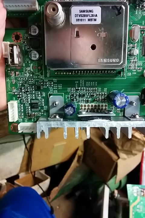

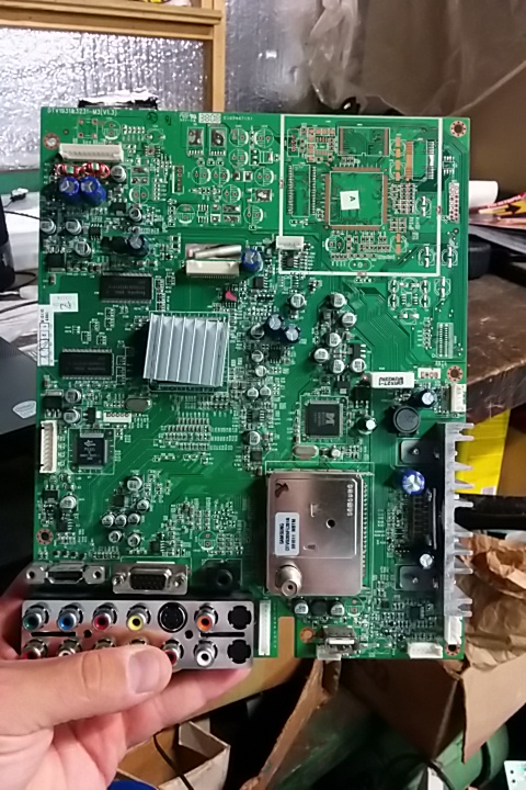

what component can i fix on main board for sound?
  • mattstolte
    • Dec 2013
    • 612
    • usa
    I got this main board and im wondering how to tell what part is bad? theres no sound from main board but it works good besides no sound, its the connector on bottom closest to heatsink

    Can you get sound through audio out, and headphones?
    Could be the amplifier i.c, or it could be missing it's supply. Is there anything from the speakers, even a faint buzz or hiss?

        Sound comes from headphone so would that mean its amplifier ic on main board? What is ic that so i can locate it and change it??

          Pics not really clear enough - It could be a TDA chip google "tda audio amp ic" images
          might give you an idea what to look for.

            It is in the bottom right, the IC in the big heatsink with a small plate with 2 screws. Unscrew and find a schematic for that IC. if Vcc and AMP_ON voltages are there, for sure that IC is shot.

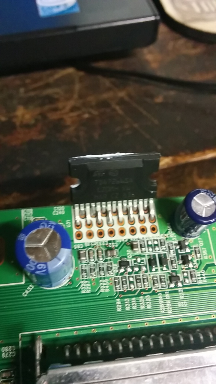

                  You need to get the p/n of that amplifier IC so we can look up the spec sheet for it.

                    any help indentifying this component and where can I find it? thanks

                      top row
                      TDA7266SA
                      CZOMH VW
                      MAR CZ 835

                        Originally posted by mattstolte
                        top row
                        TDA7266SA
                        CZOMH VW
                        MAR CZ 835
                        http://www.digikey.co.uk/product-det...1-5-ND/2772195
                        please check yourself if its the correct part before ordering

                                You should check the voltages on the pins first especially the VCC, the STBY, and the Mute pins. It may be stuck in the mute mode or in standby mode.

                                  see adit post 12 for link to digikey but do as budm says first the part maynot be faulty
