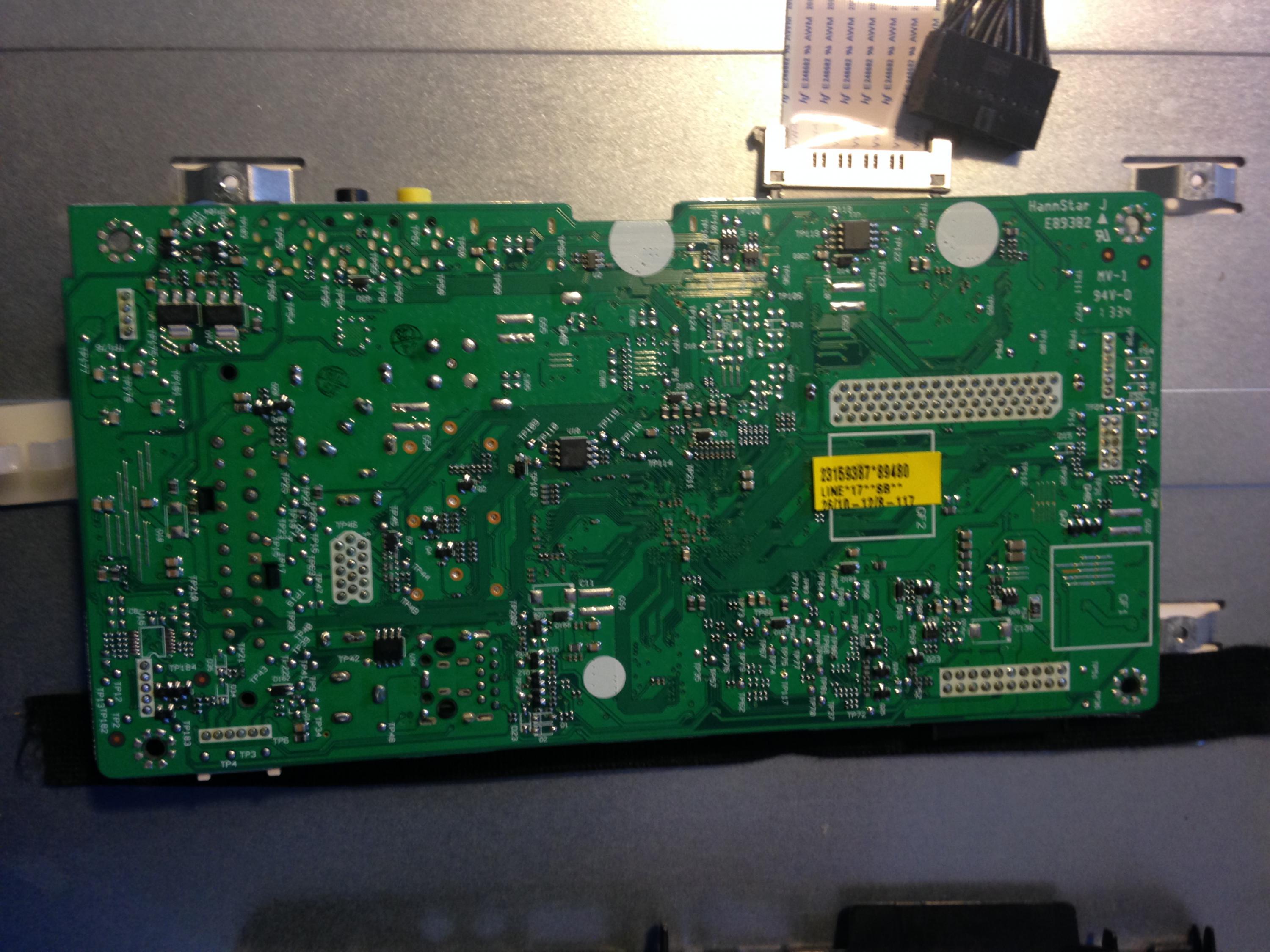

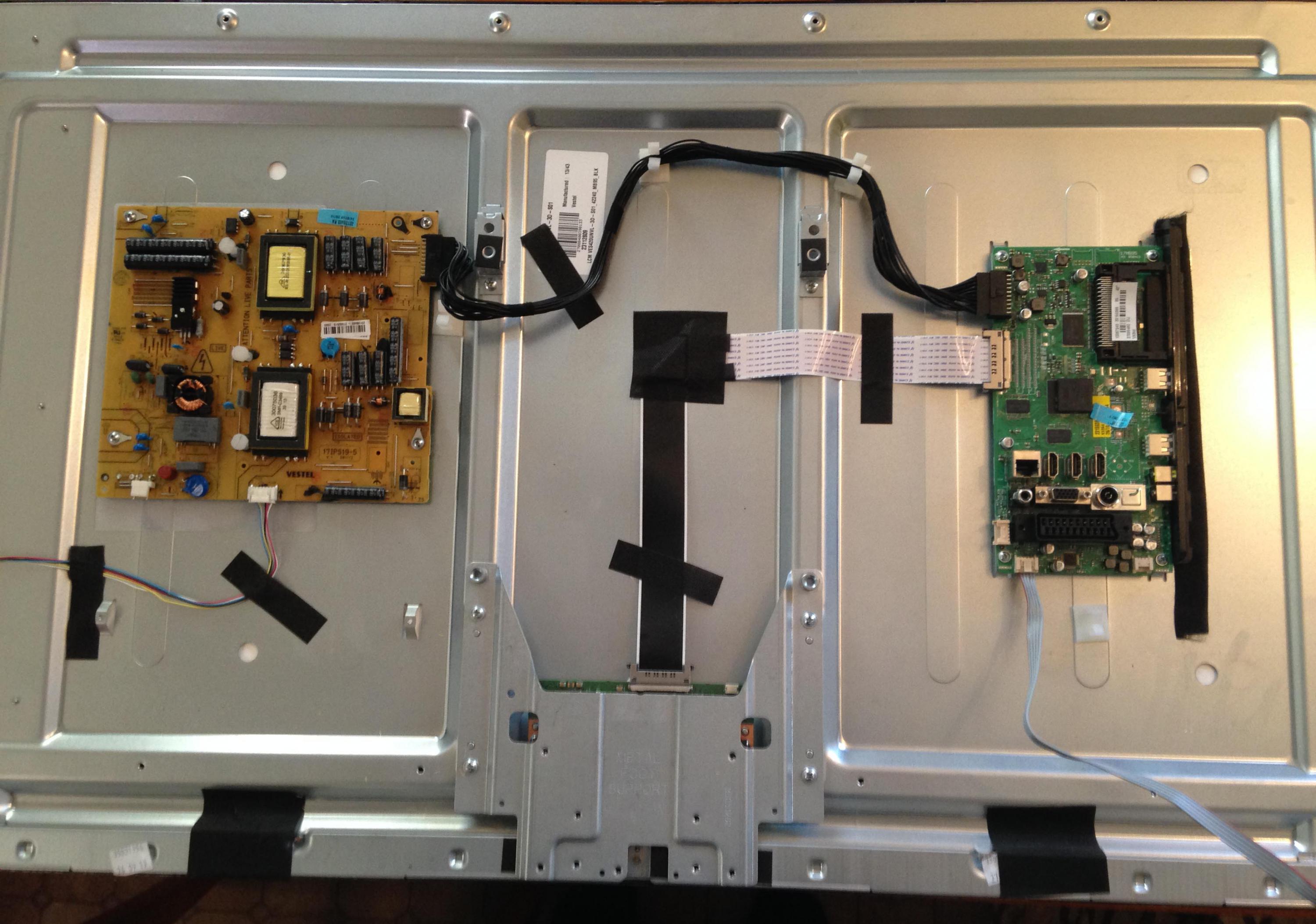

    Upload good clear pictures of the back side of the TV will be a good start so we will know what we are dealing with.

      Re: finlux 42flhk240bhd no backlight
      Hope this is clear enough...

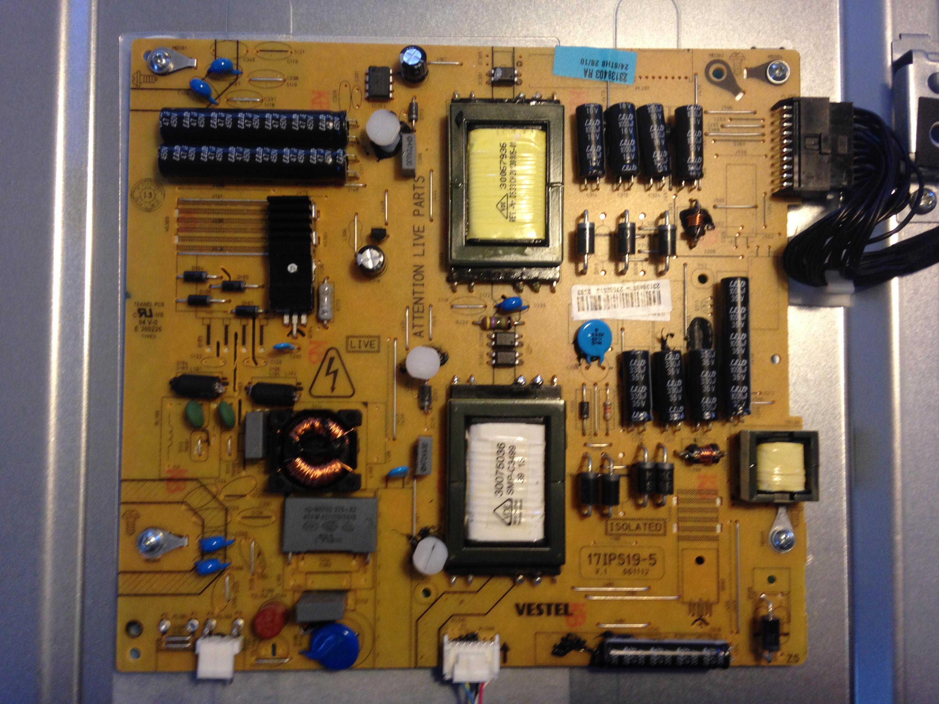

        ARRRGHHHHHH!!! its a Vestel
        It is ok for the general layout but may need to see where the wires go that lead off to the left. Can you post a good clear picture of each board front for now though may need backs.

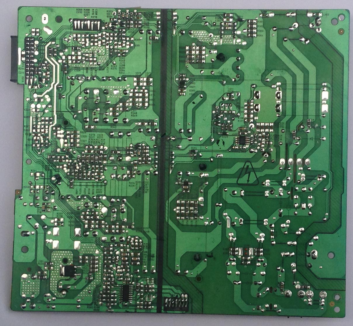

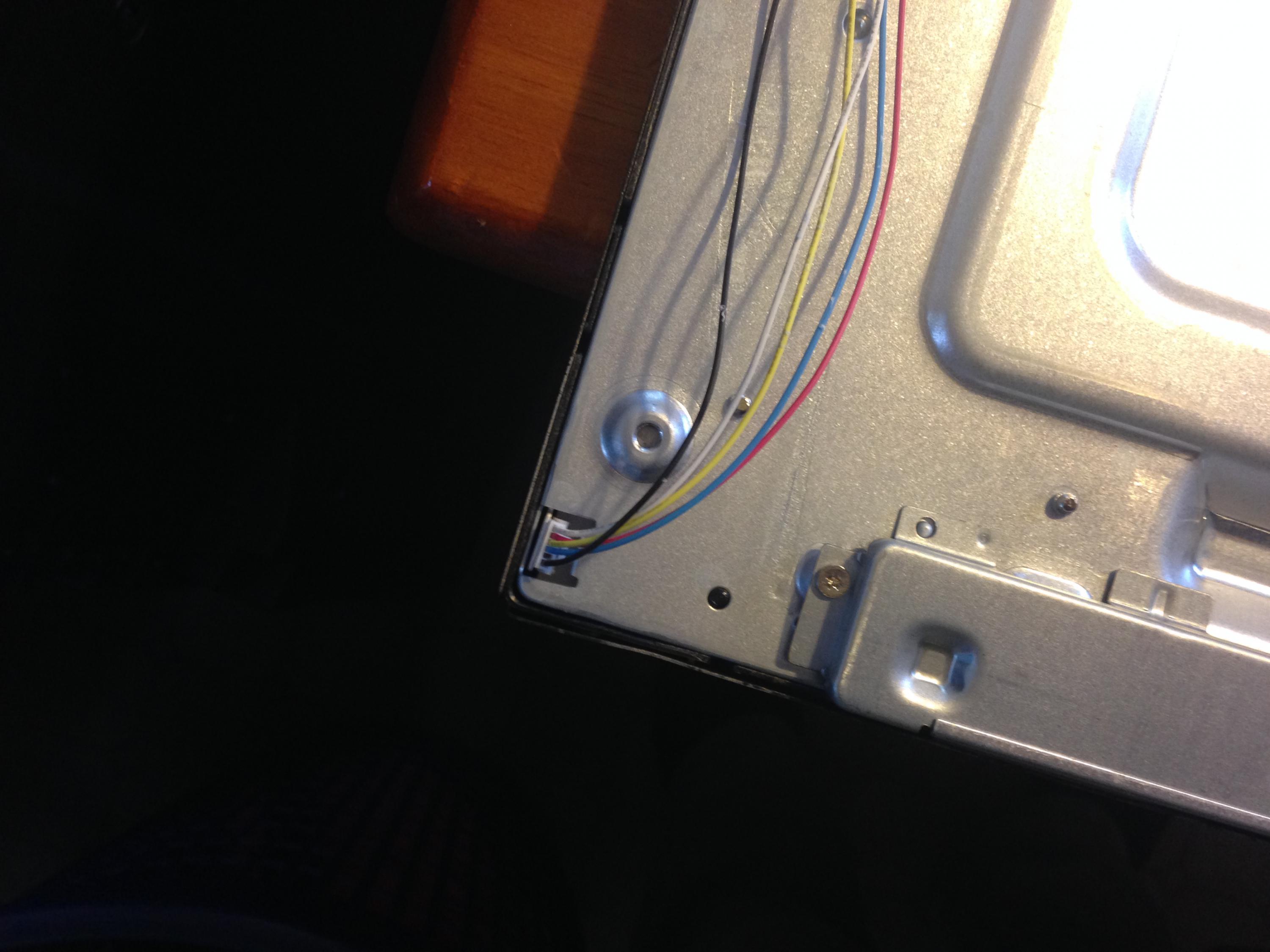

          Some more pics then. The wires lead to a connector right in the bottom left of the unit. I'd say they're for the backlight...
            Still not really clear enough - need more light but no flash. Anyway in pic 3 to the left of
            centre there is a somponent with 18 legs can you read the part number on it.
            Yes I think they are for the LEDs as well I was just wondering if it went via another board.
              you mean at the bottom of the image, just left of center? It reads
              MPS1333
              MP3394S
              D44T132.9

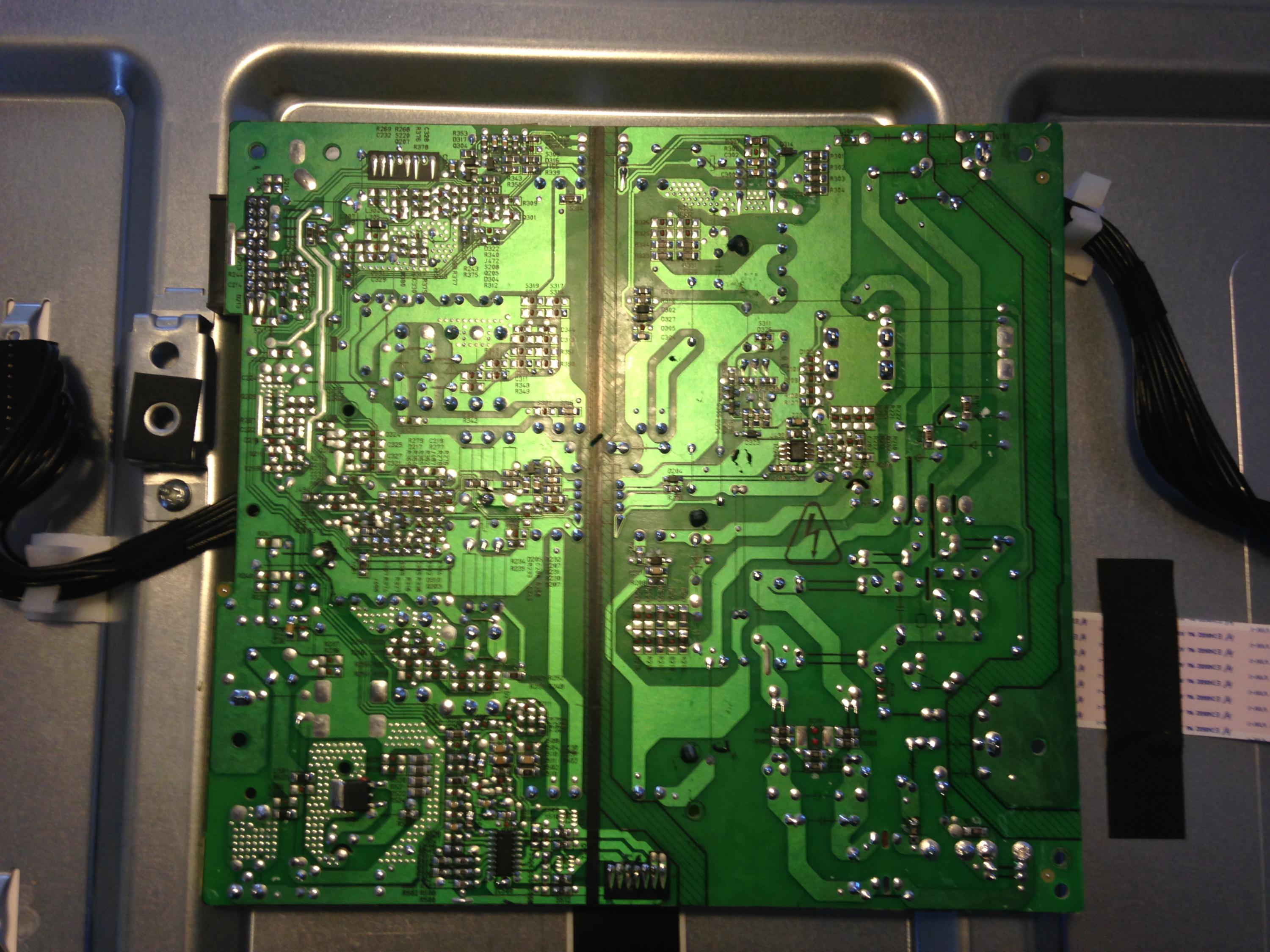

                        Really need a better picture of the back of the board take it near to a window plenty of light
                        required. You could also test the voltages on the legs of the 35v and 16v caps.
                        Meter on 200vDC
                        Next to test will be the diodes unless a better picture gives another dlue.
                          Here's the best I can manage (I think...)
                          The row of 1000uF 16V caps all have 7.6V across them whereas the row below that of 330uF 35V have 0V across them.
                          Thanks.
                            Yes that is a lot better thanks -wow and you found a voltage ! Not one I was expecting
                            but that is only to be expected on these boards.
                            What is the part number on IC303
