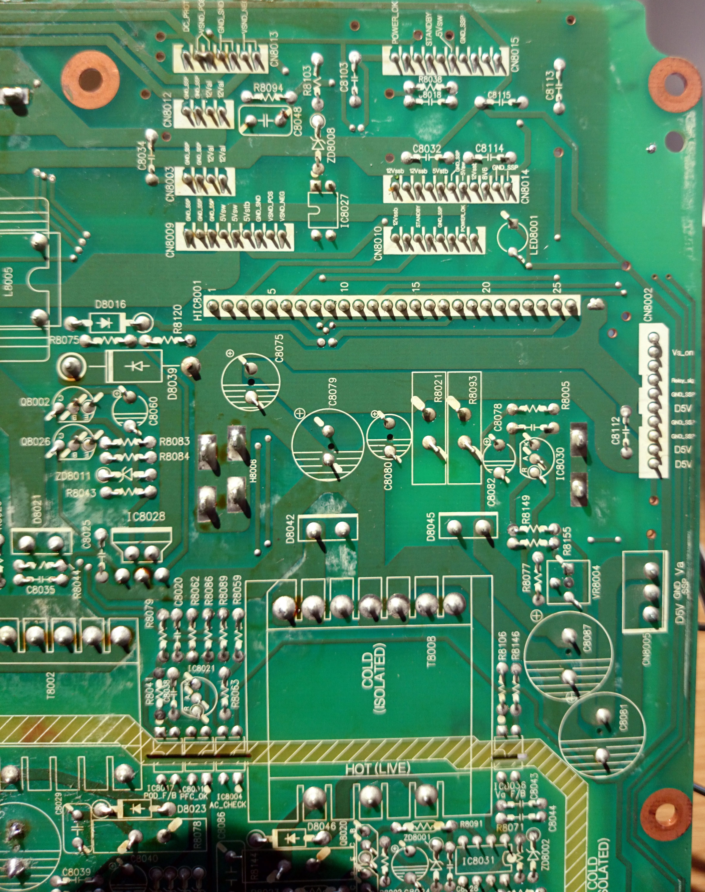

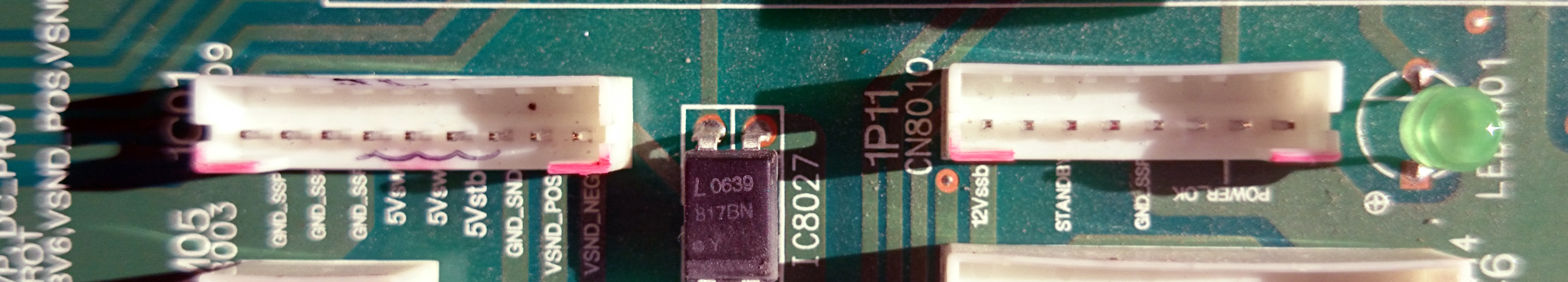

          can't find a schematic for this thing
          Can you post a upclose picture of the plug that goes to the main board? top side and also bottom side of board? So we can clearly see the printings beside that plug?
          I would like to figure out how to force the powerboard on without the mainboard.
          I gotta say,it's always scary to work on a board where someone before you did a butcher job on it,you never know what all he shorted out in a attempt to repair it...
          If we can figure out how to force the psu on ,then we can see if you get the VS and VA etc...

            Re: Philips 42PFP5532D - Dead
            Thanks Martino,
            Sounds like a good plan!
            Ok here are some photos, thanks
            (btw, you probably already know this, but only connectors CN8009 + CN8010 are connected in this tv, the other 5 above are not connected to anything). thanks
              Hmmm...need some help with this one,can't figure out what the power on pin would be
              was thinking 5vswitch and 5v standby,but seeing in your first post that you have voltage on both,wouldn't be a good idea to bridge those lol...
              Hopefully somebody will chime in that's familiar with these...

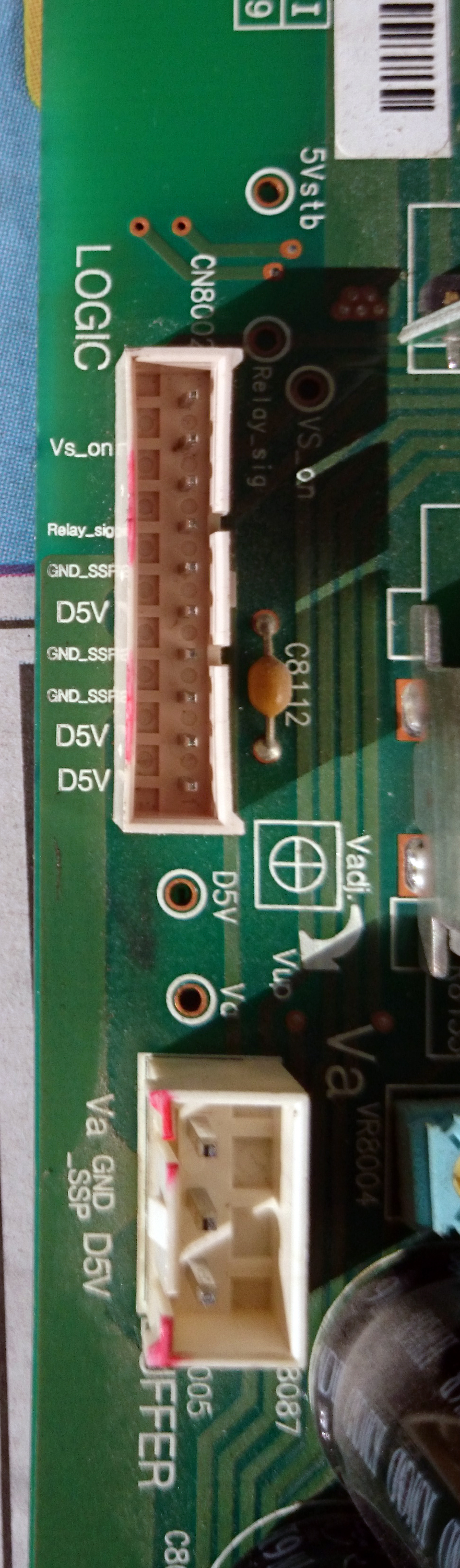

                      #30
                      Thanks selldoor, ok I re tested the voltage:
                      CN8006 (SY)
                      Vg...0.00V
                      Vs...2.00v
                      Vs...2.00v
                      CN8007(SX)
                      Vg...0.00v
                      Vs...2.00v
                      Vs...2.00v
                      CN8009 (1C01)
                      5Vsw...5.35v
                      5vsw...5.35V
                      5Vstb...5.29V
                      VSND_POS...-0.00V
                      CN8010 (1P11)
                      12Vssb...12.62V
                      standby...0.08V
                      POWER_OK...0.12V
                      CN8002 (LOGIC)
                      Vs_on...0.00V
                      Relay_sig...0.00V
                      D5V...0.00V
                      D5V...0.00V
                      D5V...0.00V
                      The above results are with the board out of the TV... Thanks

                        #31
                        Forgot to do:
                        CN8005 (Buffer)
                        Va...0.32v
                        d5v...0.00v

                          #32
                          Most supplies will be 0 with the board Out of the set....
                          The Mainboard makes the PSU turn on to derive the other supplies such as Va Vs etc....
