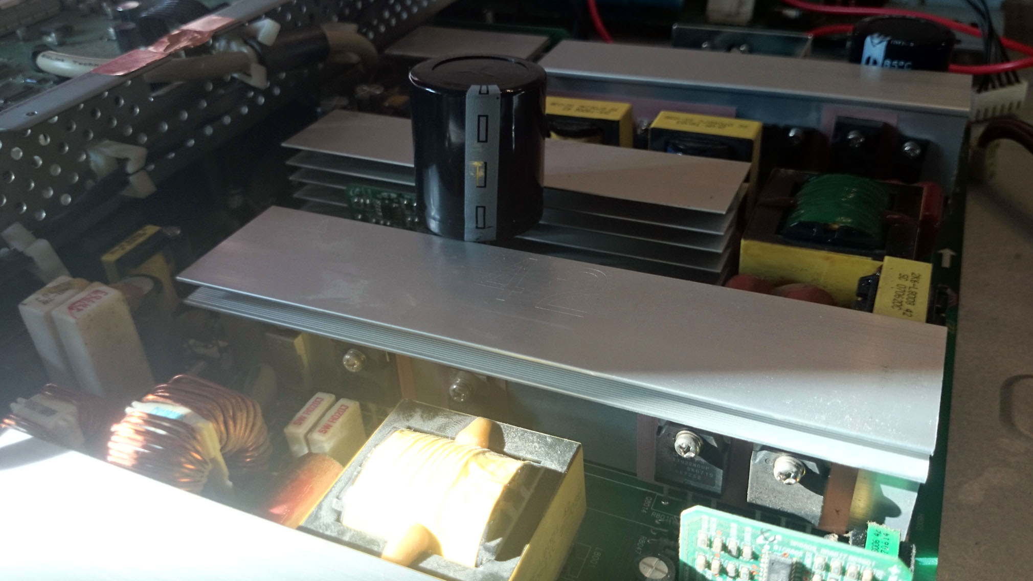

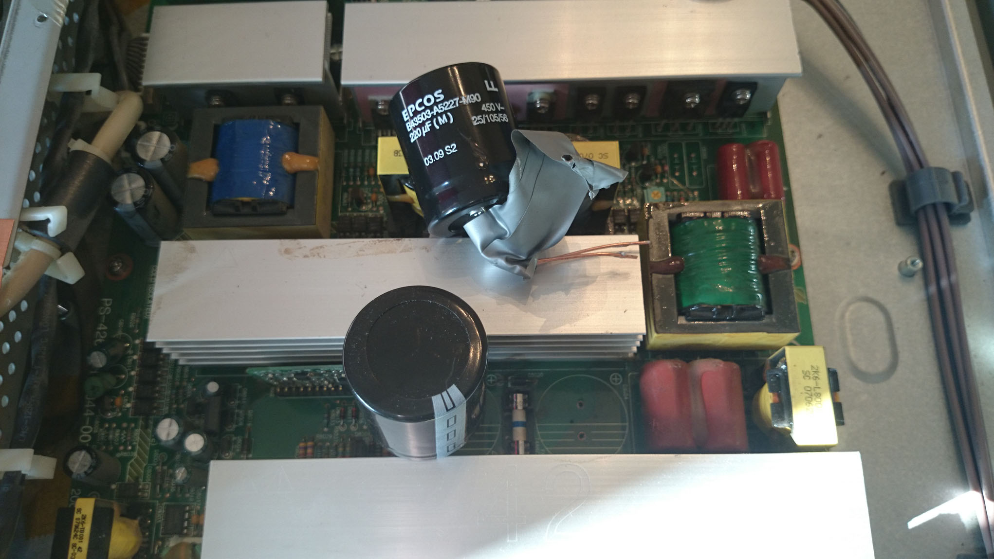

        Some news... Looks like someone has had a go at fixing it before me, I just pulled one of the capacitors off by hand as it wasn't soldered very well.
        I was a bit suspicous about these 2 caps as they didn't look right sticking up like that And the insulation tape
        So I need to replace these caps, these EPCOS are 220uF 450V, does anyone know if these are the correct ones to replace with?
          Re: Philips 42PFP5532D - Dead
          lol wtf? are they sitting on top of the heatsink!?
          Are the pads damaged? Take a photo of the underside of the board.

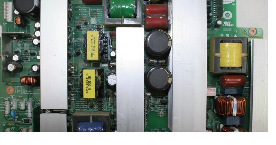

            Hi Well they dont look good but having said that they would not stop it working if they were firmly soldered in. In fact you might consider just refitting them until you have the rest working as they will be expensive to buy.
            Just in case you are wondering whilst the wrong physical size they are the correct
            rating 450v 220uf - see pic

              Hamie, yes they were above the heatsink, as selldoor mentioned they are too big, so they improvised on the previous repair. I will take board off tomorrow and inspect the pads.

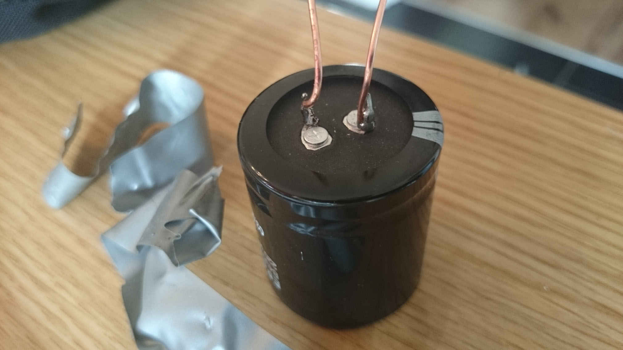

                Solder them back in - use heatshrink or insulation pulled off a mains power cable instead of tape - leave a small gap at the top of each leg and test them.
                Meter on 600vdc - you would need to be careful not to touch the heatsink or anything else in that area - If you can get to the bottom of the board test them
                there on the solder joints - probably safer option..

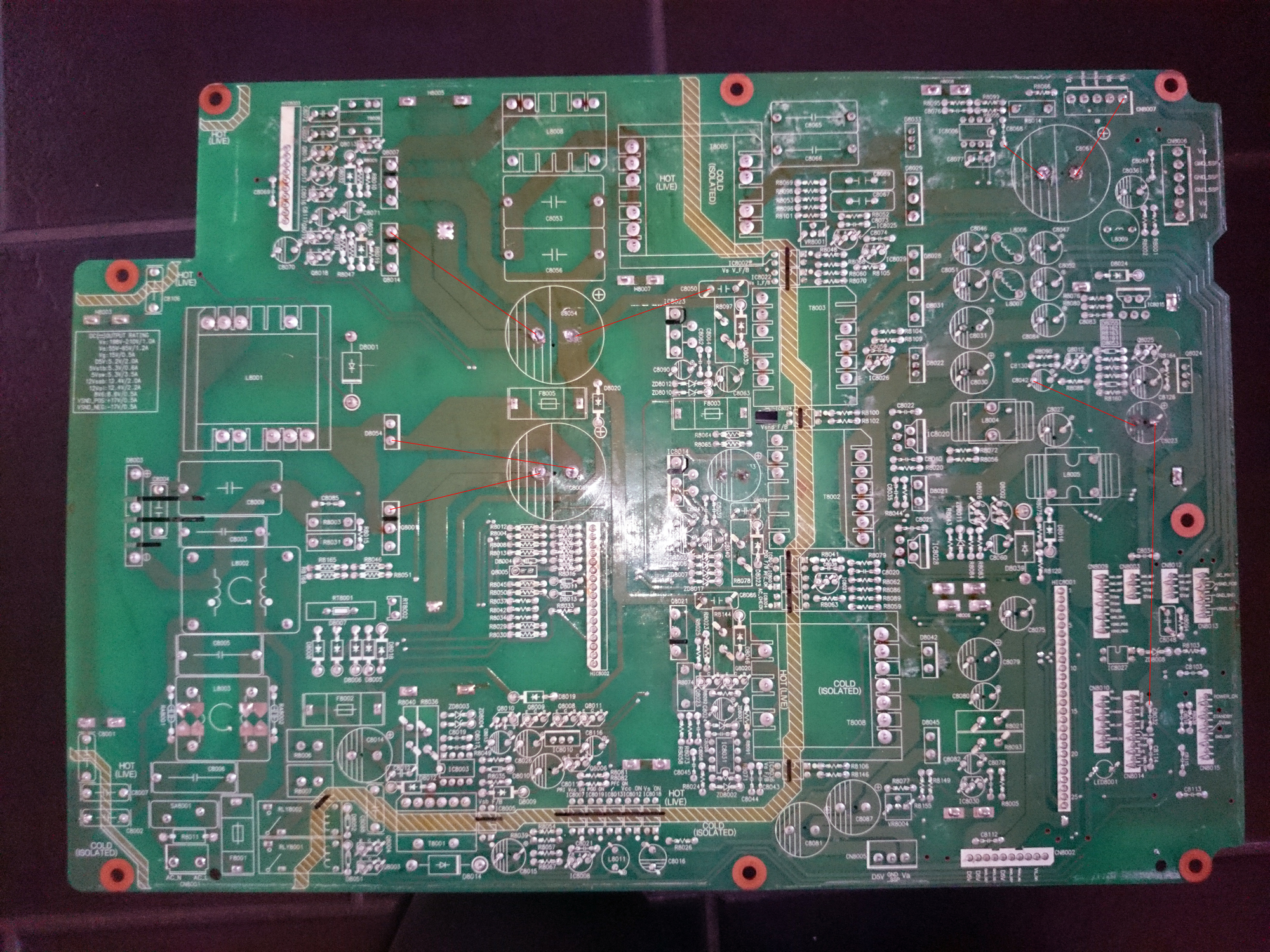

                              Hmm Odd one that - can we have a good clear picture of the bottom of the board
                                Thanks selldoor, heres the bottom of the board.
                                I forgot to say that the previous owner also replaced:
                                25v 2200uF Cap (C8023) right mid on board - I have resoldered this one as solder was bad.
                                250v 820uF Cap (C8061) right top on board - Not resoldered as it looked ok.
                                Thank you
                                  Too complicated for me - I dont like it when you cant see what is on the board
                                  for heatsinks. (not that it would help much if I could see)
                                  Its got to be a bit odd that there is NO voltage on the caps when you have some low voltages - must be a dual supply but cant see the other rectifier.
                                  So caps have no voltage because:
                                  1 The bridge rectifier is out? can you see if that is it at D6003 left side
                                  halfway down. - If it is can you test the voltage on the the outer pins
                                  (meter on vDC600) Inside pins should be AC 230v.
                                  2 The traces the caps are soldered to were not cleaned down to shiny metal.
                                  If this gets fixed I would resolder that other big cap

                                      Thanks selldoor, I have tested the bridge rectifier, I am getting 00.4v on the inner pins, and 00.0 outer pins. So I guess that is dead too. (the bridge rectifier was D8003)
                                      I am pretty sure they are soldered on well, I have done a continuity test as the pic illustrates, all seem to be connected.
