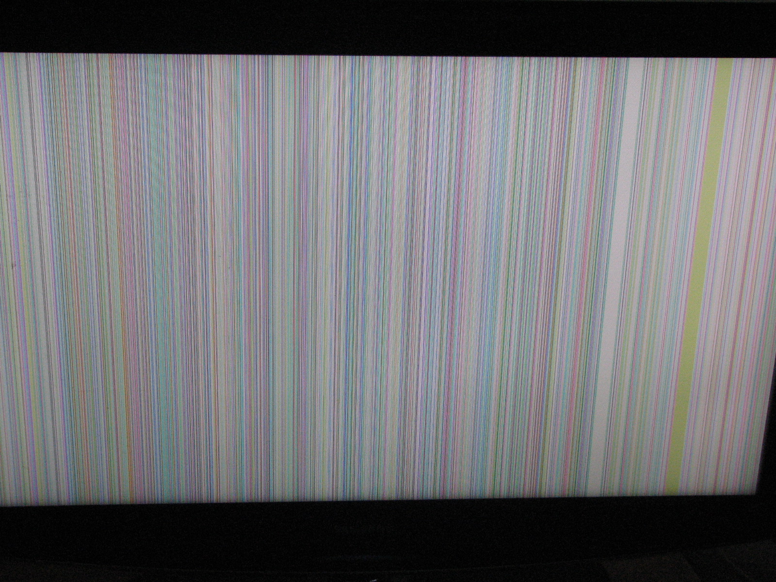

    Hello.
    I picked up this Samsung LNT4066FX/XAA over the weekend and when plugged in it displays colored vertical lines all over the screen. Sound is OK. Would this be a T-CON board typically? I would assume so since we have sound and backlight are ok..any suggestions are much appreciated.
    Thanks!
    Joe

    Re: What causes these vertical lines? LNT4066FX/XAA
    Have you opened up the set yet? On these models typically bad caps on the psu would cause this problem.
      Also could be bad panel too, I have a Samsung sitting that has this affliction with a good working PS and T-con.
