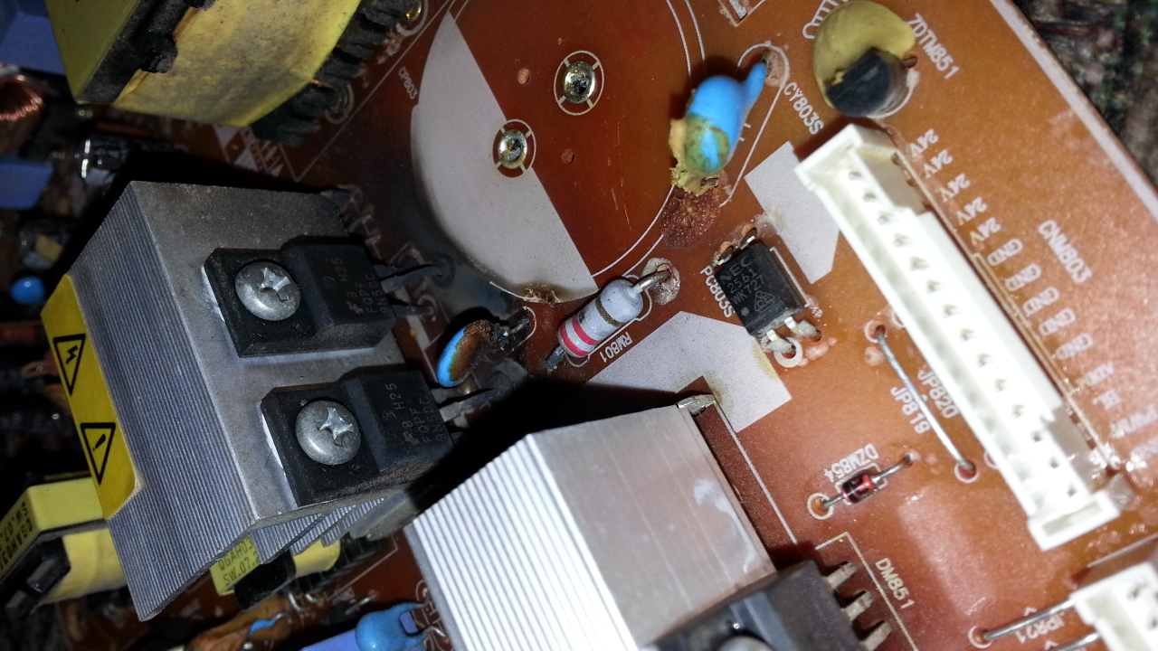

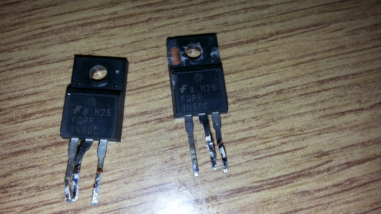

          Re: samsung LN-T3253H no picture red standby light

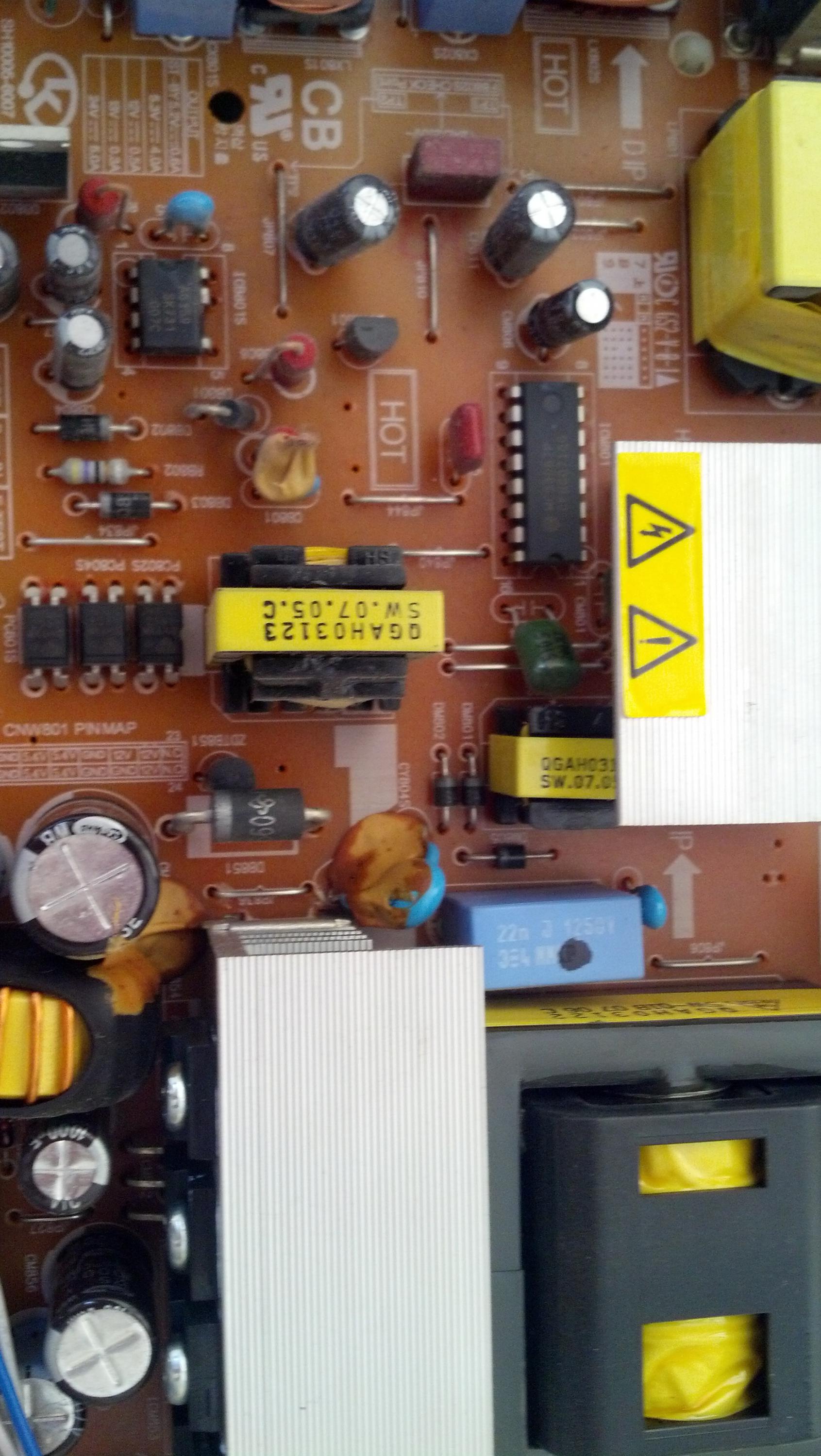

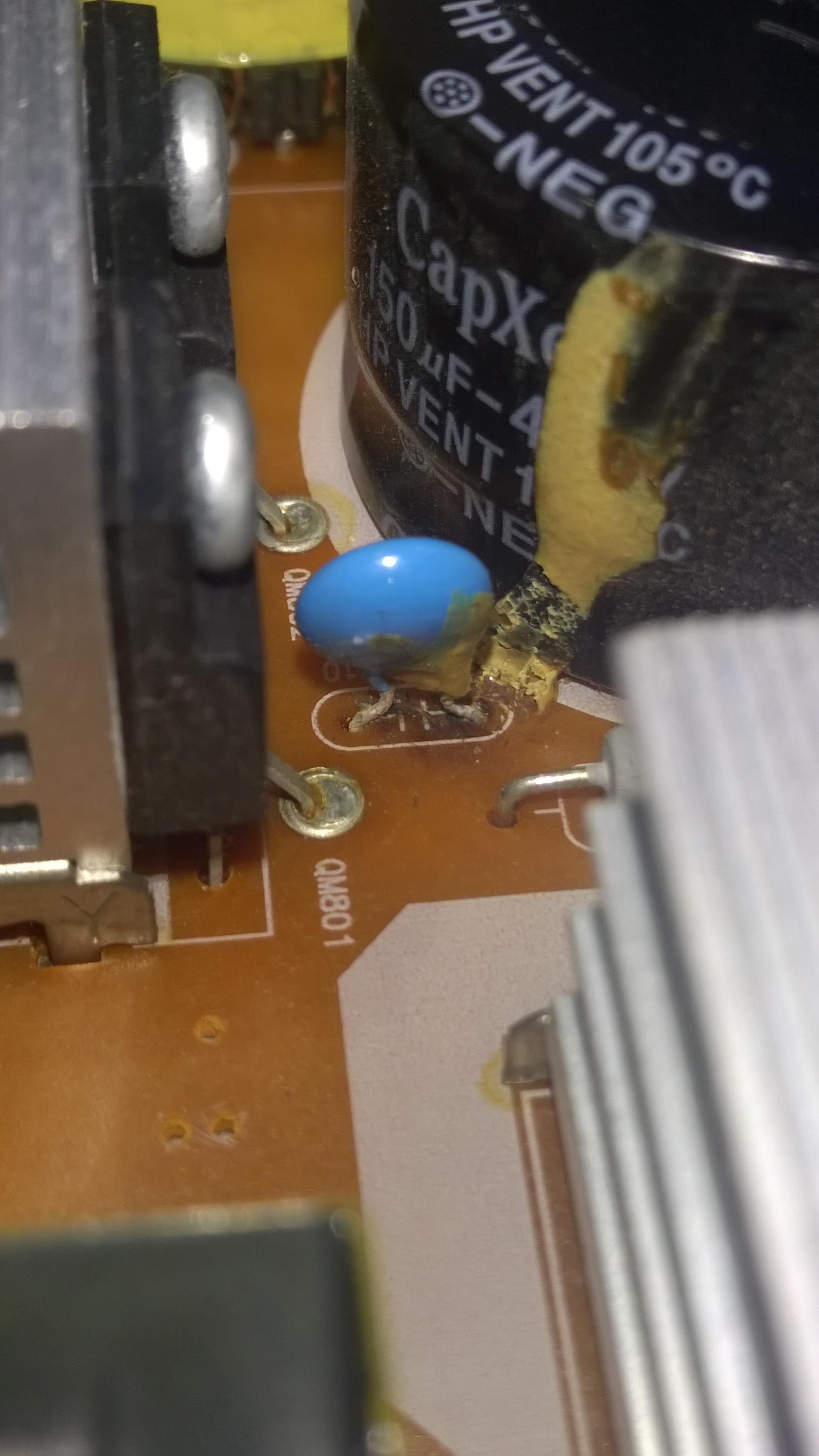

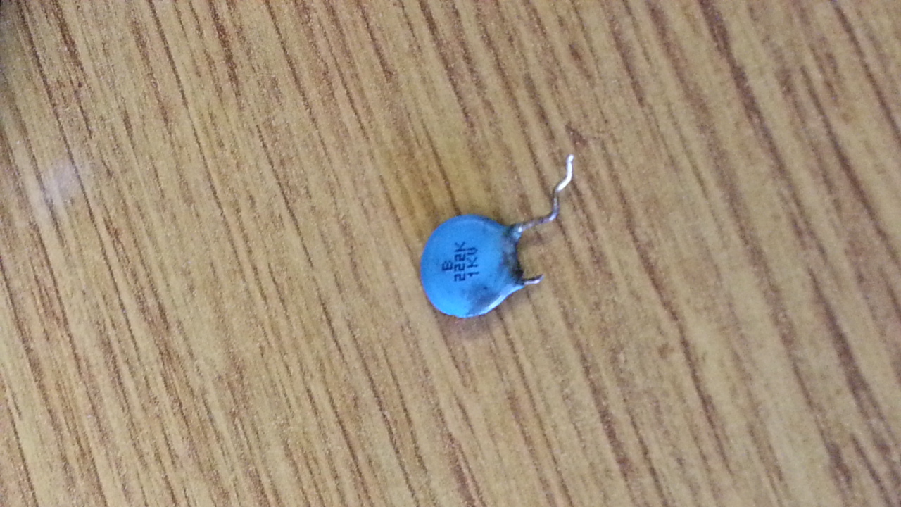

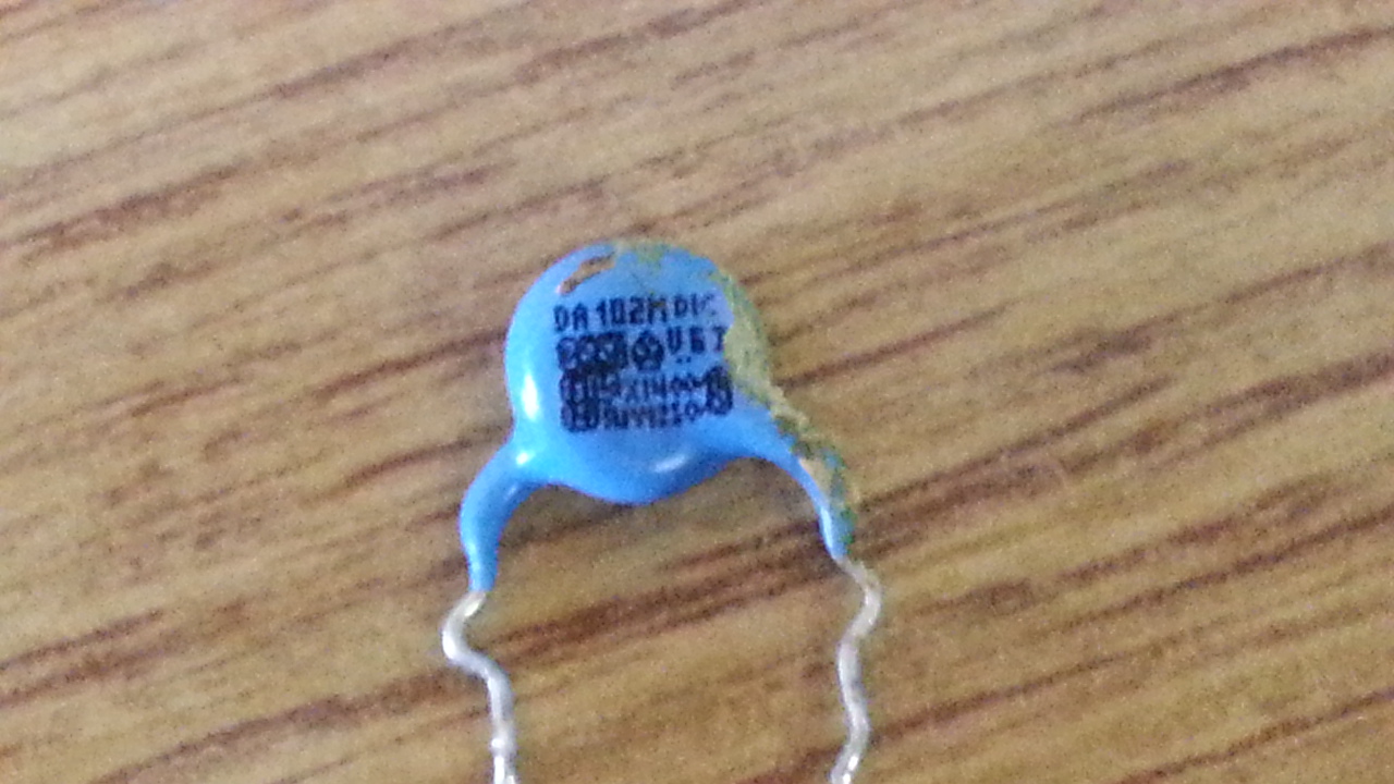

          Here are the pics of the components
          I damaged one of the mosfets when I was trying to pry it off the heat sink
            CM801, 802 are the cap as shown in the SCH. May be you mean QM801, 802 in the SCh which are MOSFET FQPF9N50C.
            The cap DA102M does not look like it is damaged, check and see if it shows any leakage resistance.

                Cap DA102M reads "OFL" when I set my meter to ohms

                      CY803 cap is fine, the TV will still function without that cap installed.
                      The CM810 2.2nF 1KV: you can get that from Digikey or Mouser:
                        Thanks budm
                        What about the mosfet I damaged
                        I broke a piece of the plastic
                        It should be fine right?
                        Or should I order a new one?
                          #32
                          I would order them and use them just in case. You should also order this cap which is a commonly failed cap CM808 (BLUE RECTANGULAR CAP). 0.022uF 1.25KV.

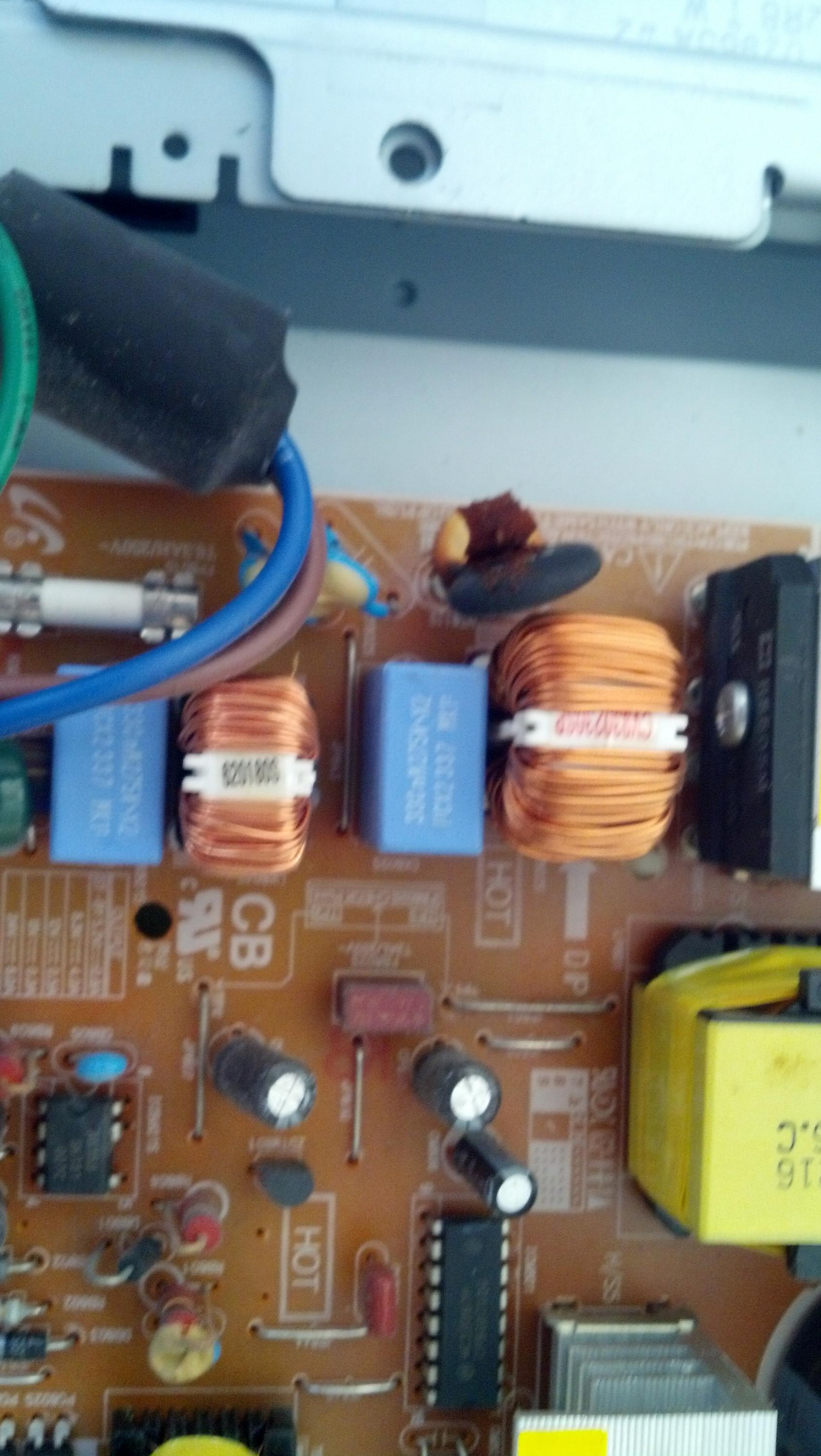

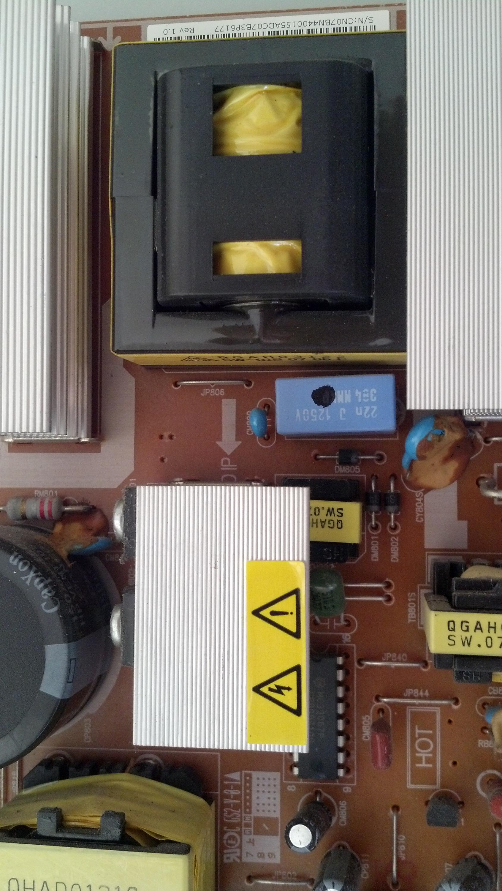

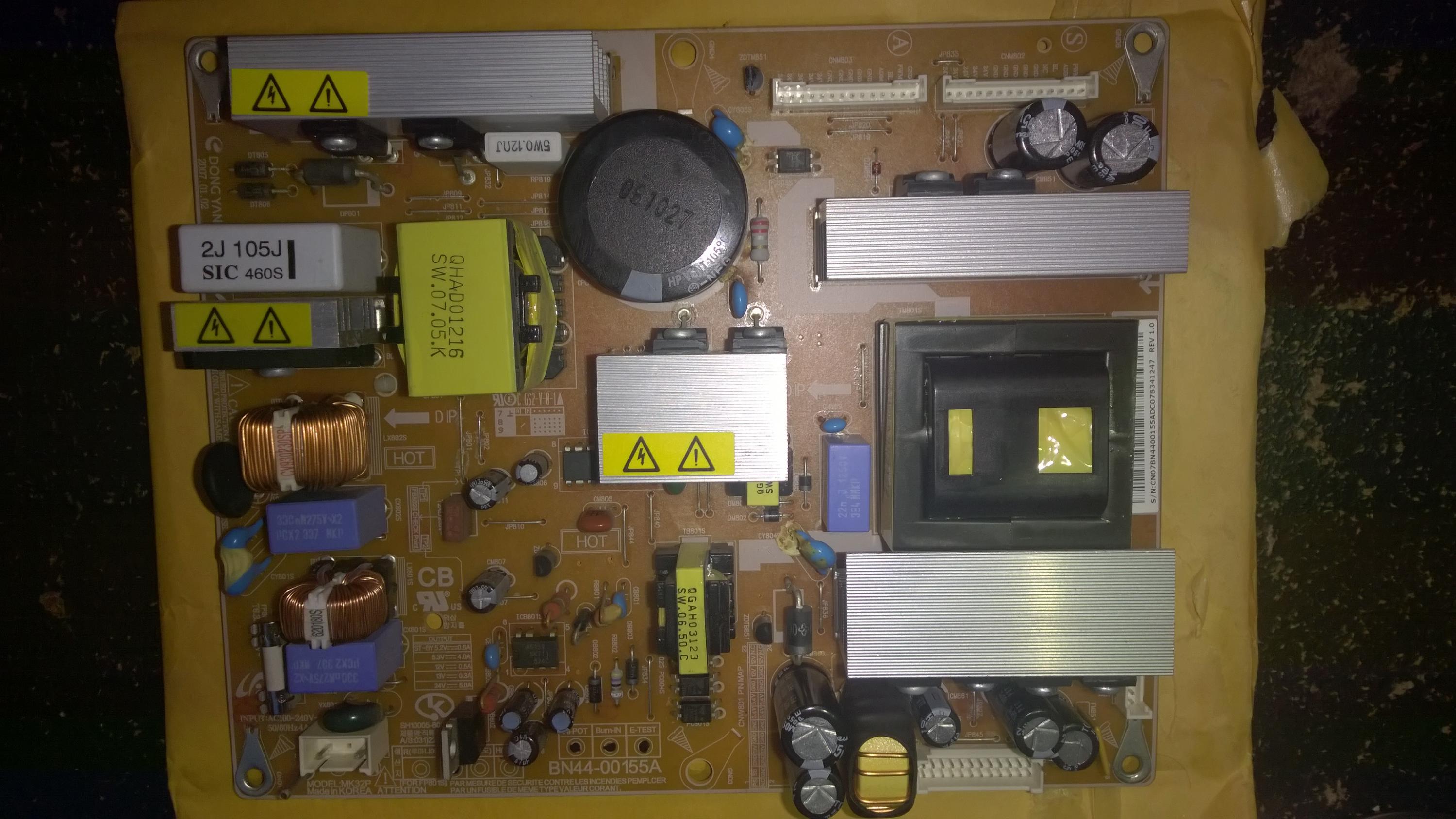

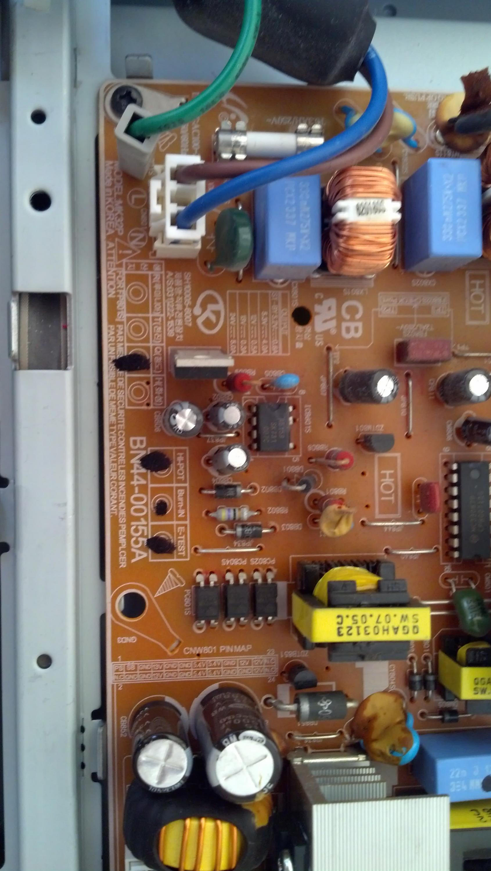

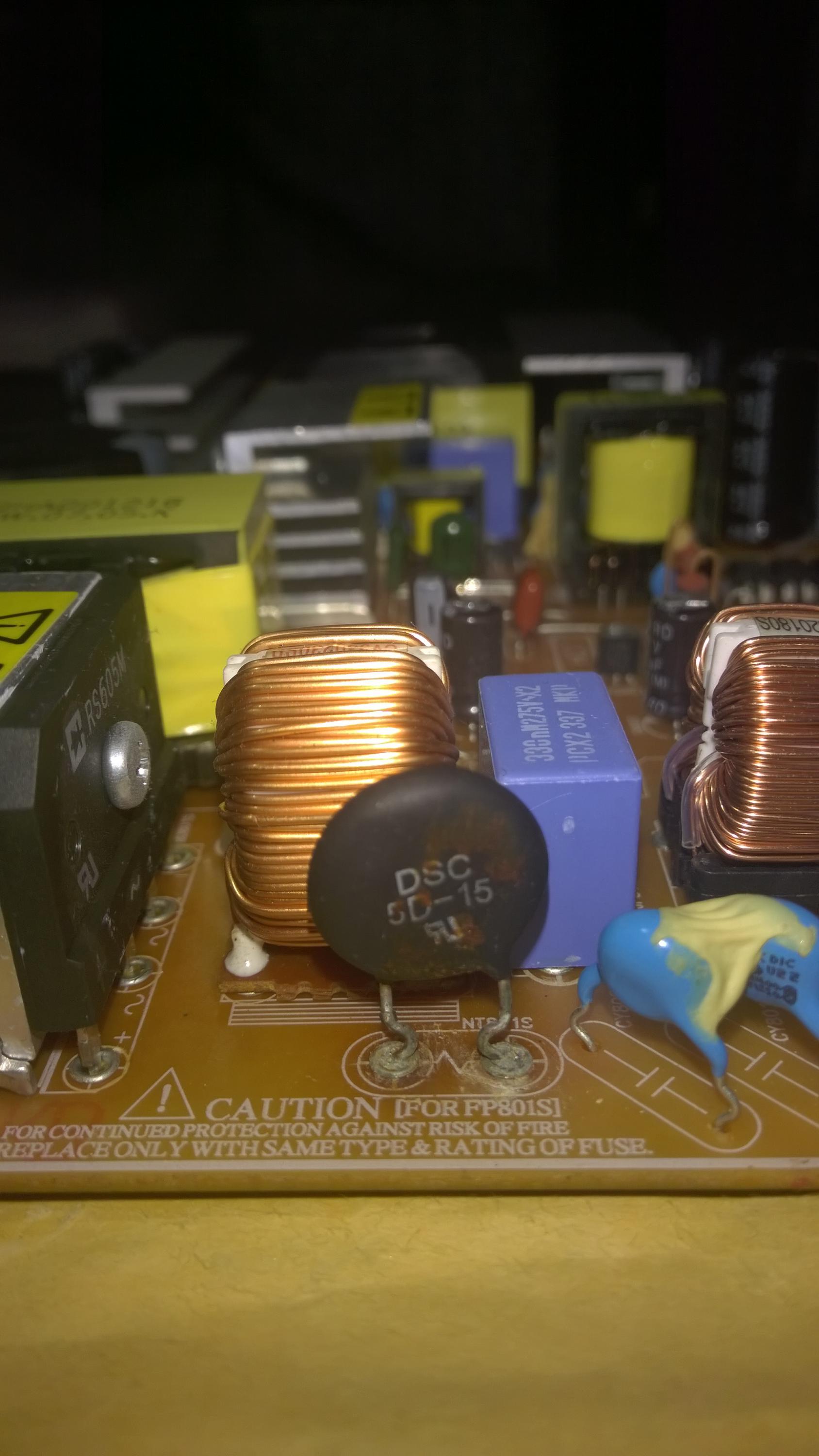

                              I am also having this problem with the same power supply board in the same television. There is no picture when plugged in, the red light blinks intermittently, and the bottom blue ambient light also flashes.There is no sound from the speakers. Also, I can hear a humming/high pitch noise coming from something on the board as if trying to start but failing. I have already replaced the 7 capacitors on the cold side with Rubycon ones with no luck. I'm currently in the process of cleaning up all the yellow glue and finding other failed components. I've taken some pictures of the other components that might need to be replaced. The black circular thing, not sure what it is, labeled 'NT8119' has corrosion under the glue that I removed. The other thing that may be replaced is the CM810 cap which also was corroded under the glue. Are there any other components that I should be inspecting? Also, to anybody who owns this tv, could you please tell me the size and length of the 15 housing screws, and the 4 screws for the power supply? I received this TV sans screws.
                                #35
                                Sorry, Im not sure how to edit posts on here, but the black component should be NT811S, not NT8119.
                                  Update, after replacing only the resistor RM801 and capacitor CM810, the tv works again. Glad I stumbled upon this forum and thread.
                                      I just picked up one of these as well. Opened the TV to find the glue all dissolved on several parts as well. No exploded parts or scorch marks like jose6326 though.
                                      Going to start with replacing resistor RM801 and capacitor CM810 as above and then take it from there.
                                      So why do they put glue on so many parts on this particular board? I have not seen such issues on other Samsung boards aside from bulging inferior caps.
                                      Do the glues serve a purpose when the soldered leads should be enough to keep the part in place?
                                          Thanks budm. So no need to re-glue after I clean it? Attaching pics for those curious
