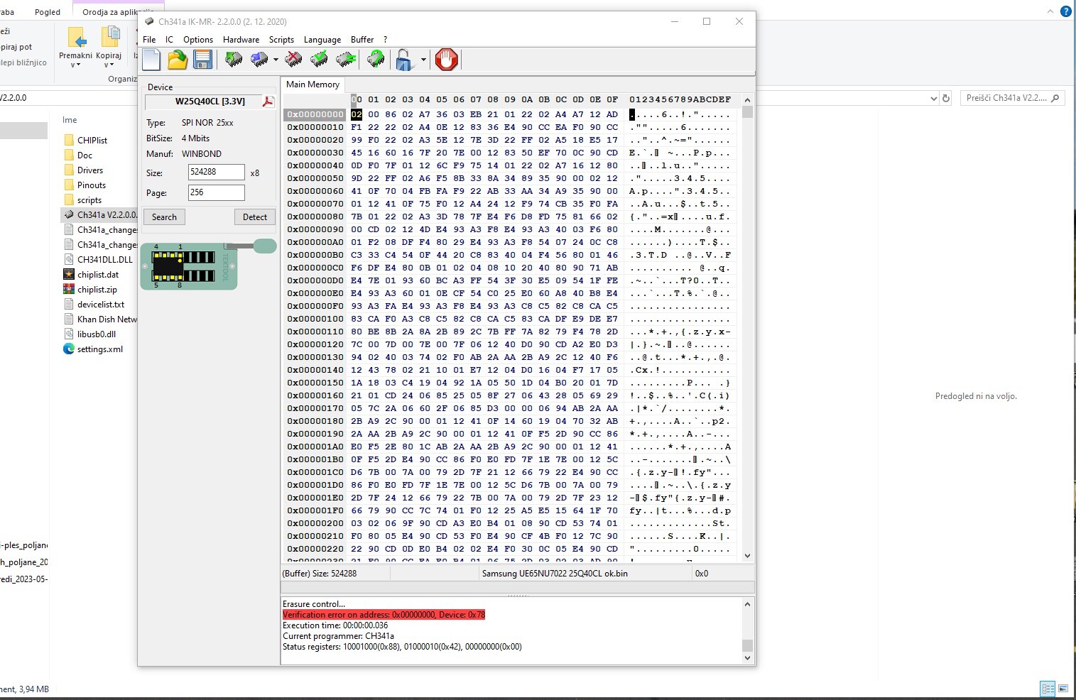

    I have Samsung UN65MU6300FXZA with Mainboard BN41-02662A, dead , No Standby Light. I suspect result of main power jumping. Checked all voltages on main board ok,..
    My main suspect is bad flash memory, ...
    Any suggestions or can someone please​ check dump file, in the attachment
    Thank you

    So which TV do you have: SAMSUNG UE65NU7022 or Samsung UN65MU6300FXZA?
    Try this dump.

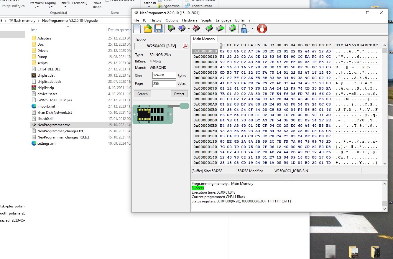

          No, still nothing. Maybe I am doing something wrong or...when I delete flash is till some dato on (picture Reset), and after reprograming shows me Verifivcation error (pic 2 Dump)

            Start by removing the protection (status register), erasing the chip, recording and checking. It is better to use NeoProgrammer V2.2.0.10.

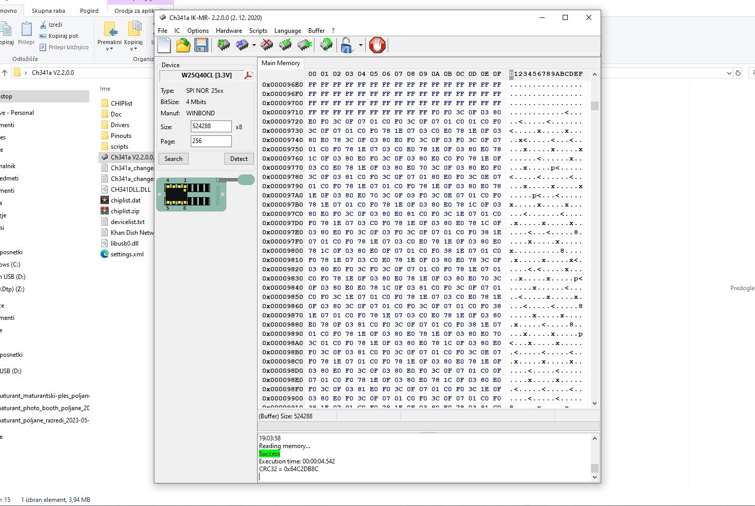

                            Yes, try reading from a working TV 25q80 and writing it to this motherboard, provided that their panel numbers are the same (and save your original dump!).

                              nope, 25Q80 rewriten, same situation..

                                Try setting and writing status register (0x28,0x00) after writing my dump.

                                  unfortunatelly same result, start with led light, but shortly vent off, after short time started blinking, 5 times and back again, one long red...
