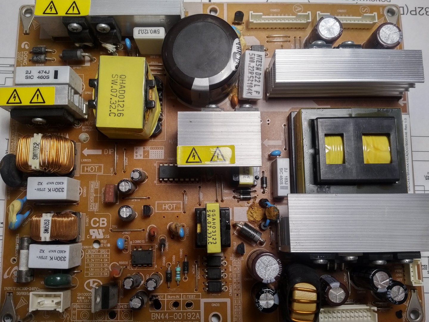

      #62
      Re: samsung LN-T3253H no picture red standby light
      Lets us see the pictures of your board.

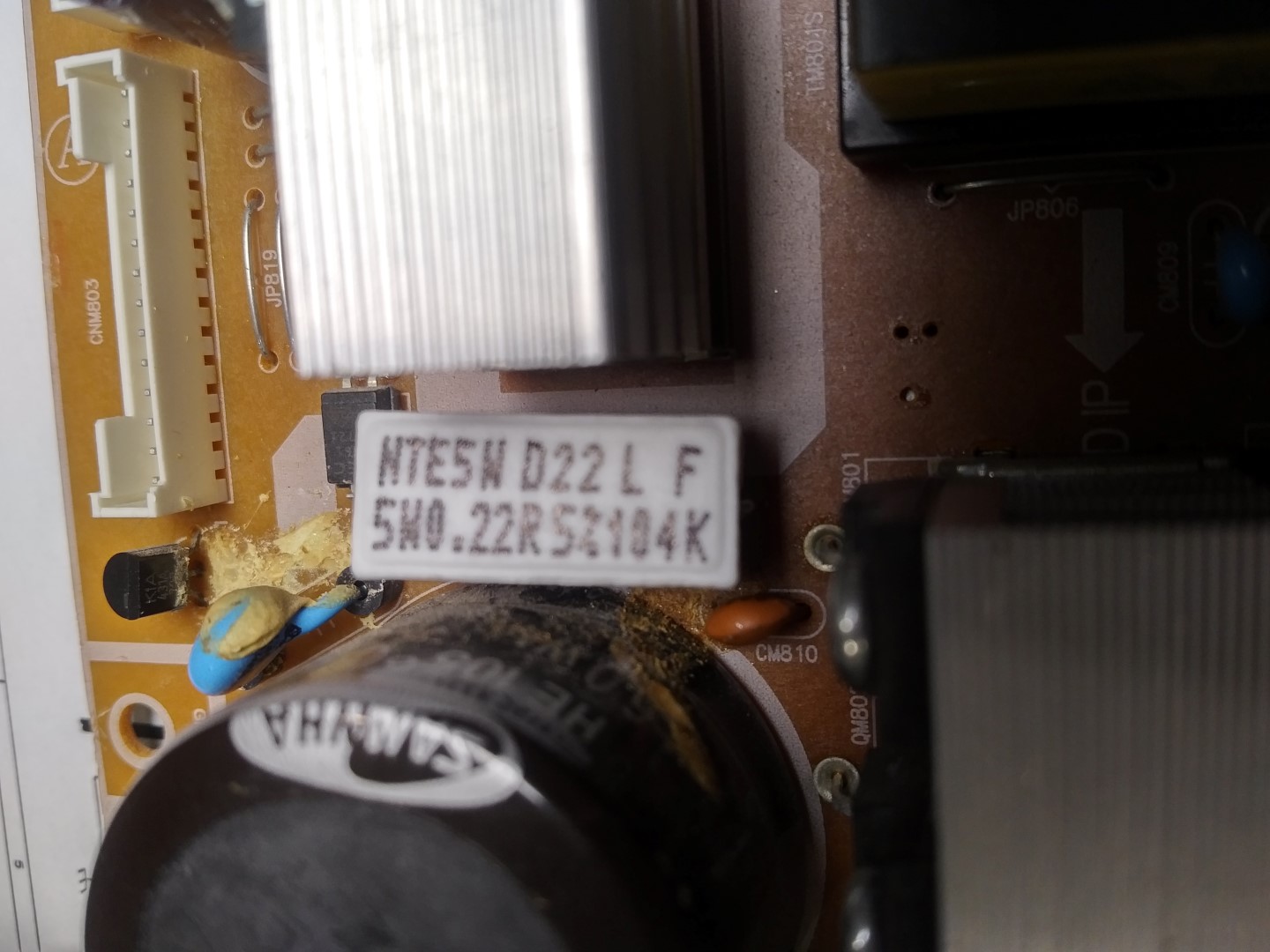

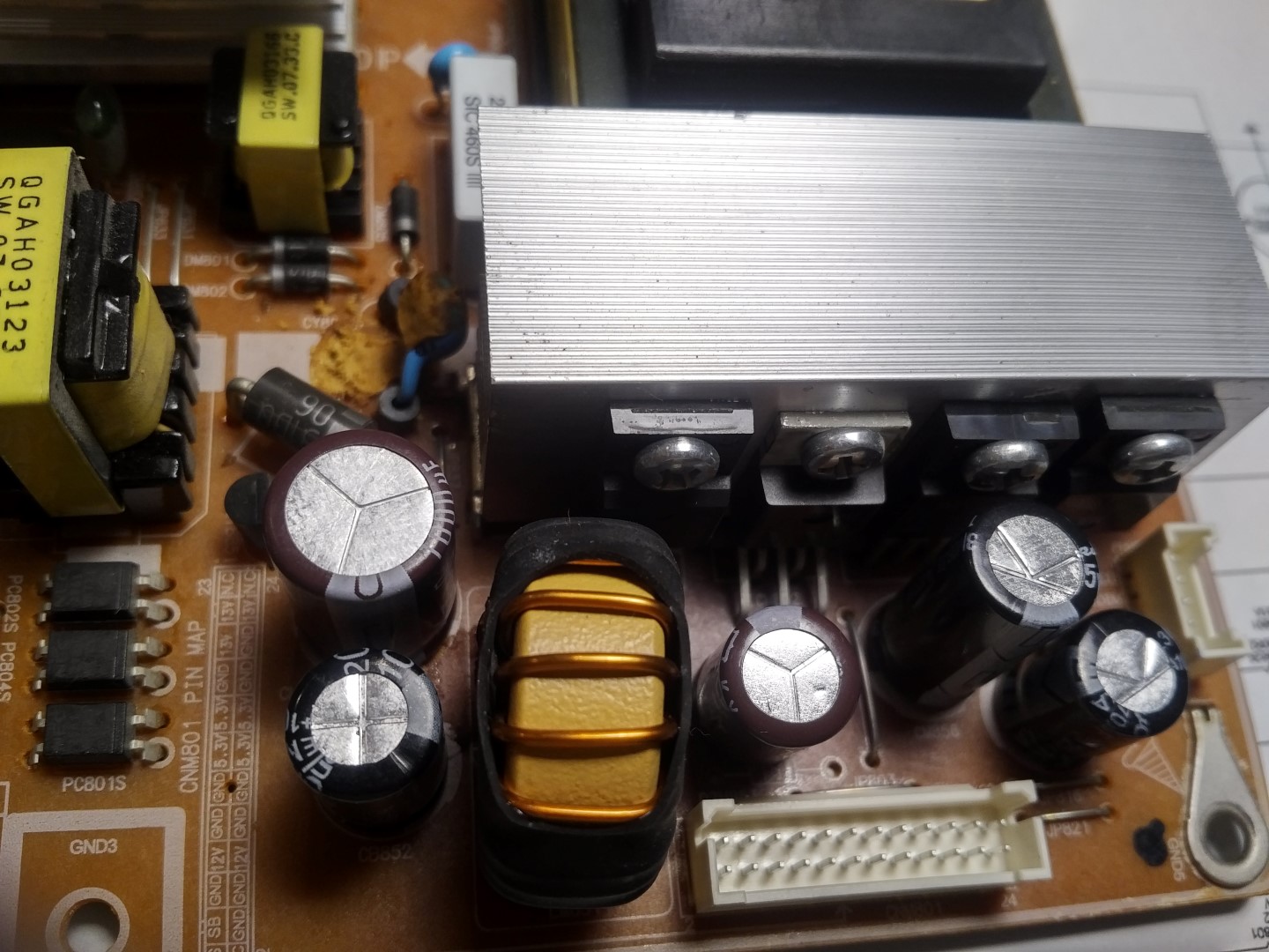

        #63
        Thanks for the reply. Here's some pics of my poor removal of glue. But I think I managed to get it away from all leads. I'm concerned that zener ZDTM851 (left of conn CM803 in the pic, had glue over all legs. I will try to test it.
        I had a 5W 0.22R in my drawer so I used that instead. Should be Ok to replace the 1kW RM801.
