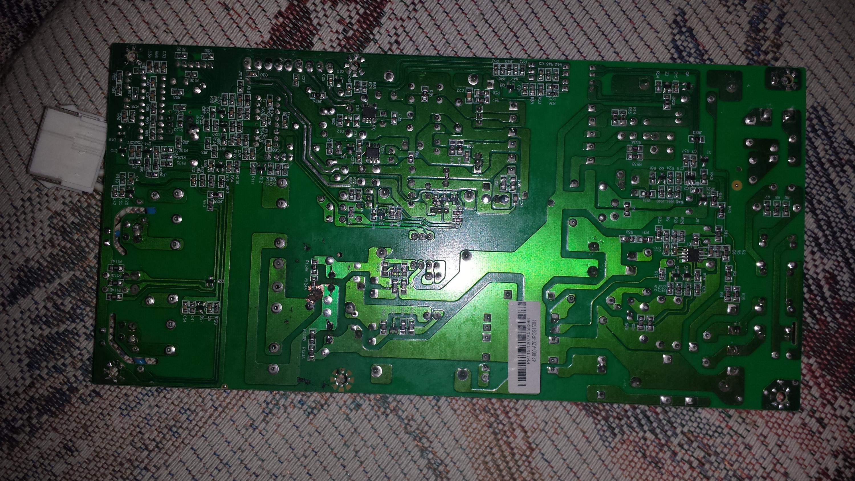

      Re: Memorex T3321
      Ok The Board is <img src="https://07c64c6ea680b4fd723b32b6563c24fa3e5fef68.googledrive.com/host/0By-2rqlHK3Ked3FsYkQyNTA5ZWs/2014624192321.jpg" style="max-width:100%" alt="Powerboard" />. I think it was part of the board that popped , i have a new one

        Re: Memorex T3321
        Link doesn't work, please upload your photos to the forum, that way others can use them for future reference too - external links have a habit of eventually disappearing

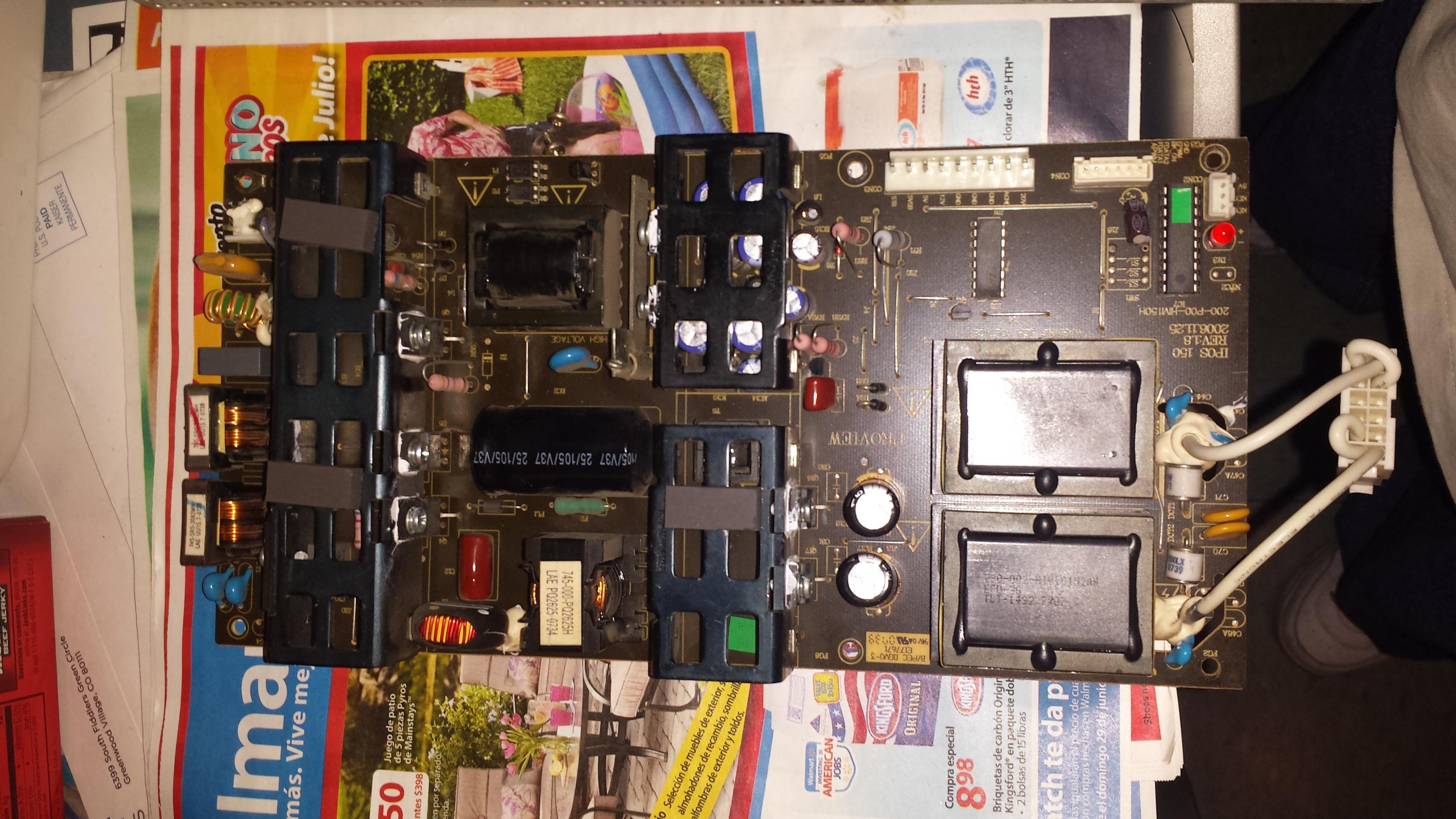

          Re: Memorex T3321
          ok Sorry, here you go

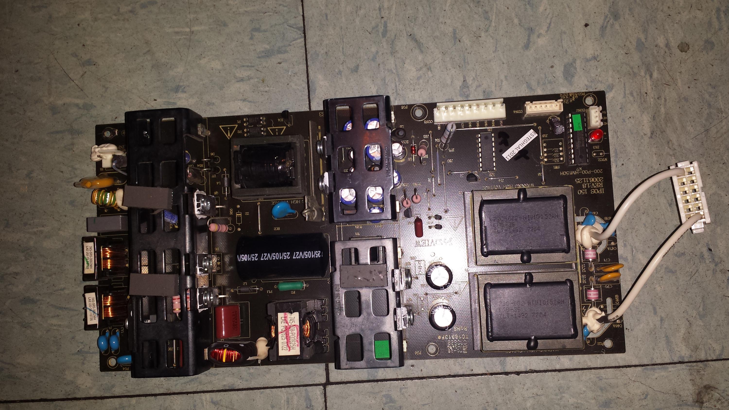

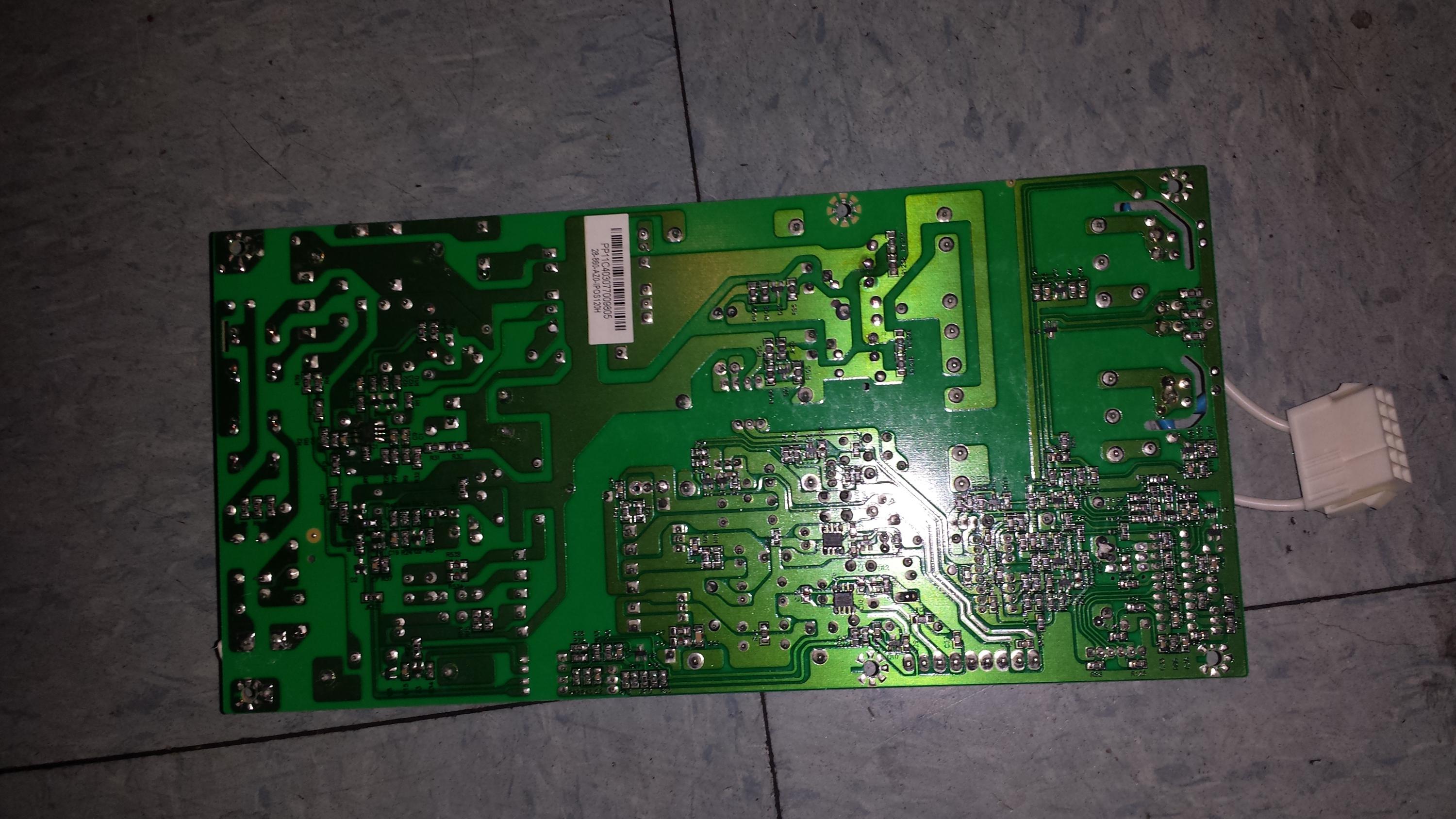

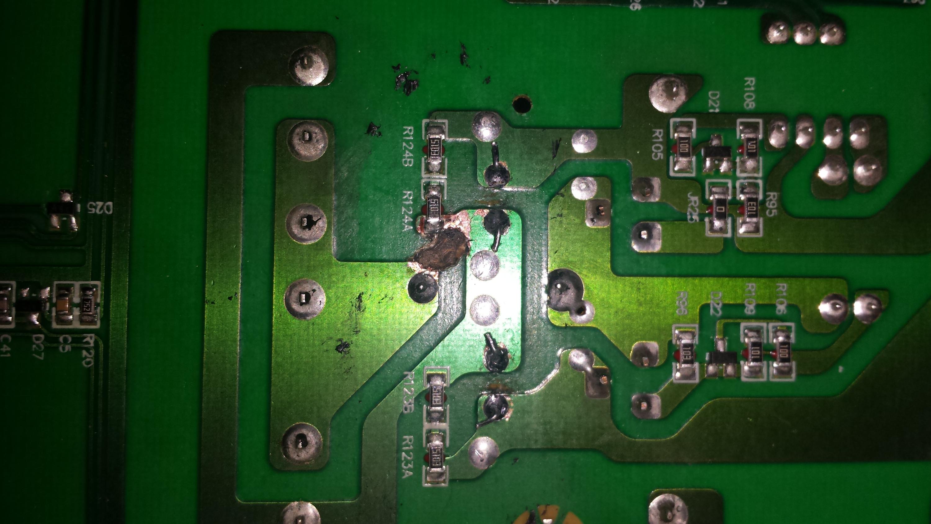

              Re: Memorex T3321
              It looks like there has been arc-over between two tracks in that area. Did you clean it?
              Can we get a photo of the other side of the PSU too, to see what is going on there?
              Was the new PSU brand new or used? Can you post photos of it also? Preferably the inside of the whole set also.
              With sound but no picture could be a backlight issue. Do you get sound even with the screen off, or does everything eventually stop? If you shine a bright light on the screen, can you make anything out? (works better at night) It could be the lights\inverter is bad but everything else is working.

                Re: Memorex T3321
                Yea,i Cleaned It. Before IGot the New One. The New Is Used I Got It From Ebay. What Would Keep The Lamps Off .
                the first two are the new one
