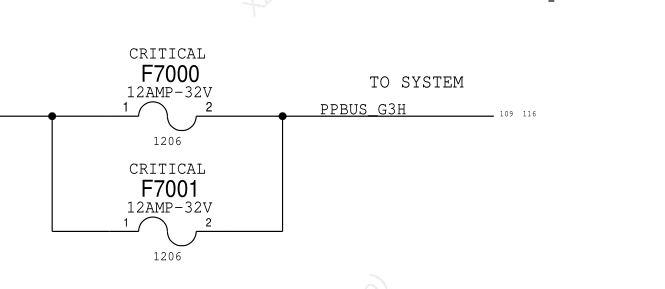

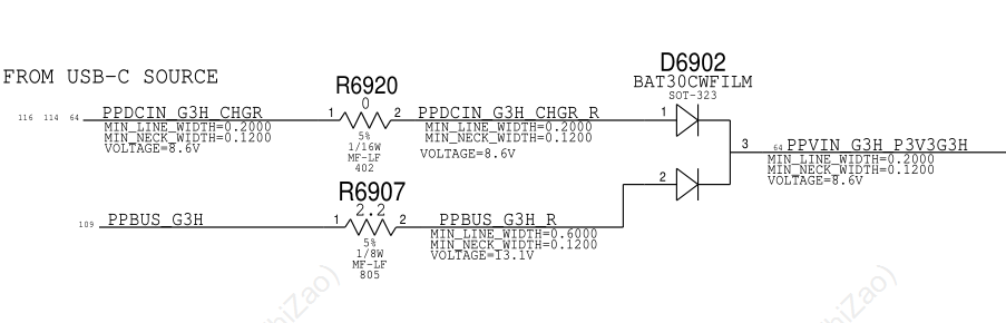

            Carefully measure the voltage to ground of
            PPBUS_G3H @ Fuse F7000 or F7001.
            PP3V3_G3H @ L6900.
            Also measure the above points of interest by checking each pin on D6902 (dual common cathode diode) - measure each pin to ground.
            What are the measurements?

              F7000 and F7001 measure 0.09V.
              D6902 pins
              1 - 0.03V
              2 - 0.06V
              3 - 0.05V

                The board is missing PPBUS_G3H. Remove all power / disconnect the battery. Measure the resistance (not diode mode) of the PPBUS_G3H rail @ F7000/F7001.
                What is the resistance in ohms? If the resistance is too low, there is a shorted component on this rail. Moving forward, flux and carefully remove each of these fuses so that we can isolate the producer side (ISL regulator) and the consumer side (downstream) of PPBUS_G3H.
                Then power up again and measure the voltage this time to ground on the PCB pads. Do you now have a stable PPBUS_G3H rail on the producer side without a load?

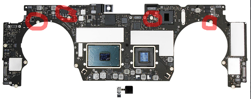

                        Sorry this is very amateur but can the gold plated part of the mobo ground as per below?
                        When to ground, it measures 0.
                        Click image for larger version  Name:	A1707 Ground.png Views:	0 Size:	382.3 KB ID:	3333344
                        • mon2
                          • Dec 2019
                          • 14522
                          Yes. The round plated holes are intended to serve as ground connections to the chassis. There is a short to ground on this rail and this is causing the rail to turn off.

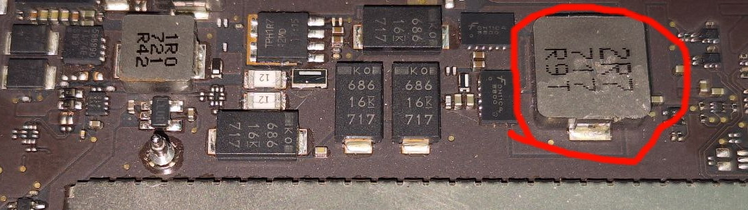

                            Ok, measured all. All seem to be testing OK besides the one I have looked at here in the pic. Measuring 0.
                            Thanks for your patience so far. I know I am still asking a few things that I could be learning myself. Time just isn't on my side right now.

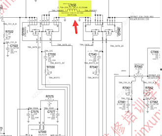

                                  In post # 14 - how was this measured? In resistance mode with the meter probes across the 2R7 (L7030) inductor leads? If yes, then the resistance will be close to 0 ohms because this is a long run of wire = coil of wire.
                                  Or is this the resistance to ground = 0 ohms? Not be confused with 'OL' = over limit and then you must select a higher resistance scale on your meter.
                                  If this rail is at 0 ohms to ground then there is a shorted part on this rail.
                                  Test in DIODE mode and compare the value to the attached. Meter in diode mode. Red meter probe, yes red to ground. Black meter probe on either side of this same inductor. What is the measurement? If close to 0 then there is indeed a short on this rail.
                                  In diode mode, a non-shorted rail should be as per the attached diagram = 0v462.
                                  Click image for larger version  Name:	diode_mode_reading.png Views:	0 Size:	774.7 KB ID:	3448607

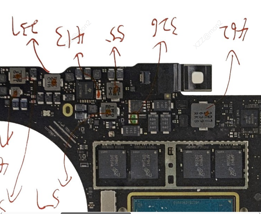

                                    Yes absolutely 0 ohms. All others measure and the number keeps going up.
                                    In diode mode the other inductors measure and give a beep. 462 shows a small measurement that drops to 334 to ground and then doesn't give a beep at all.
                                    Same for 237, 413, 55. Highest on top left one @819 and lowest one at 129 on "326" as per your pic.

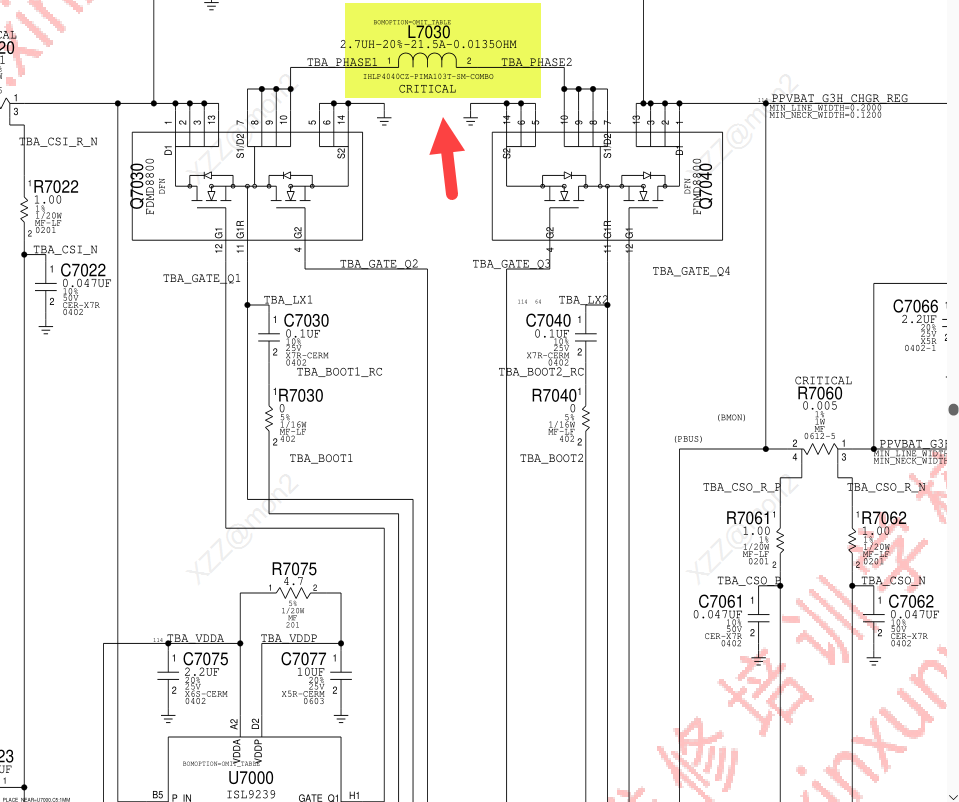

                                      Both Q7030 and Q7040 dual mosfets are suspects since they both contain low side (switching to ground) mosfets.
                                      You have a few options but suggest the following:
                                      1) if you have flux, hot air and patience, consider to flux one side of this inductor so that it can be lifted off the board. One leg only is required to isolate which side of this circuit is shorted. Hoping it is not both but you will know soon enough.
                                      2) After the one leg is lifted, test the inductor PCB pads to ground again and check if the short is removed or not. The side that remains to be shorted should have the dual mosfet replaced. Measure the resistance to ground on each step of this replacement process.
                                      3) Plan B is to flux either one of the dual mosfets (Q7030 or Q7040) -> remove the part off the board and test if the short is gone or not. Repeat with the other mosfet if the short remains.
                                      One of these dual mosfets is leaking to ground.
