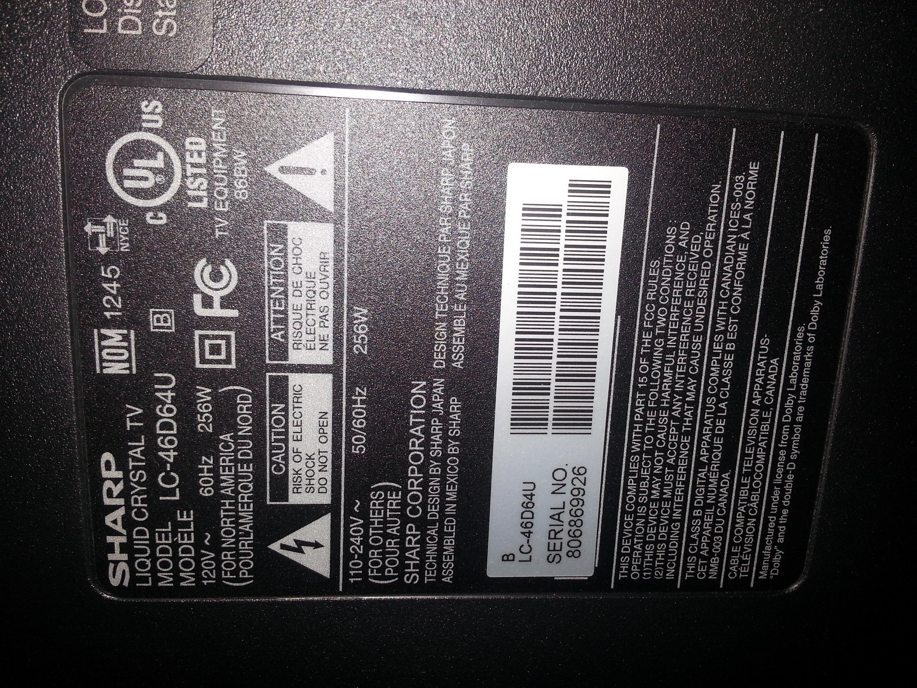

    Question is will my Sharp LC-46D64U accept both 110 and 220V input?
    The back of my TV has the sticker than mentions 110V for north american and below has 100-240 for others. The manual also says the same thing, but I called Sharp and the lady I spoke to on the phone said they didn't recommend it... not sure though.
    Any advice would be great... Moving overseas and would like to not have to buy a voltage transformer...

          Re: Sharp LC-46D64U TV voltage... both 110V and 220V?
          You would be better showing the picture of any info on the back of the tv.
          Also there may be more information or a jumper or wire link on the power supply board
          with an alternative position for different voltages.
          Hope your not going to brazil
          http://www.liveinbrazil.org/electric...en-travelling/
            Picture of TV attached...
            Are you recommending that I open up the back of the TV to look at the power supply board?
            Nope not Brazil... Expat to Norway

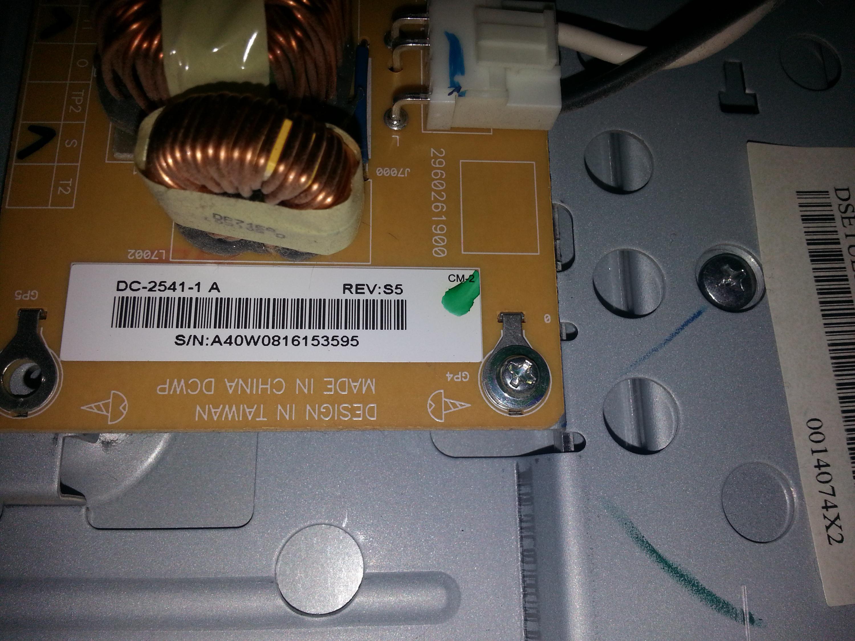

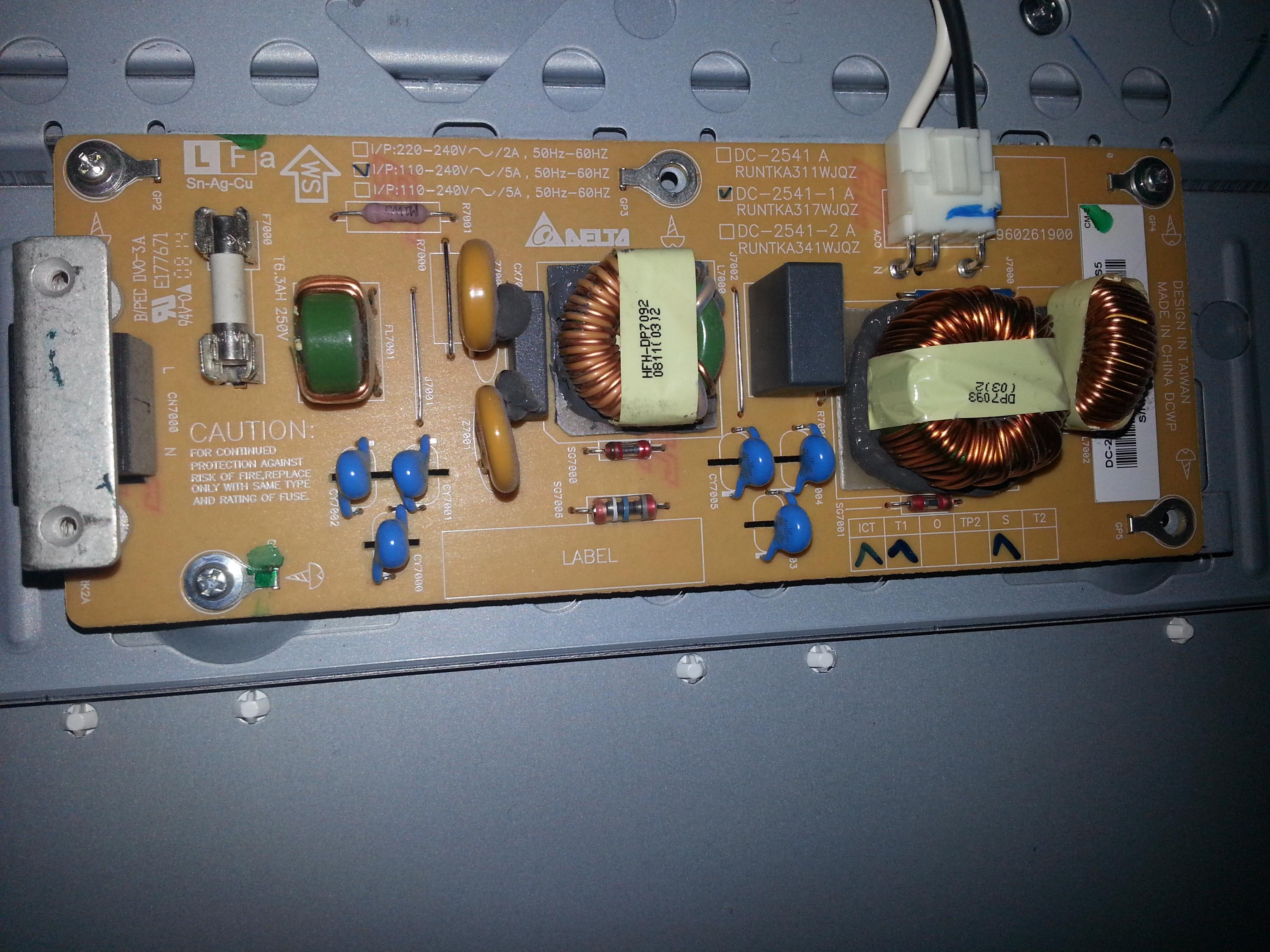

                Opened the back... here are a couple pictures of the power supply board. Looks like it's ok for 110-240V. Tried to google the board part number for specifications but all the sites I looked at didn't give anything I was looking for.
                  Another pic...
                    Id say the tick in the middle box is the clue. Sorry i dont have time now to check further
                    guess you searched for DC-2541-1A ?
                      Yeah I googled the DC... number. Mostly Ebay and other sites selling used boards with no real information other that the TV model number it's compatible with.
                        The TV should be fine. The only thing that won't work will be something like the tuner; the HDMI and component ports should still work as they are completely universal. Also, it will probably work with PAL sources as most modern TVs support PAL and NTSC, regardless of the region they are made for.
                          have you got a foto of the psu?
                          it's worth checking what voltage the smoothing cap(s) are for a start.
                          they may have left parts out or used under-rated parts for the u.s. market.
                          btw, it probably wont be much use in norway unless you have a cable or sat reciever when you get there.
                          they use DVB and it's probably MP4 and HD.
                          if your tv can tune it, it may still need an MP4 cam module.
