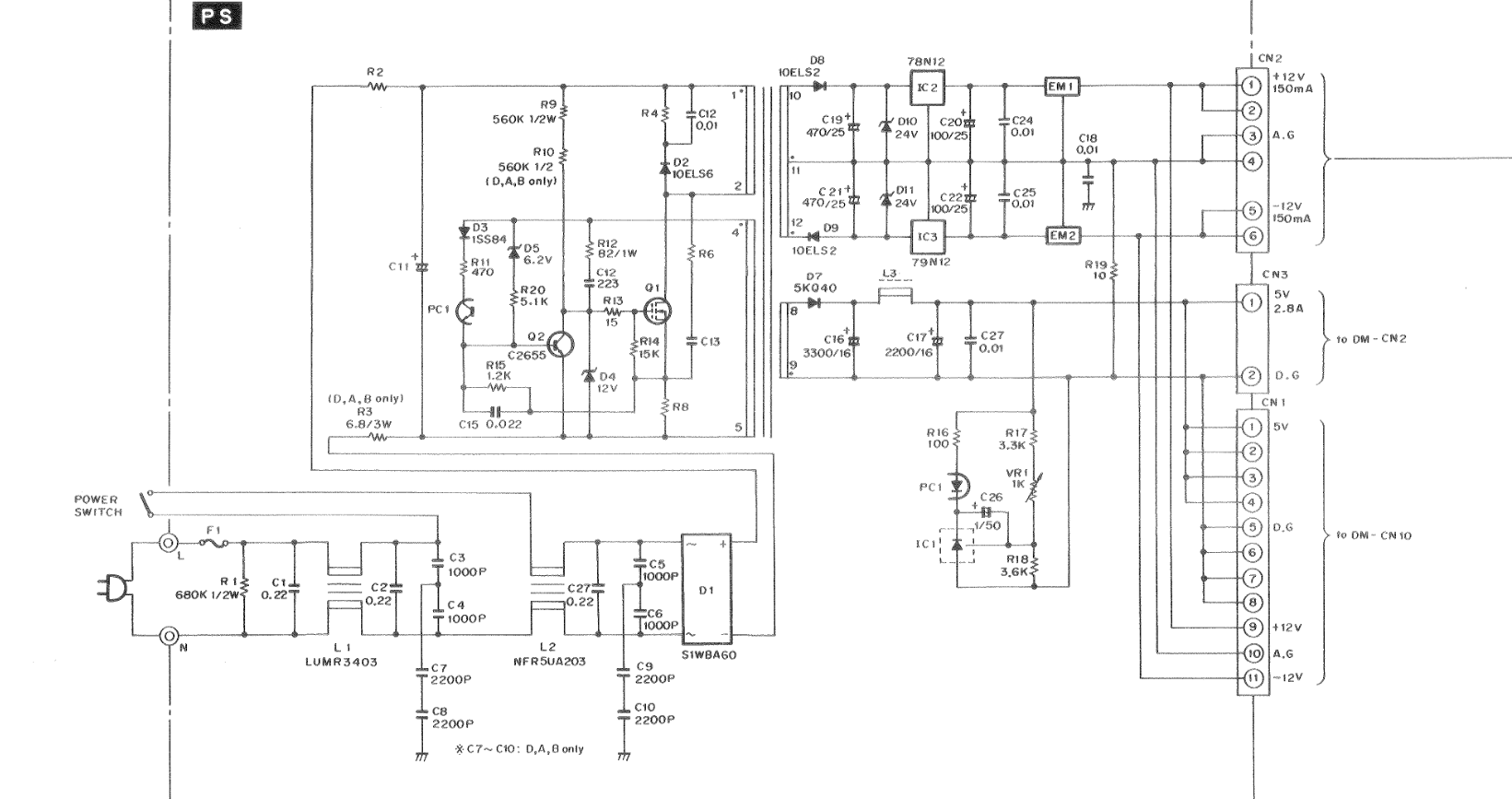

    I need help to ascertain if the power supply on my Yamaha SY85 keyboard is 110v or 220v or both.
    I have attached the schematics below.

    What is the voltage rating on C11? From a picture I found it is 150µf/200v which would suggest the power supply is for 110v ac input only

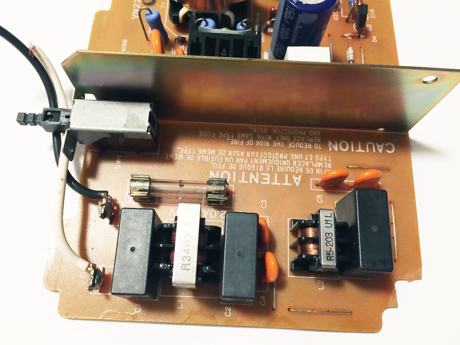

      does it have R3 fitted? i suspect that is used for 220-240v regions.
      btw, typical japanese shit - they fitted the wrong fuse!
      it should be ceramic for mains use - not glass
        Yes it is rated at 200v. You are right, the power supply is for 110v AC.
          No R3 is not fitted. I have also got confirmation from another Yamaha SY85 owner that my keyboard model is for 110v AC.
