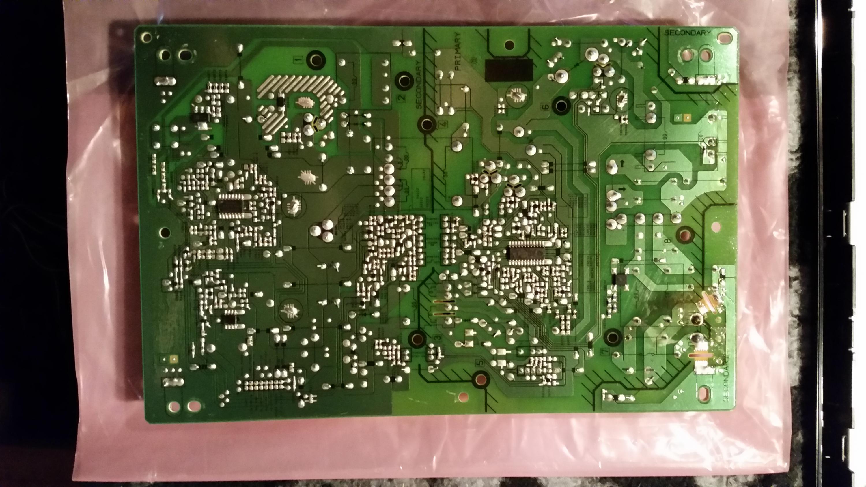

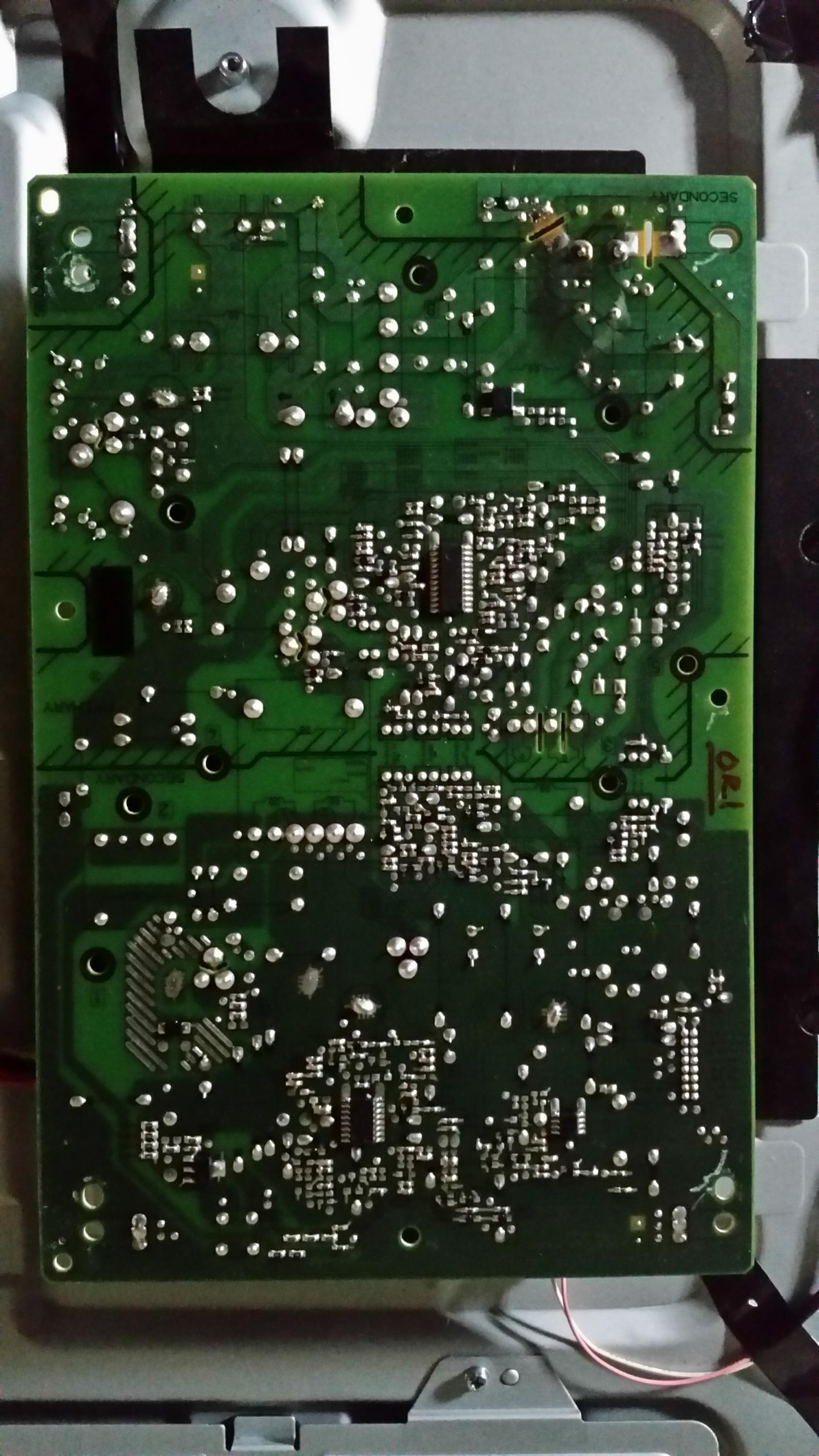

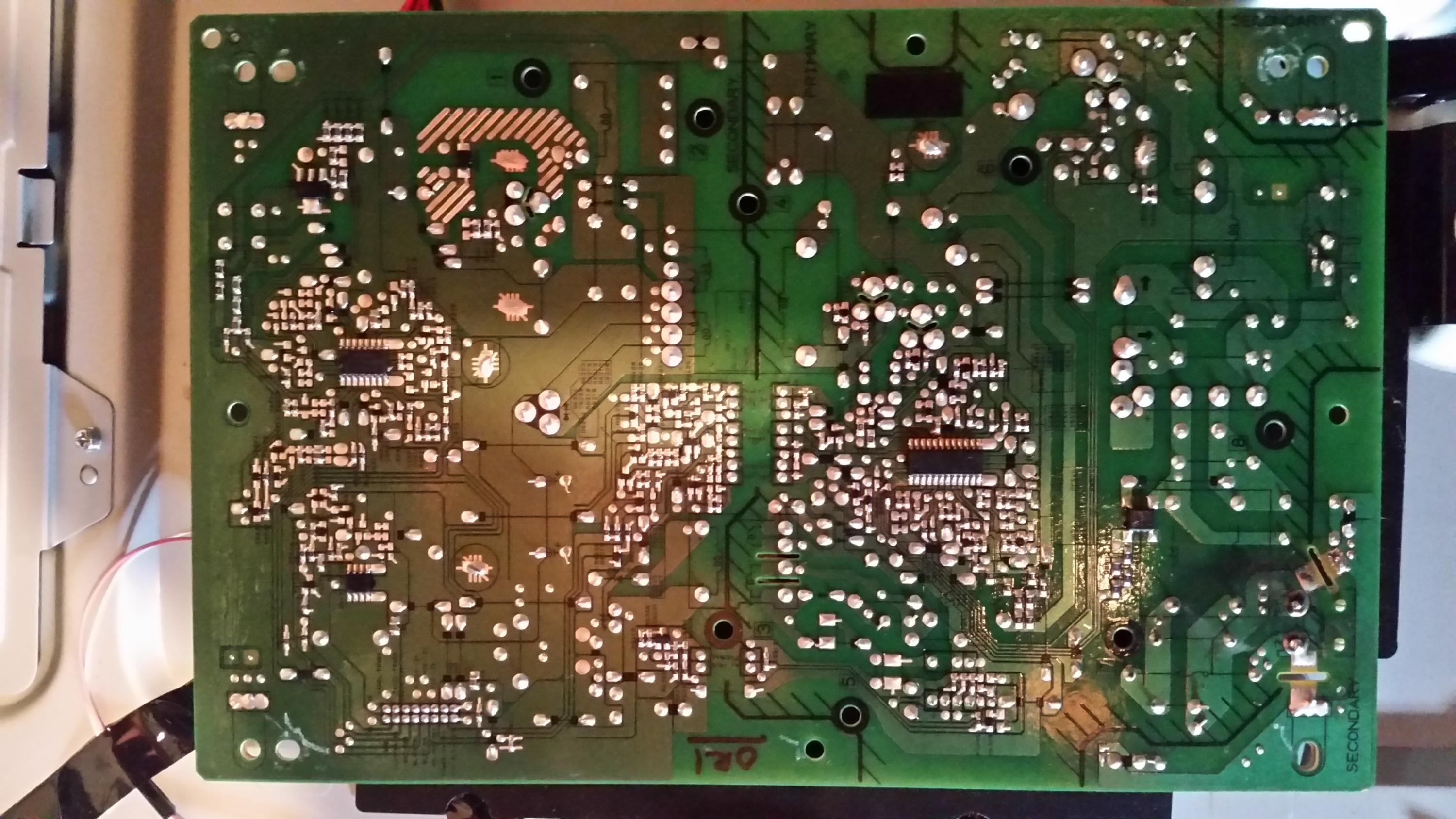

    Decide which board you want to trouble shoot and post a good clear picture front and back. You of course can duplicate the tests on the other board but to work on two boards is just too confusing (its difficult enough with one)

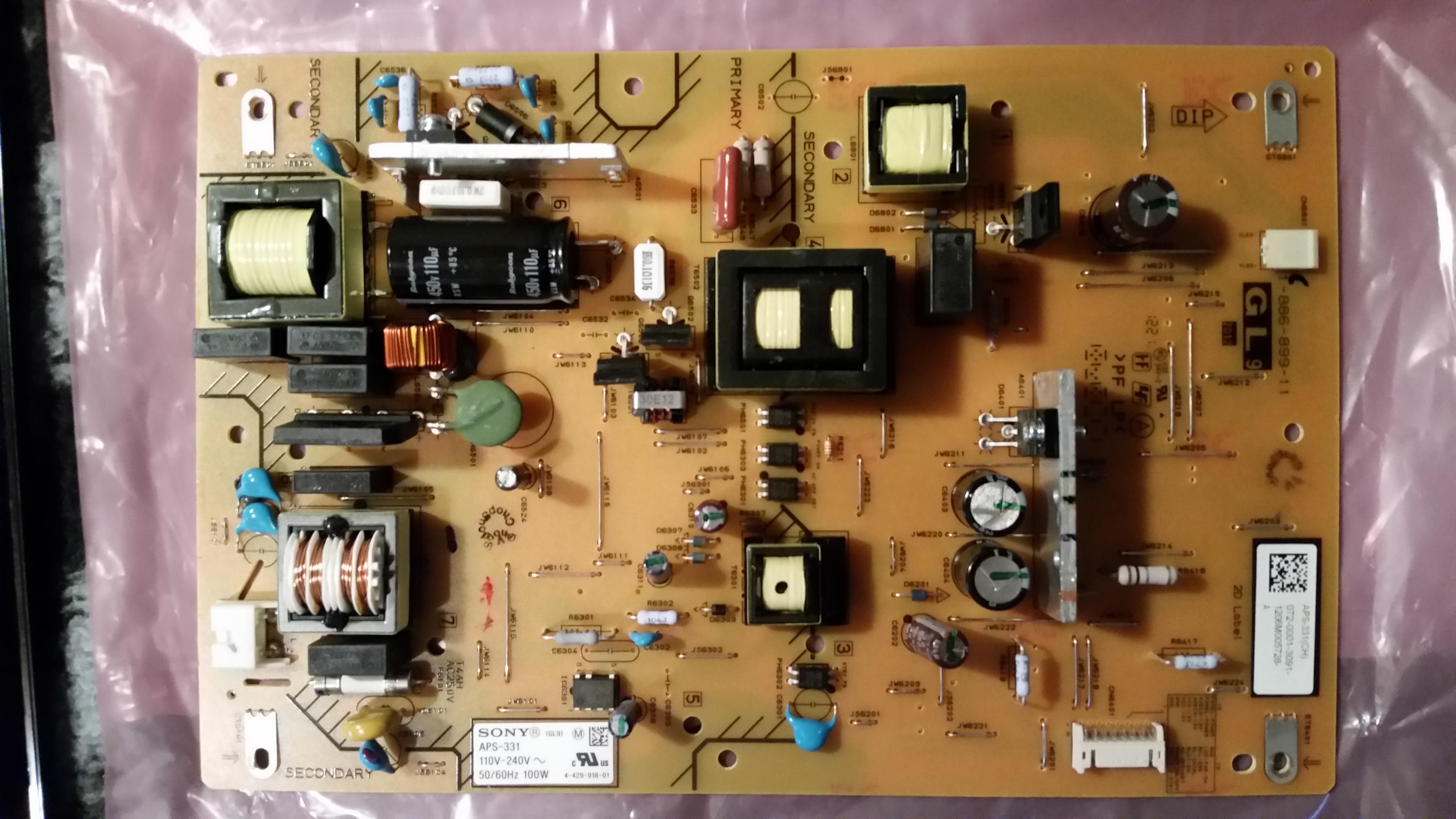

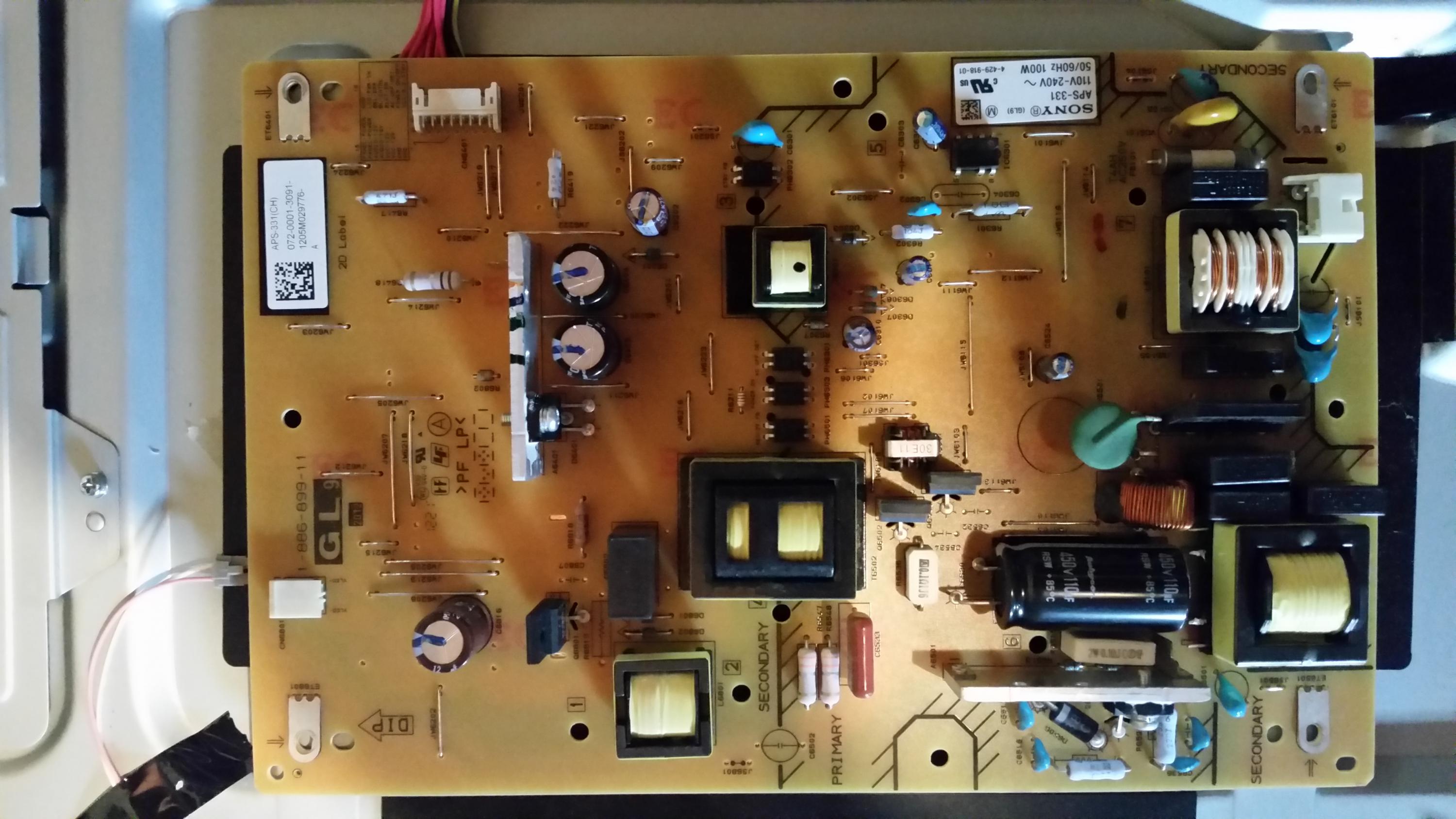

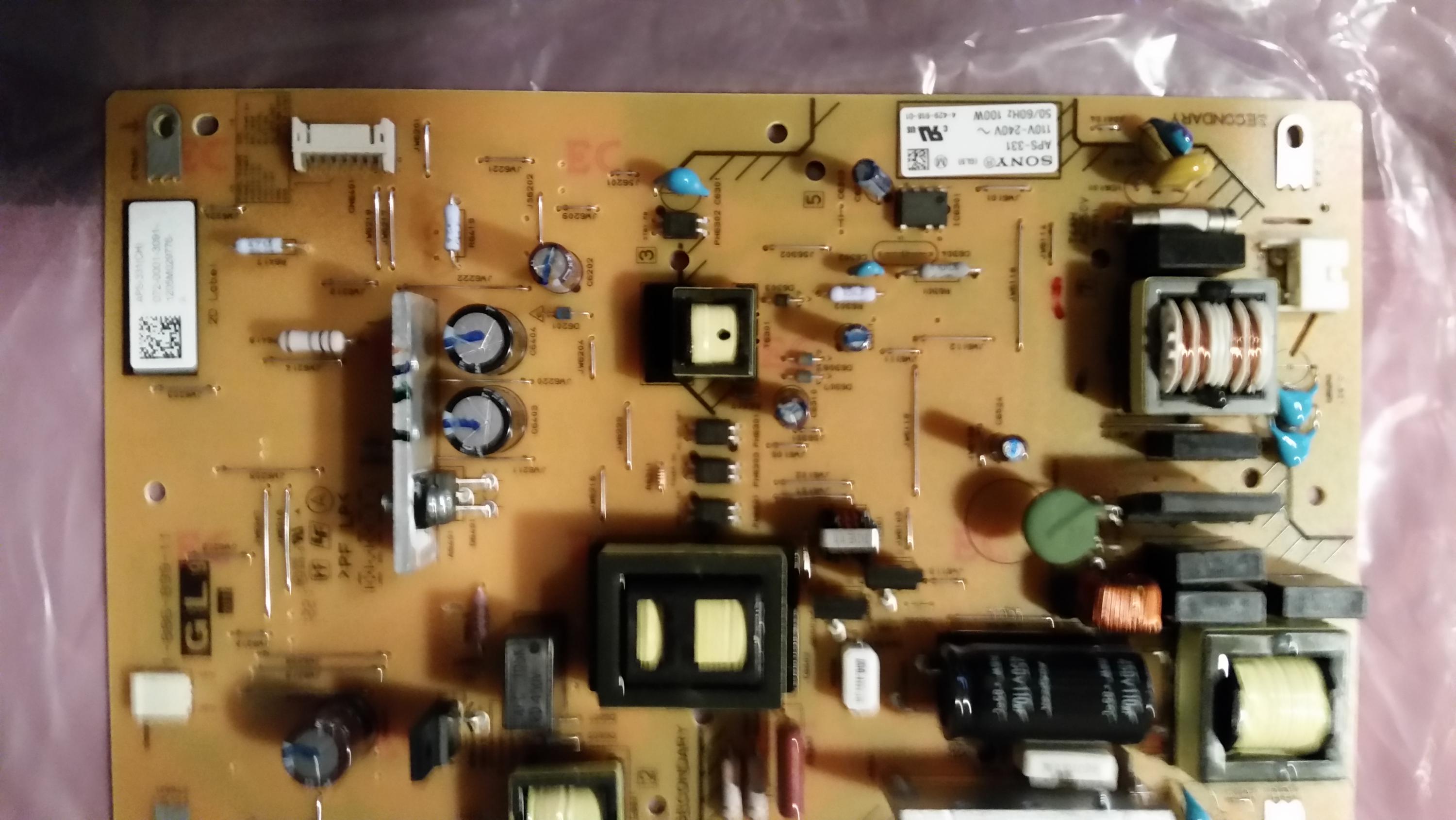

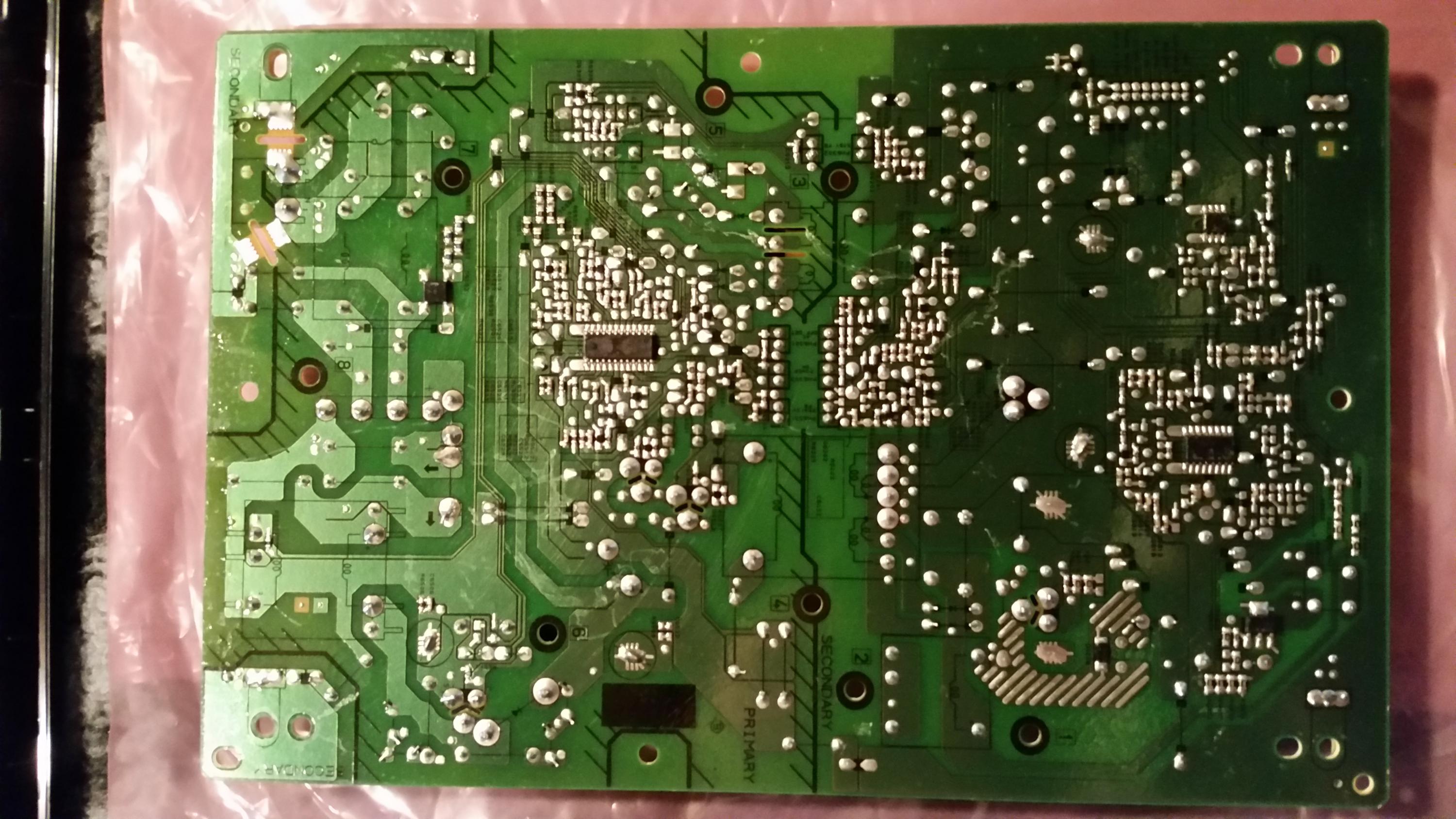

      I have included here both boards for sake of being complete. I would like to only troubleshoot the old board because both new and old are giving me same bogus readings at the pins going to main board. No pin reads over 350mV on either board. I will be returning the junk new one.
      Old board:
        Re: Sony KDL-32EX340 not powering on
        New board:

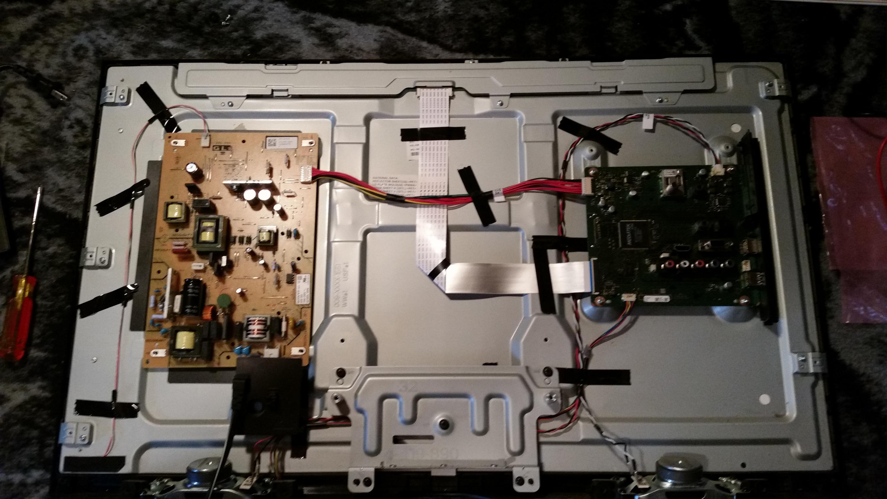

          Please also post the pictures of the whole back side of the TV so we can see how all the boards are connected together.

              Attached is a photo with all boards and their connections.

                Bit of a shame but the Picture of the old board needs to be a bit clearer - I can see much more detail on the new one, but we need to see the old one clearly.
                There is a small transformer between the BIG 400v cap and the edge of the board
                can you check the soldering on it - looks a bit odd in the picture.
                Are you confident to test high voltages? 300-400 volts say?
                If so can you connect the power supply to the mains, set your meter on 600vdc and
                very very carefully put a probe onto each leg of that BIG capacitor.
                If the board is off the set make sure you are working on a non conductive surface and dont touch any part of the board other then the capacitor with the probes.

                  Hopefully you will find these new pictures of the old board a bit more helpful.
                  Two lighting conditions just to be sure.
                  Both new and old boards read 164.7V on the biggest cap (a 450V).

                    Check the fusible resistor R6301 to see if it has open circuit, it is for feeding the B+to the STBY SMPS IC 6301 (MIP2H2).
                    Also take the resistance reading between pin 7 (8 is tied to 7) and the other pins, then report the reading.
                    http://www.shopjimmy.com/media/catal...254-11-top.jpg
                    http://www.shopjimmy.com/media/catal...-11-bottom.jpg

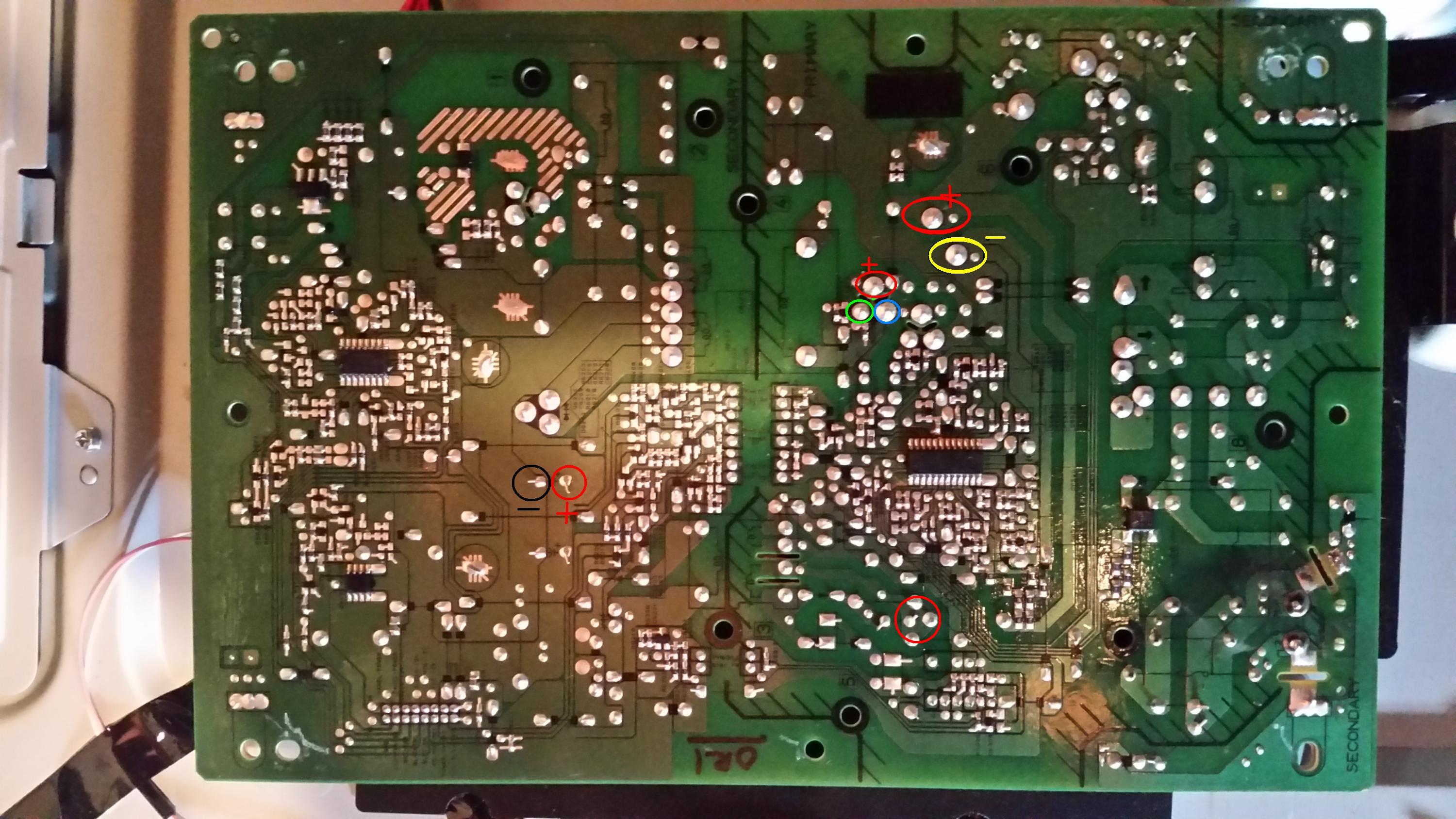

                      I would first check for 12v at the low side in case you did not get the right ground at the connector.
                      Set the power supply alone on a non-conductive surface. plug power into the board, THEN into the wall
                      Check voltage at the capacitor at the red and black circle
                      If no dc
                      then back to the high power side
                      and check for near 160+ between the yellow and red + next to it (this is the main cap again)
                      then leaving the neg test probe in place on yellow check the smaller red circle
                      at the same time you can check the resistor that bud m mentioned by using again the yellow as ground and red at the other side of the board at the group of 4 pins in the red circle.
                      if 160+ at all points
                      Unplug power, let sit 10 minutes
                      then check resistances
                      blue to red green to red and blue to green
                      and on the ones Budm asked for on the 7 pin IC

                            Using my newly purchased board
                            First black and red = no voltage
                            Big capacitor = 164V still
                            Negative big cap to small red circle shows variance from 380v down to open loop and this keep cycling as long as probes connected.
                            162V from yellow to red across board
                            Resistances
                            Blue to red = open
                            Green to red = 10 mega
                            Blue to green = 4 mega
                            The real 7 pin IC
                            1/8 17mega
                            2/8 11.5mega
                            3/8 6.8 mega
                            4/8 7 mega
                            5/8 open on the new, 8 mega on old
                            6/8 7.5mega
                                      "Negative big cap to small red circle shows variance from 380v down to open loop and this keep cycling as long as probes connected" Unless I am reading your post wrong. Also reading in MOhms in circuit of the fusible resistor does not make sense either.
                                      The big red circle with + and the Yellow circle - are the two legs of the main filter cap. There is no other circuit in the primary side that will generate the 380V except the PFC Voltage booster circuit.
                                        looks like he is getting the 380 between neg of main cap pin (yellow) and the small red circle w/ + next to it on the main power mosfet
