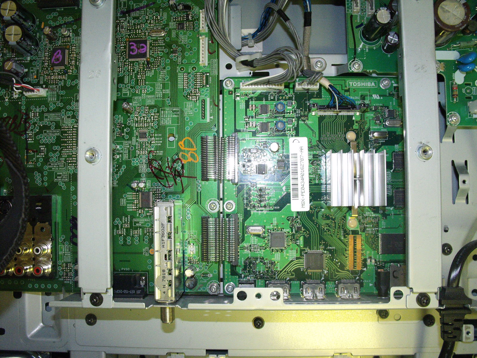

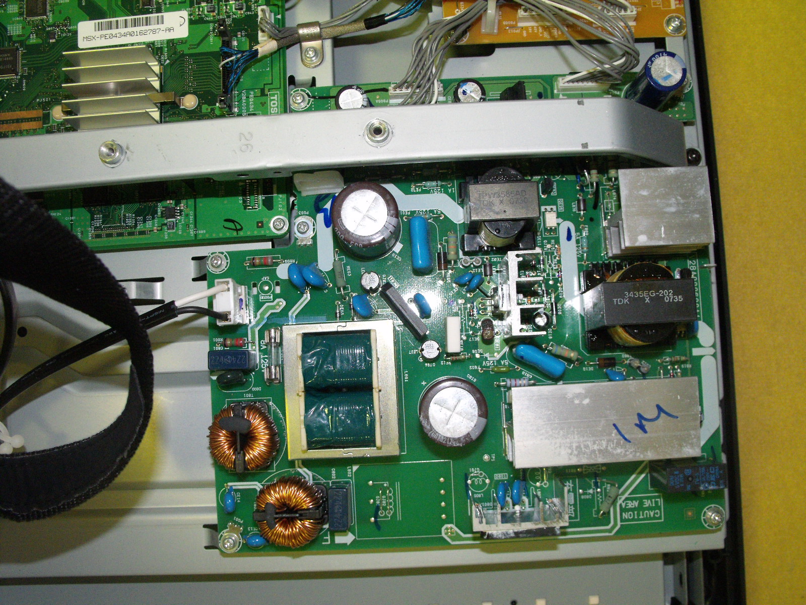

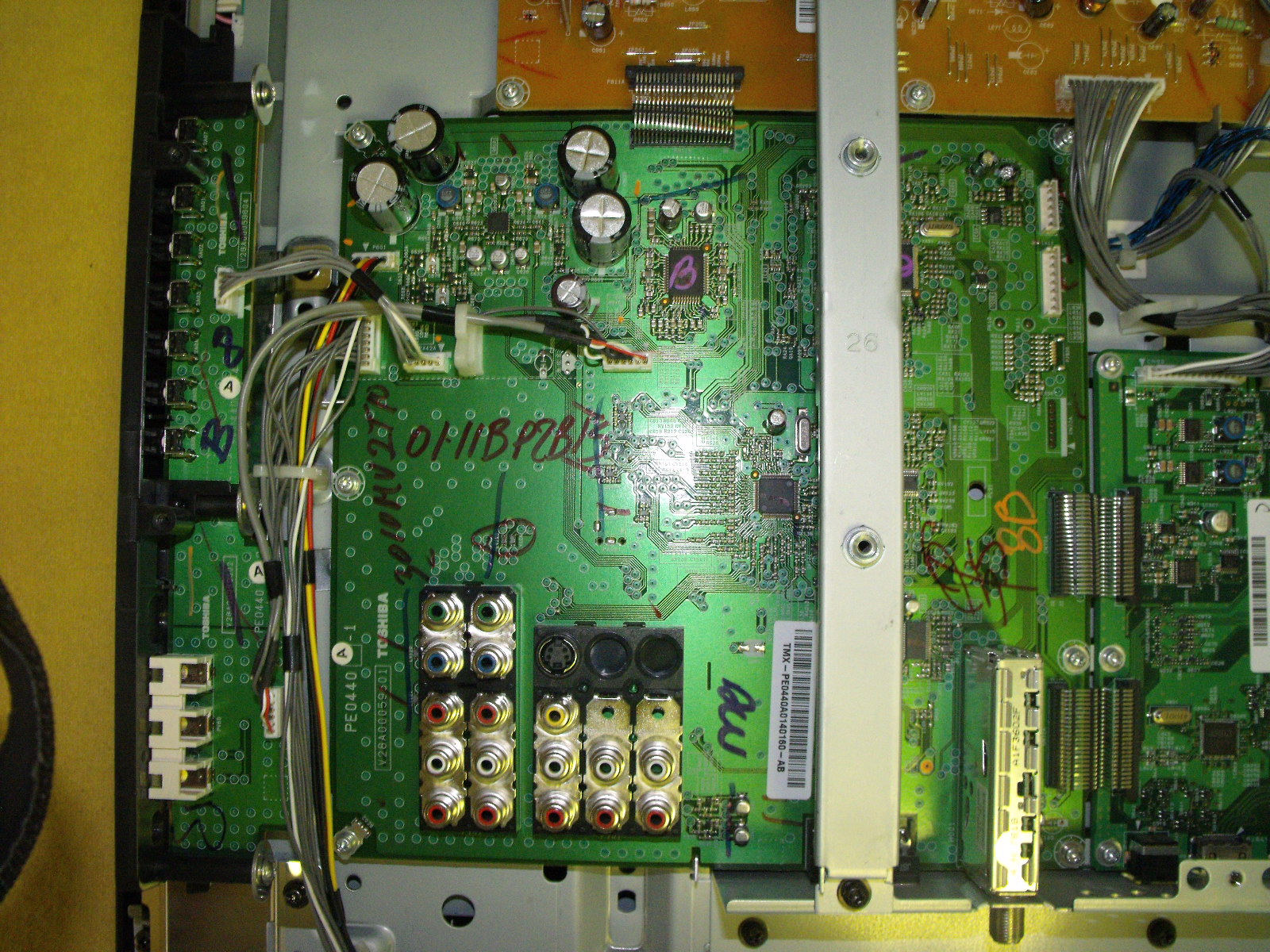

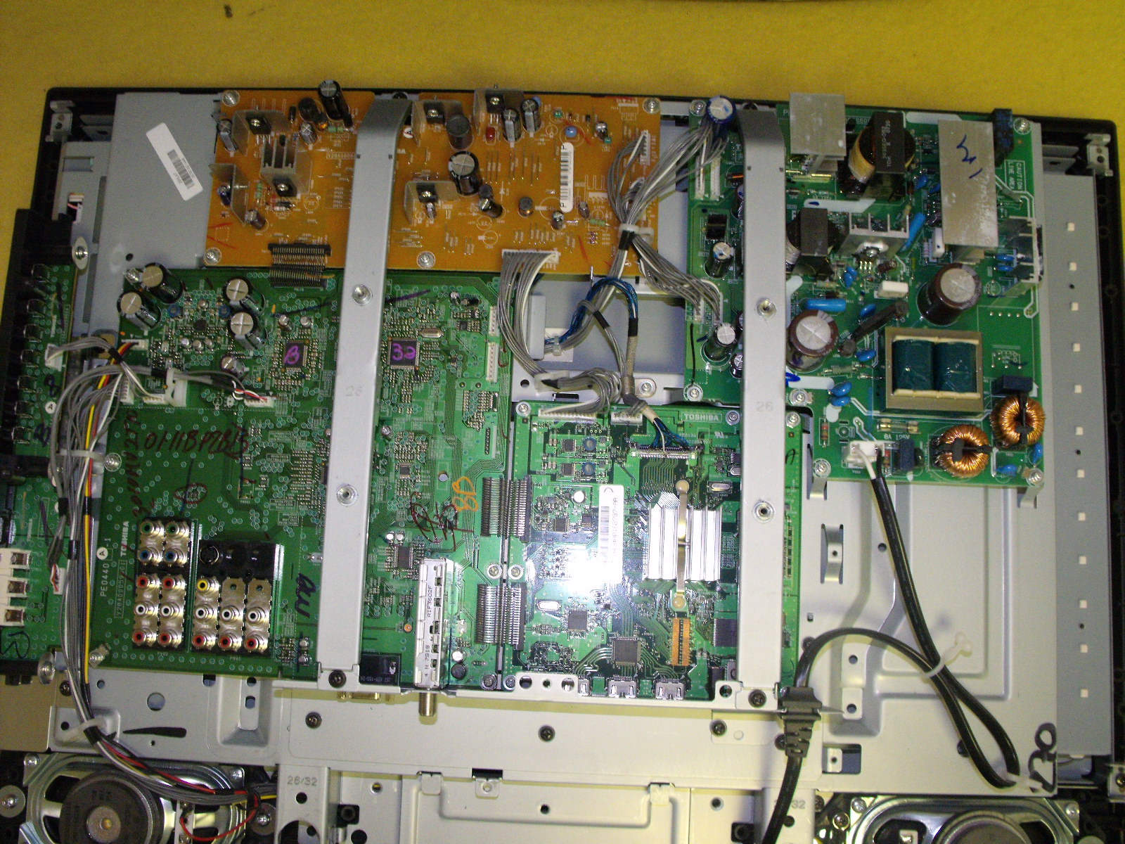

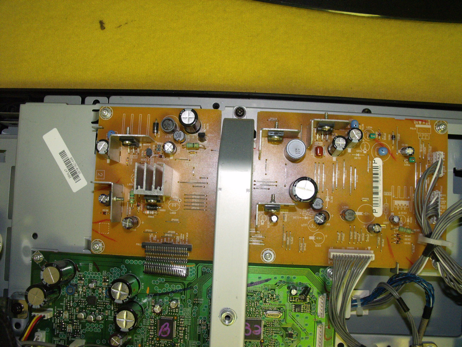

    I have a 26HL47 Toshiba and it turns on and backlights come on but that's it no picture. I can press the menu or input buttons and just nothing on the screen but a white picture. I'm not even sure what to start checking so if someone could guide me I would greatly appreciate it.

    Might be the Siene board, I know that on of the trouble shooting sites I read when I was working on the 37HL was a white or black screen on boot up could be a siene board issue.
    How many amber blinks before it comes on?

            Any pin marked 12VLCD on that sub power board? Top middle.

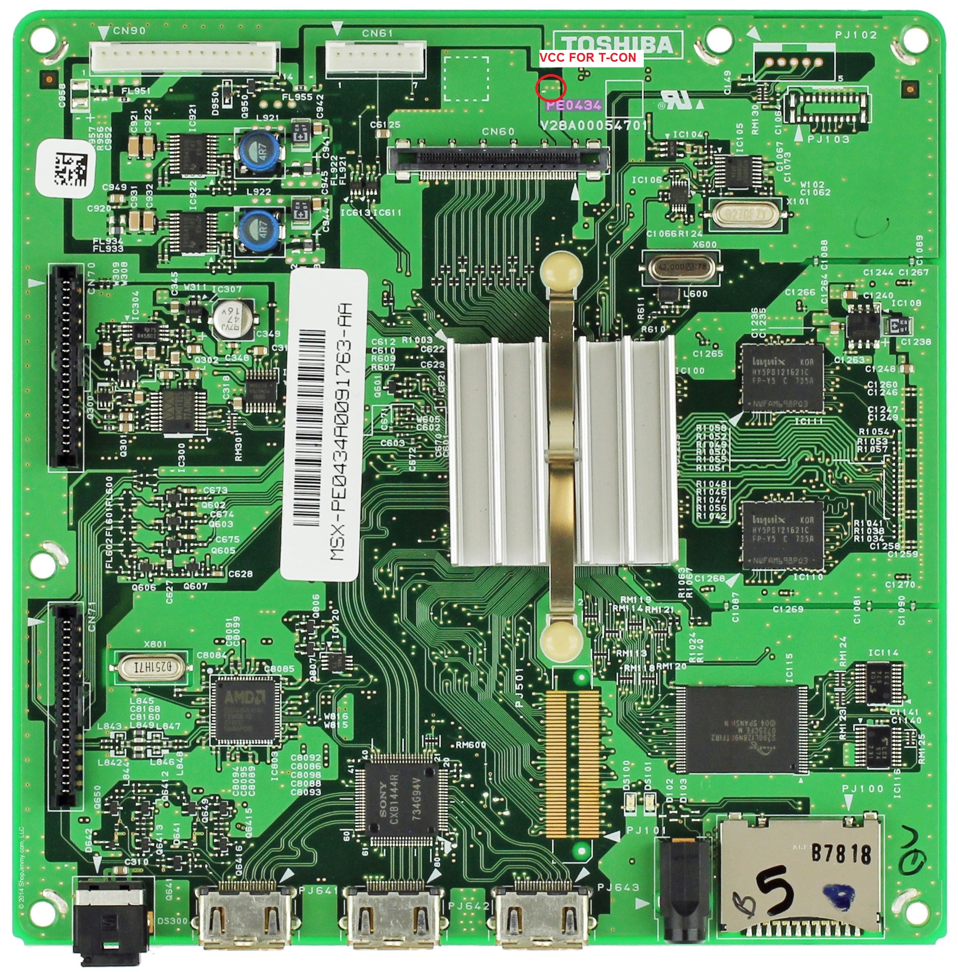

                OK, what about the POWER_LCD pin, can you check that, it's on the flexi-ribbon-metal thing.

                  Re: Toshiba 26hl47 White screen
                  Hard to tell what pin it's for but looks like 3.28V
                    When you turn the TV on and off, does this change?
                    If so, we will need to look at the T-con board.
                      Just goes to 0V when off and 3.28V on.

                        try disconnecting the one metal plug that has all the blue wires and the small one that is next to it with the 4 gray wires and see if the white screen is still about the same brightness.
                        If it is about the same, see if you have any voltage on the gray wire plug pins on the board side (Wires look glued so you probably want to check those with the plug removed)
                        then check the far right group on the blue wires (probably easier to check these with that plug plugged in

                            What do you get on pin 14 of connector CN90A of the B board (the brown board)? Also monitor this test point.
                            http://www.shopjimmy.com/media/catal.../0/2/022_1.JPG
                            Picture is provided by SHOPJIMMY.
                                I get 5.17 volts

                                    Could a ribbon cable do this? I turned it back on and it seemed the picture was frozen compared to the sound and I did a little twist on the frame and the video started to work then let of and froze again.
                                      did you try a different input ?
                                      Try to check that 5 volts when the picture freezes or doesn't come on
                                      also loosen up as much of the rear assembly that holds the boards, to maybe, see if it is at the lcd panel side or in the boards.
