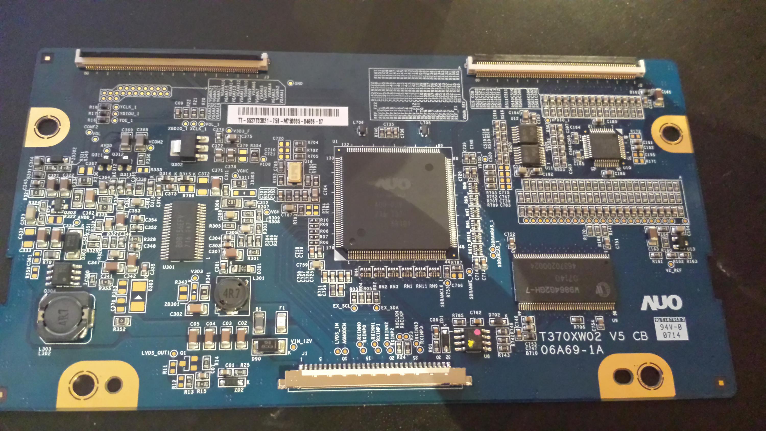

    turning back for a little info i had a samsung LE37R88BD a few years ago and it developed a dark picture and ghosting fault, changed the T-Con out and the thing worked like new again and hasnt went faulty since. I have purchased another Samsung but this time model number is LE37R87BDhs thhe same fault. it is the exact same T-Con board that is in the TV so my question is will i have to purchase a new T-Con or can an existing one be repaired ?

    Can we see the pictures of the board and the screen shot to see what the pictures you describe look like?
      Re: T-Con Repair ?

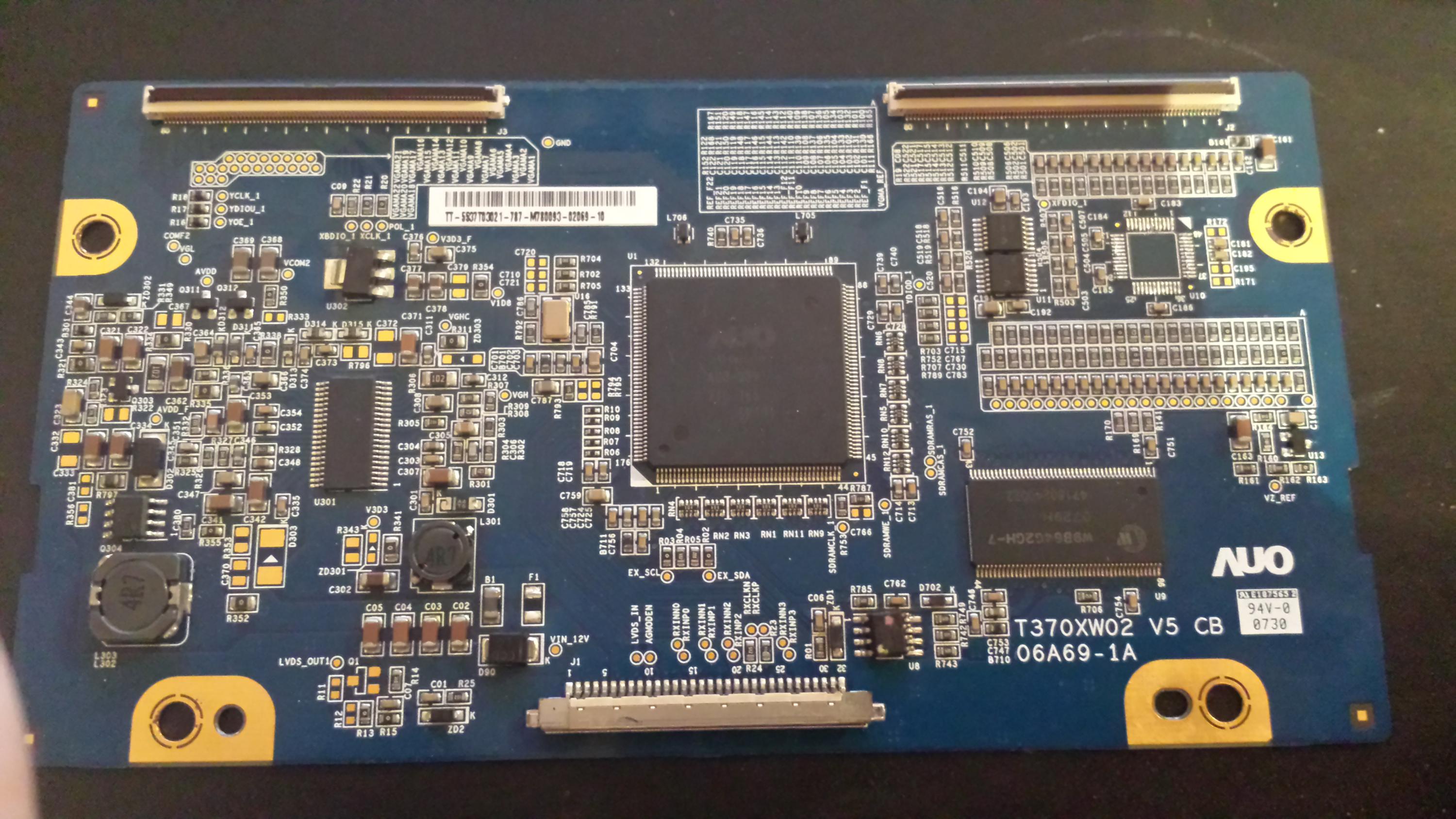

      picture of T-Con, you want a picture of the Ghosting Budm ?
        Re: T-Con Repair ?
        sorry Budm thats the wrong picture, this is the right one.

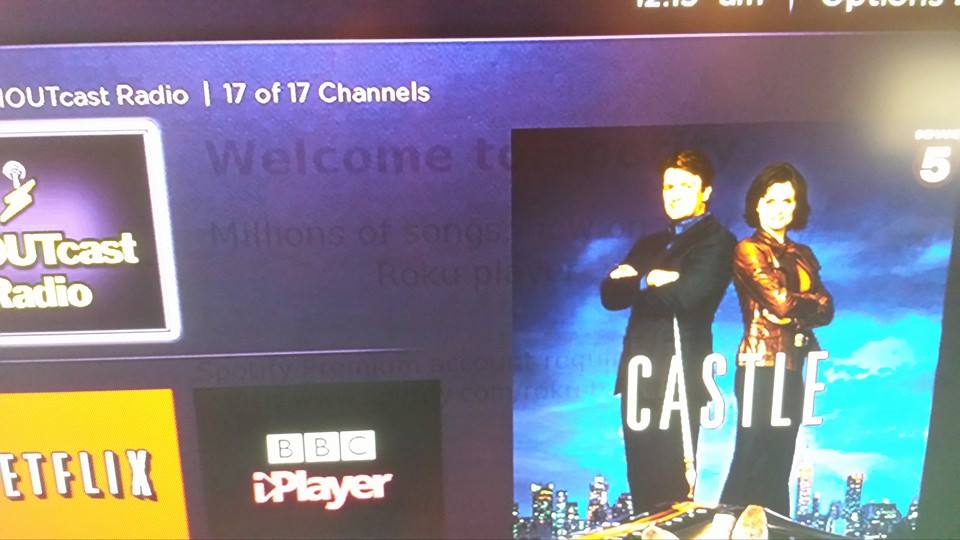

          Can we see the screen shot of the picture so I can what the fault looks like?
            Re: T-Con Repair ?
            sorry Budm here is a pic, plugged up my Roku stick and went into Spotify then came back out it and left image on screen when i came back out it.

              Looks like it has a as15 chip in it. The one in the top right hand corner.
                Re: T-Con Repair ?
                Yep looks like an AS15 failure to me, to prove it you can test the gamma voltages on the T-con.

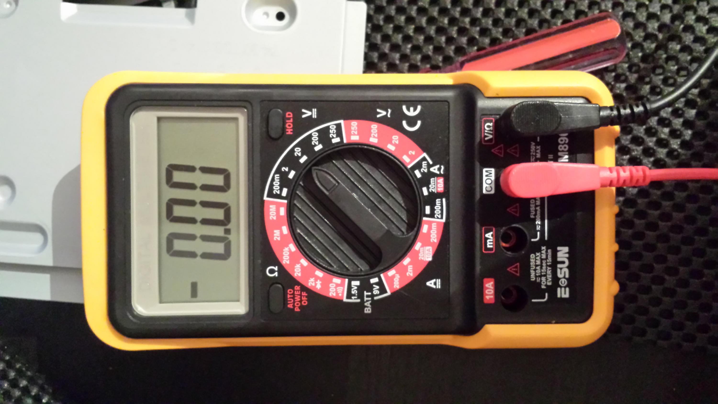

                        Tom have i got multimeter set up properly as voltages are coming back minus volts ?
                          Re: T-Con Repair ?
                          You have the red probe in COM and black in VOLT/OHM, it doesn't really matter but you should normally have the black probe in COM and red in VOLT/OHM.
                          (Just ignore the minus sign for the readings if you have made some already, it's not important.)
