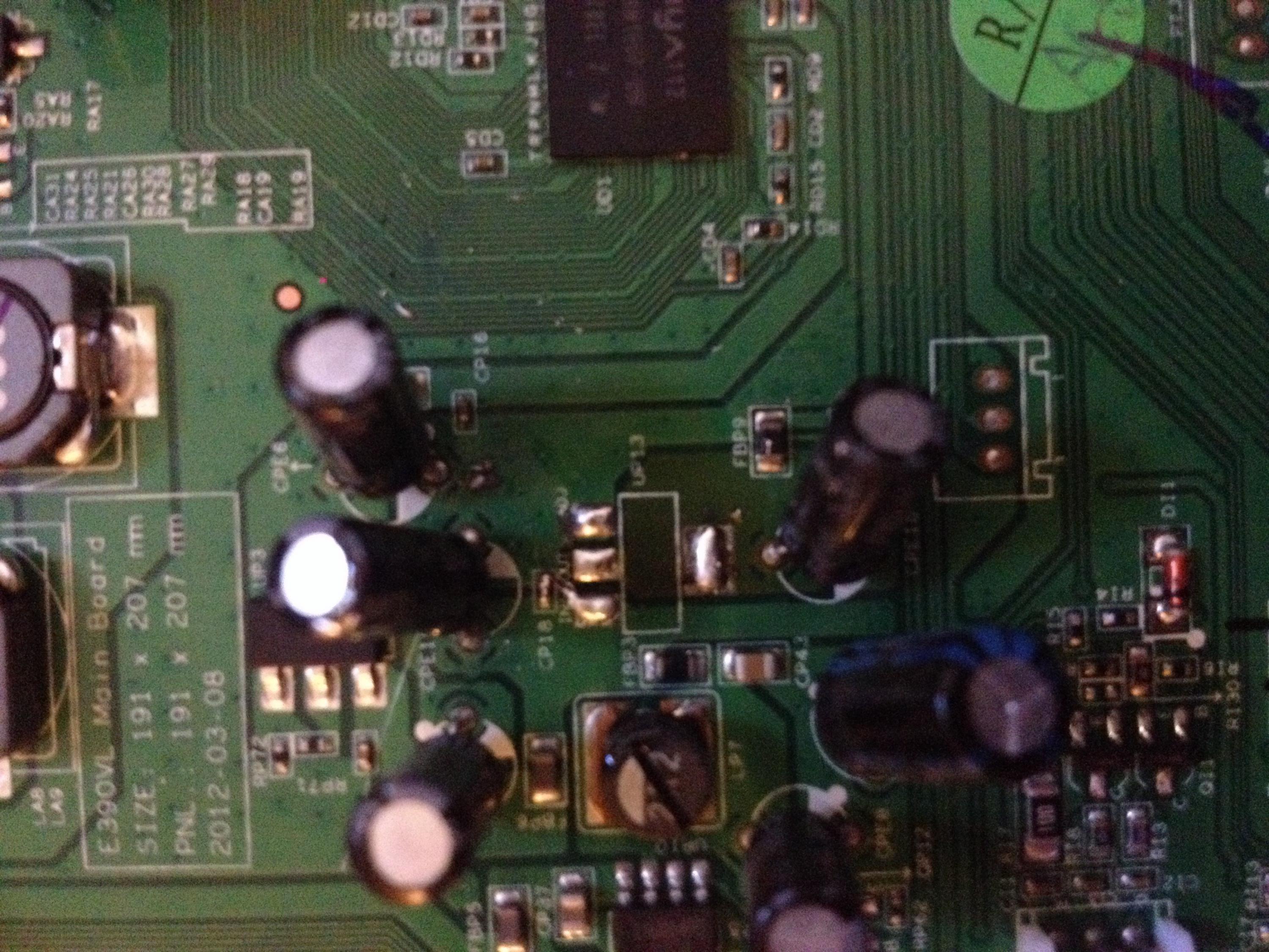

          So I removed the regulator and the big pad or output pad still read 1.1ohms. Here is a pict of the board with the regulator removed.

            you can remove the inductor to confirm (see picture) if your CPU is fried. This will isolate the regulator output from the CPU.Then measure the output again. I only did a visual trace of that output of that regulator, you may need to confirm where that regulator output is feeding by using your multimeter in continuity mode. also try testing the cap.

                Is there a small brown rectangular ceramic connected to the big tab of the IC also? Removing that FB (ferrite bead) from the circuit will help us isolate the load from the output pad, there may be more than one load that is connected to the output pad, removing that FB is the start.

                  The only think small I can see that's near the output tabs is that very time cp18 if you look just left of the 3 pads.

                    Ok I see the fb it's what eclogues labeled in his image. I will remove that and take another resistance measurement of the big tab in ref to ground.

                        CP18 looks like for the input. Typical kook up of the regulator IC will have electrolytic cap with small ceramic cap in parallel for the input pin and the same for the output pin.

                            BTW, the small brown ceramic cap usually is MLCC (Multi Layer Ceramic Capacitor), when it failed, it failed as shorts circuit.

                              Ok so I took the small ceramic cap out the fb whatever. And measured the resistance between the out put pin and the chassis ground without the tv plugged in and got 5.78 mega ohms. So I'm guessing the CPU chip is bad. Eh?

                                That or any other components that are connected to that section.

                                    Remove CPU see if short goes away )
                                      #78
                                      Re: E390vl help with regulator testing
                                      There has to be another MLCC cap after the FB, I would look for that and then remove it to see if shorts will go away.

                                          Also was the FB thing the MLCC cause there is a very small cap next to the FB thing I removed.
