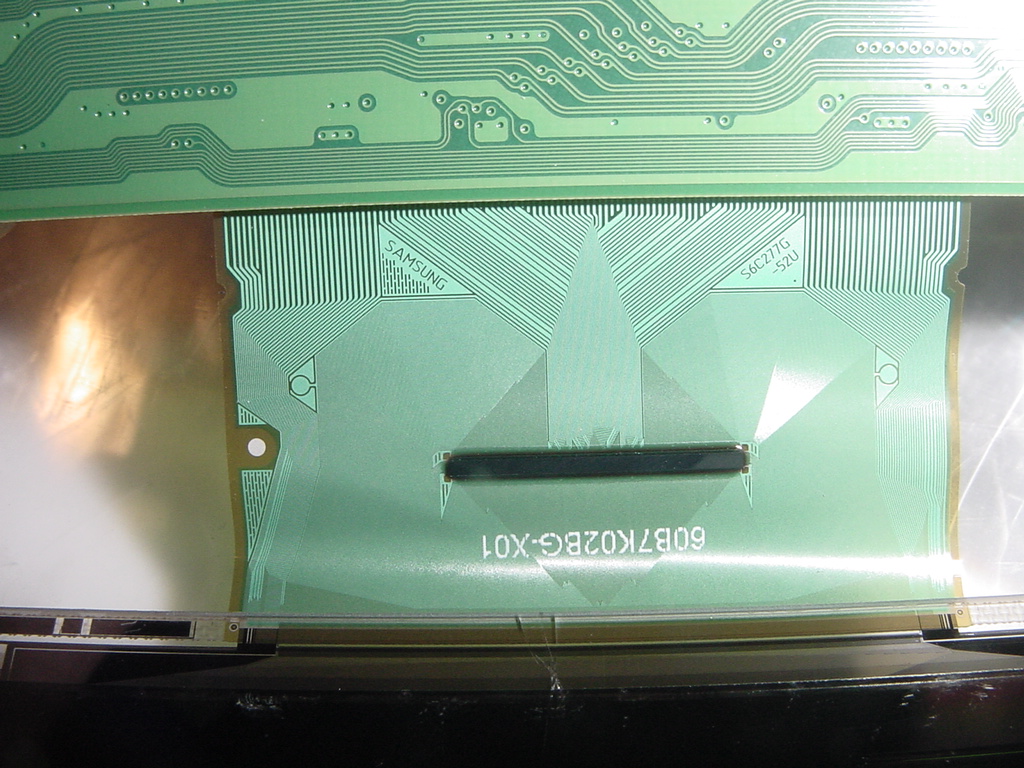

                  Bad news, one of the ICs in the flex board/cable has "darkening" at one end... I'll try to get a picture... I realize this would be extremely difficult to replace due to the alignment required, but is it even possible to remove the flex PCB from the glass without damaging the glass?

                    definitely the flexible pcb... Impossible to purchase/replace?

                      Re: Sharp LC-52LE640U - DET_PNL12V failure
                      For the average user the answer is no.
                      There are pulse tab bonding machines that attach COF etc but they are expensive!
